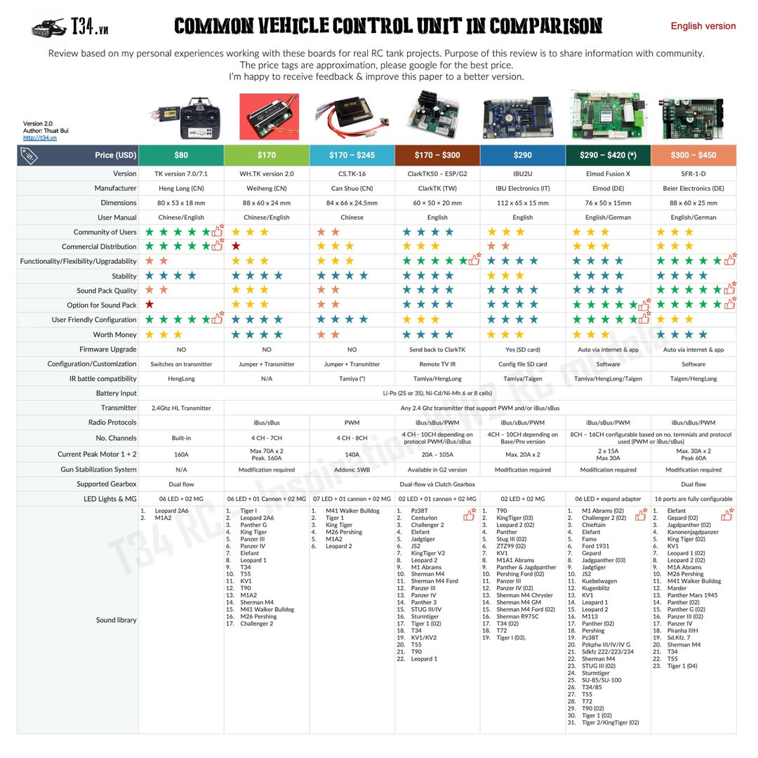

Xiaoshan_Sailor
Posts: 755
Location: Hangzhou, China
Re: Other types of mfu boards
Post by Xiaoshan_Sailor »
This was posted on a FB group from an RC hobbyist in Vietnam. Offers a nice recap on the various features & user value on commonly available commercial boards.
Posts: 6075
Oh, that is a handy chart! Thank you, Sailor!

Sam84 wrote: Tue Jun 17, 2025 7:02 am Thank you heaps for those suggestions will have to look them up, how does the dasmikro stand up against the other boards?
While I think you can use the DasMikro as a control card, in most cases, I think, it’s just used as a control card.
So no experience with Beier or Clark, but compared to Elmod it pales in comparison. The DasMikro you can have up to I think 93 seconds of total recording time? When used with the OpenPanzer TCB you can have the normal set of tank sounds and then 6 user sounds. Again, you are limited to about a minute and a half total, of sounds.
With the Elmod you can do up to 24 user sounds, and some of my sounds are whole songs, like Master of Puppets or old German parade songs.
Also Elmod is much much more user friendly than DasMikro, and I think Elmod is a larger library of sounds than DasMikro does. But you’re talking $30 versus $300 so…

Hi all thank you for all of your input and thank you to sailor for that great chart, all have been helpful. I ended up getting a dasmikro unit, USB programer and ESC unit for just over a hundred off Ali express so let's see what happens lol
Thank you
