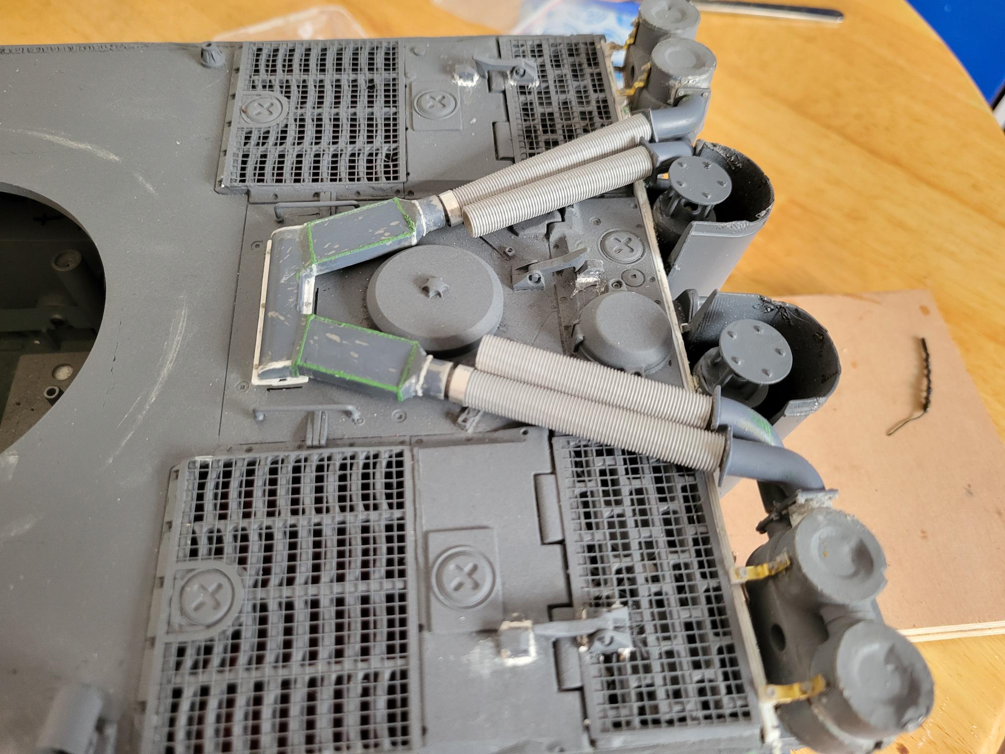

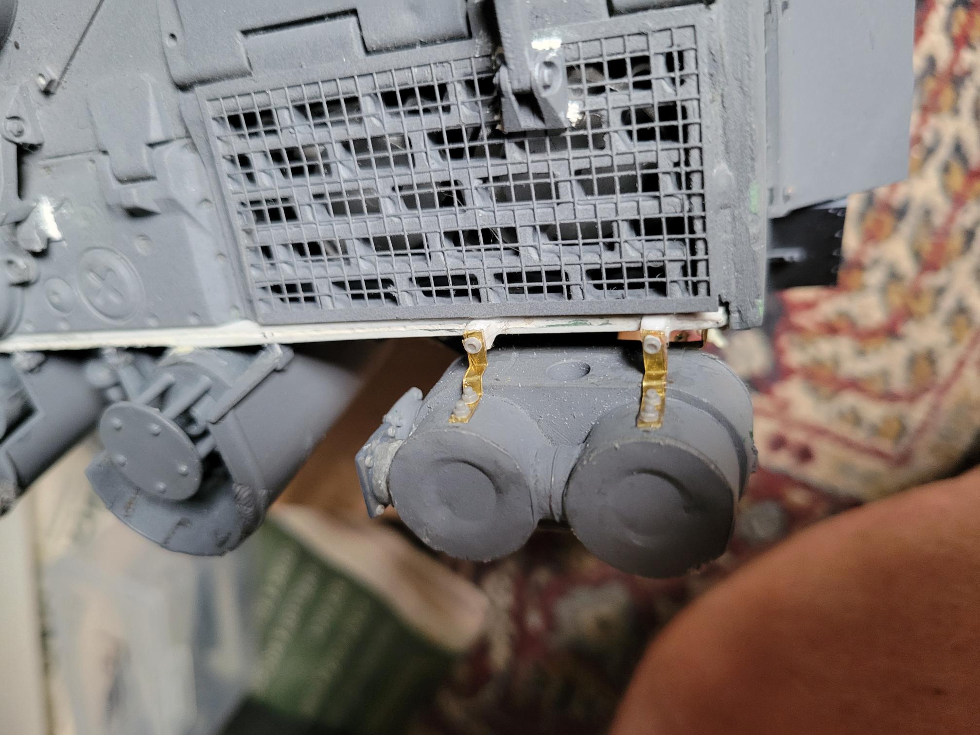

I have been doing a bit towards the Fiefel installation. Rear Filters finished and now test fitting the Fiefel tubes that I had printed to my information by a seller on Shapeways when it still existed. Getting it all to fall into place will be a test of patience but its coming together.
Lots of sanding glue debris and tidy ups to do yet but getting there.

Those are nice Mr Froman, a clever touch.
Feifel tubes are an often overlooked but signature mark for Early Tigers

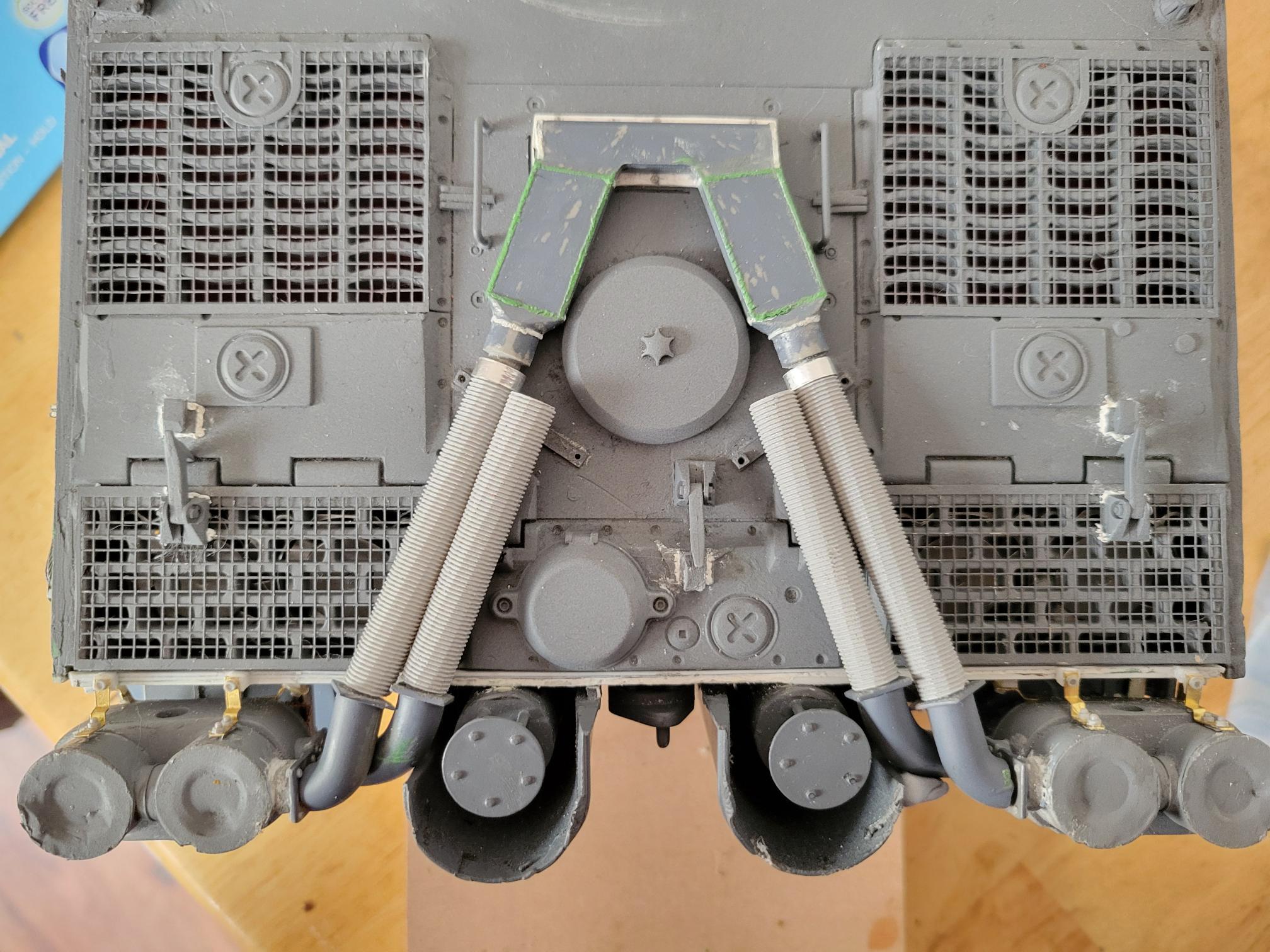

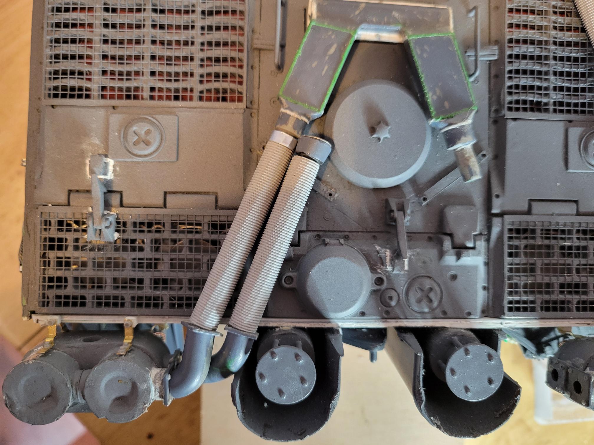

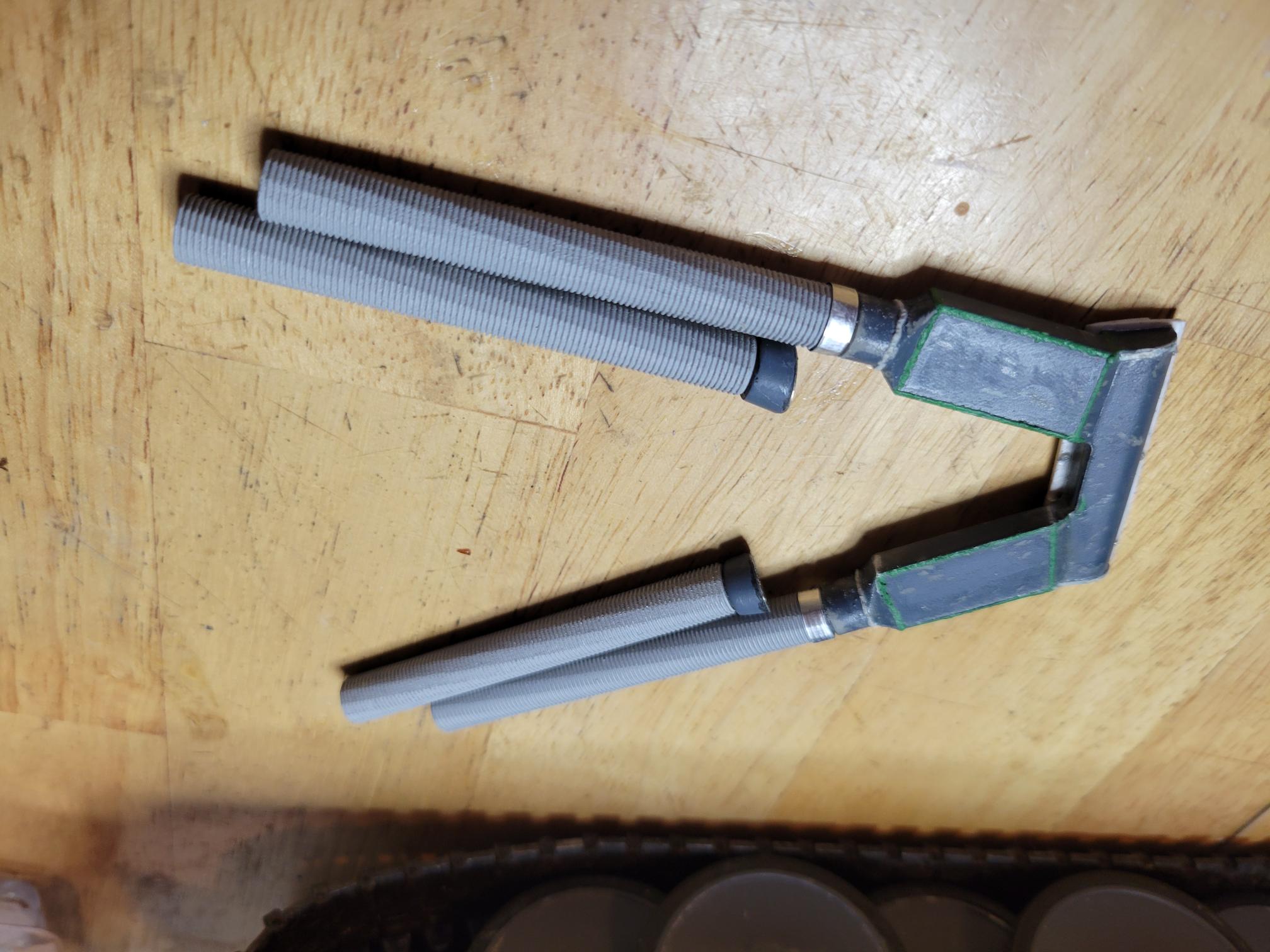

These views bought to you by the power of blu Tac :D
Still have the clasps to fit then can glue it all in place and start on th bracektry to hold the 12 sided tubes in place. I am hoping to achieve a fair bit this weekend.
Thanks for dropping by.

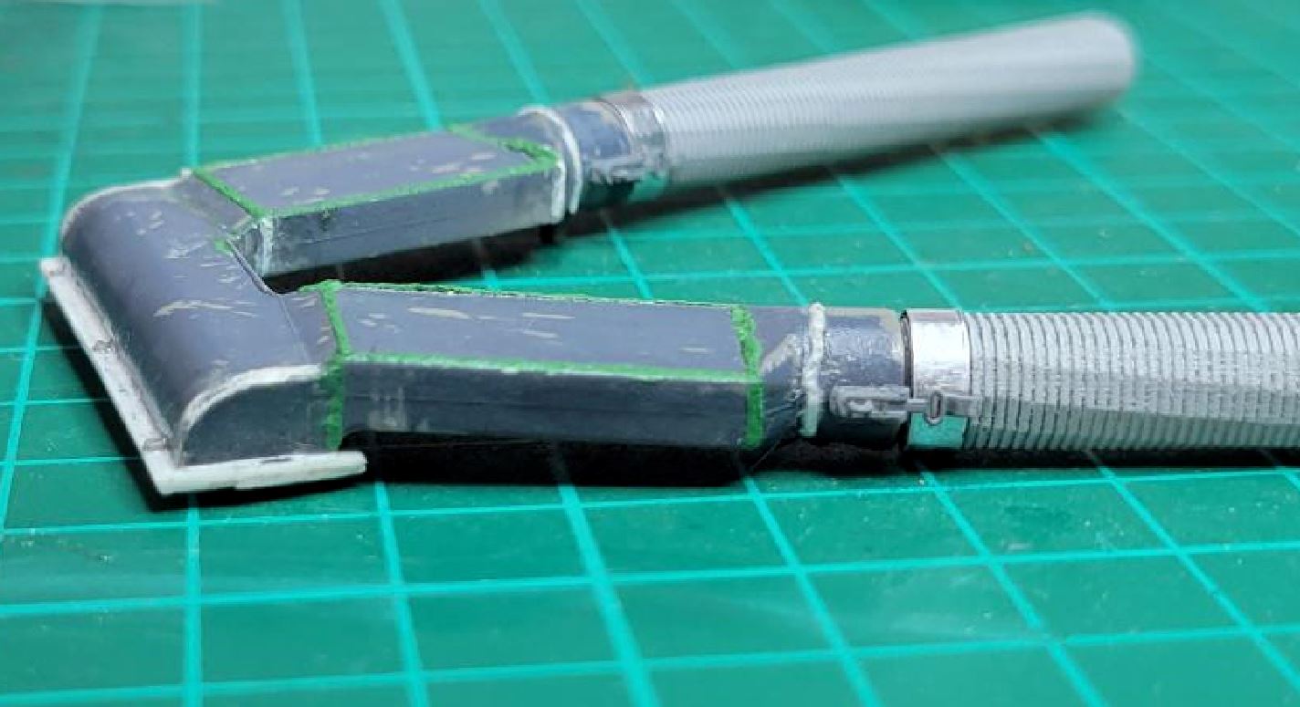

Using the "ABER" PE kit I wrapped it around a pencil then painted a line of liquid solder along the join and gave it a gentle sweep with my Dremel butane torch,
The multi sided tube formed before my eyes.

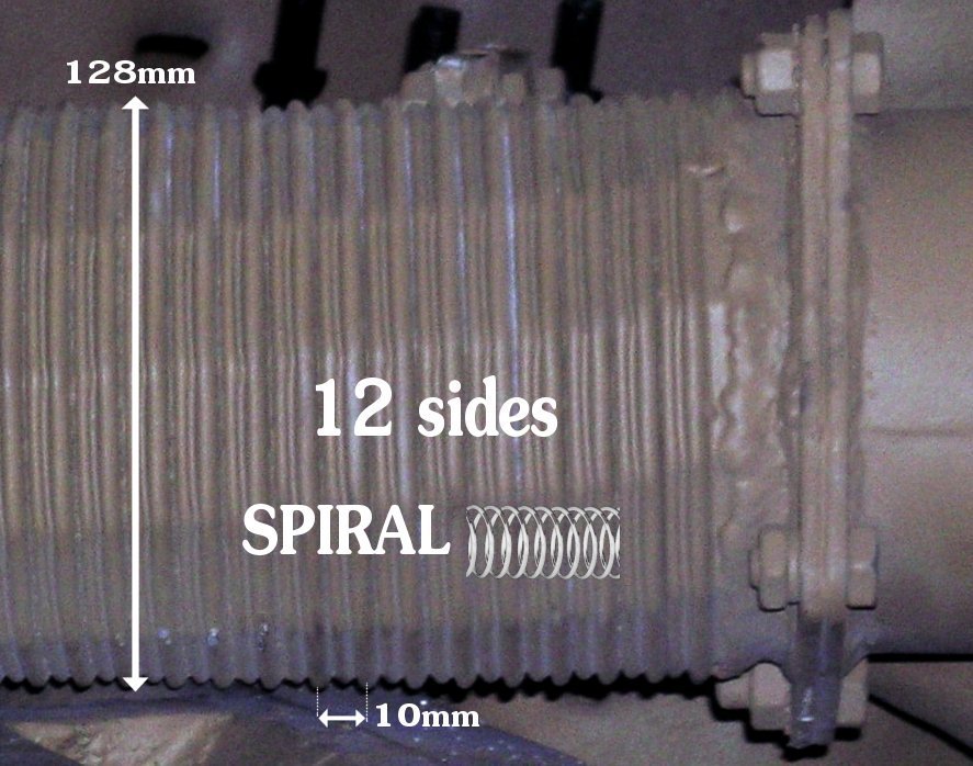

Jarndice, i thought about the Aber but it woudnt have the twist in the 12 sides so went with approached a WW2 Shapeways chap. After his first attempt, he tweaked it until i was happy it matched the photo thats out there. Might have been from David Bryden s Tiger.info site.

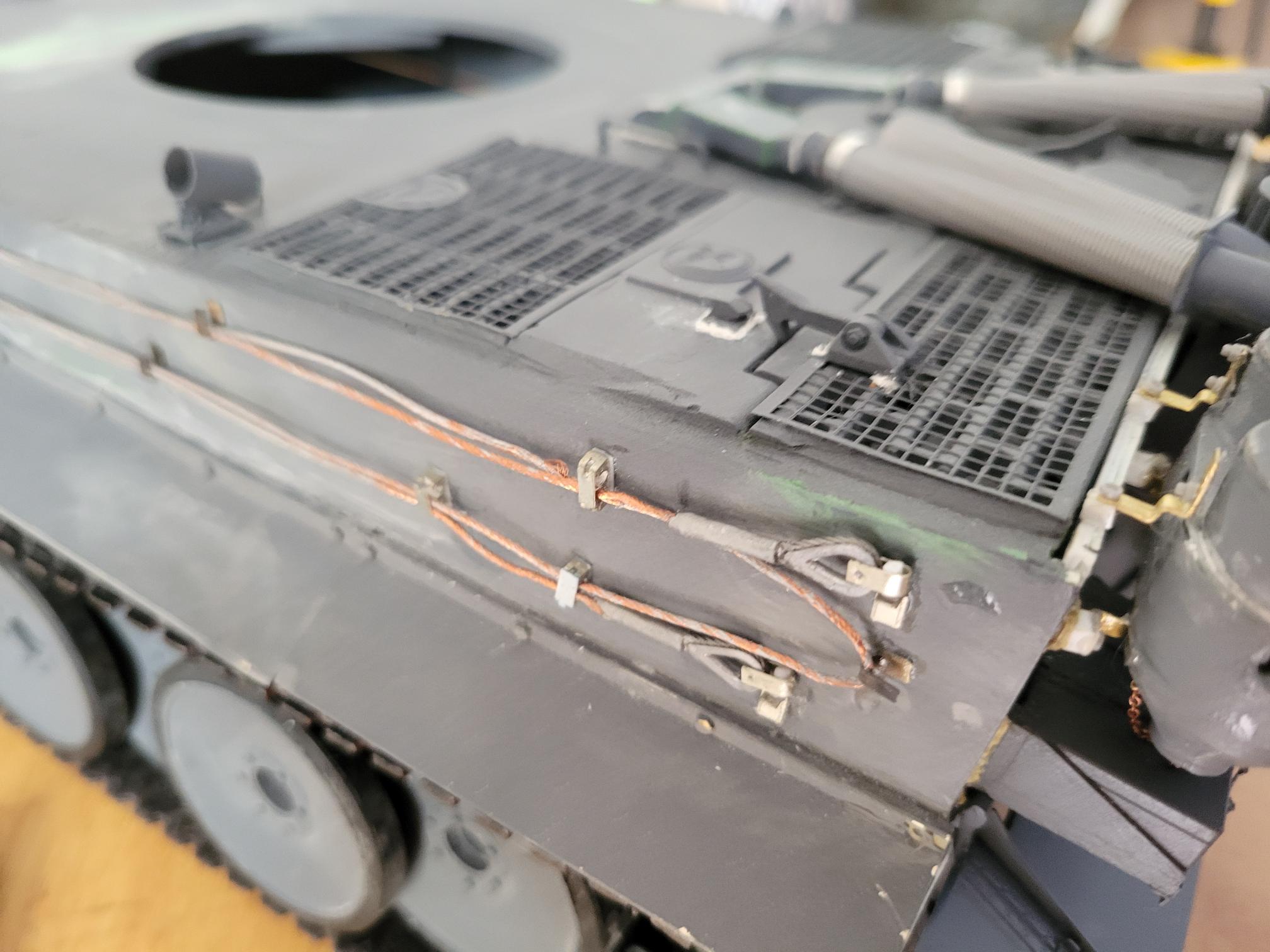

Retaining clasps on. Quick tidy sand and then try for fitting. Wich me luck.

Those are some excellent clasps and tubing. I saved a bunch of pictures of the real stuff ferr reference on all that spaghetti mess somewhere but you definitely don't seem to need it. But I do remember a conversation I don't recall if Mr. Byrden was a part of though, where it's labeled "spiral" I remember as interlocking piping with a specific flow direction.
