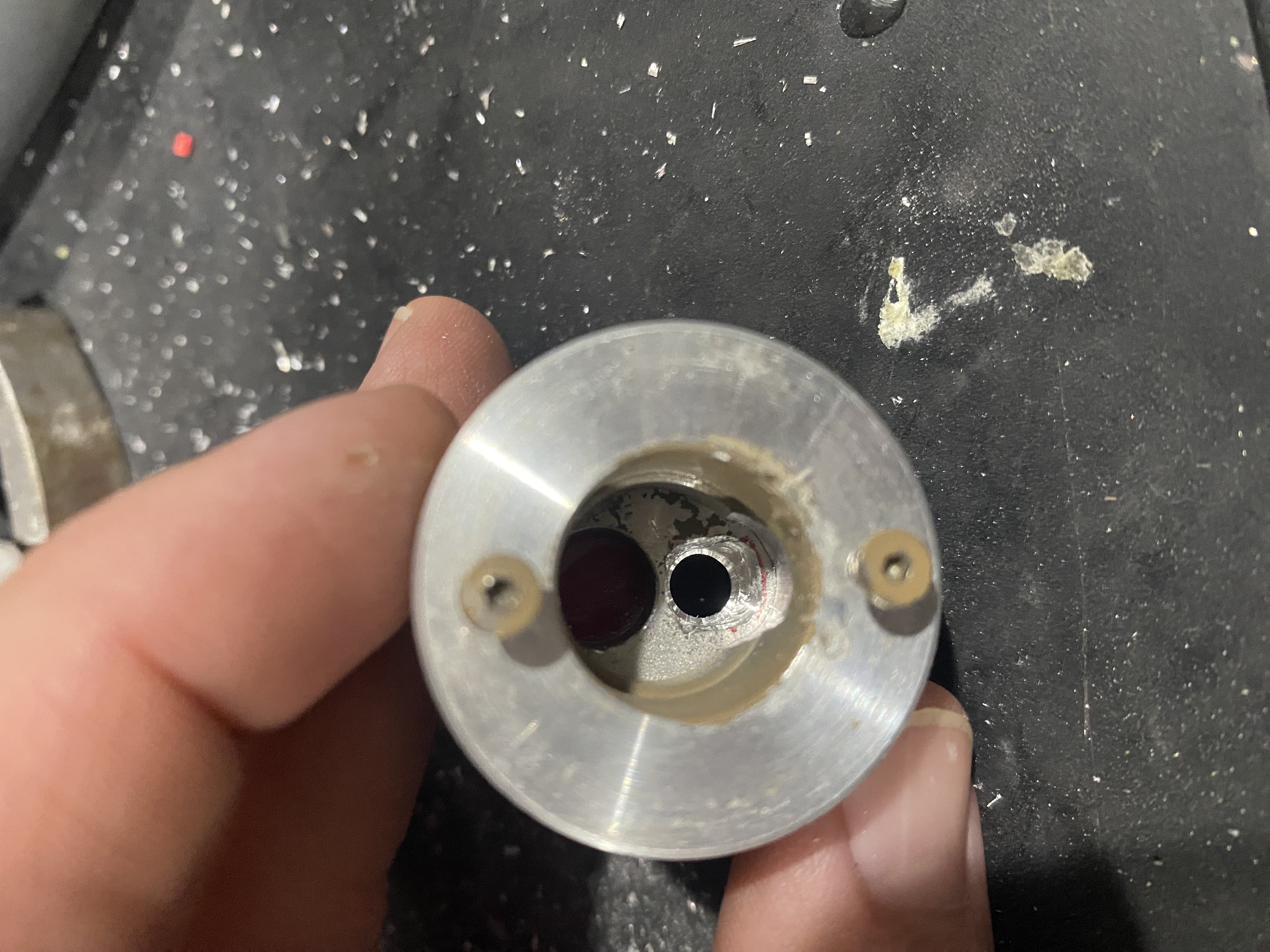

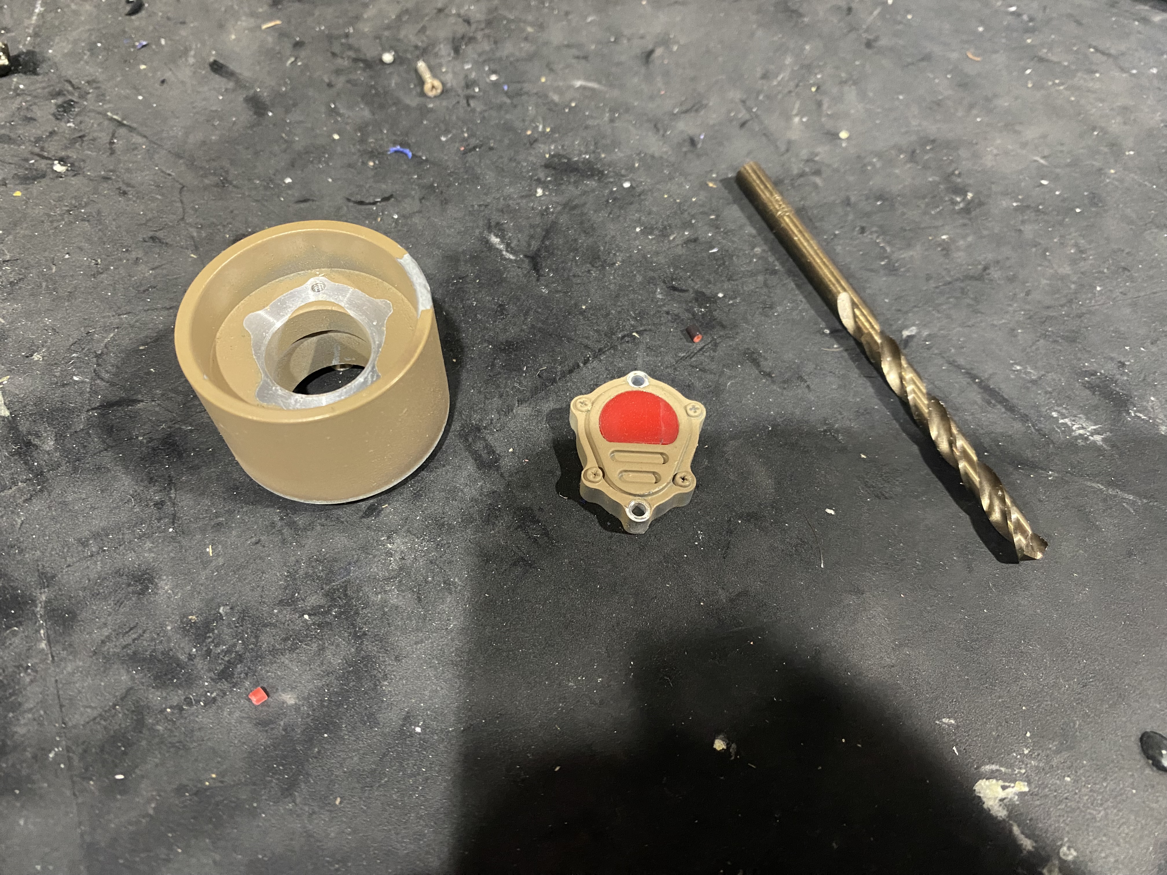

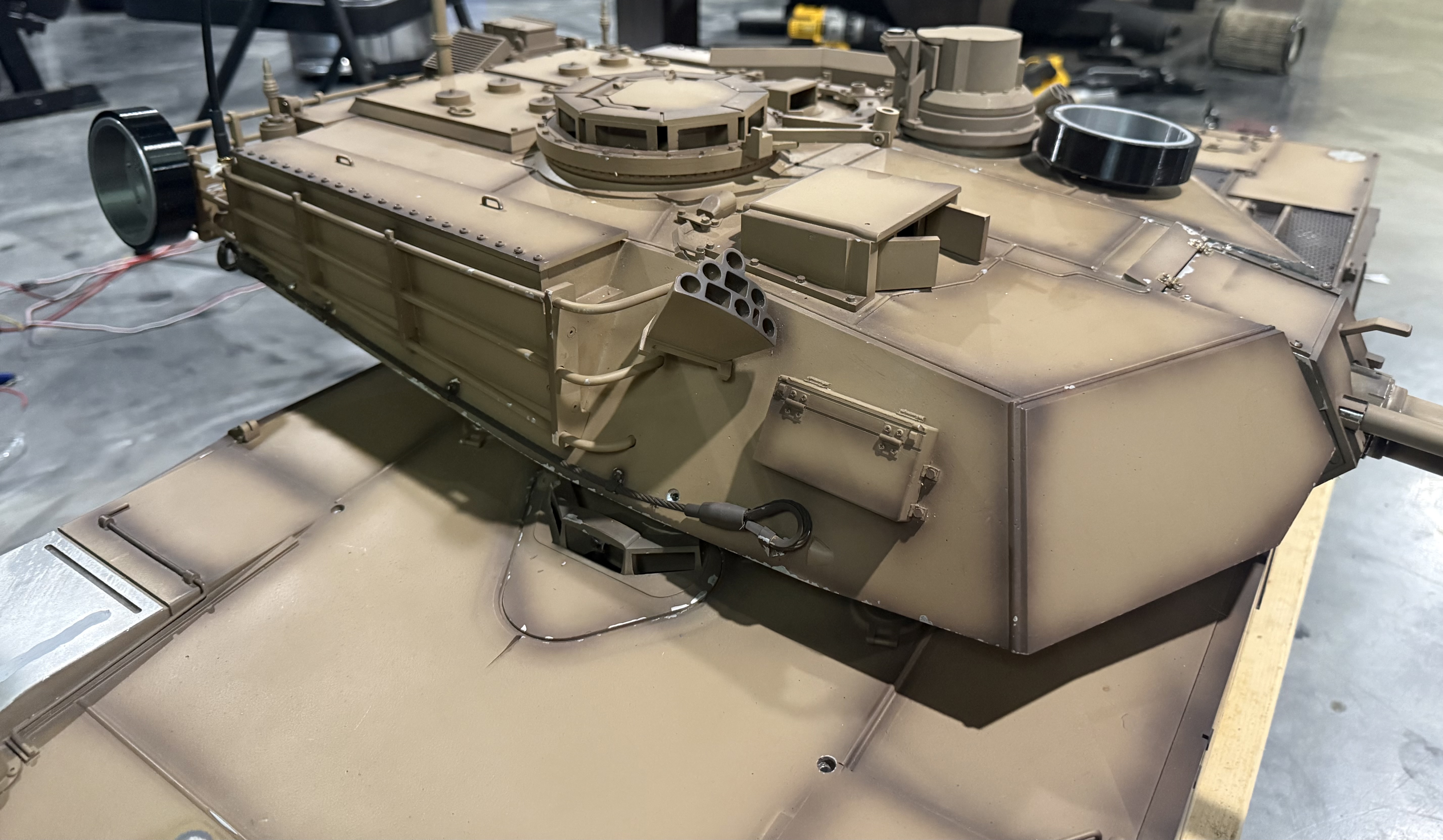

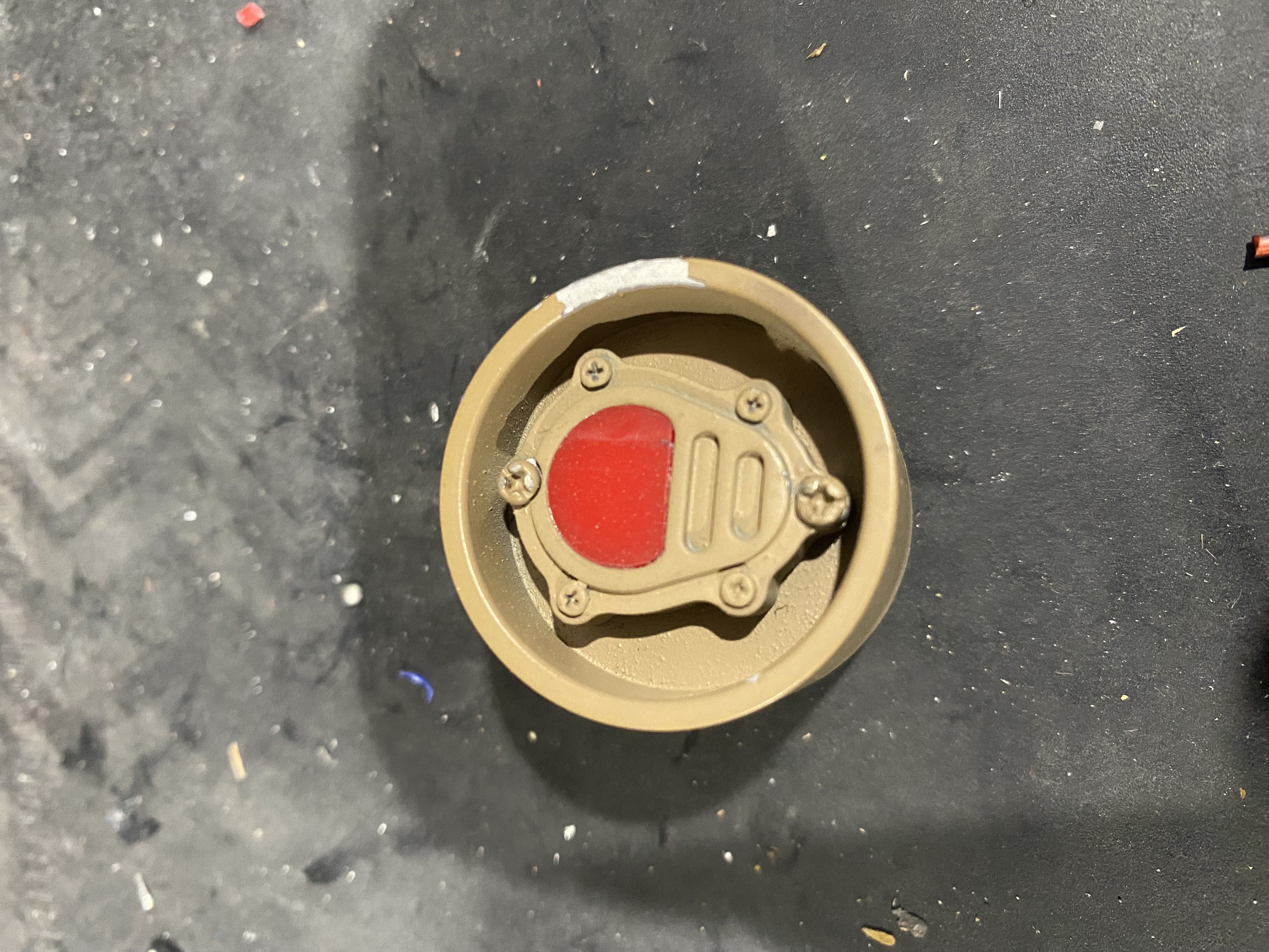

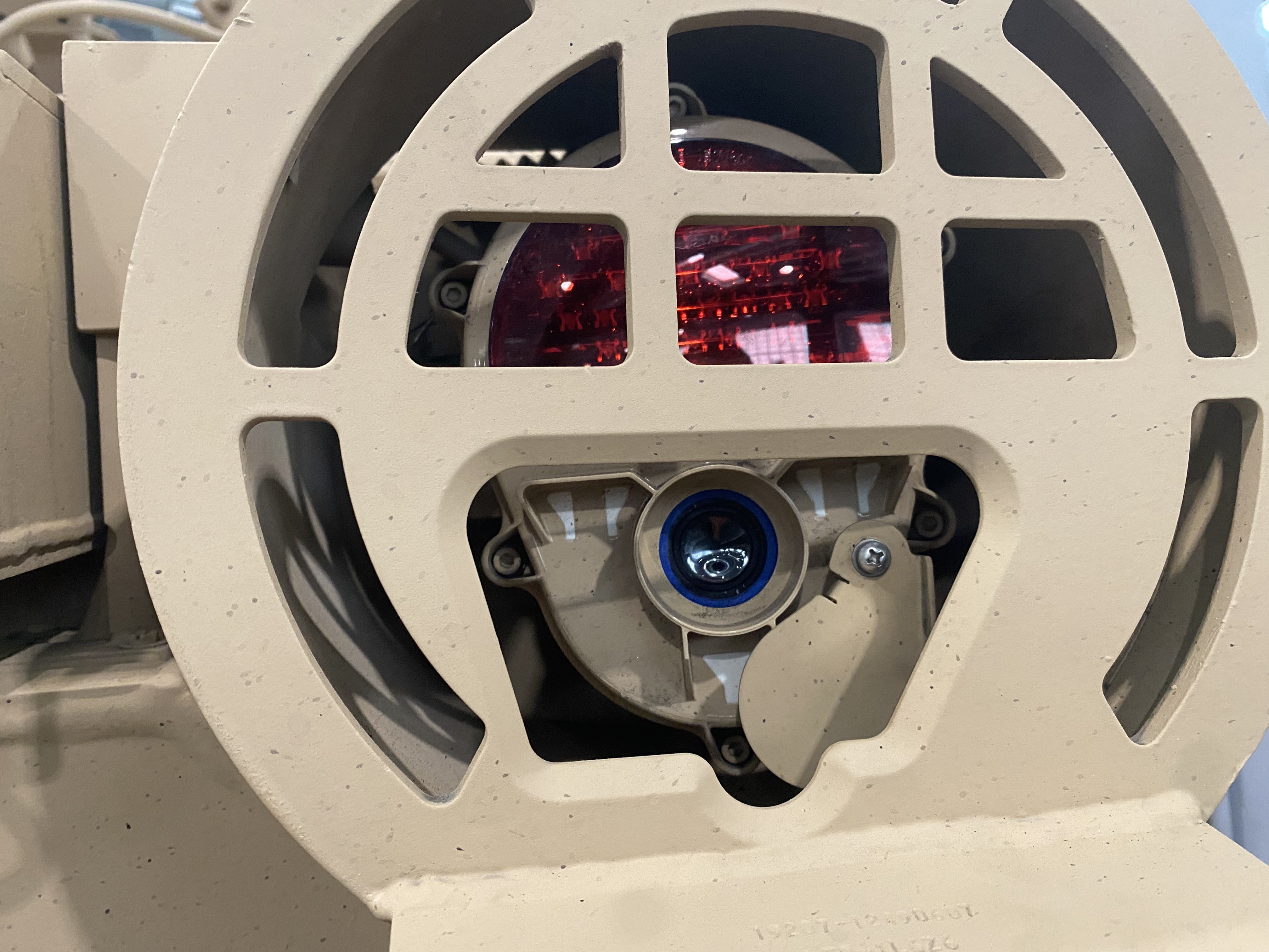

Finally getting around to putting a camera in the starboard rear tail light.
Used a 5mm drill bit on a drill press to try to get the hole in the center. Used a 6mm drill bit on the press to open up the inside some. Used some dremel bits to clean out the inside hole, try to square it out some. Used a pointed dremelt bit to try to delete some of the raised parts on the outside of the tail light.
Hot glue to secure the camera how I wanted it. Camera is the TBS Ultra Tiny Camera. Here is an example of the resolution from an older video I did with my 1/16 scale Tiger I. It’ll probably be a while before I get this one plugged in and running.
Next up will be putting one of these in the middle drivers periscope slot. Should be much easier and not require any modification.
I know this modification is not ideal, but the layout is similar. I’m getting a 3D printer over the summer, so redoing this will probably be one of my first projects on it.

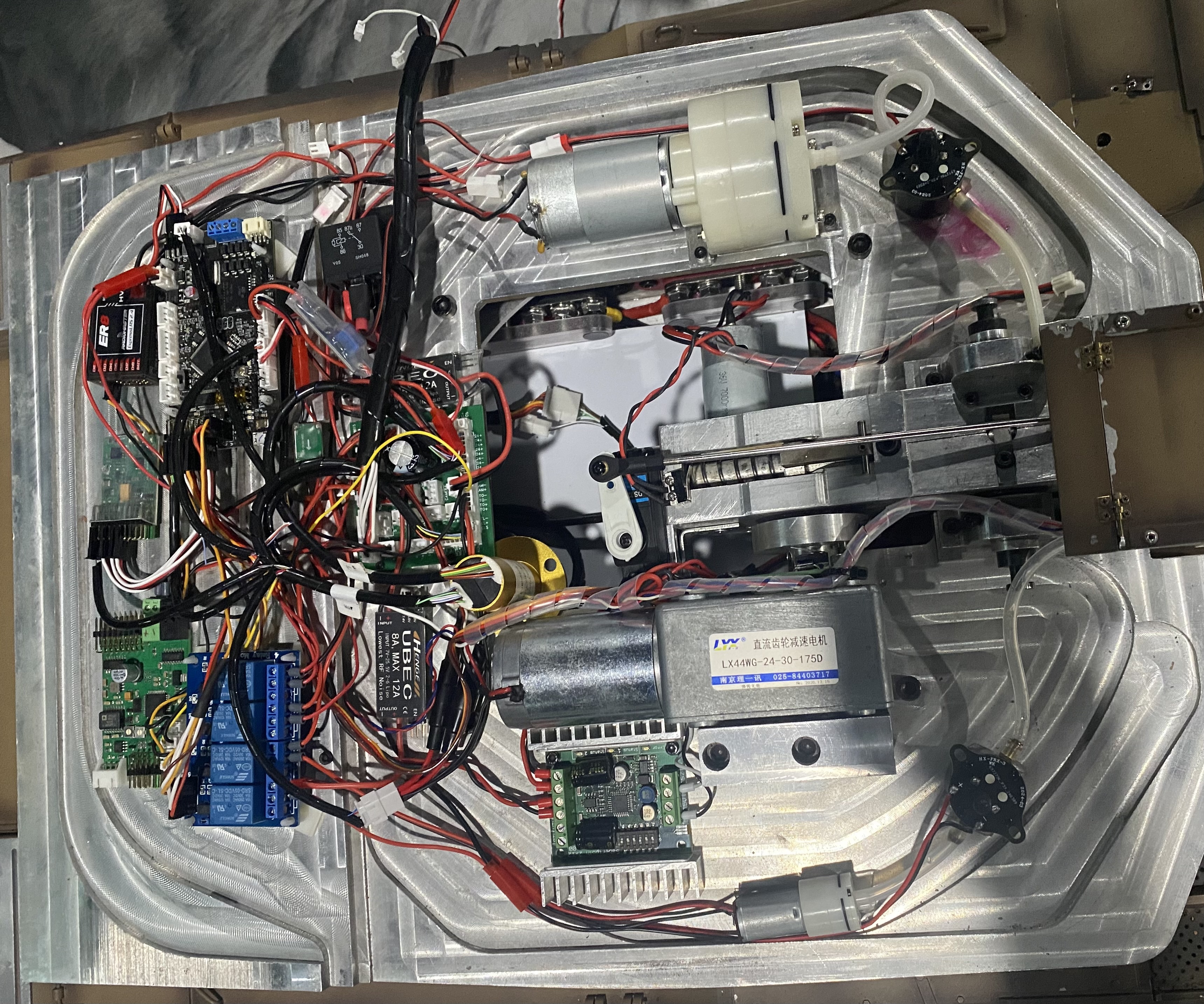

The wiring in the chassis is done. Next step is going to be putting the top of the chassis on, plugging everything in (FPV VTX, two smoke heaters, two blowers, gun stabilization unit/traverse ESC, elevation ESC) to see how many amps I am going to be drawing through the slip ring, before installing the slip ring.

Update time, she lives!
https://youtu.be/Q_D0ySeJ_Os?si=fG5YFYvkMeA_M3OV
At this point I have replaced the stock HL TK-8.1 with a variety of equipment:
Open Panzer Tank Control Board
Radiomaster ER8 Receiver
SGS B100 Dual Motor ESC
SGS TVC-GSU-12 Gun Stabilization Unit
DasMikro Mini Sound Unit
Cheap Amazon 100w Mono Amp
The tank doesn't look any different, and for the most part doesn't perform a whole lot different (the exception here being the sound, TX/RX range, and the turret stabilization), but almost everything under the hood is new. I plan on doing a video showing the difference on the inside in a while, but I'm doing some custom daughter boards first that should help me clean up the rats nests on the inside.
Future projects now are:
Hooking up DasMikro Mini V3 (Benedini V2 clone), it has an amp port!
Cleaning up the rats nest inside with some custom daughter boards.
Replacing the standard 1/16 scale air pump and oil heater used in for the 120mm with the leftover 1/8 scale air pump and oil heater.
Fixing/replacing the VTX to get the cameras running again.
Putting a camera in the gunners auxiliary sight and the dog house.
Buying a better speaker and making a custom speaker box.
Moving the gun barrel control from ESC/motor to servo so I can use the gun barrel stabilization on the GSU-12.
Attaching the LPCROWS unit.
Rigging the doghouse doors to be operated by servos.
3D print detailing.
Paint.
Got a lot left to do, but sure feels nice to have it running again finally.

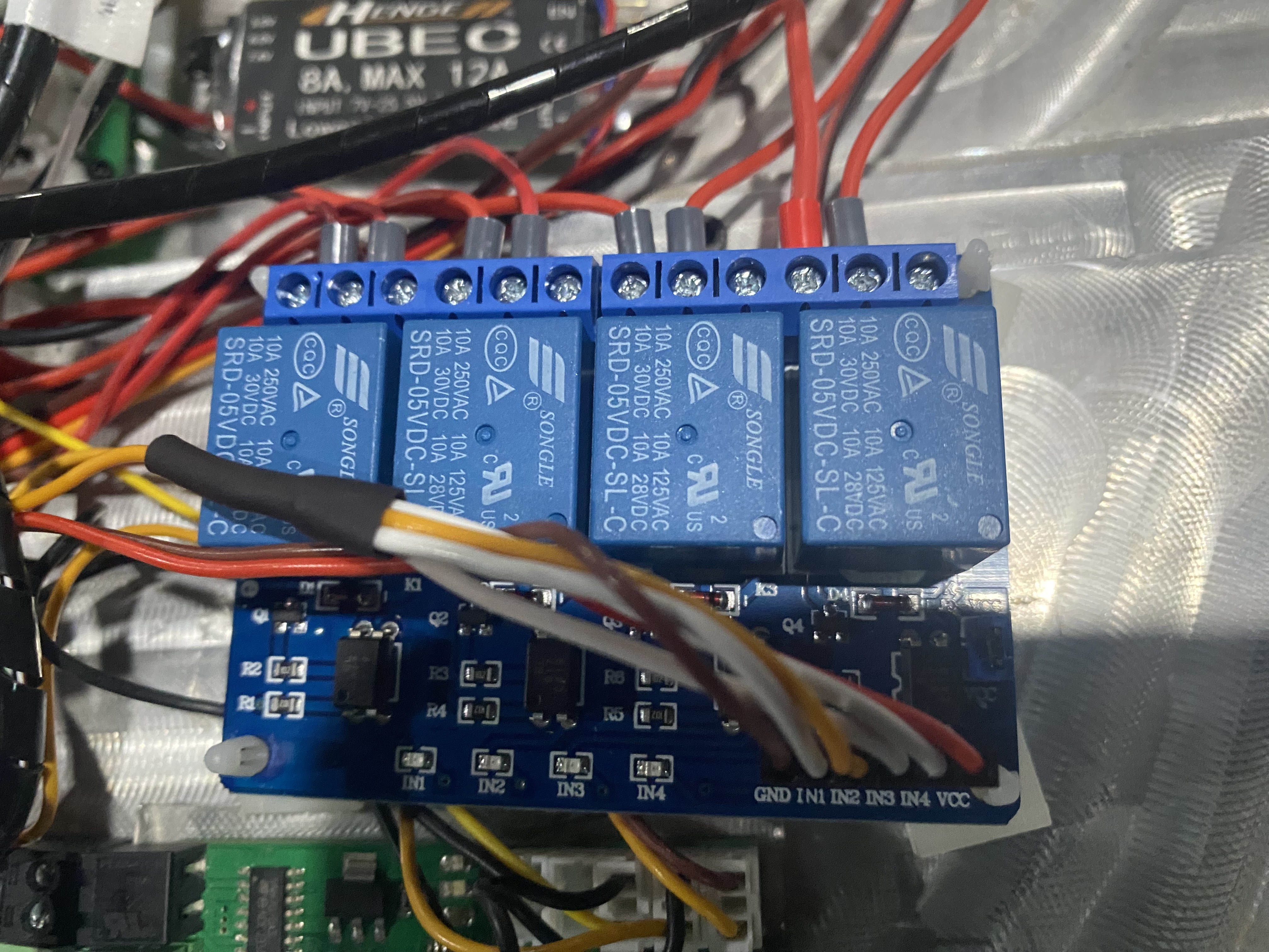

Installed a 4 channel 5V relay today. With the flick of a switch this turns off the two heaters for cannon and machine gun smoke, and prevents power from going to the air pumps when the relay is off. That way when I’m just testing things or when smoke isn’t important I can just turn it off from the TX, save some wear and tear on the gun smoke components and smoke oil.
Also installed the knock off Benedini Micro V2 and it worked like a charm. Now I don’t have to have a second battery just for the amp, I can just run it off the main power.
Next up is hooking up and mounting an 8.4v high torque servo for elevation so I can use my gun stabilizer for both elevation and traverse.
Please don’t crucify me over my rats nest. I promise I’m going to fix it soon. I know it’s bad.

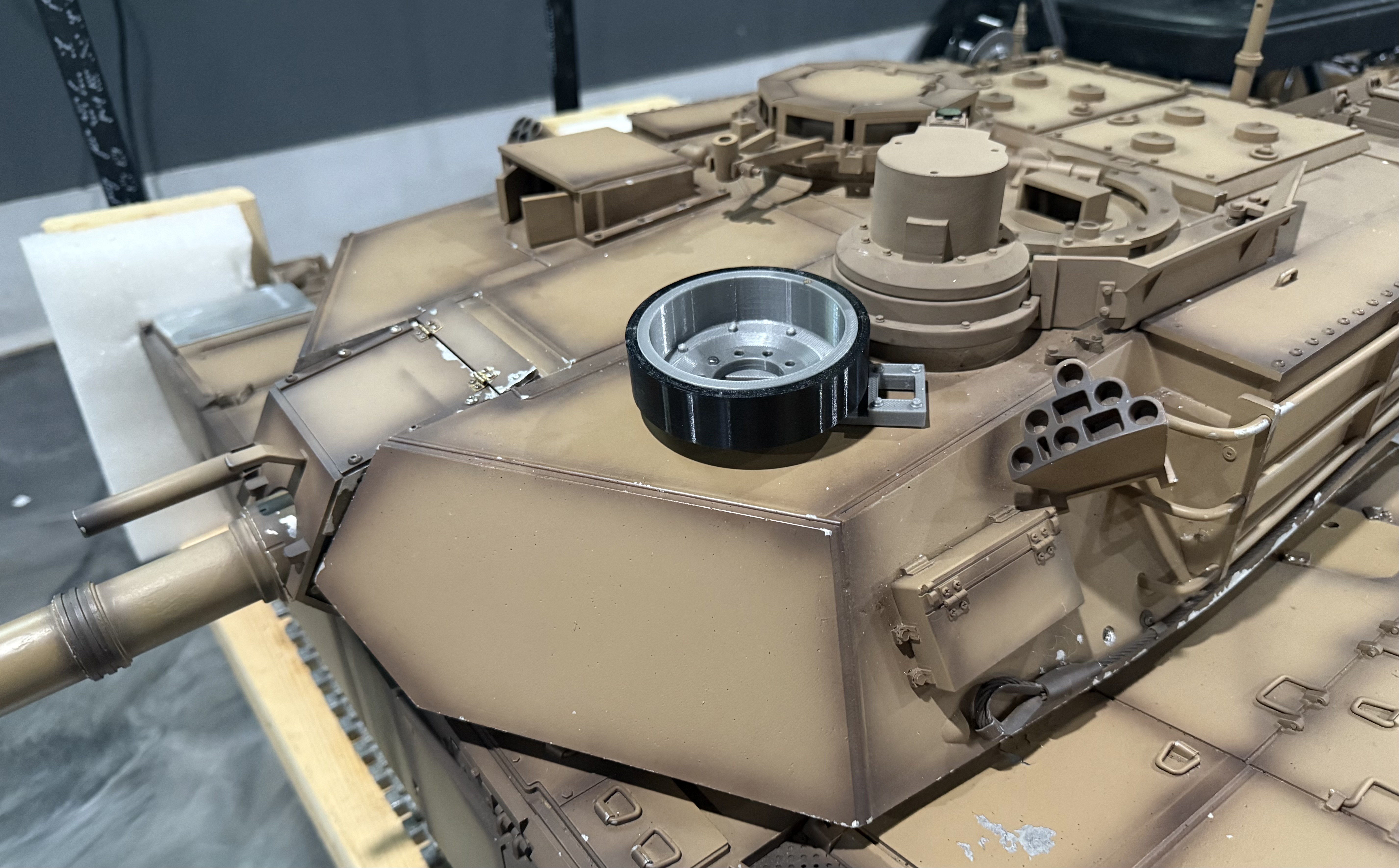

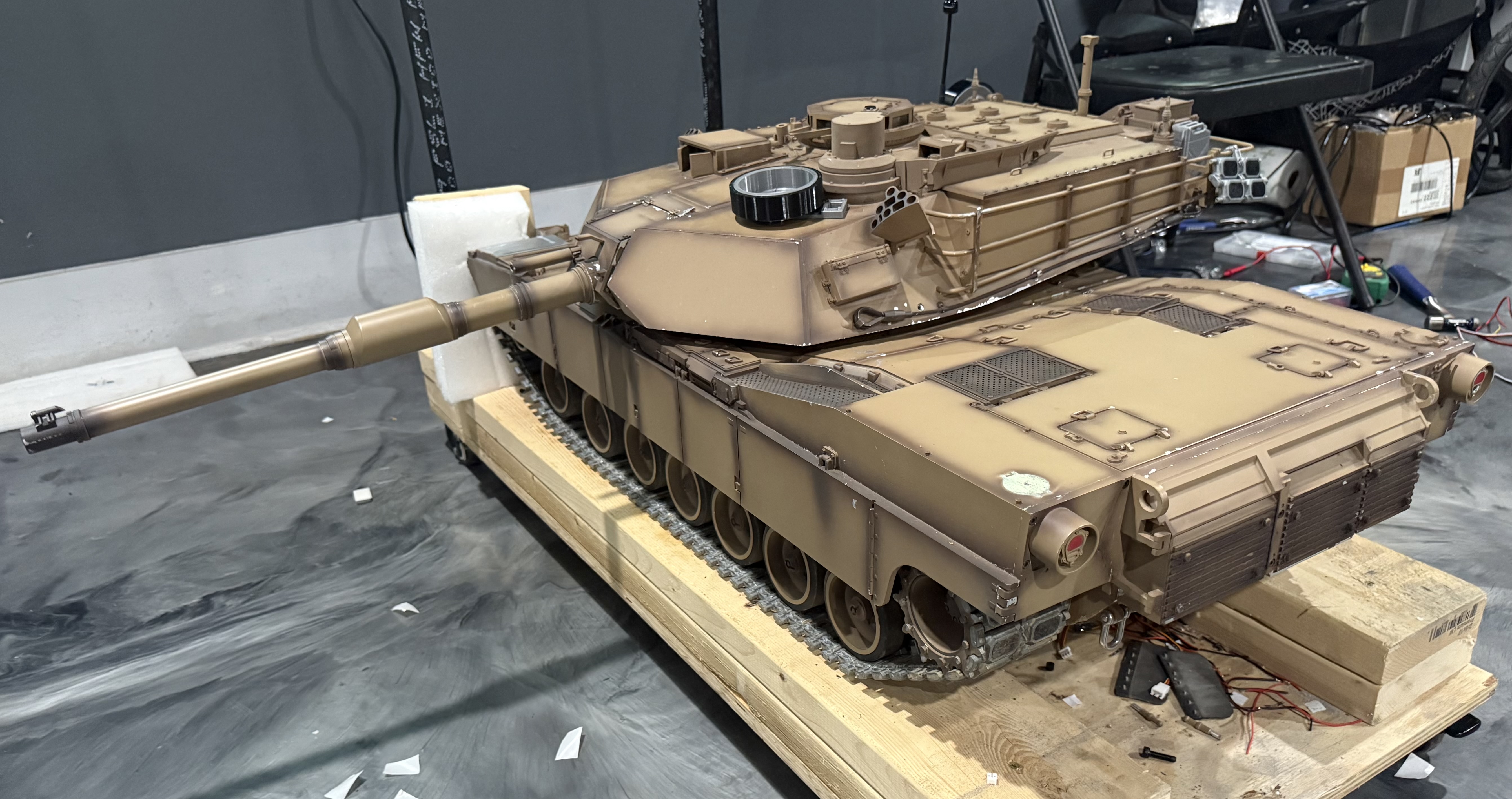

- Putting the 3D printer to work making some bells and whistles for my tank
- IMG_0134.jpeg (2.69 MiB) Viewed 824 times

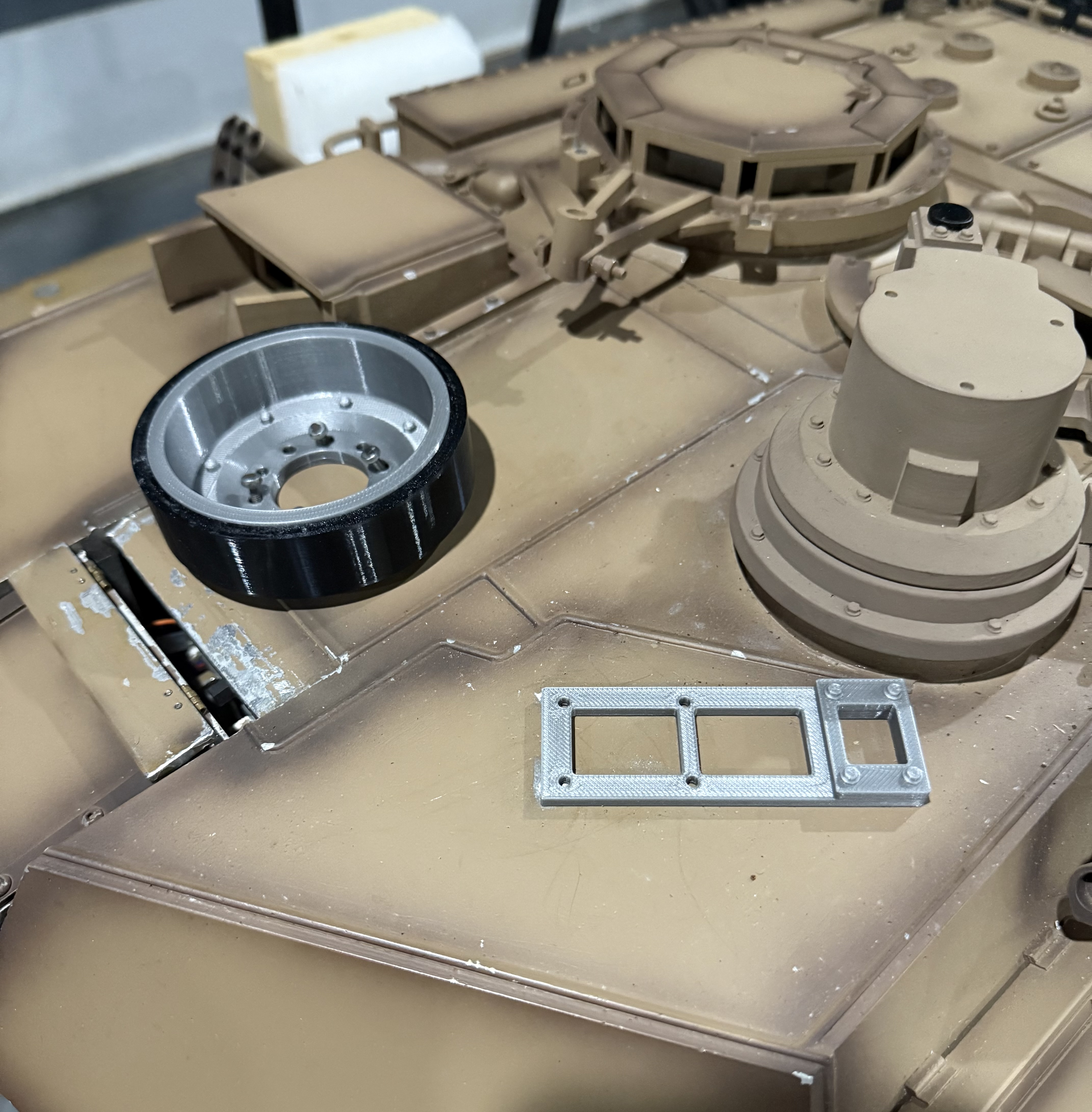

- Spare wheel and rack. Rack was based off of the DKLMRC one, but I had to design my own because the holes for the spare wheel on the rack didn’t line up with the holes in the wheel hub
- IMG_0135.jpeg (2.96 MiB) Viewed 824 times
- Wheel was scaled up to 1/8 from 1/48, and also I split the tire from the hub and used TPU filament to make a more rubbery tire.
- IMG_0130.jpeg (2.72 MiB) Viewed 824 times

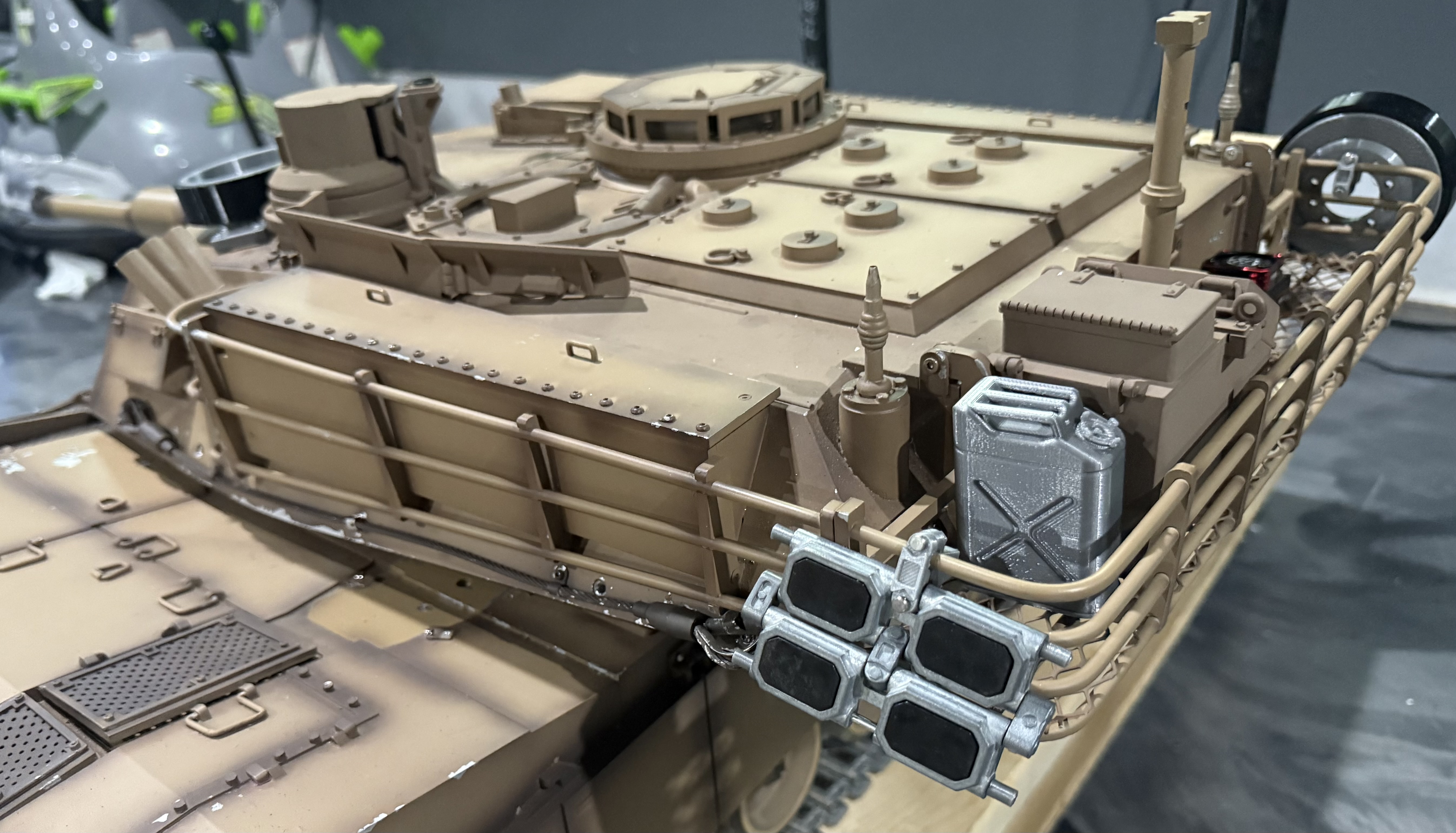

- I designed the track fin segments used to hold the spare wheel and tracks myself. Kind of made a hybrid design between the HL one and what the real one actually looks like. Also had to make the track pin hole in it large enough to attach to the bustle rack. Found a Jerry can online and scaled and printed that too
- IMG_0136.jpeg (2.75 MiB) Viewed 824 times
- Another spare tire
- IMG_0137.jpeg (2.84 MiB) Viewed 824 times

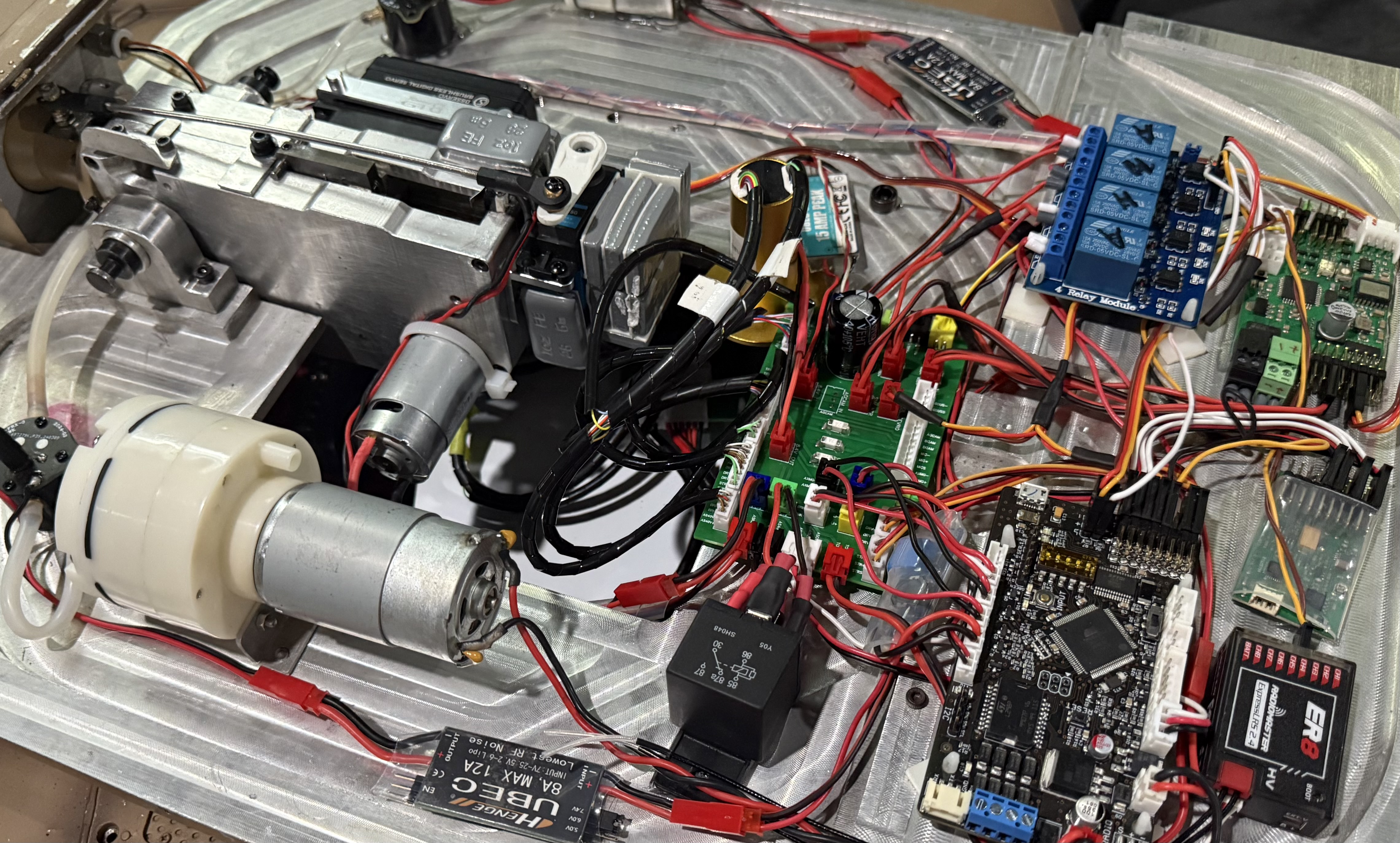

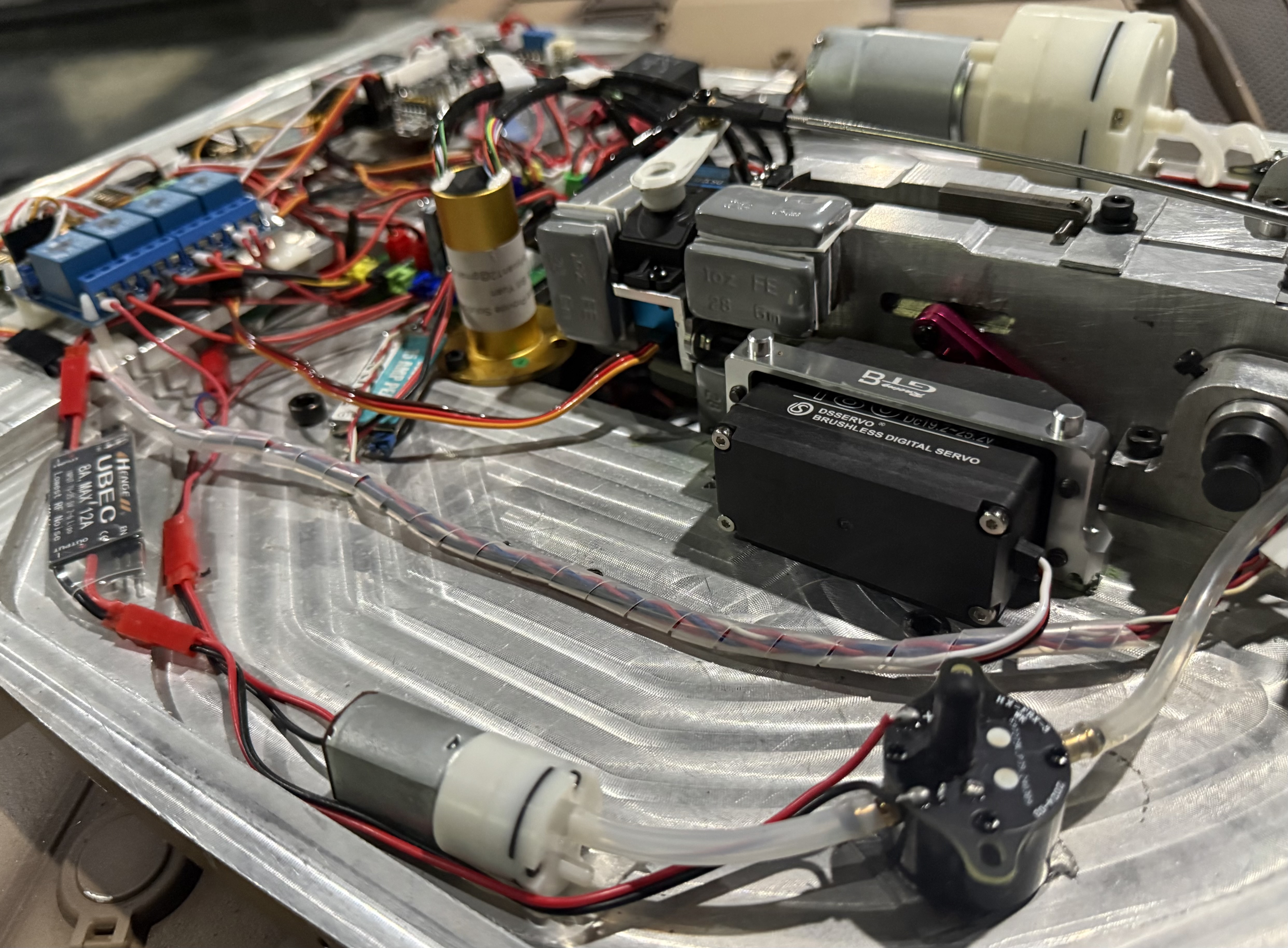

- Inside the turret, there’s a lot going on. It looks better now than it did a month ago, I promise.
- IMG_0121.jpeg (2.94 MiB) Viewed 824 times
- There’s my adhesive steel tire weights. Was trying to find something that fit in the space well that wasn’t lead. Ended up coming across these and they worked great. Ended up using 24 or so of them.
- IMG_0122.jpeg (2.11 MiB) Viewed 824 times

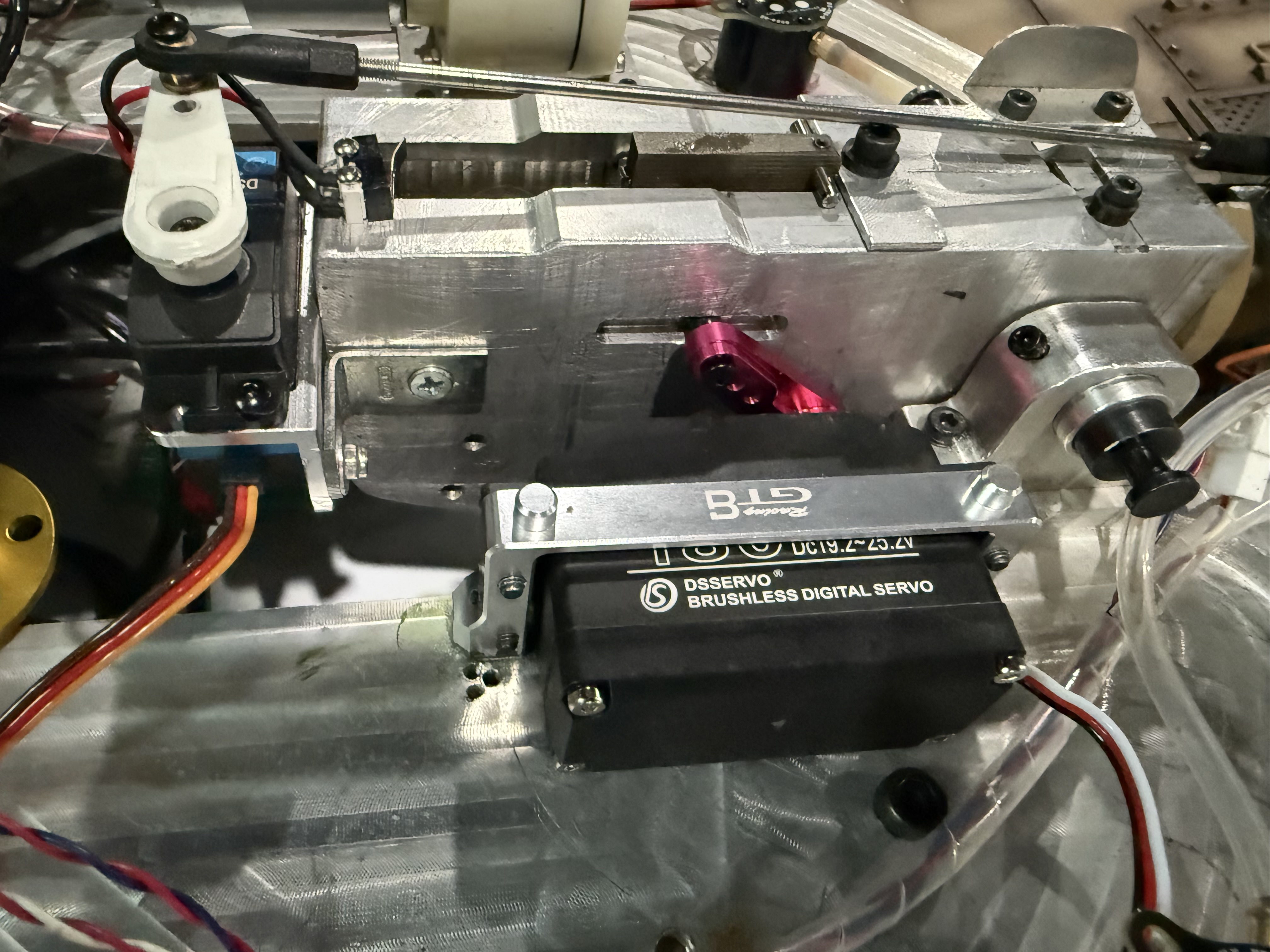

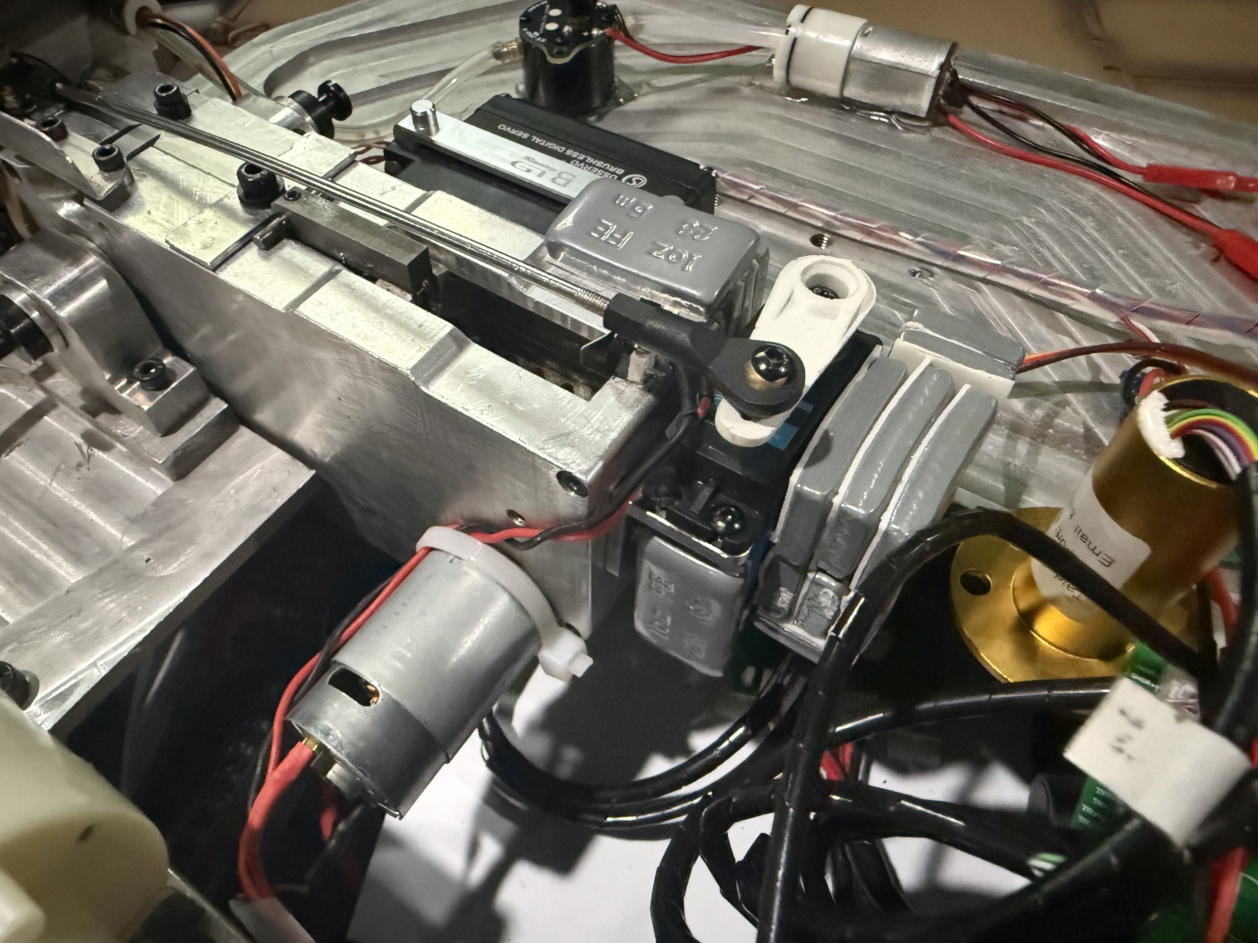

- That servo is no joke
- IMG_0123.jpeg (2.92 MiB) Viewed 824 times
- I think this servo and mount is originally for a 1/5 scale truck or plane
- IMG_0089.jpeg (2.09 MiB) Viewed 824 times

Wow! The view inside the turret is in itself amazing! And given the amount of wiring, a remarkable display of "wire control" neatness. Wow!
Re: 1/8 Scale HL Abrams
Thanks!
Yeah I tried to make it look as nice as I could, but there’s a lot going on. I might go back and wrap everything with wire covers once I get all the kinks worked out, but I’ve got a little more to do yet.
