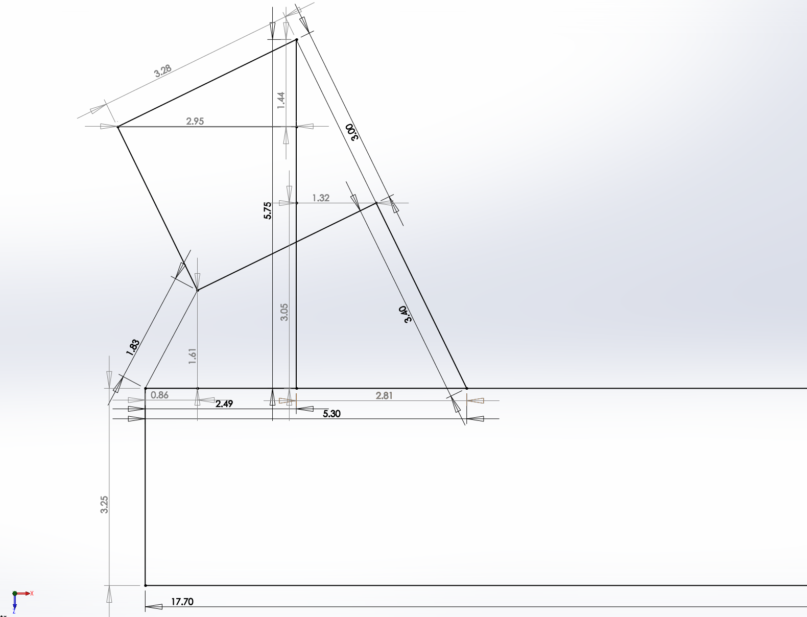

first thing first, now that I had my material I was using (some 0.2mm scrap tin sheeting) I could make the proper dimensions for what I needed to cut out, and prepare that in a drawing for me to follow;
- actualdims.PNG (168.71 KiB) Viewed 2541 times

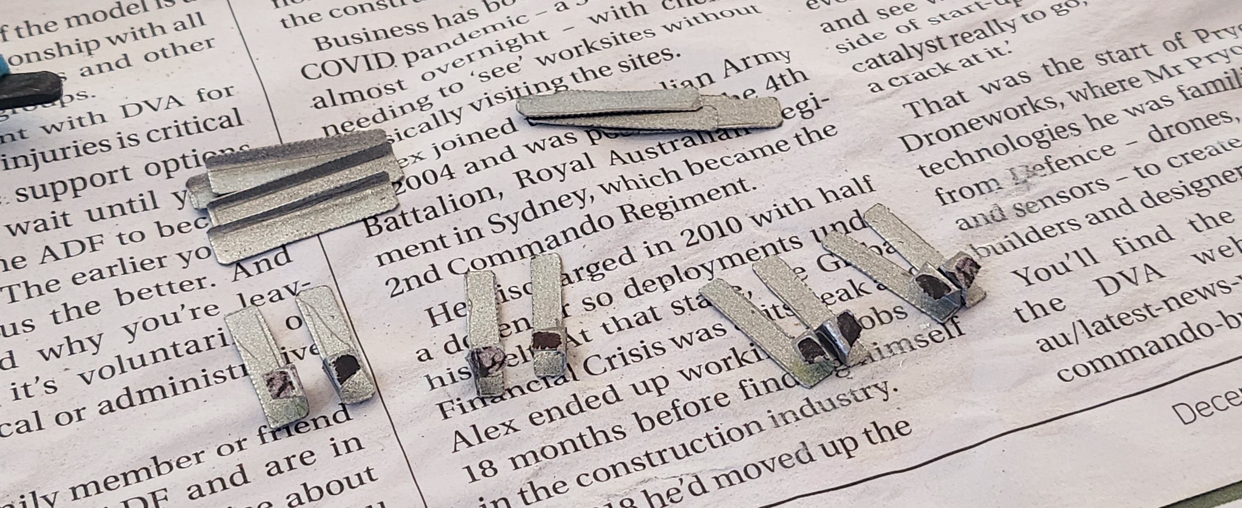

And with that drawing, I cut out and bent my little brackets to shape.
- 20250524_110331.jpg (1.22 MiB) Viewed 2541 times

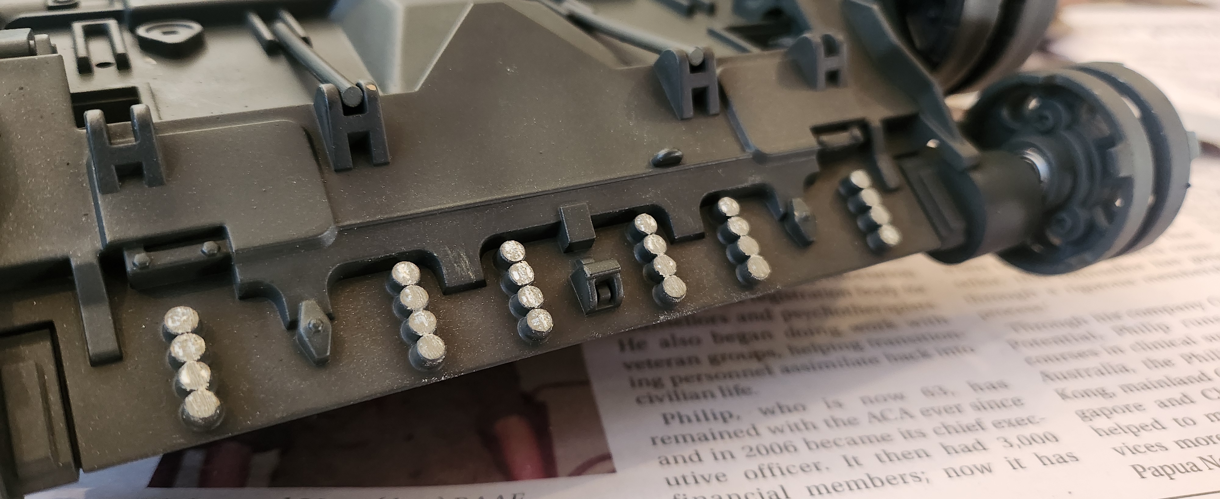

With that, I first cut off the bold heads of the bottom of the tank, and sanded them back;
- 20250524_103722.jpg (1.91 MiB) Viewed 2541 times

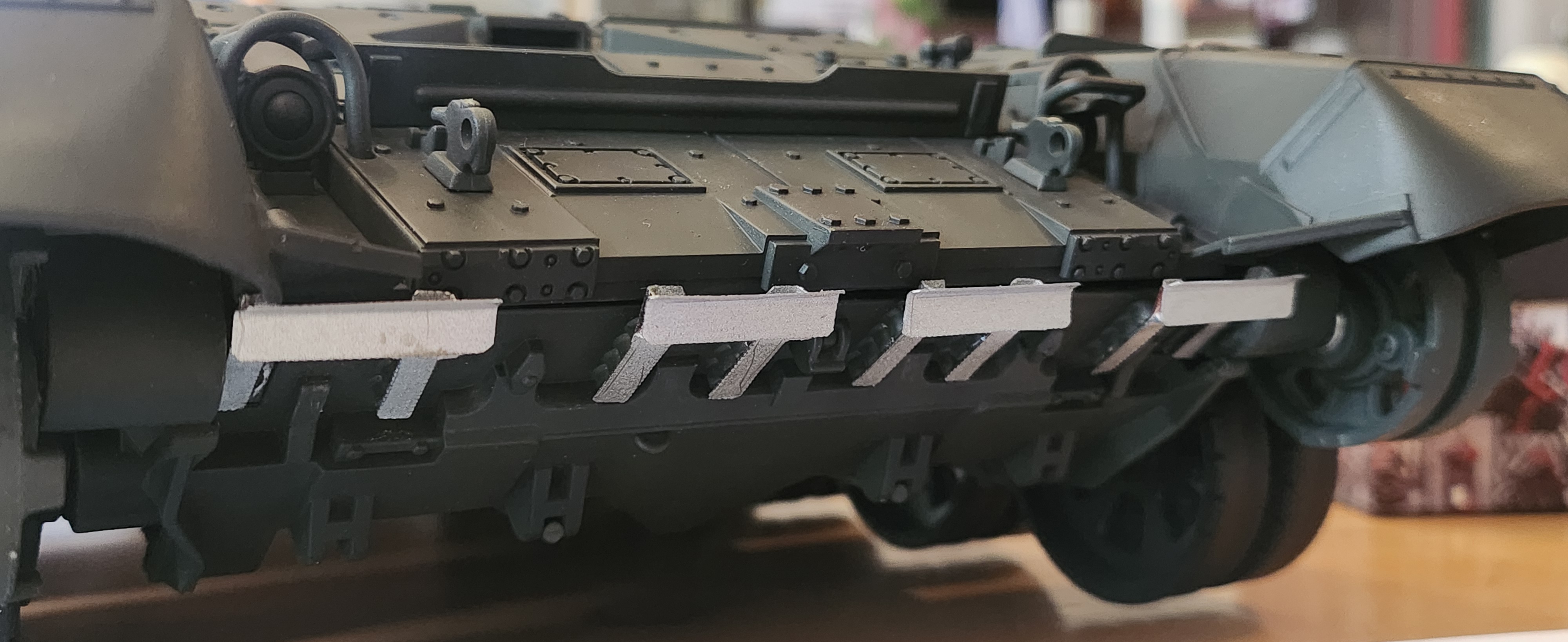

and assembled these on the underside of the tank like so;
- 20250524_122050.jpg (1.25 MiB) Viewed 2541 times

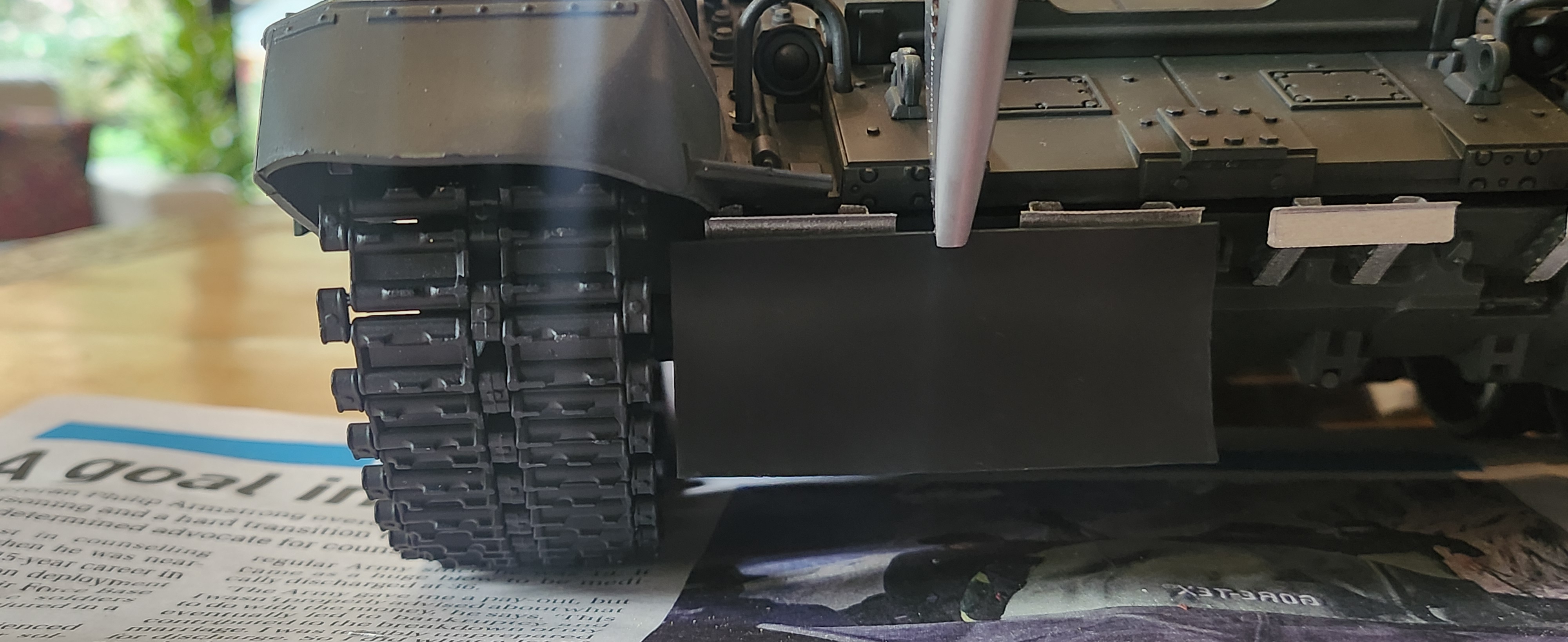

I will do some cleaning up sanding, and paint these before I permanently mount the rubber, but I wanted to test fit and cut the rubber to size so that it is ready to go asap.
I had measured based off the real tank's dimensions for the rubber, and the bottom parts looked fantastic. However, on the top, the measurements I had were too wide, so i needed to trim them.
I mounted the track temporarily to check the gap between it and the skirt, there is a pretty scale accurate clearance between the skirt and the track, but I am concerned that on the model when running off-road, this might get caught with the assistance of some FOD.
- 20250524_122719.jpg (1.12 MiB) Viewed 2541 times

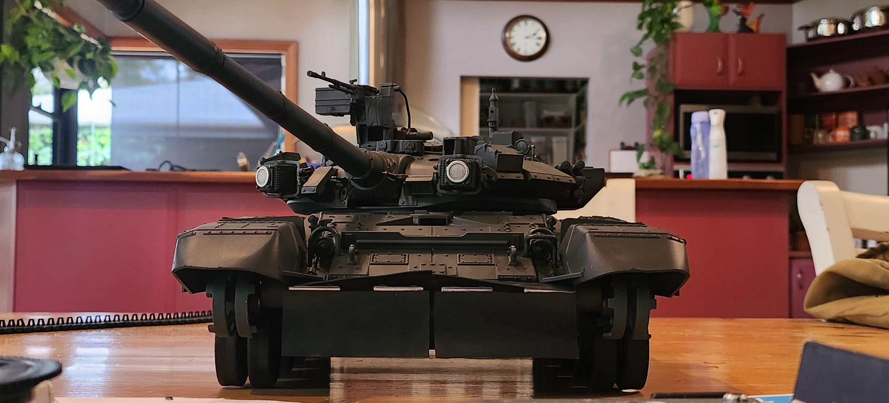

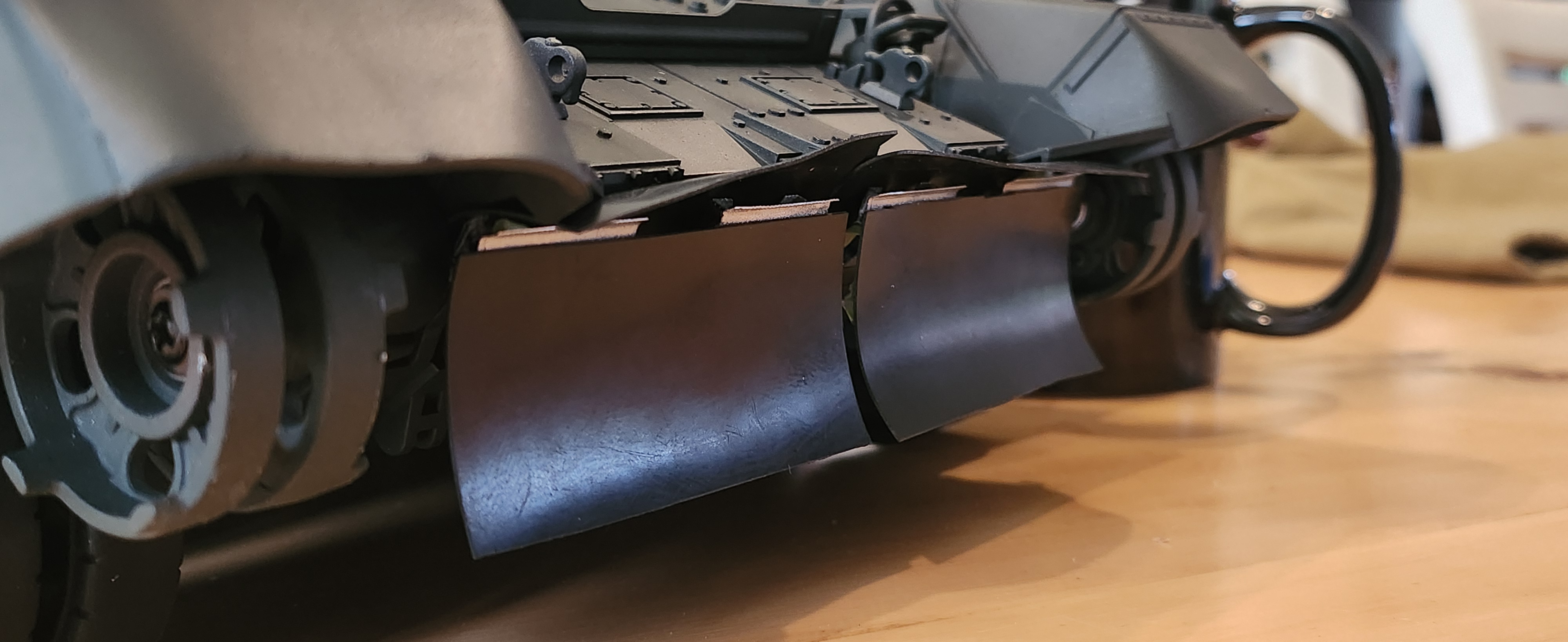

After cutting them all to scale, I thought a dry fit was in order, I used some masking tape to hold them on temporarily, and wow; I'm very happy with how it looks so far!
- 20250524_135420.jpg (1.1 MiB) Viewed 2541 times
- 20250524_141534.jpg (818.05 KiB) Viewed 2541 times
There are the face brackets that the rubber is held between also, and they will be mounted after the painting is done.
