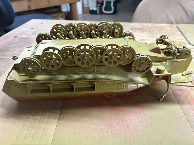

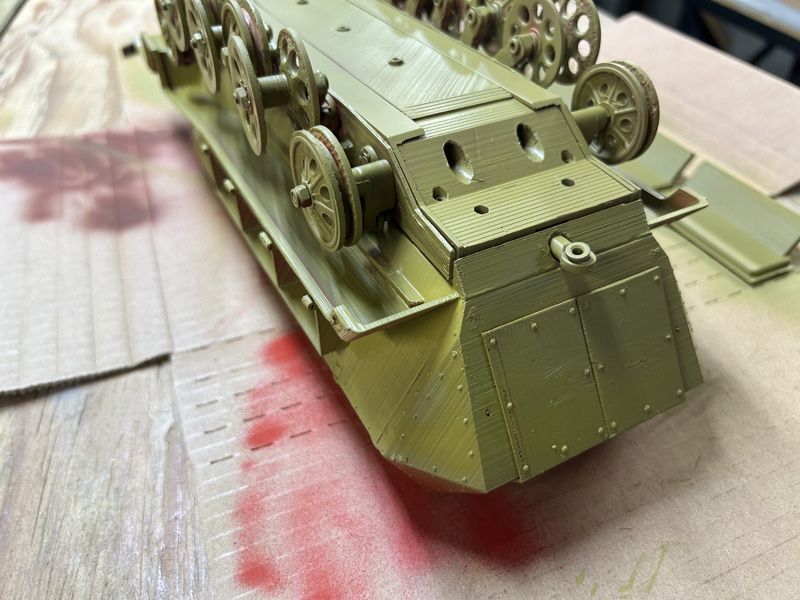

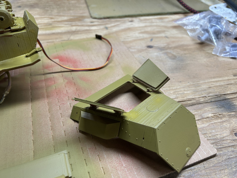

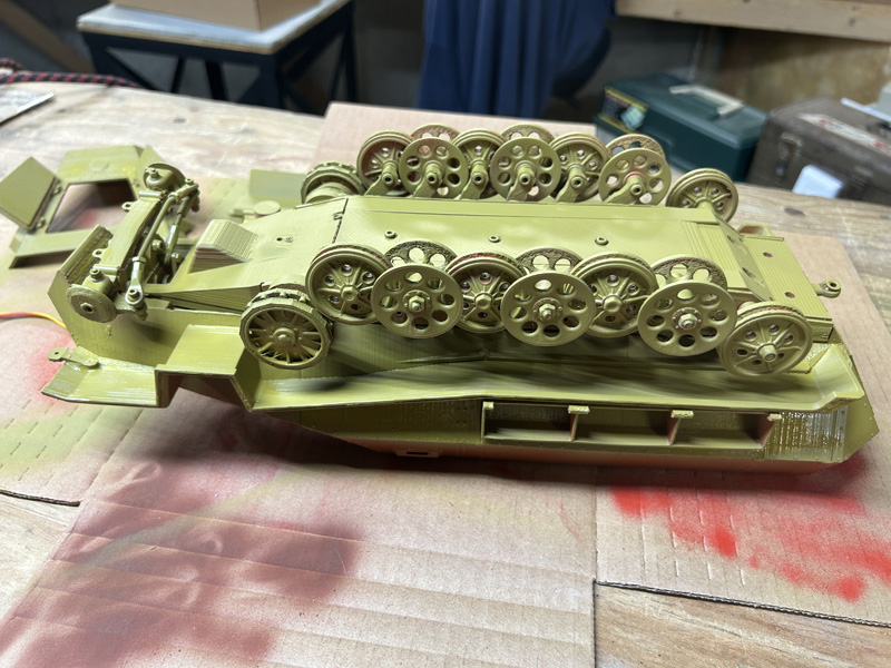

Yes, I do sometimes make progress. After a bit of time away to work on two rather out-of-the-box tanks, a HengLong Challenger 2 and a Taigen Panther G, I am back at the SdKFz. 251. I blew a hole through the firewall with an 88 (well, really I drilled carefully) so the wires to the motors can fit through to the ESC. That's all set to go, so I am on with the second primer paint (Will sends his WCP models in a red primer): Vallejo 73604 Surface Primer - German Dark Yellow 60ml bottles. I have used a few of these relatively new Vallejo Surface Primers as base coats. The Dunkelgelb looks a bit too greenish to me, but I am partly color blind.

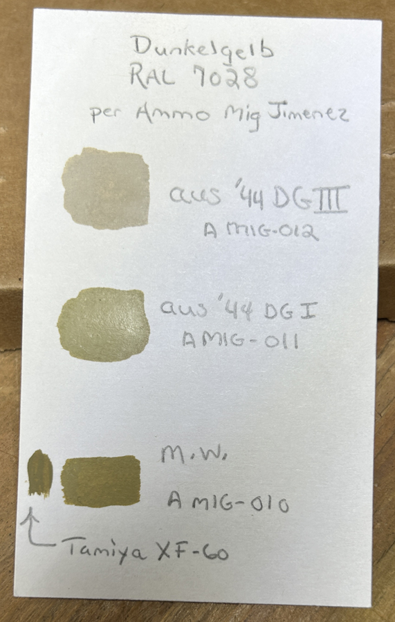

Sometime, somewhere (at an age far-far away) I made two samples of three (there were likely more) of the variants of RAL7028 Dunkelgelb. The paint on my WCP SdKfz. 251 seems to be quite close to the Ammo by Mig 010. That gives me some range of date possibilities.
The SdKFz. 251 A-B-C's were early, so many were only Dunkelgrau, but I wanted to do Dunkelgelb with camouflage. I am open to suggestions.

I used Tamiya's newer XF-88 and XF-89 (XF-90 is the brown for tri-color) on my Panzer III build. It only comes in the mini Tamiya bottles and not as a spray. It's much better than XF60.
Link to mine painted with Tamiya XF88 and XF89: viewtopic.php?t=33231&hilit=mato+panzer+III
