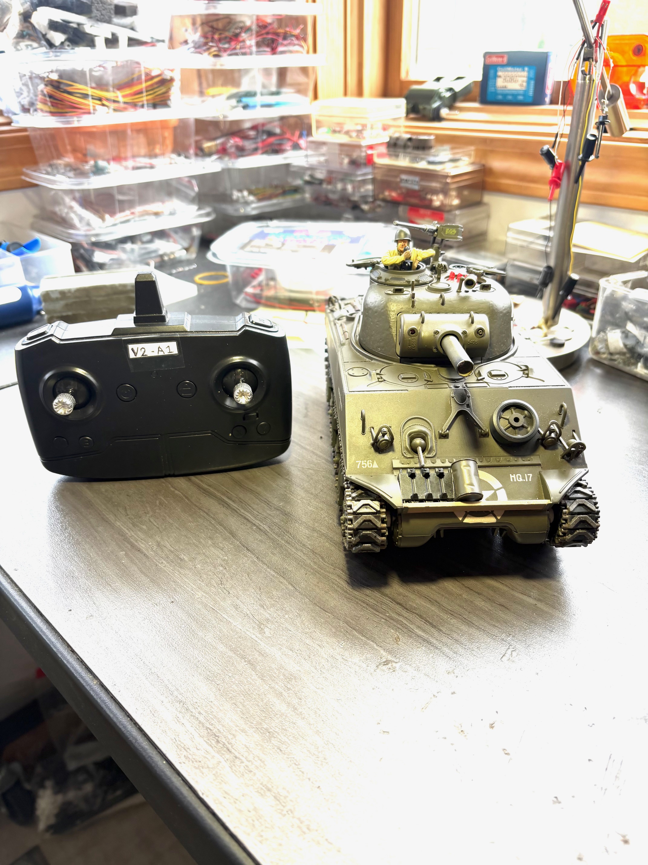

Vs Tank M4E3 Sherman converted to HL RX-24 V4 receiver.

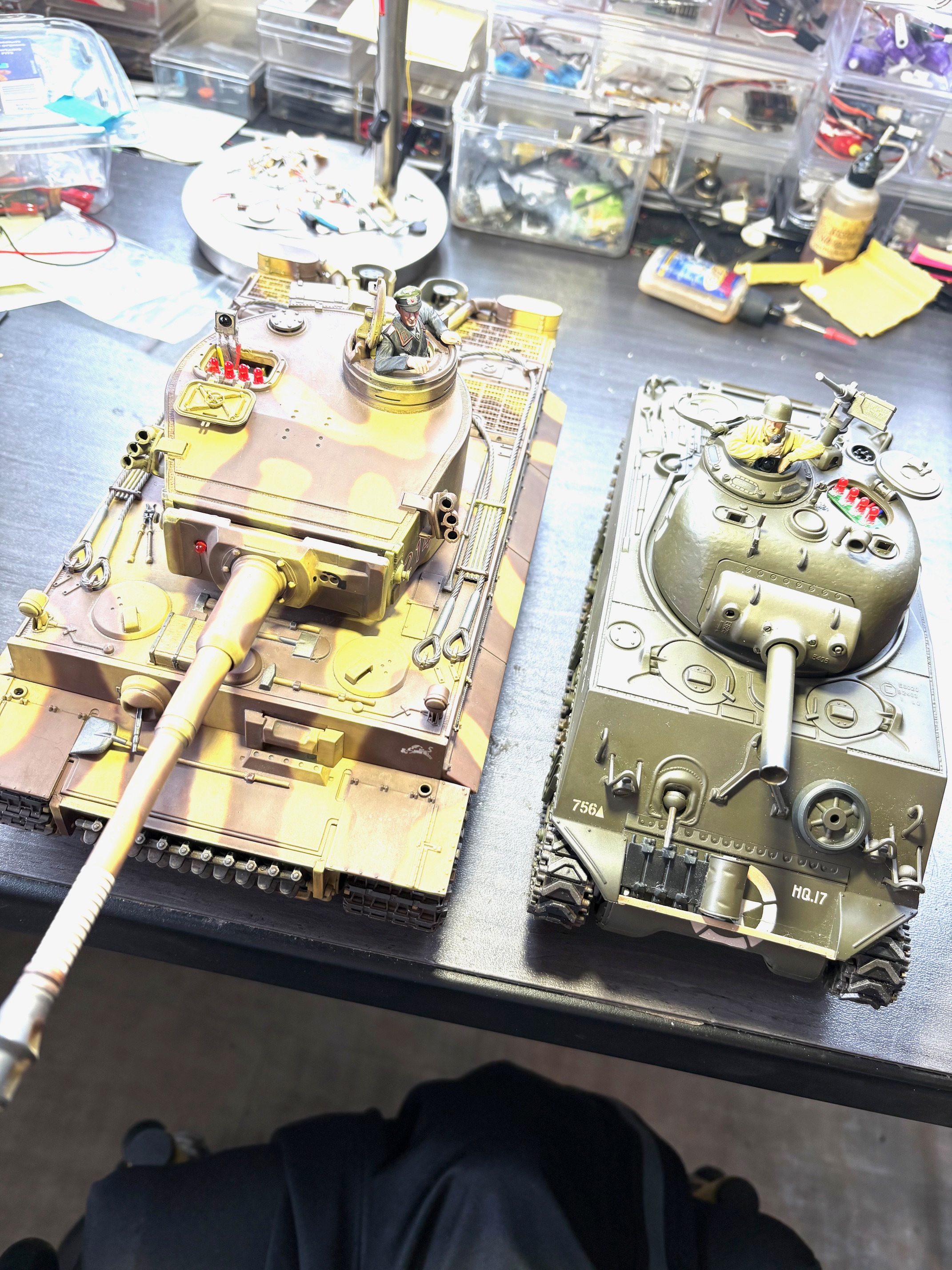

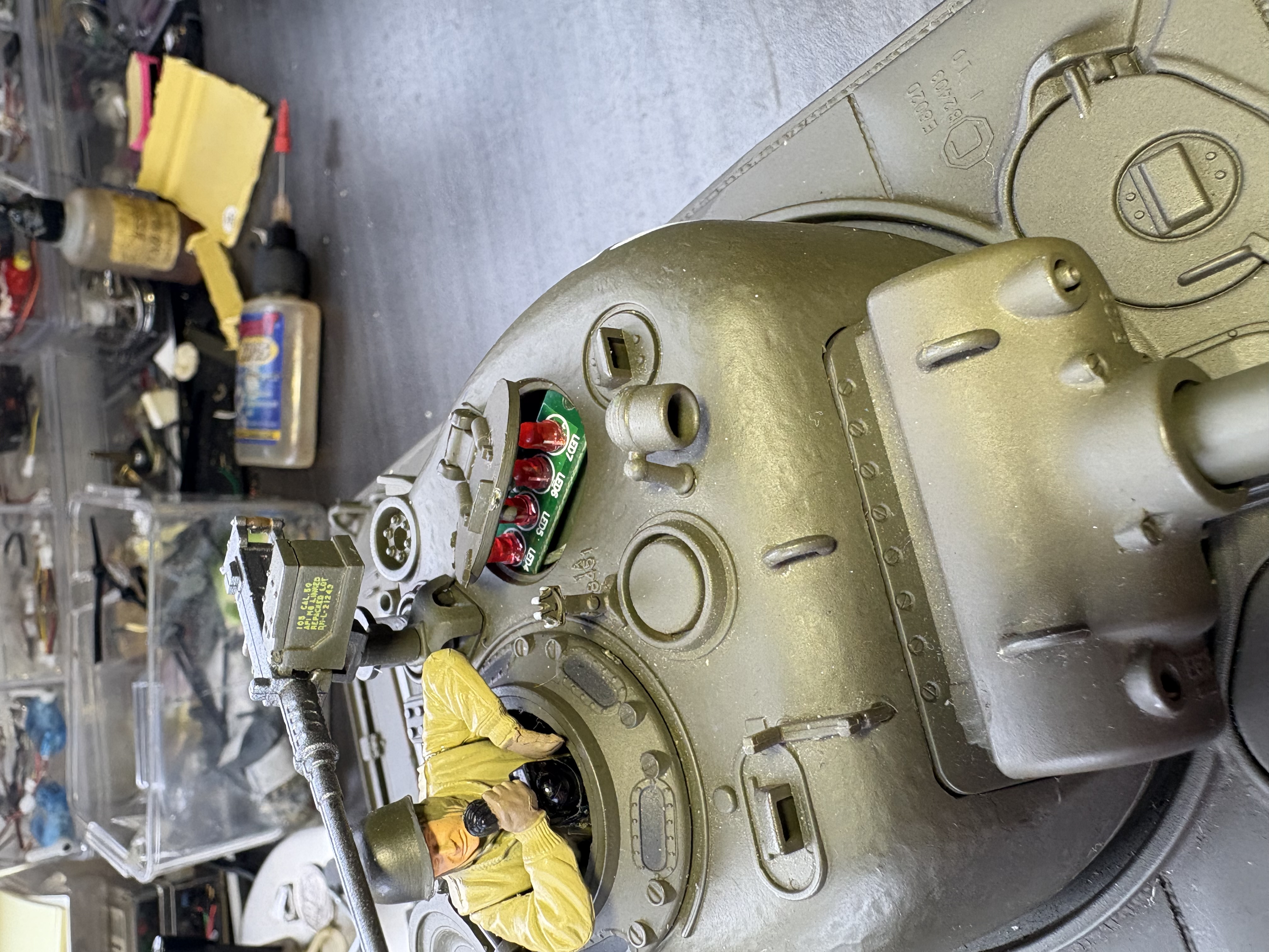

Heng Long 4 LED scoring display added to Sherman and Tiger 1. These Tanks are ready for IR battle! Still got to change that BIG RED MG LED! I was short on LED's at that time but I now have smaller ones that would look less TOY LIKE lol.
IMG_0245 (1).jpg (1.89 MiB) Viewed 2095 times

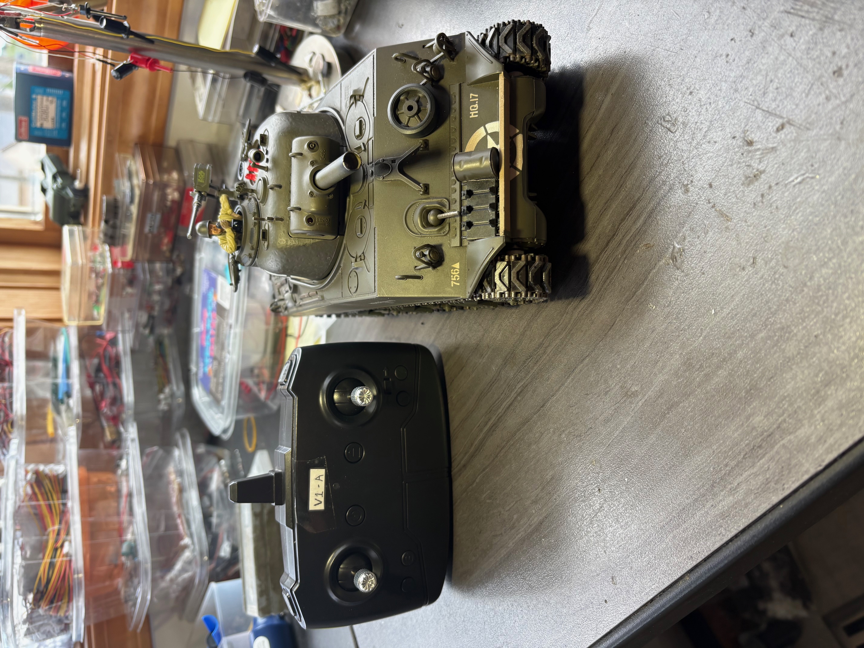

Vs Tank M4A3 Sherman converted to HL 2.4g RX-24 -V4 receiver. Next upgrade will be getting the main gun recoil to work. with the RX-24-V4 receiver.

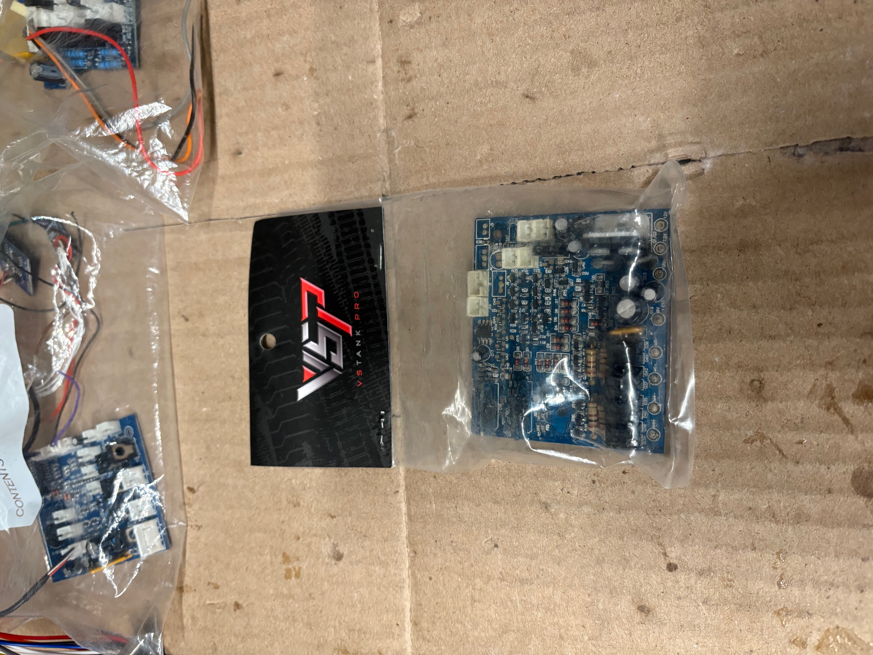

modler wrote: Sun Apr 13, 2025 3:37 pm B| I recently did some work on my 1/24 Vs fleet and found out that the RX24 V1 circuit board works great! You just need the V1 Transmitter. The V1 Transmitter can quickly be identified by the single beep tone it makes when you push the TX on button. The BLACK RX24 V1 receiver is the only one that works with a V1 Transmitter. I bought a set of new Poco Diva Amazon set of 1/30 HL battle tanks and of course the first thing I do with any new Tank is to take it apart and look inside. I was very surprised to see a BLACK RX30 V1 circuit board! So I dug up the 5 V1 boards that I had from ~4 years ago and tried them and they work great with the the new V1 Transmitters that came with the HL 1/30 Tank set.
So in summation..
Black RX-30-24 V1 receiver boards only work with V1 transmitter only (single beep tone with TX on button)
RX-30-24 V2,V3,V4 all work with V2 and up transmitters. Will not work with V1 transmitters. (multitone with TX on button)

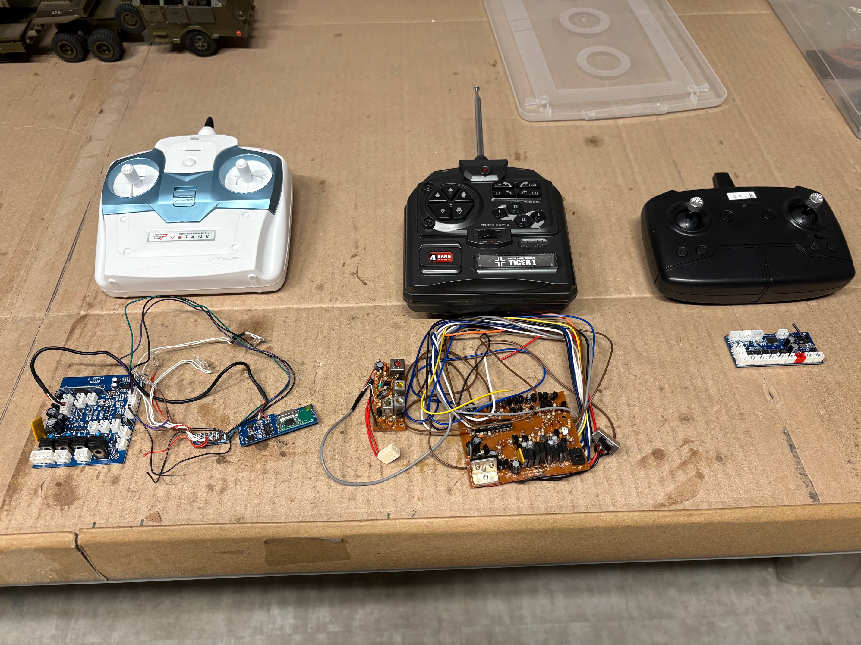

The VsTanks can have 2 or more different transmitters that I know of. I do not use the VsTank radio gear as it is overly complicated and outdated IMO and is not fully Digital Proportional. Oh and the battery tray in the VsTanks are useless as well for me as I use Lithium poly batteries. 2s lipo works well with the motors in these tanks. I cut the trays out otherwise there is no room in there for a Li-poly battery. This swap to Heng Long radio gear requires a HL receiver switch as well. You basically gut the VsTank electronics and swap in a HL setup. Requires some experience to do this mod. I have converted 3 Vstanks to HL at this point.
Maybe you can find a VsTank transmitter on ebay. If it is the later 2.4 G radio system, that would be better. Otherwise the are the old 72 mHz radio that uses channel crystals and that can be more difficult to match up.
Left late 2.4g VsT IR battle tank receiver. Middle 72 mHz VsT IR battle tank receiver with rf board and crystal....oh wait ,crystal is missing. I have it somewhere. Right 2.4g HL IR battle tank Tx and receiver. Full DP and compact size. Advanced design. Works very well. May be the best available receiver of its type at this time.

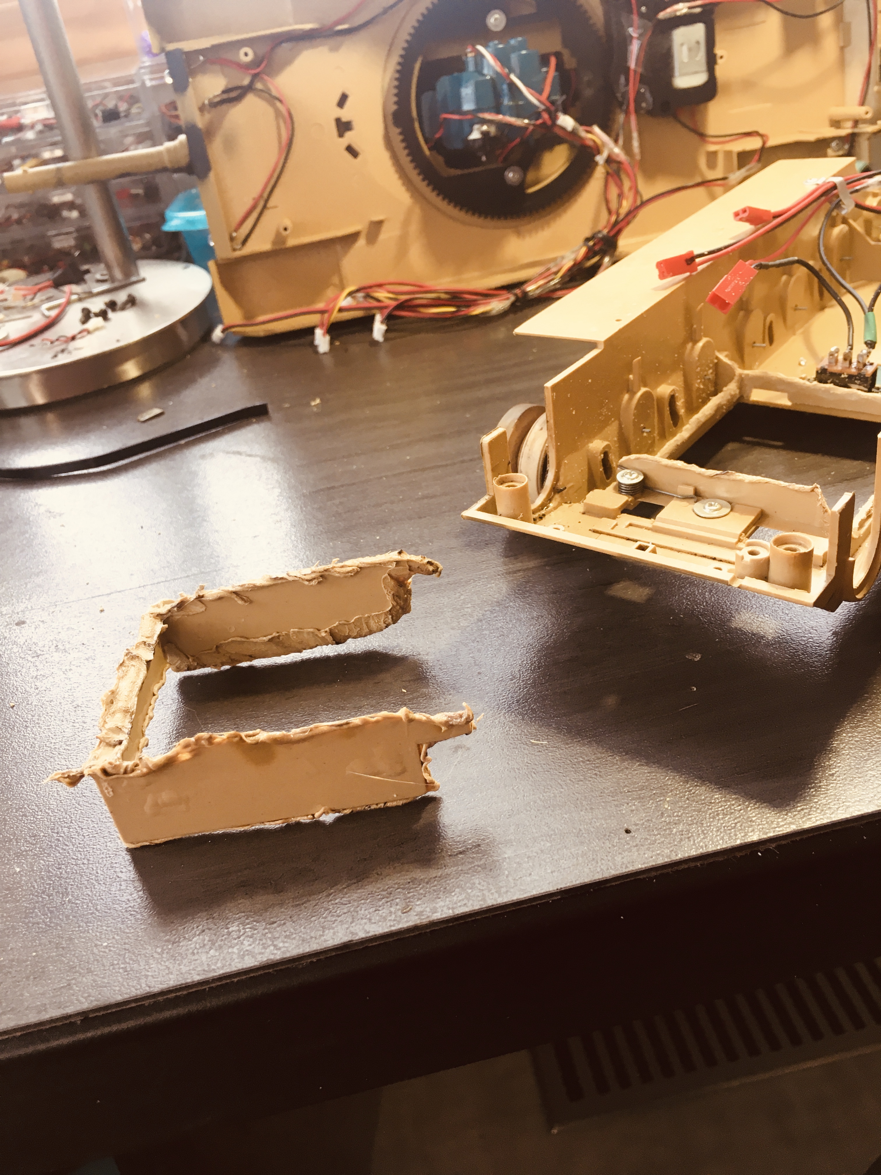

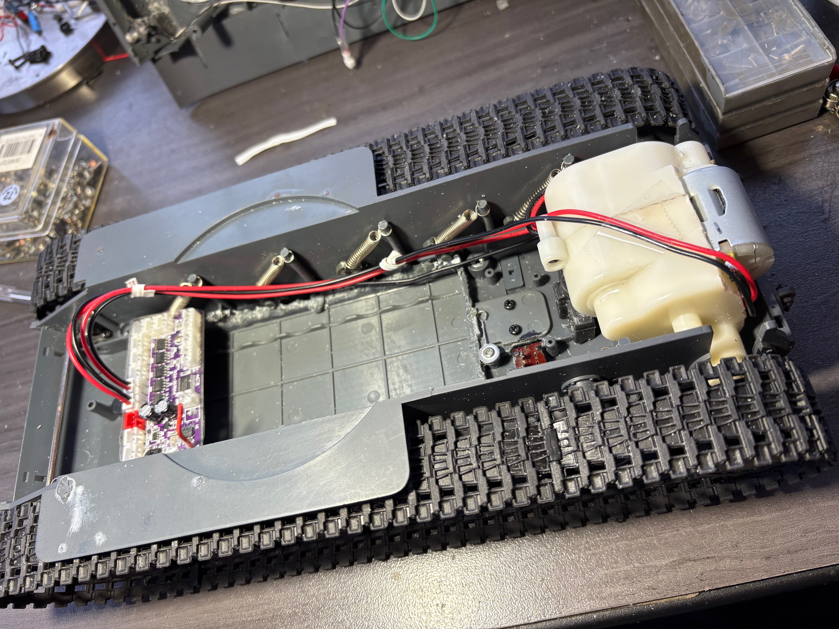

The receiver has to be properly mounted in the chassis and in the right spot. Lots to do in this conversion.
IMG_0287 (1).jpg (1.91 MiB) Viewed 1997 times
battery tray cut out but enough left for the receiver mount.

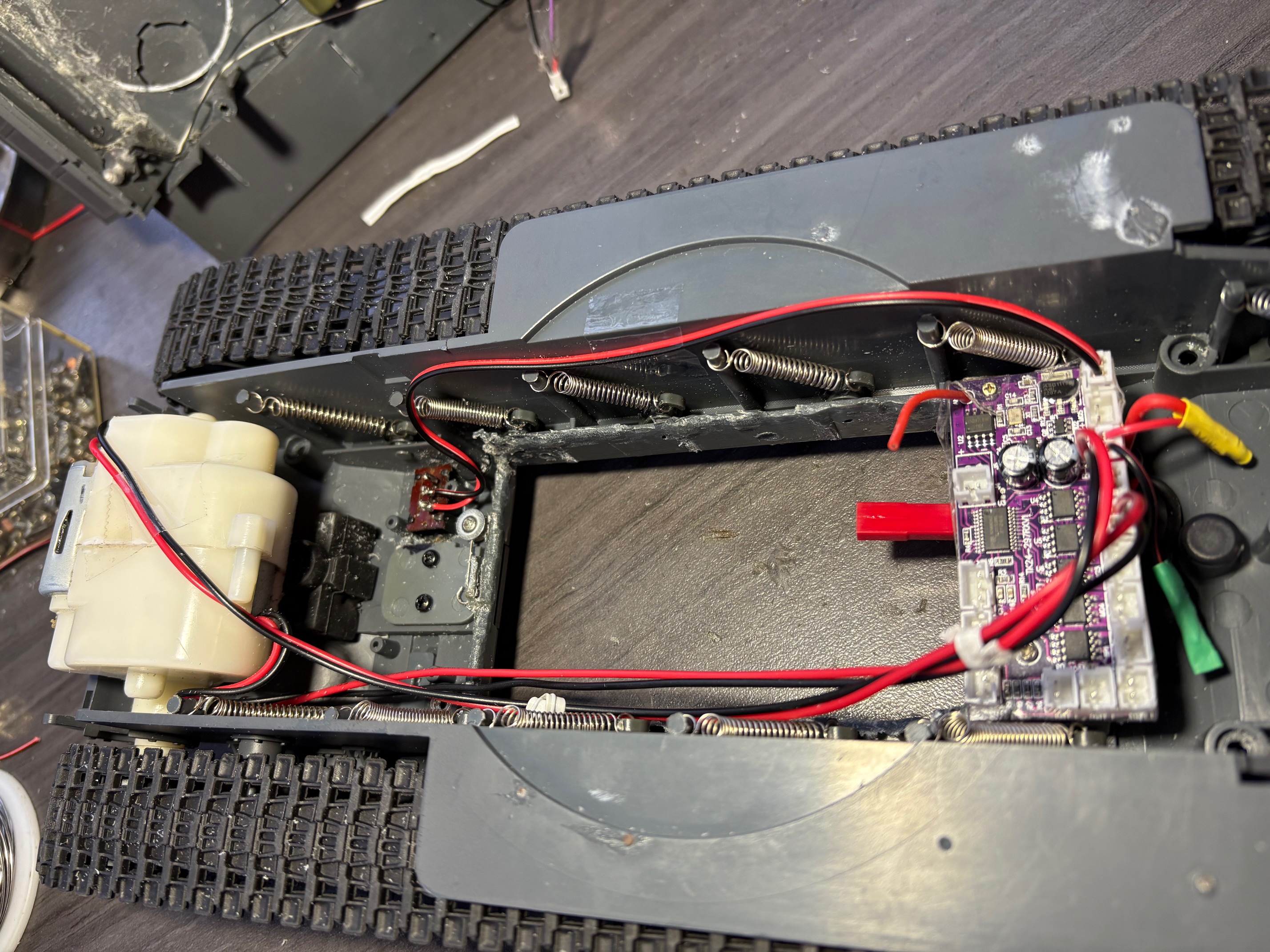

This VsTank has HL radio receiver and gearbox. This one was the most challenging.

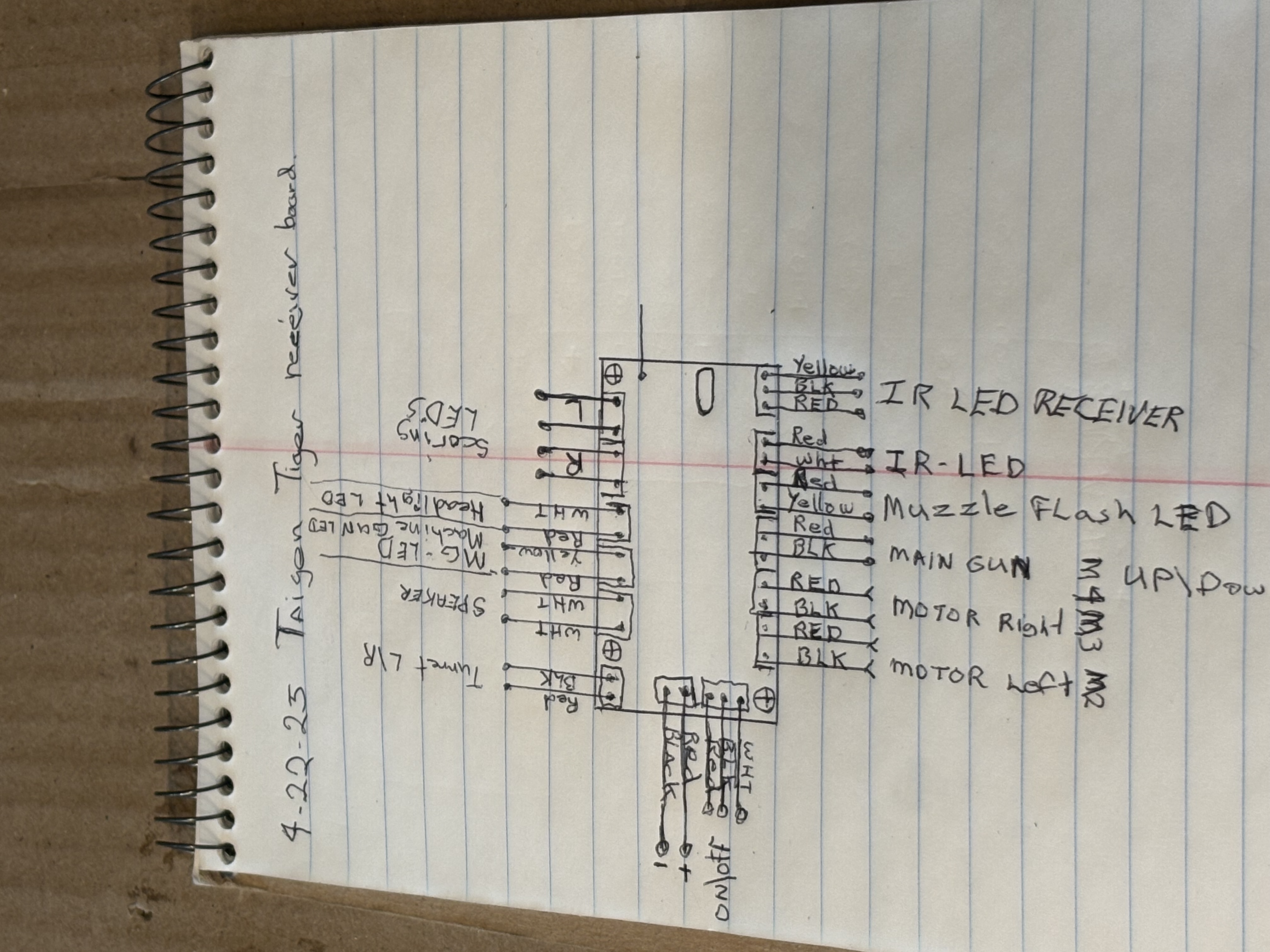

As far as schematics, you will have to do your own. below are some examples.
Taigen Tiger 1 receiver hook up schematic. The Taigen receiver and TX work very good as well amd is a good candidate for upgrading a VsTank.

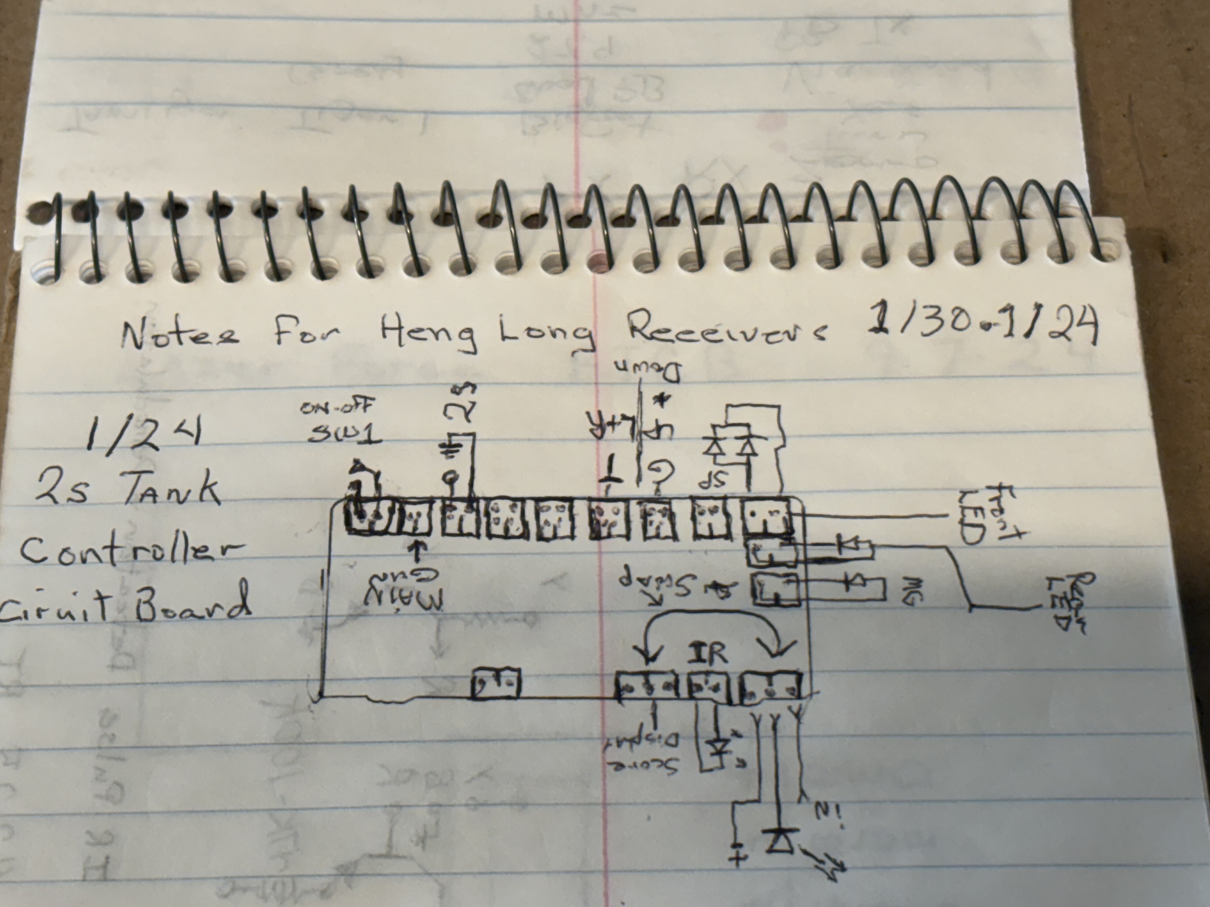

Baseline HL receiver hook up schematic.
