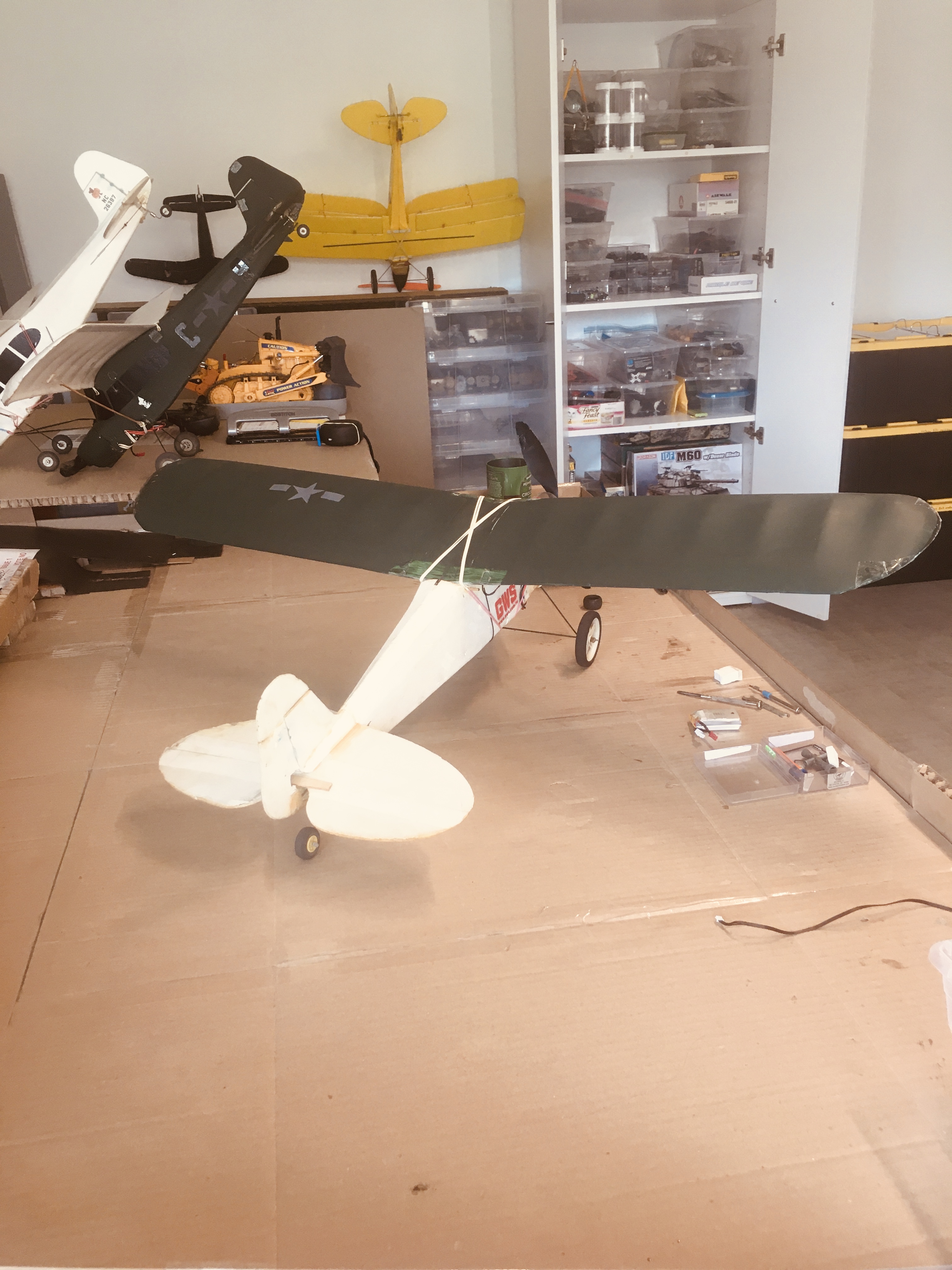

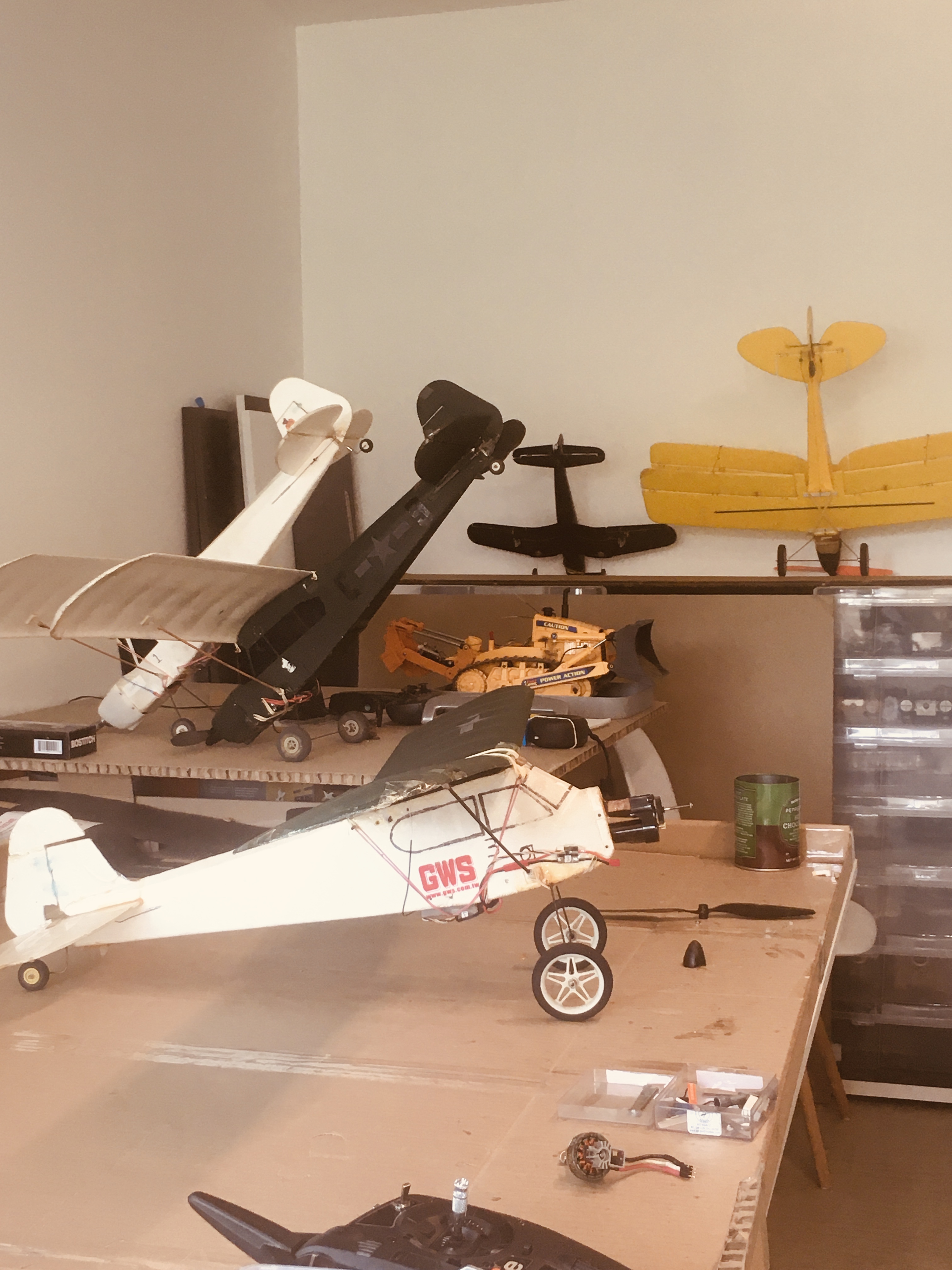

Spring 2024 is here and this time of year I put my efforts into R\C flying. The Tanks and military models rest for a while unless they can run outside in my garden :D
A little about the F4 Cub. Electric power with ~800-1500mAh 2s lipo. Brushed motor with a gearbox with various gear ratios Wingspan ~40'', under cambered wing "slow flyer" 3 channels. No ailerons as it is designed to be a simple easy to fly plane that I operate with landing gear on pavement.
Steering via tailwheel allows taxi on pavement and bare ground. I usually sit in a folding chair while flying it and Taxi it to the ROG area and after the flight of up to 30 minutes or longer depending on the lipo used, I taxi it back to where I am seated. People say to me that it "Flies like a bird"
ROG's are its specialty with scale like take off and landings that when people see it do those things they are amazed at how realistic it does them. They often clap and say wow, that was a sweet landing! I put on a air show yesterday with 3 GWS plans for three ladies in the neighborhood who brought their elderly wheelchair bound mother to watch the show :D
I have been flying these GWS cuds since 2007. IMO, these "cubs" are the best R\C planes available, (I have 5 of them). I decided to upgrade to a brushless inrunner on the one in this thread

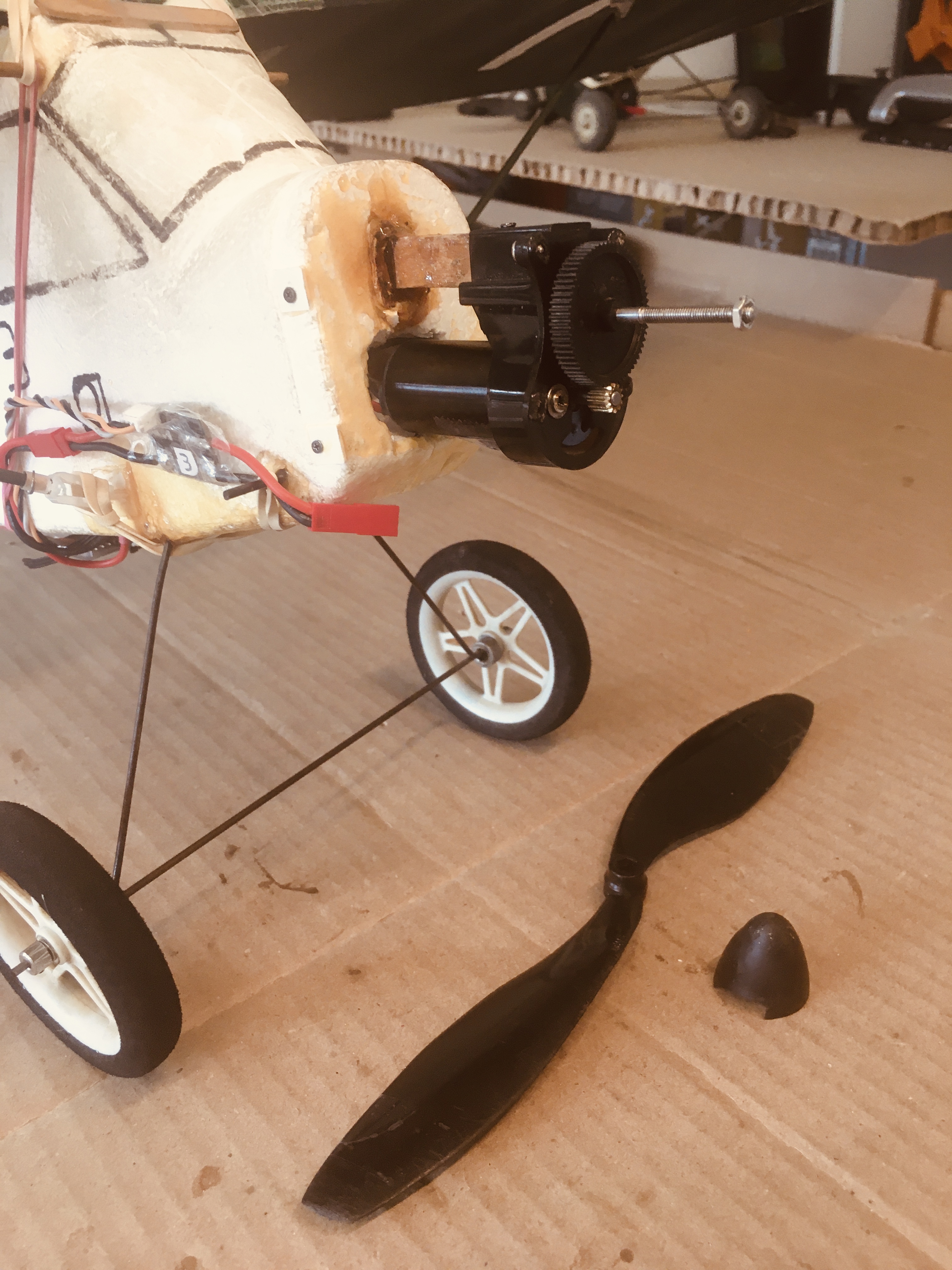

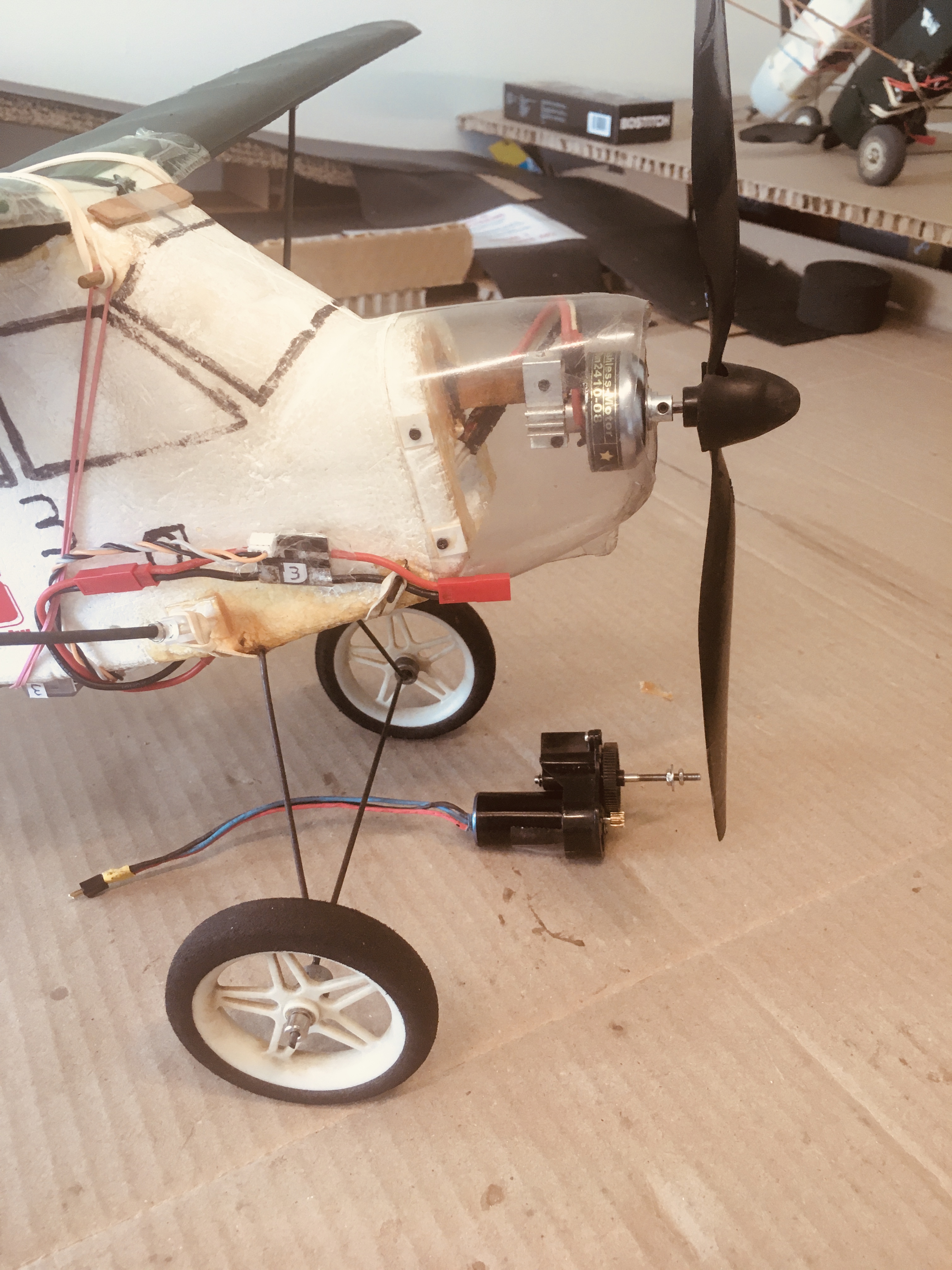

First motor tested was a GWS Ducted Fan motor that I installed in a GWS gearbox with "C" ratio gear with 10.47 prop.
Worked very well on the test flight but Telemetry reading of current draw from the small lipo used was too high (6 amps @ medium throttle) from a 2s 1300 pack. Overpowered and short flight time but other than that worked well.

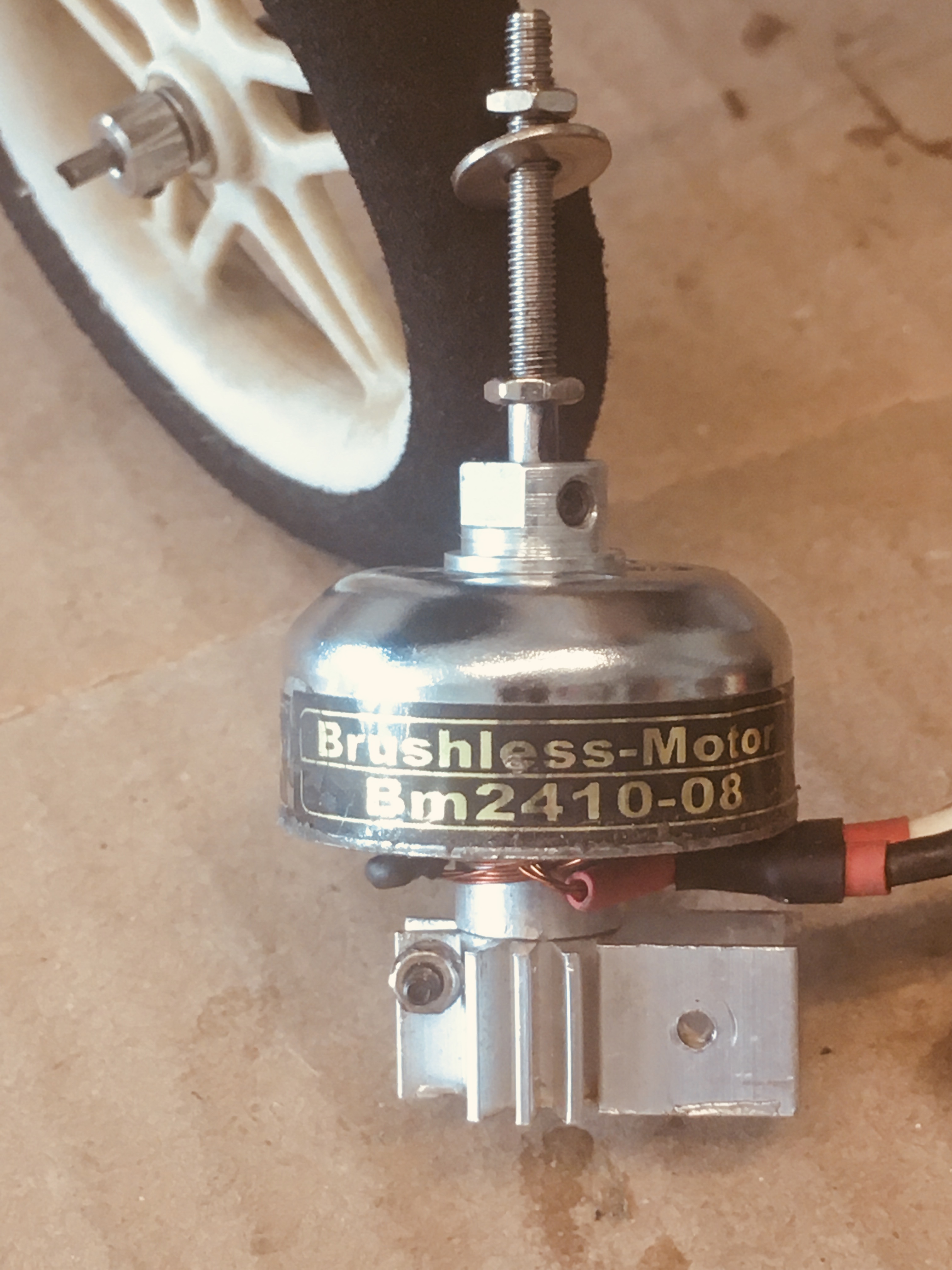

Next I will try a Bm2410-08 BL outrunner which should be be in the 2-3 amp medium throttle range.

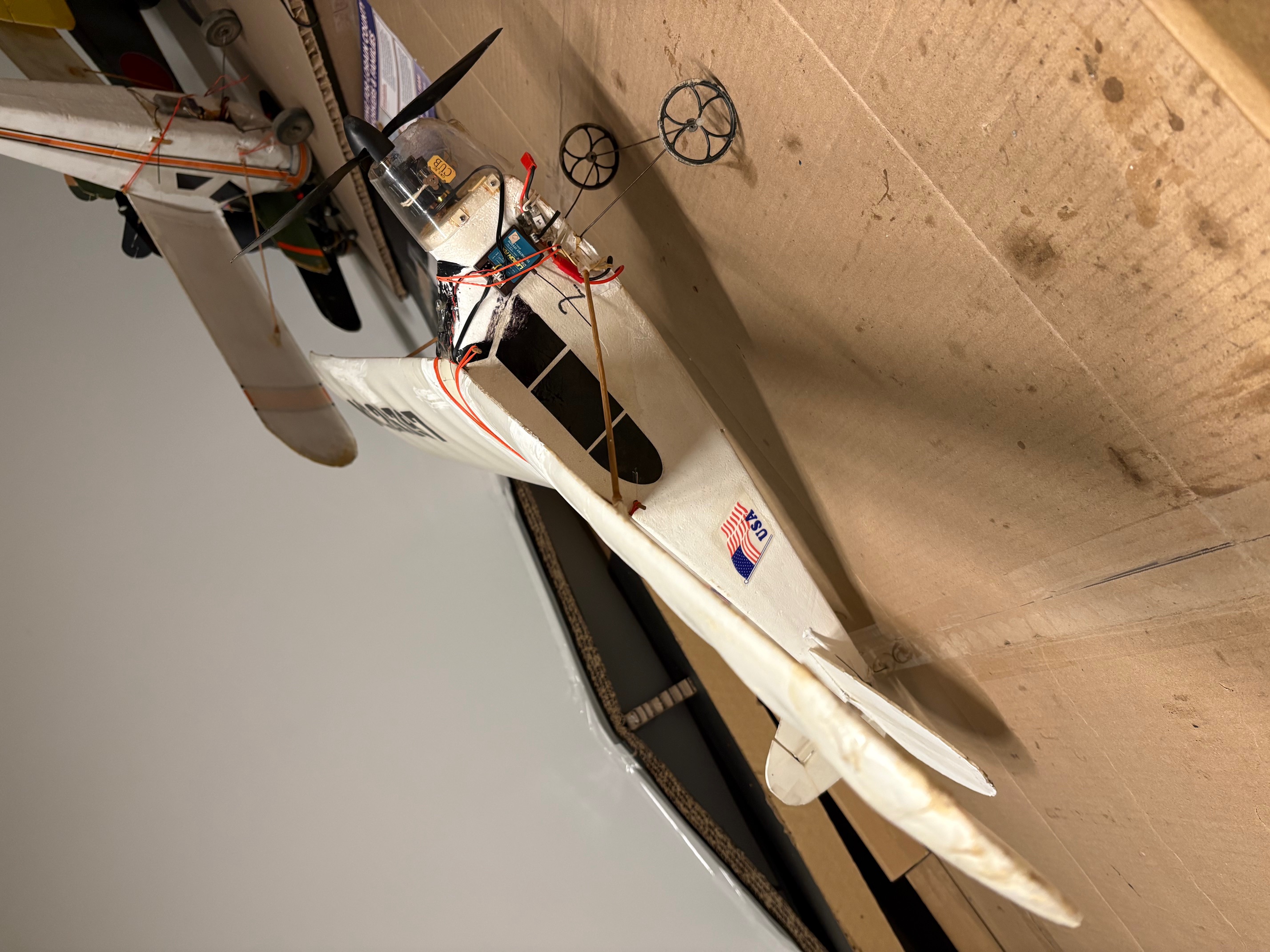

The floats on the right are for the F4 Cub. I will post some pictures of the floats installed.
Waiting for the wind to stop.

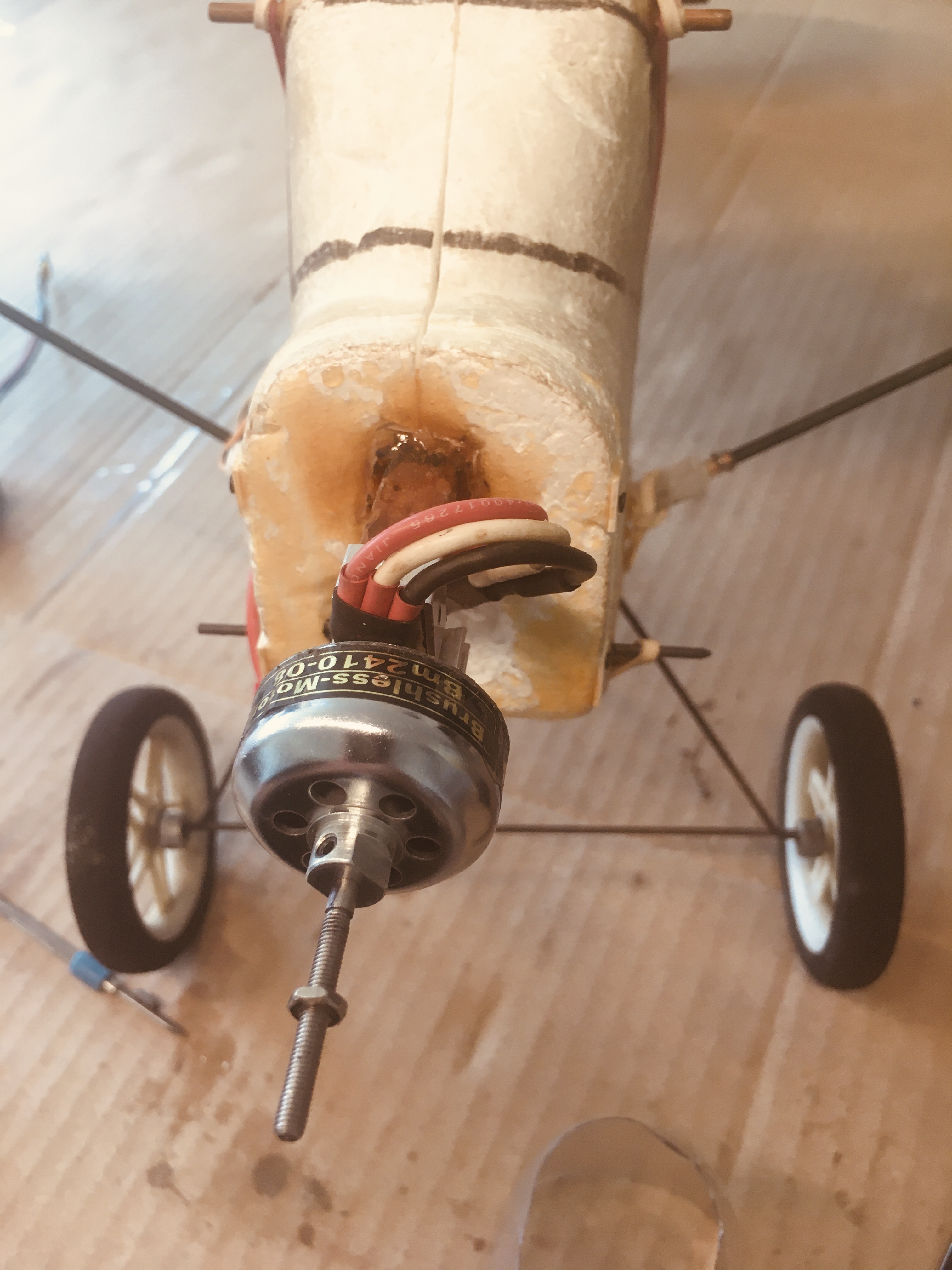

motor swap complete
motor swap complete
Passed static motor test, ready for test flight.

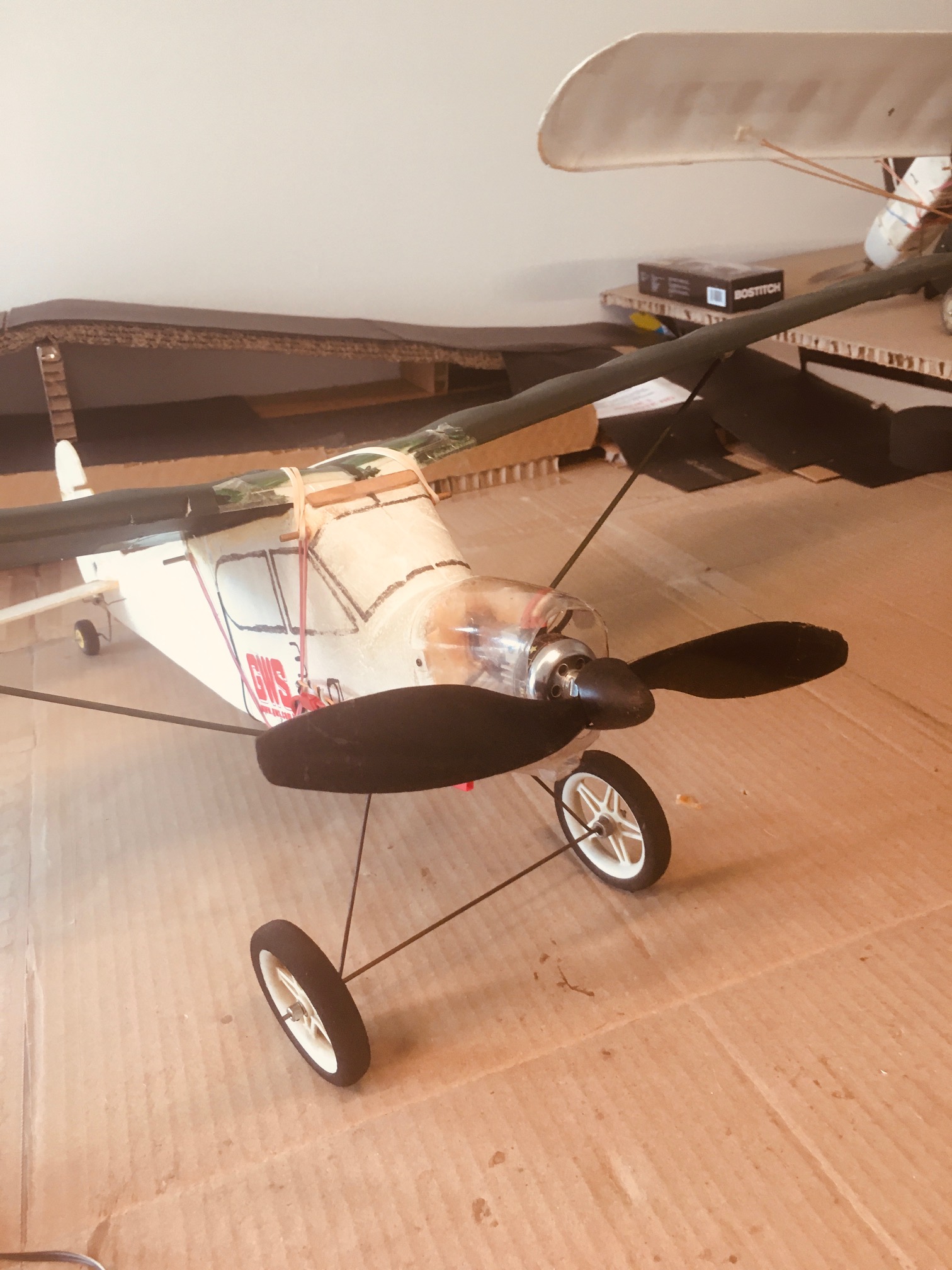

Motor swap complete :D
looks good to me
looks good to me
right and down thrust angles look good. motor location same as original so motor cowl can be installed

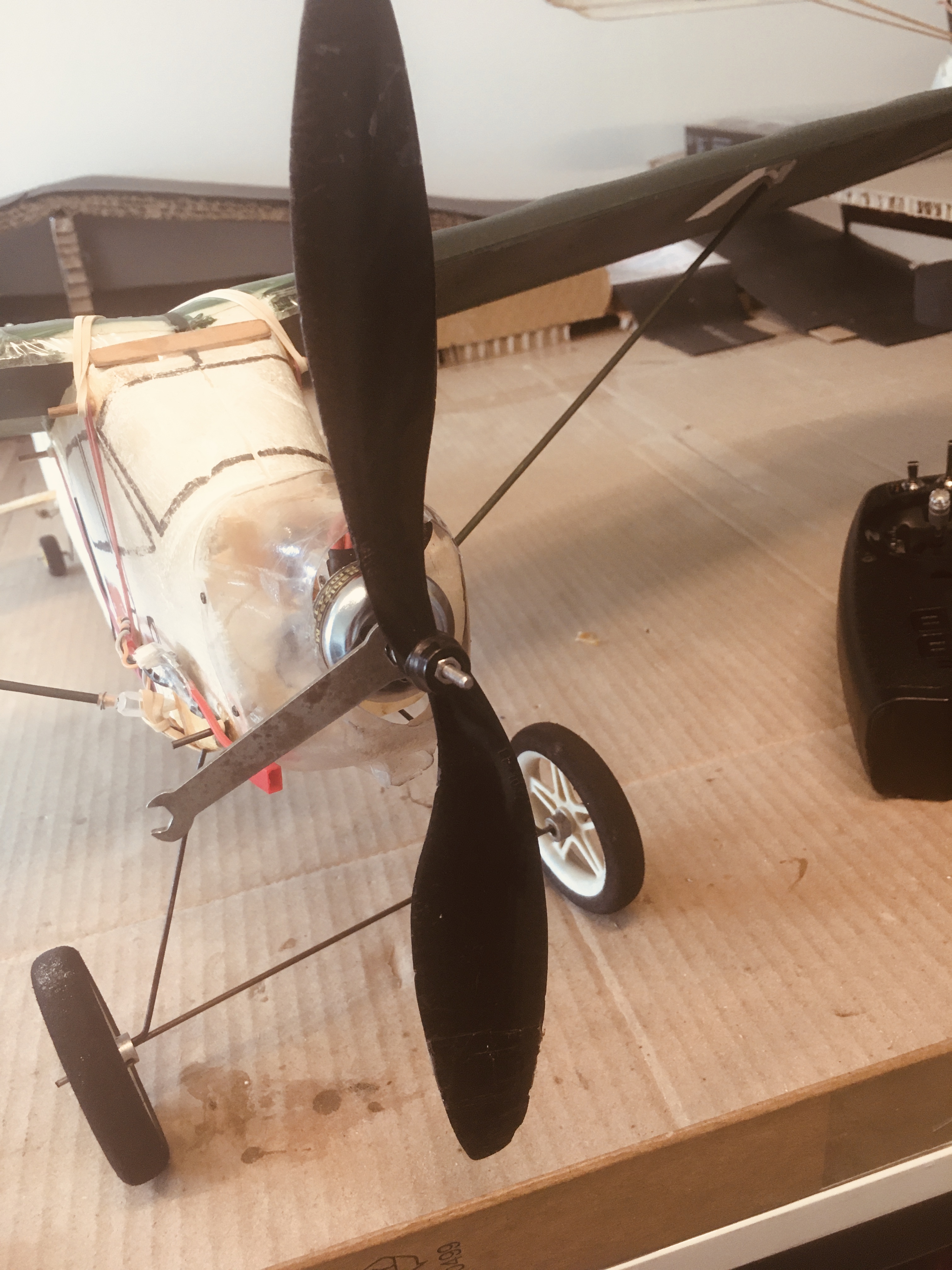

GWS 10.47 prop installed
Motor swapped and tested.

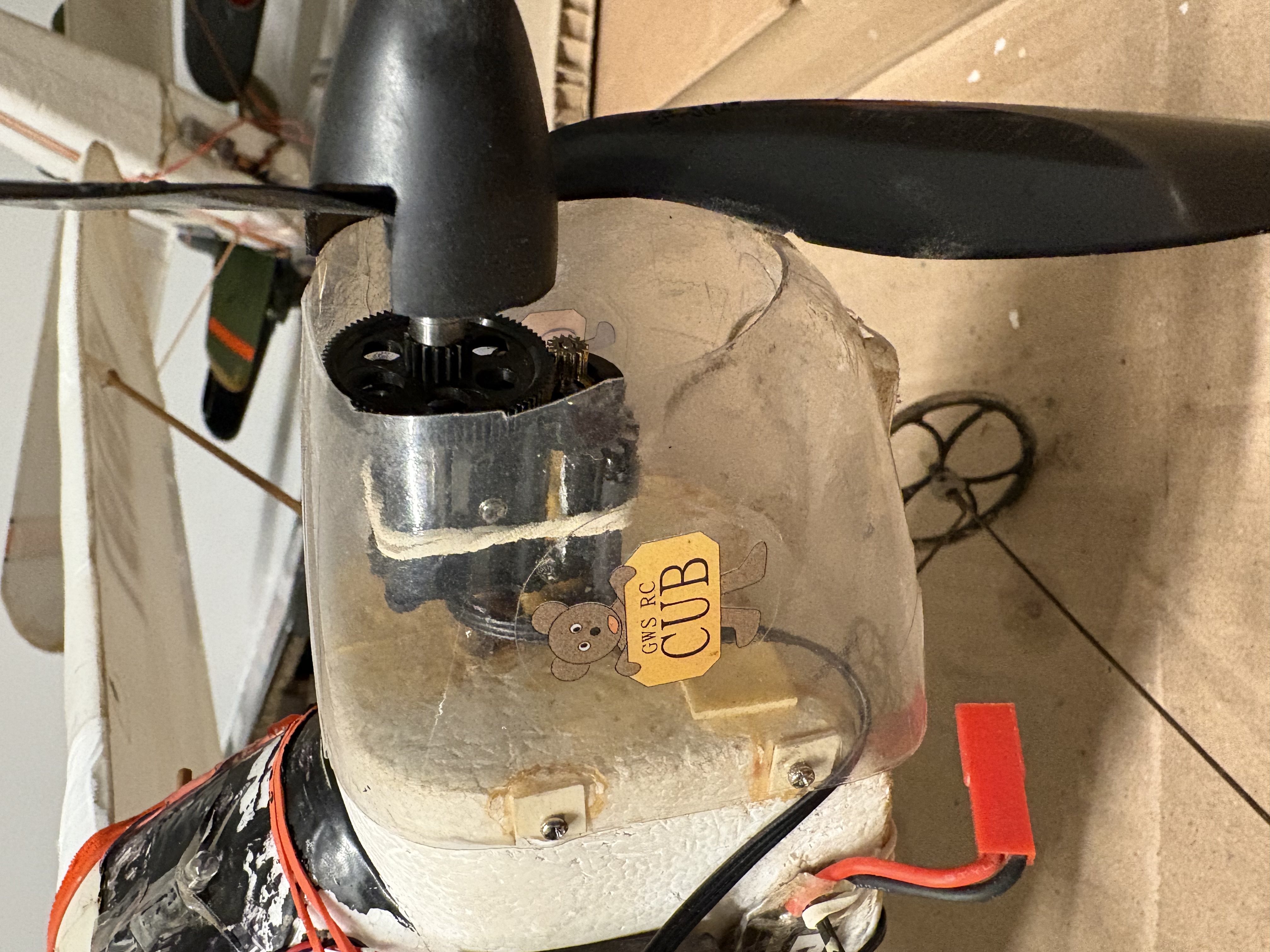

Well, flying season is upon us again. Got my AMA membership paid up and am ready to dust off the planes and get them flying again. I only talked about the GWS cub so far but I have other planes as well. Speaking of cubs, I used a fuego inrunner in one of my cubs and it has the smallest motor yet of any plane with a 40'' wingspan. It works great and because of the low weight and small 2s lipo, it holds the record of any plane I have flown as a "super slow flyer" :D
The GWS F4 Cub in this post is about 20 years old and has flown a thousand flights or more with multiple takeoffs and landings per landings per flight so the this planes has thousands of take off and landings on the clock so excuse the beat up condition :D
Now that is a small engine for a plane of this size. It is very efficient with the 2s battery consumption and can land at near walking speed.
