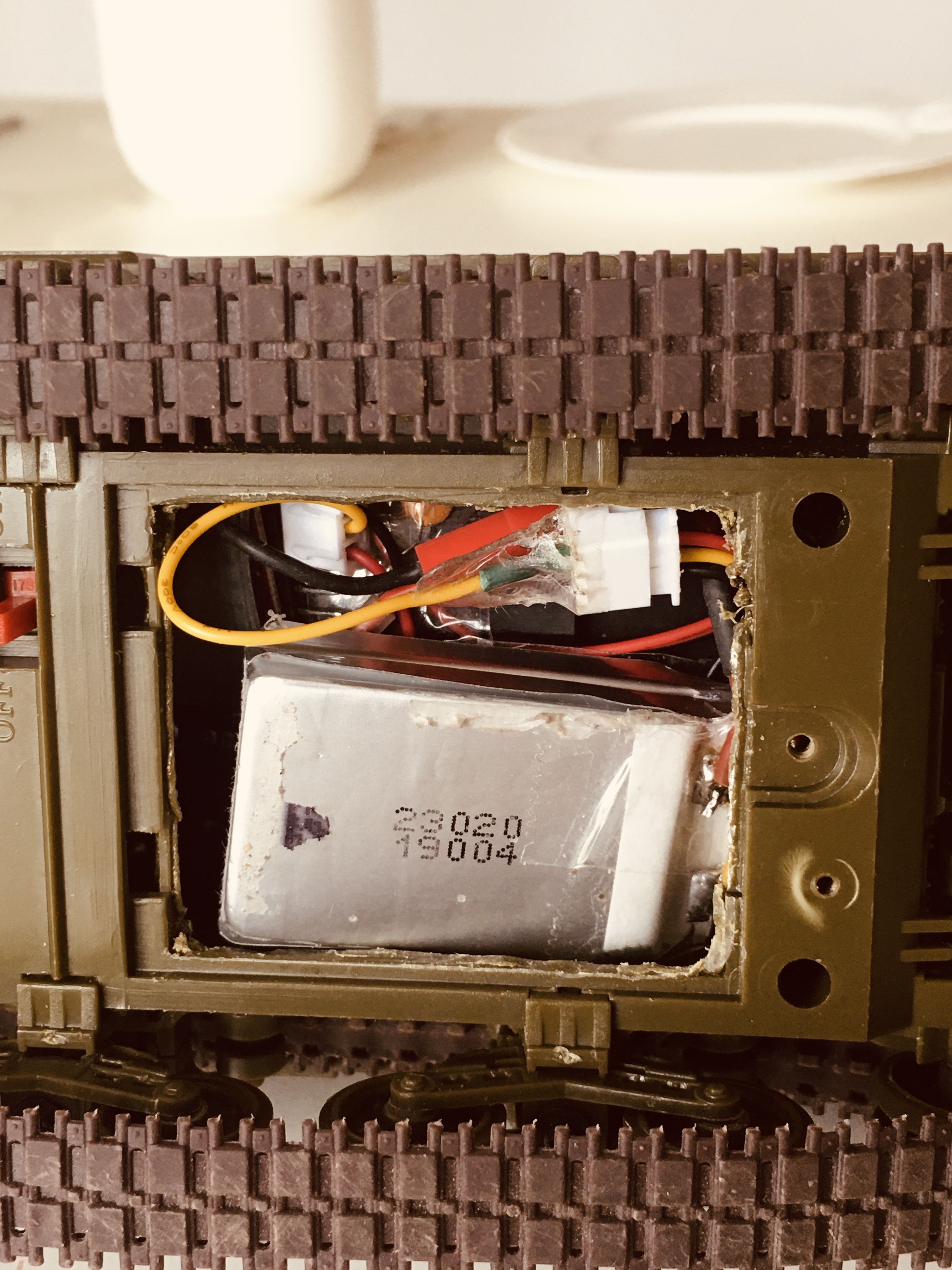

Lipo access panel.
Lipo access panel.

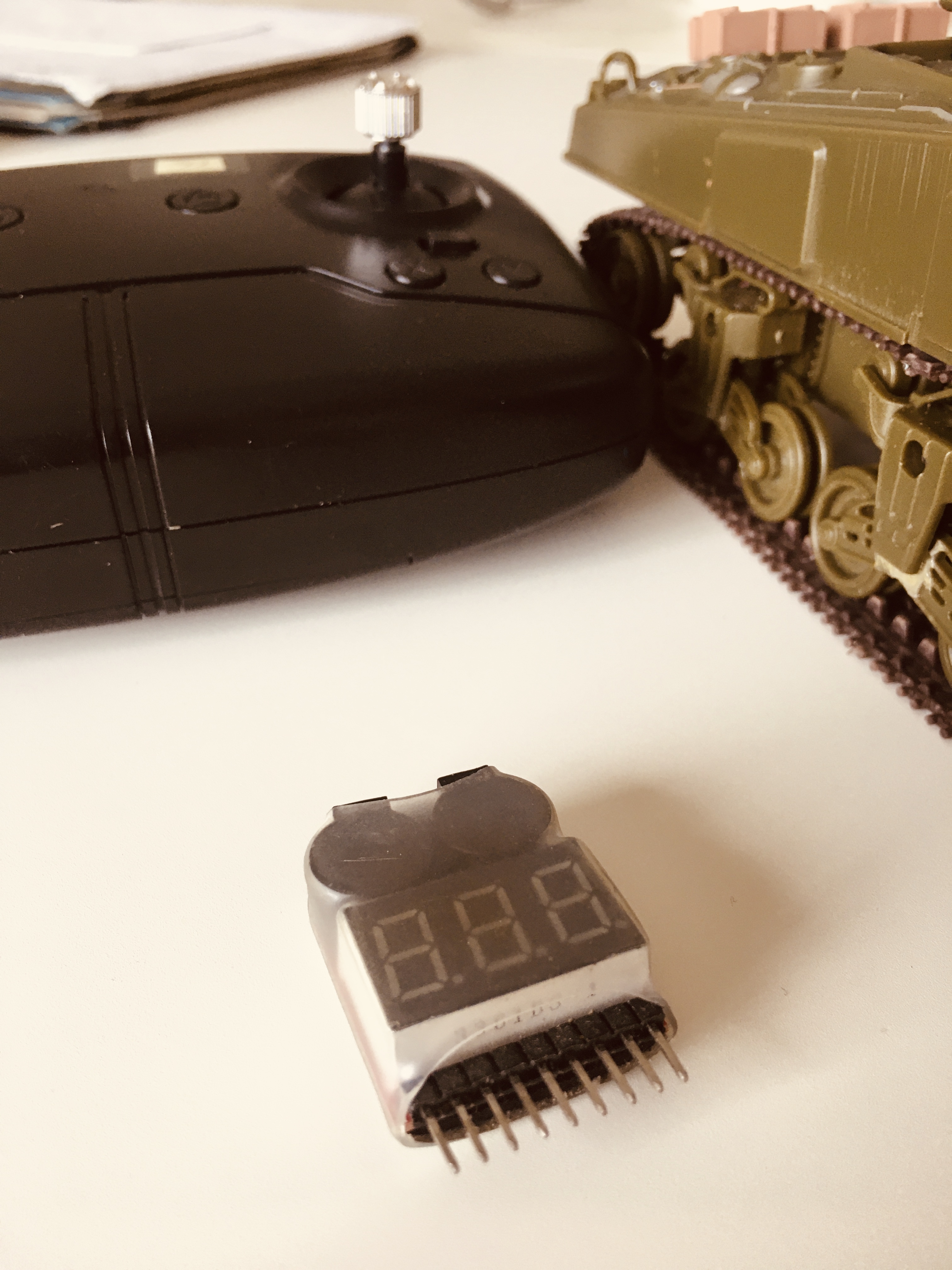

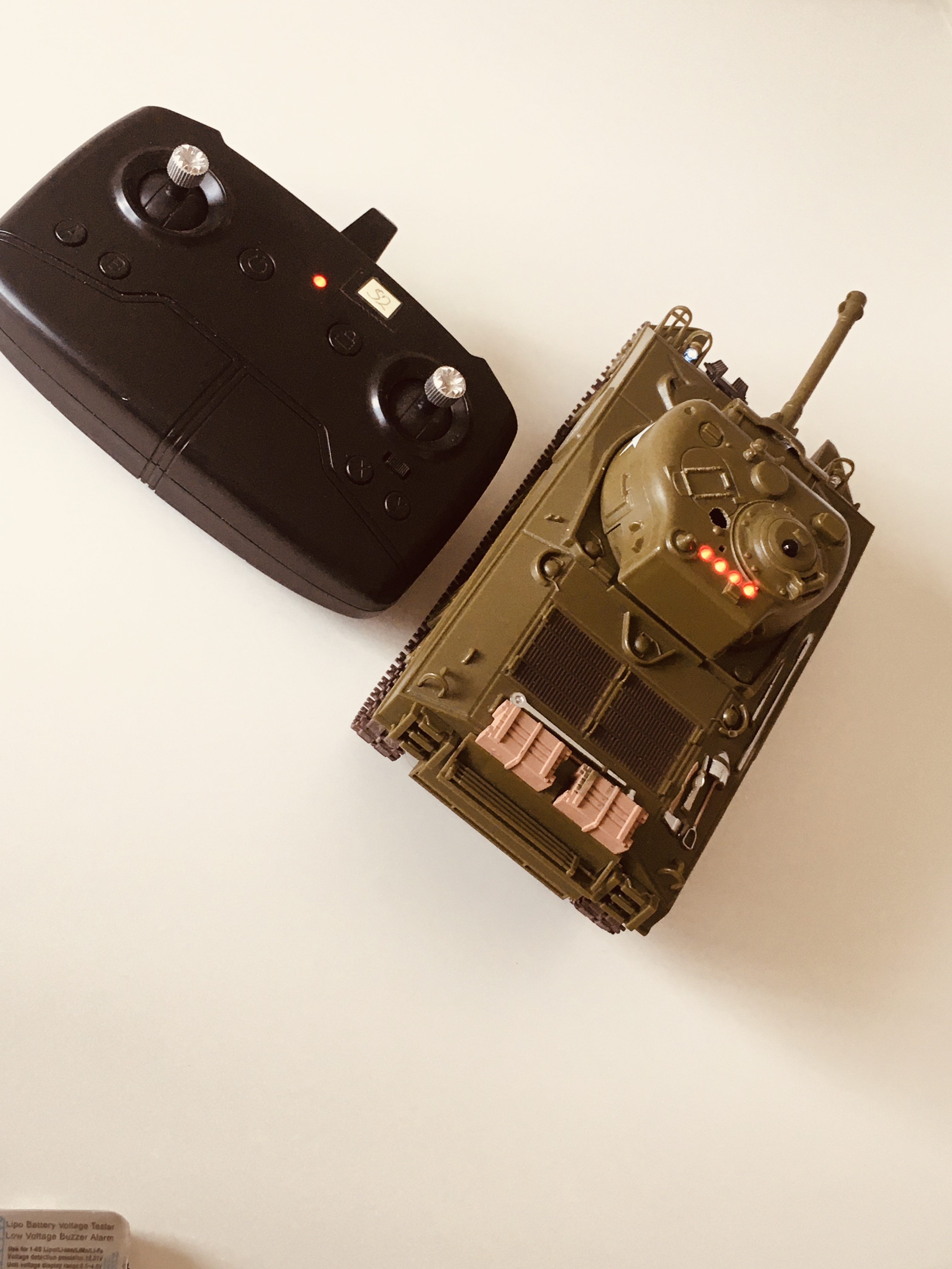

There are nice little voltage alarms. I wired this one so that it Turns on/off with the main power switch. You can't see it from outside the tank but you don't haqve to, it has a loud beeping audible alarm signal.

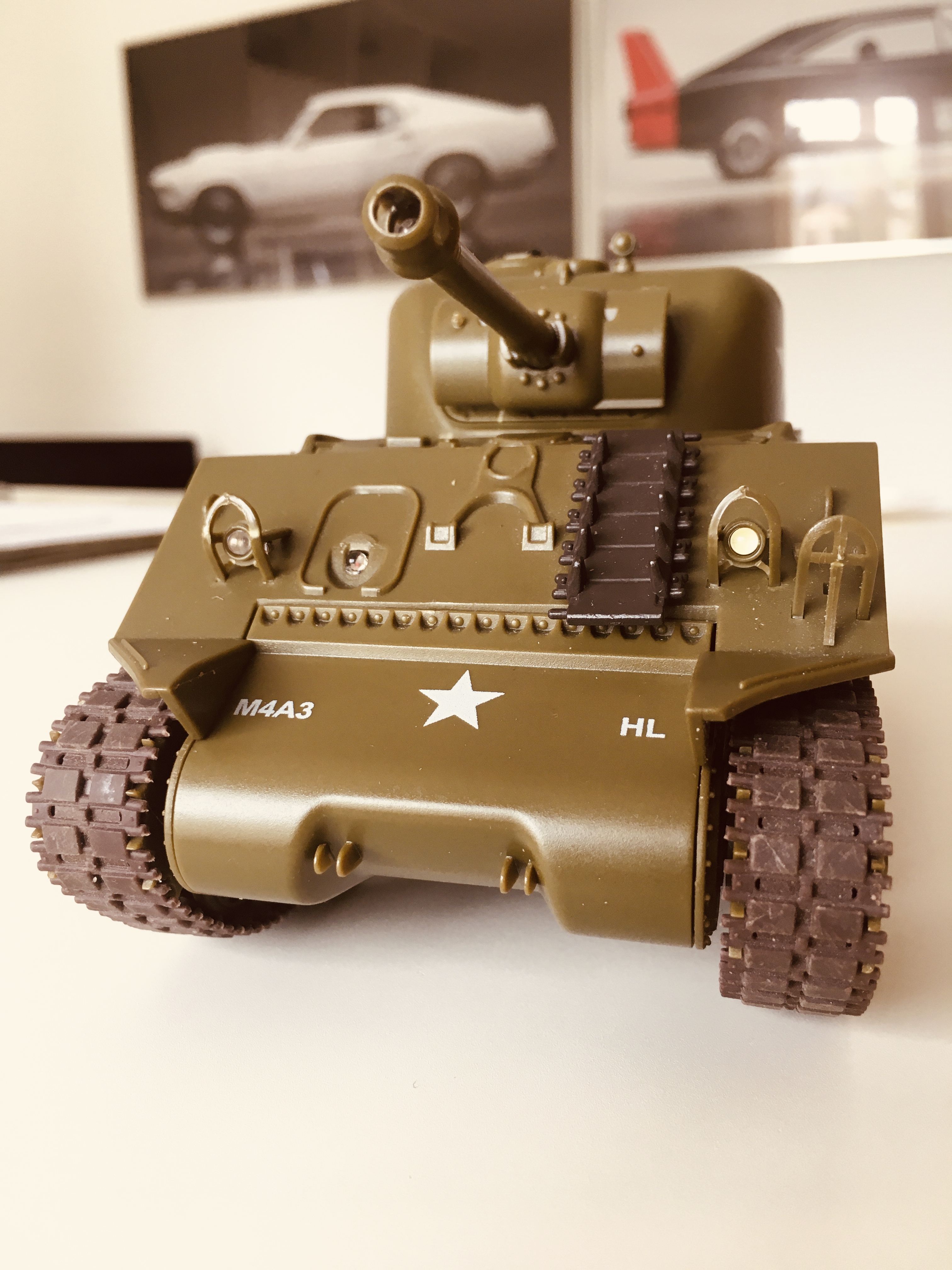

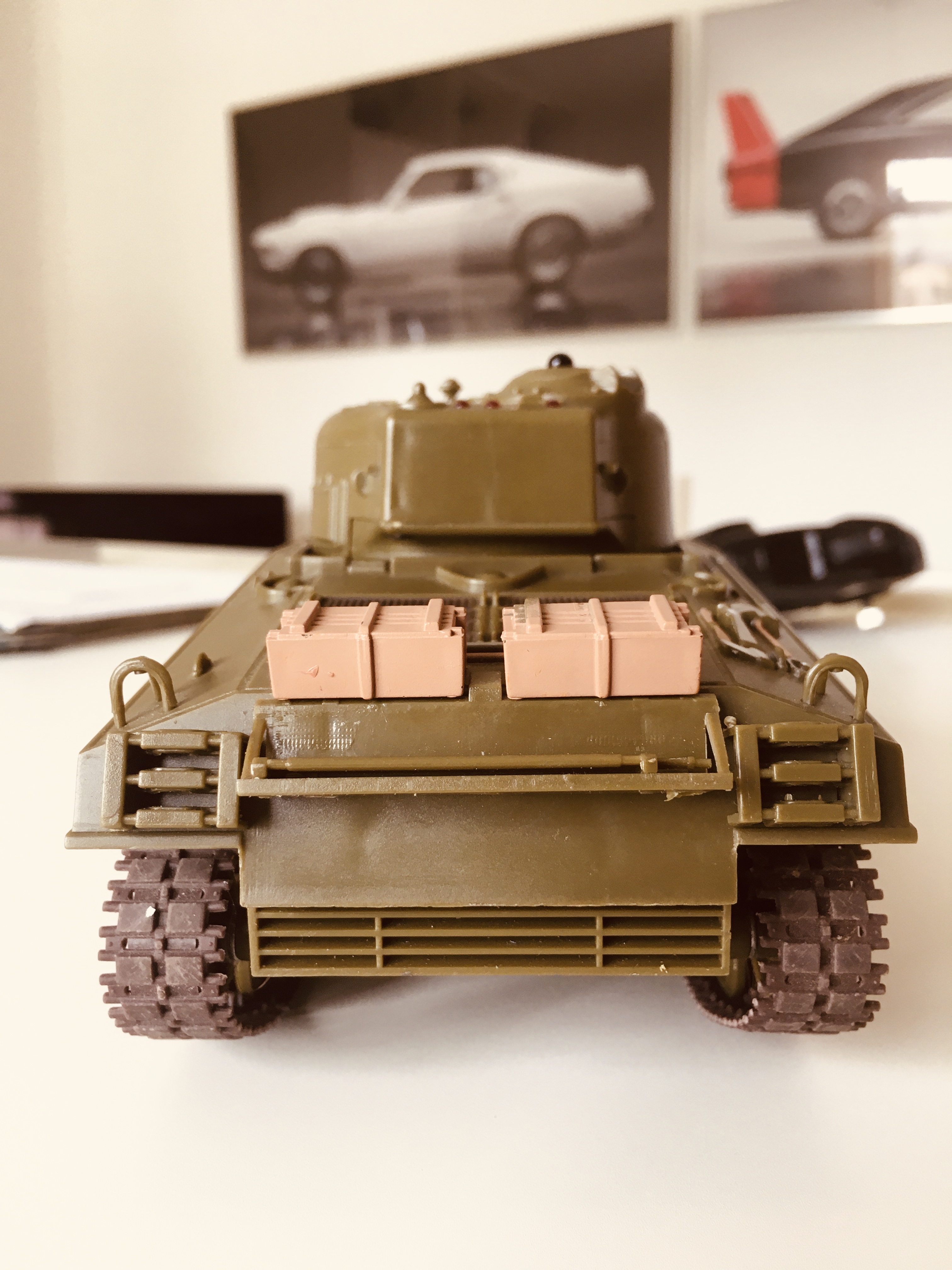

Has most everything a 1/24 HL I\R Tanks has but in a smaller package. "Cut away battery box " mod can be seen here.

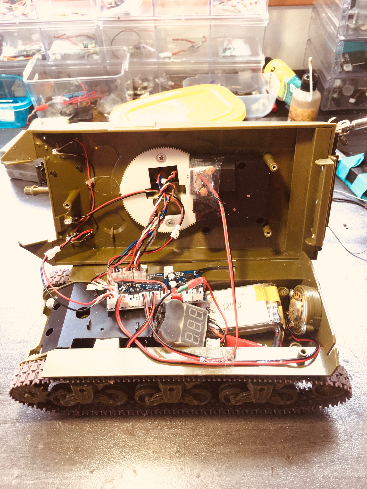

low voltage alarm visible here. These are available on ebay for ~5 dollars. Its a tight fit but is doable.

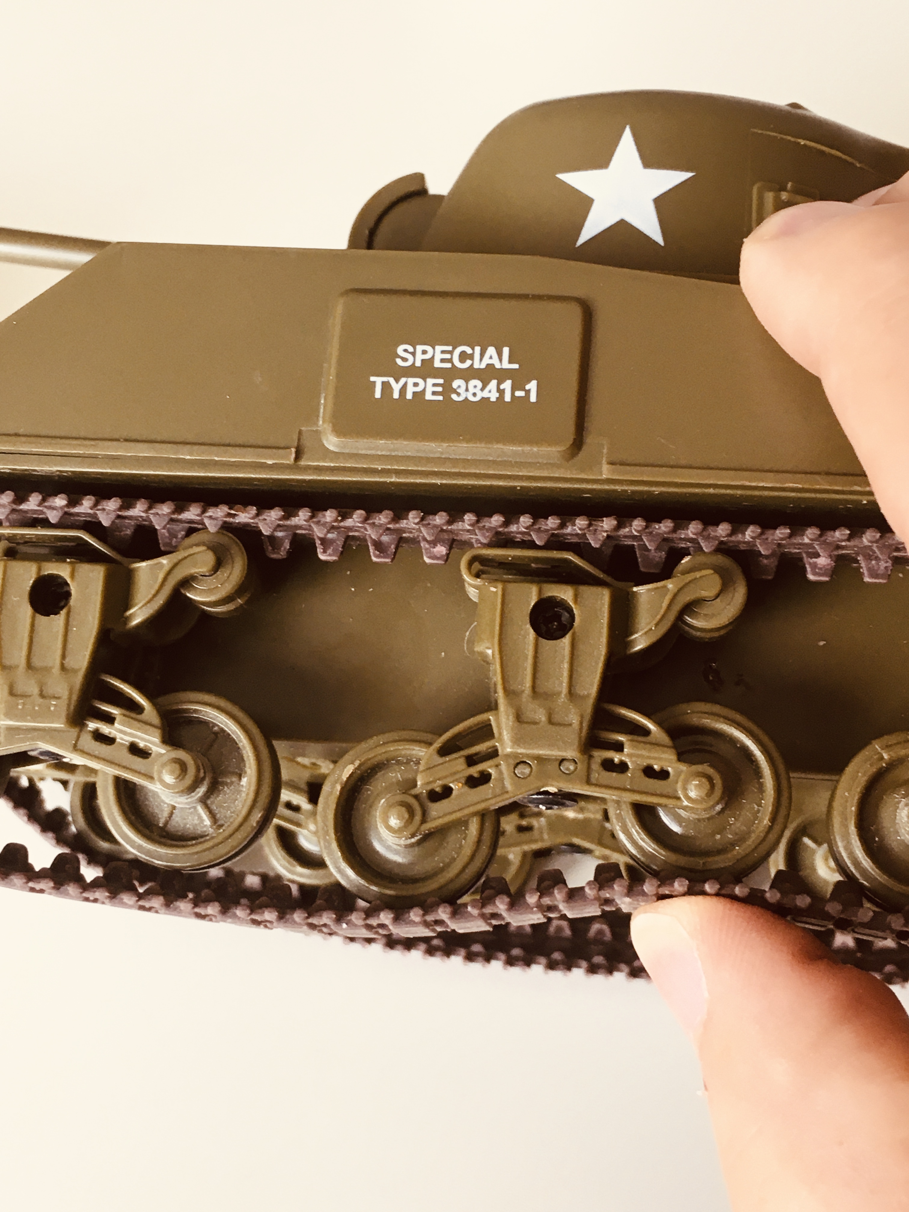

Yes those are non stock looking tracks on this Sherman. These tracks have a center ridge on the track which makes them "live track" for better track stability. This Sherman does not throw its tracks easily. The suspension bogies are also not stock looking with "leaf springs" instead of vertical springs used in the M4A3.

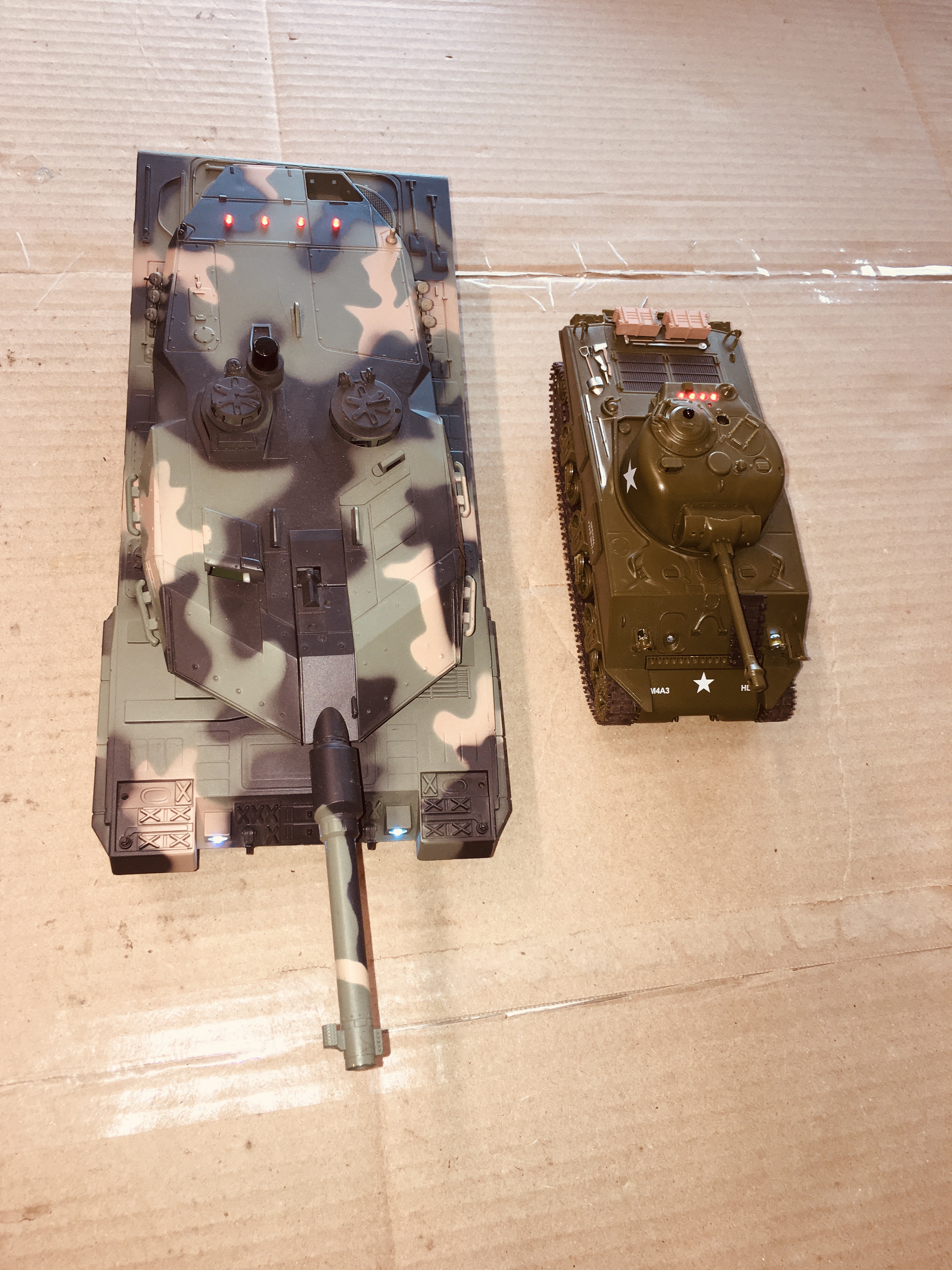

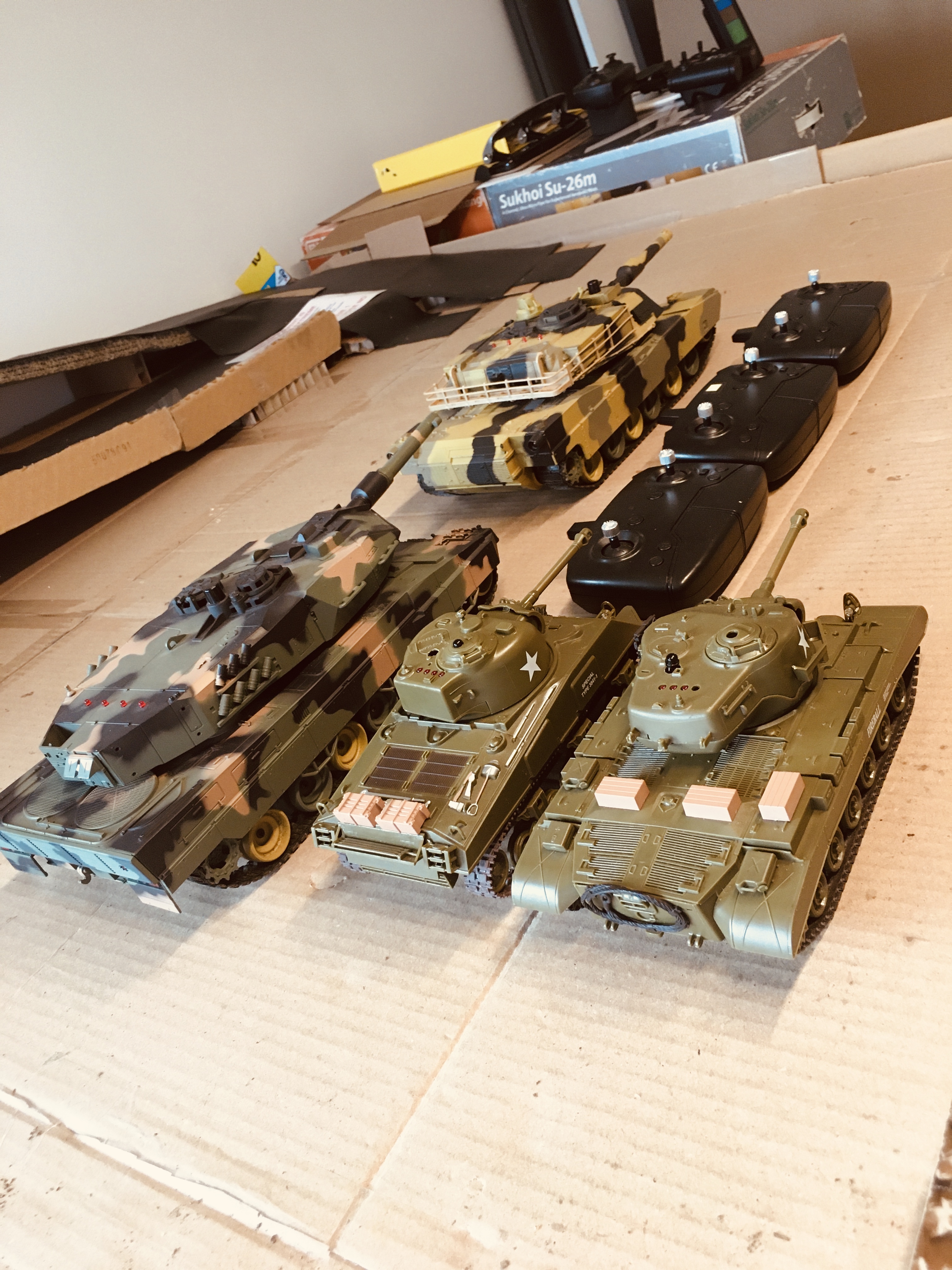

Here is a 1/24 M1 Abrams getting some new LED lights F\R plus LV alarm upgrade. The cut away battery box mod is visible here. This is a must do mod for both the 1/30 , 1/24 scale HL Tanks.

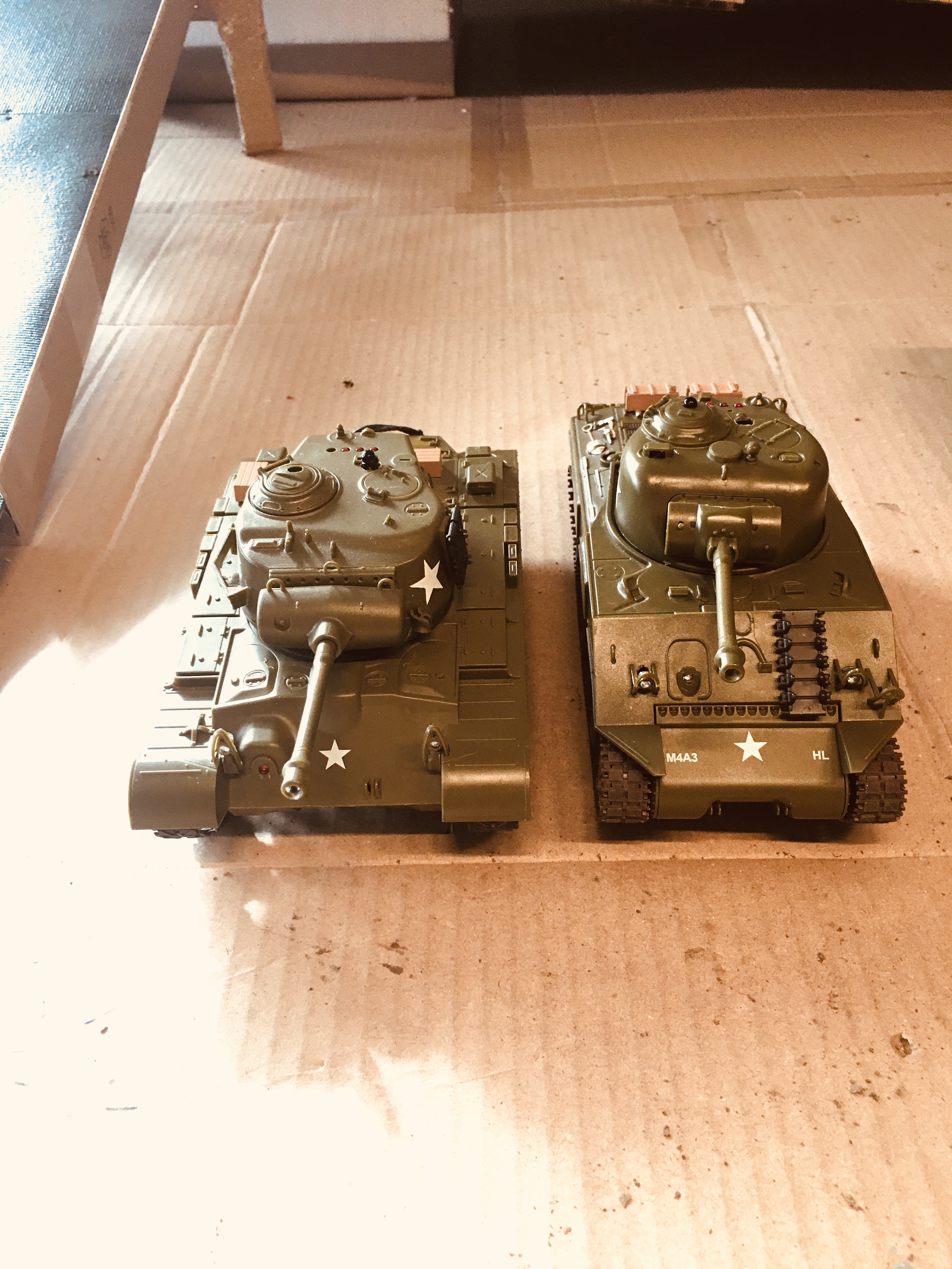

Both HL 1/30 battle tanks
M26 Pershing is the other HL 1/30 scale model

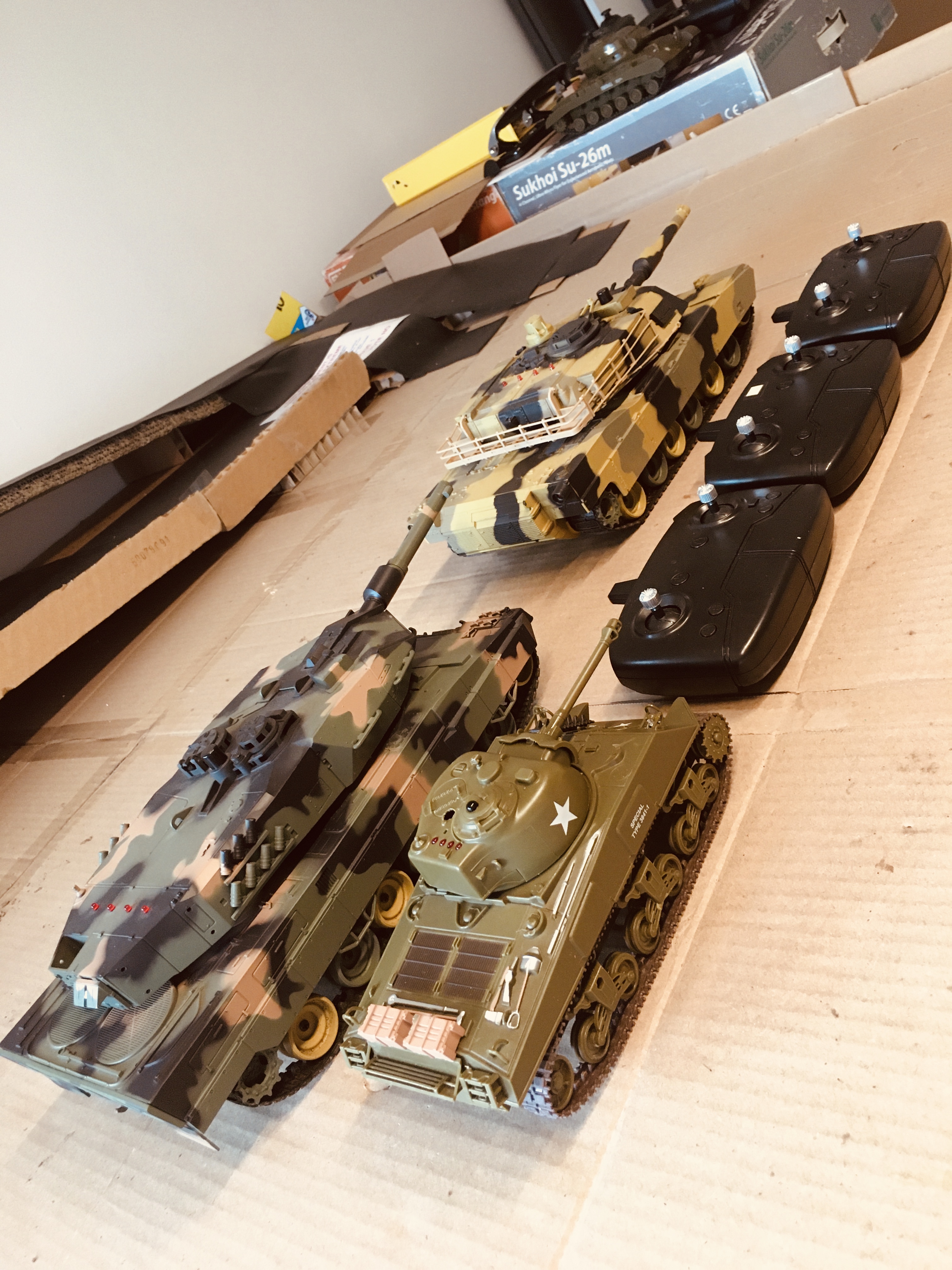

I run these outdoors

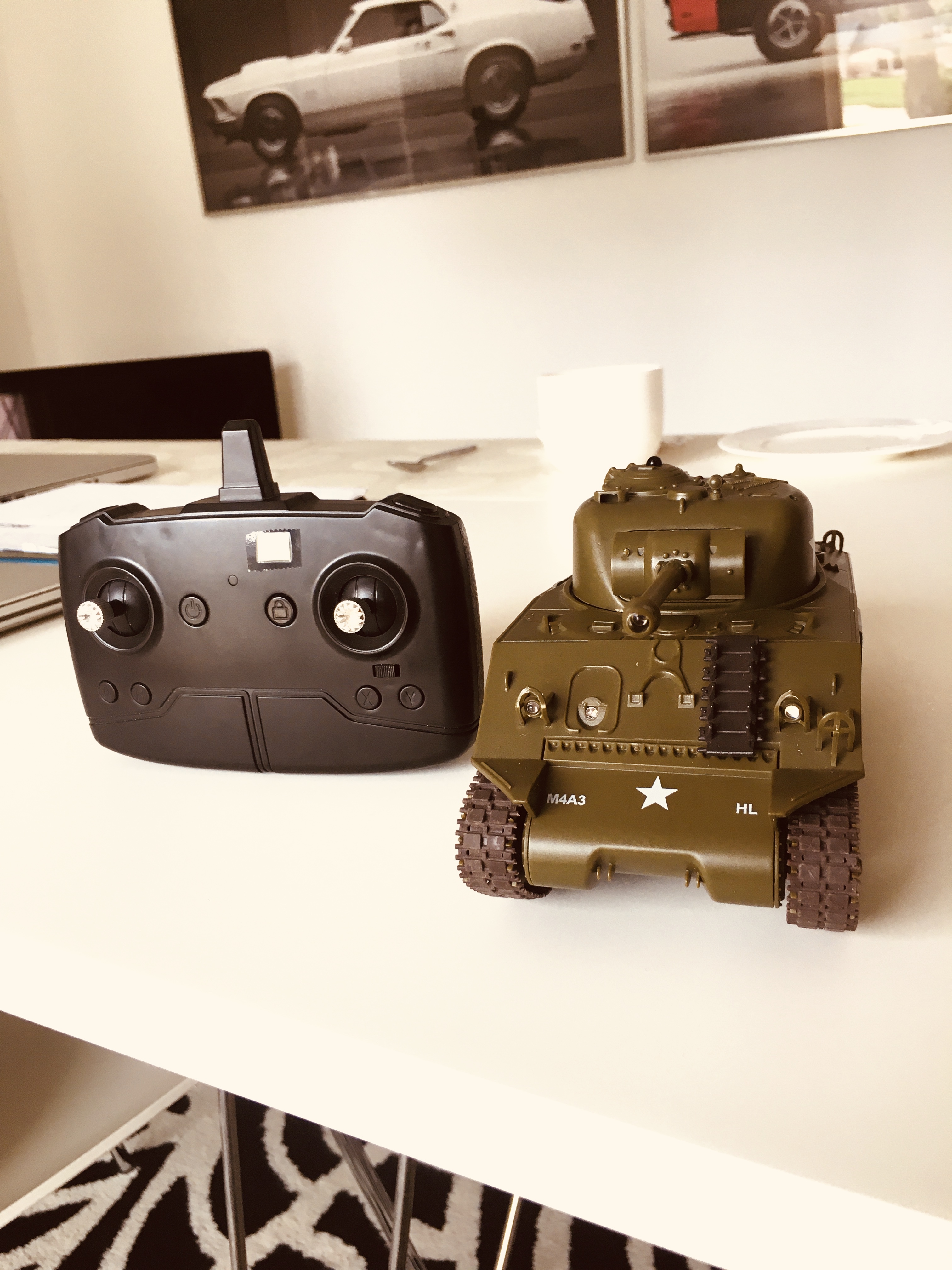

1/24 vs 1/30. The Tank controller board(s) are interchangeable between these two tanks. So what I have done here is mod the 1/30 Tank to 2s lipo. Works way better with 2s.

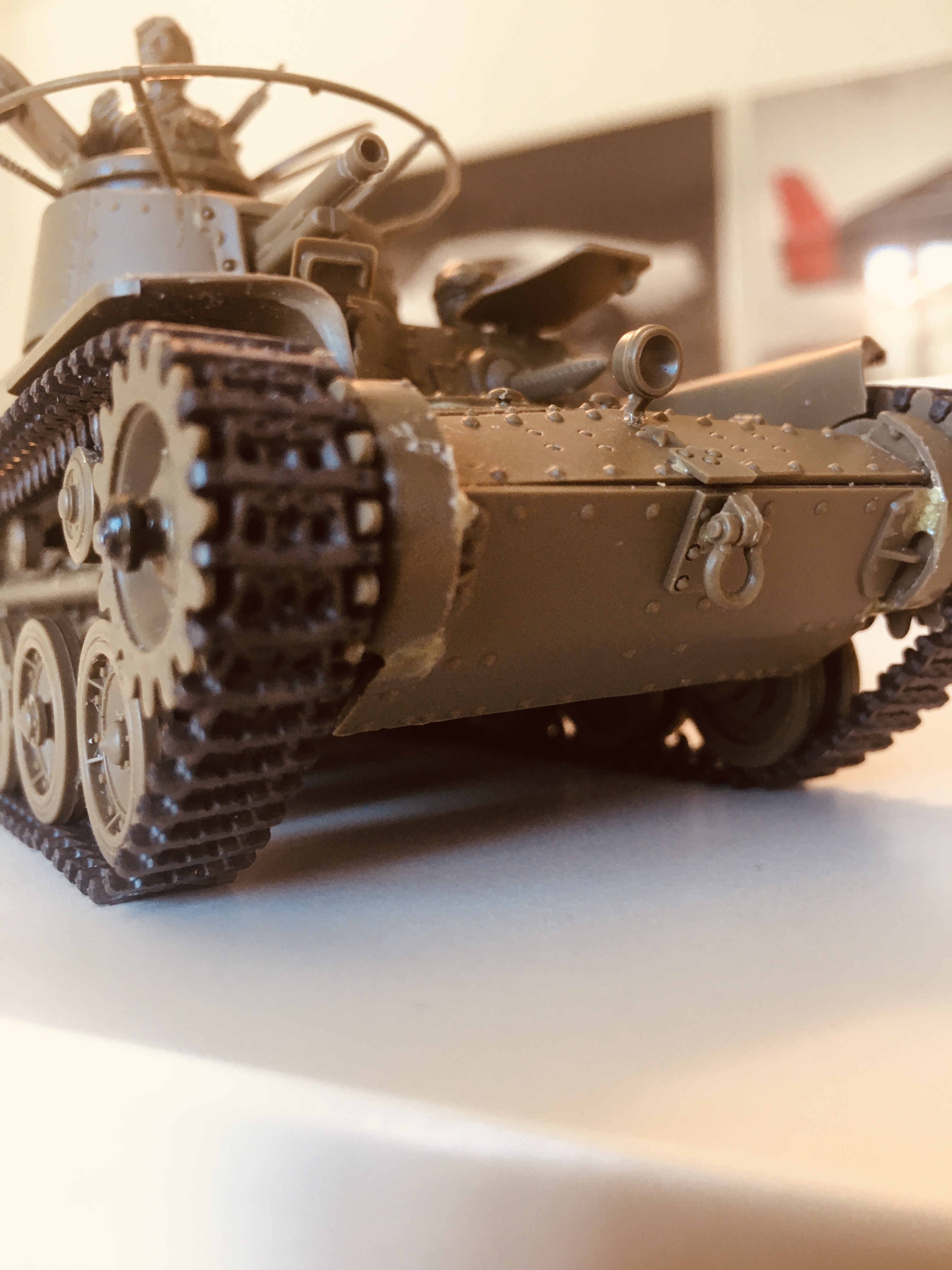

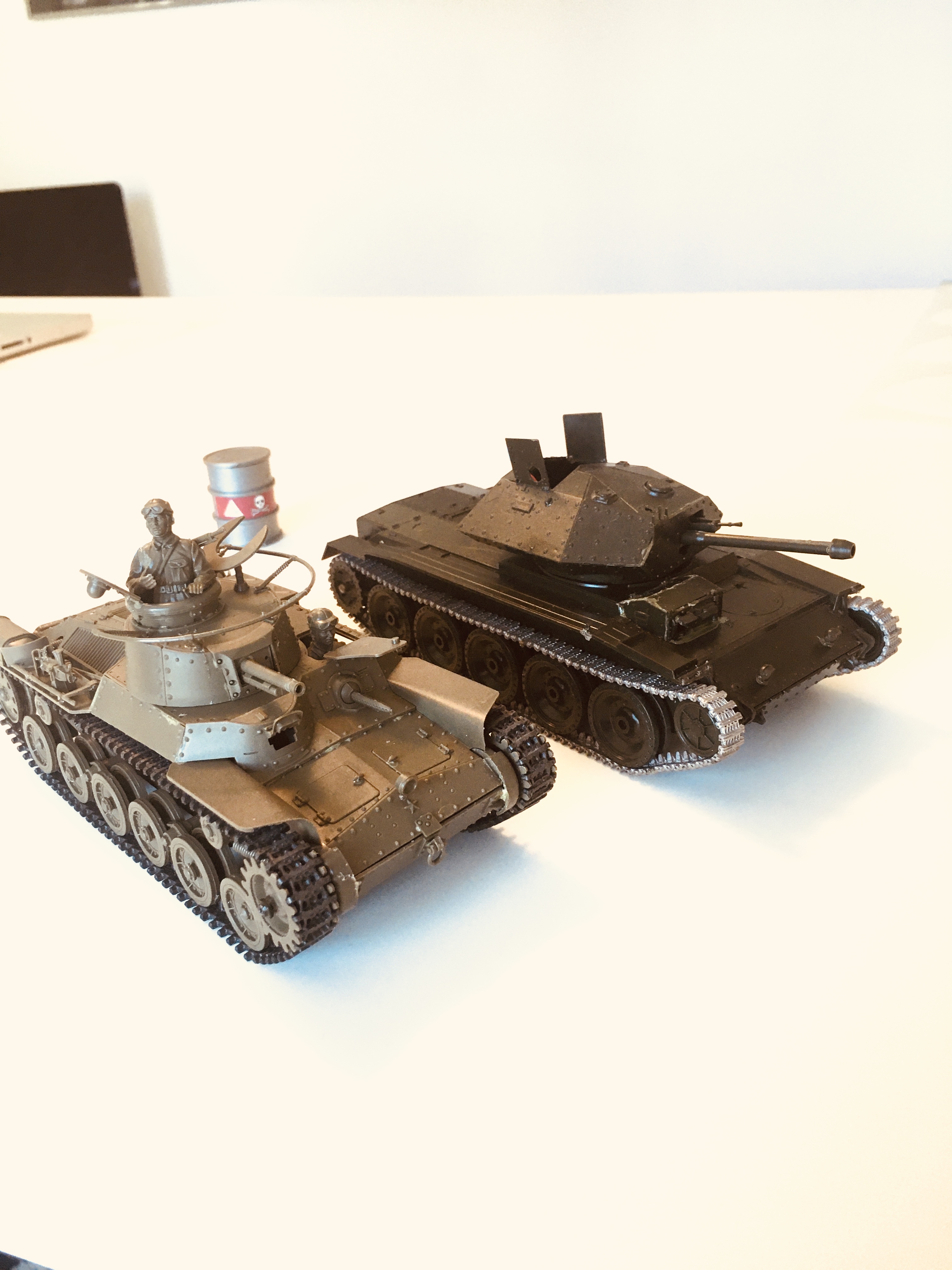

Yep, very little room for a driveline in there. In my mind, it is one of the best looking Tanks of ww2, right next to the British Crusader Mk III.
Beauty
Beauty
Type 97 and Crusader Mk III are the 2 most Challenging models builds I have ever successfully done.
Type 97 has a very small engine room.
