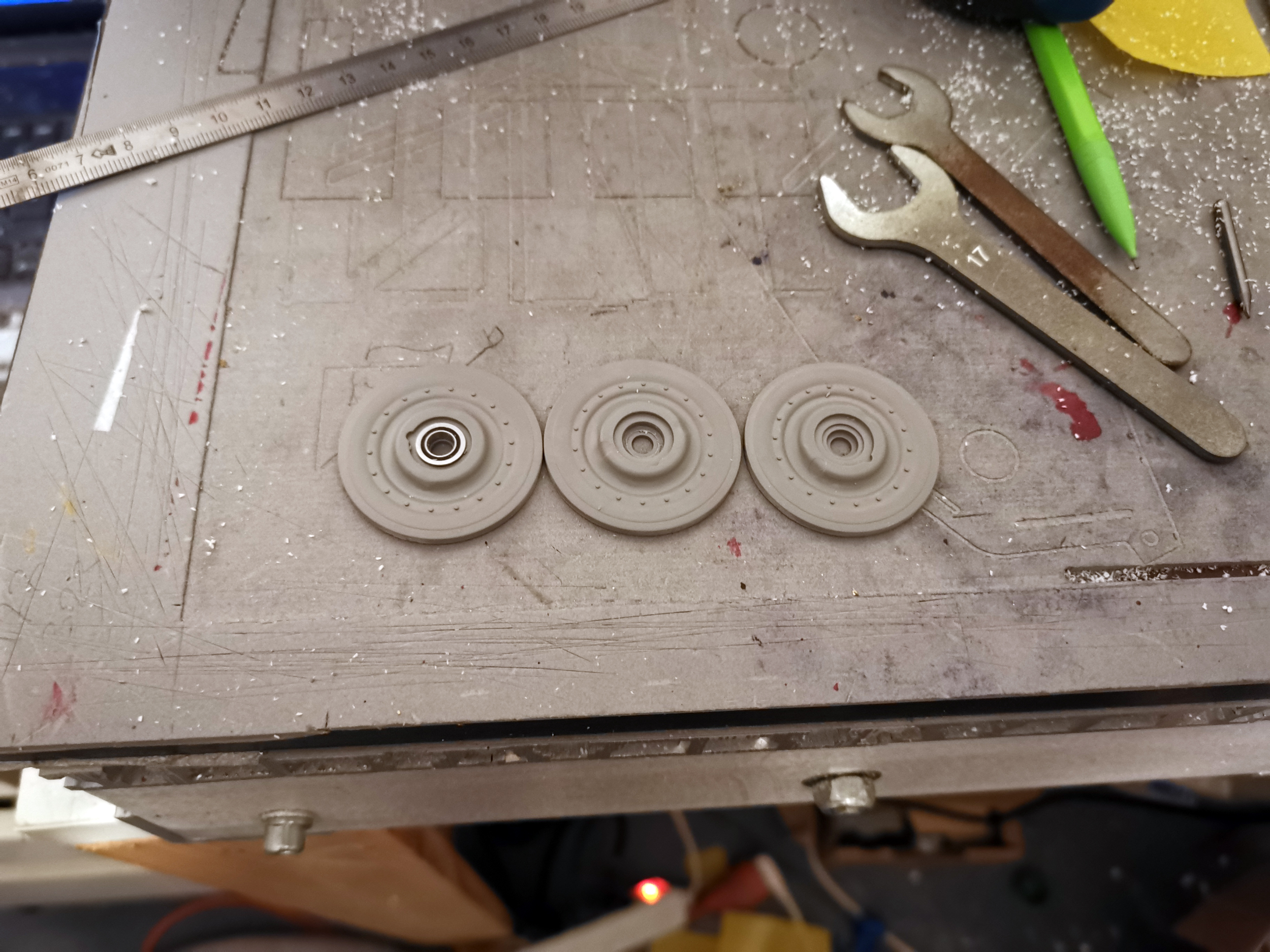

I put ball bearing on all the running gears.
For the road wheels I used flanged bearings.
I had to enlarge the existing hole and make it a bit deeper so I could insert them.
I havent put the wheels in the correct order but you get the idea : on the right the stock kit parts, on the middle the wheel with the modified hole and on the left the wheel with the bearing.

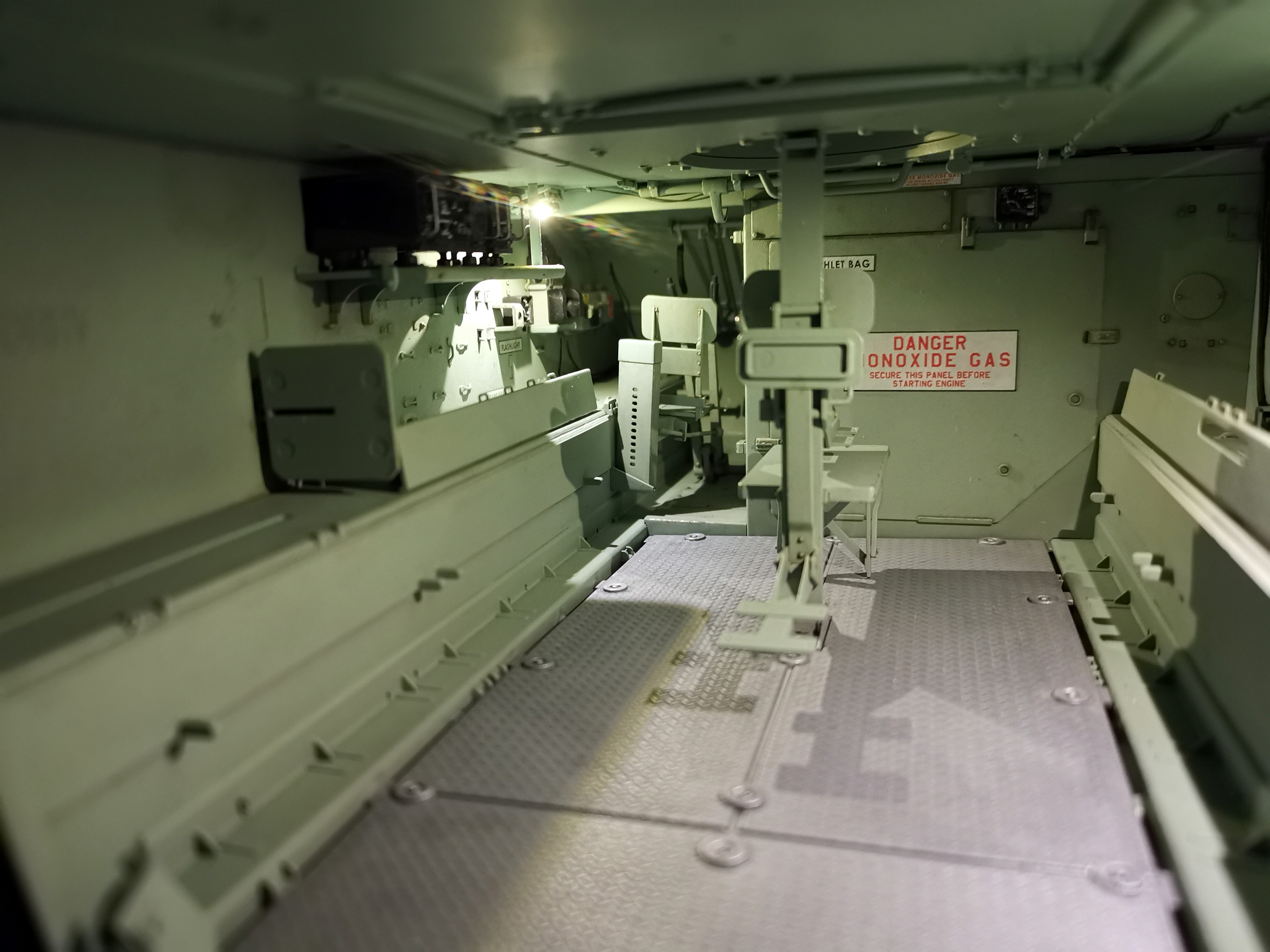

I have installed small warm white LEDs for the headlights and the inside.
That's where I am today.
It runs like a charm, I'm very pleased. Now I will have to paint and weather it and like I said, I'm not a Vietnam guy so I'm a bit scared about it.

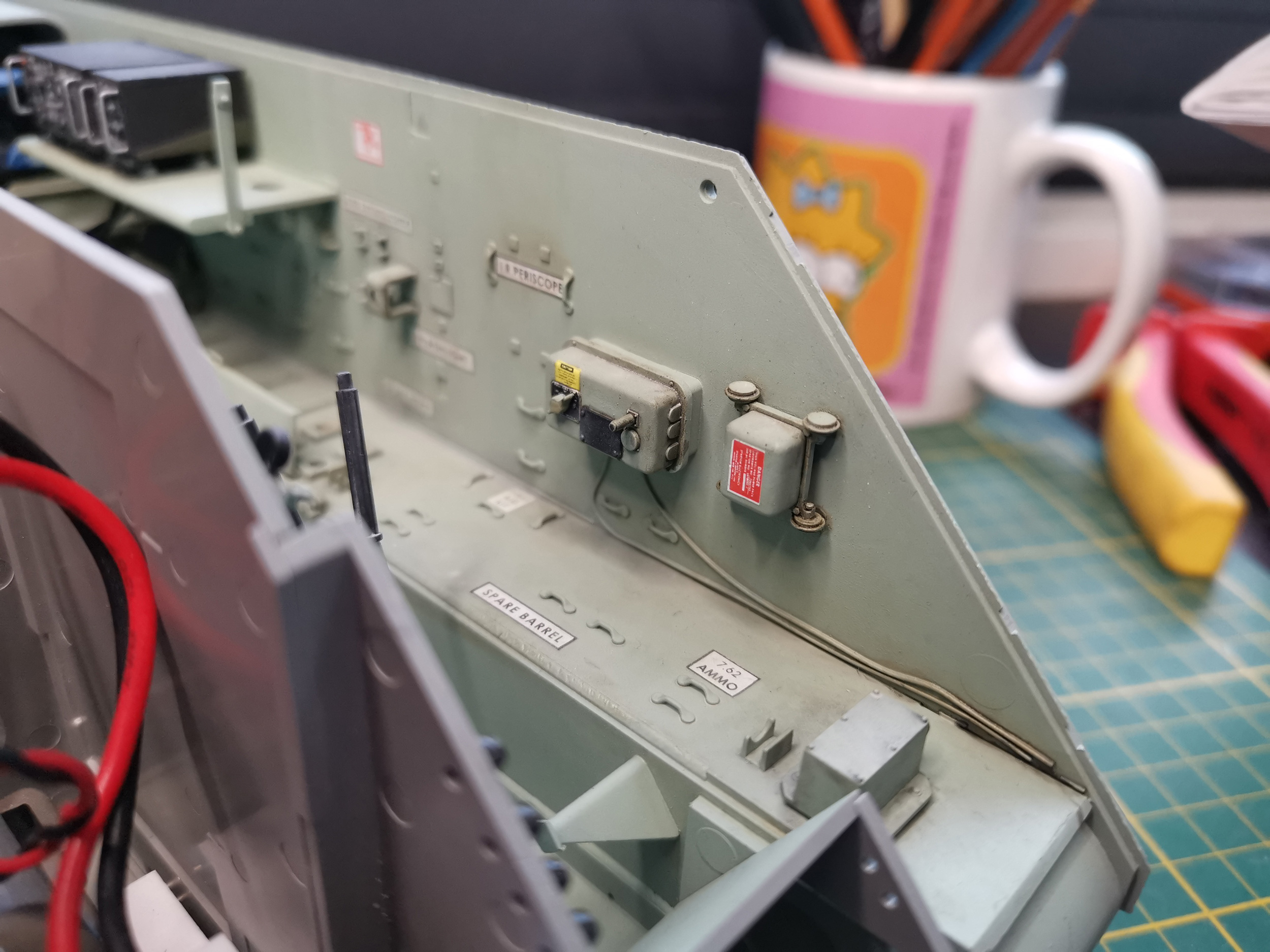

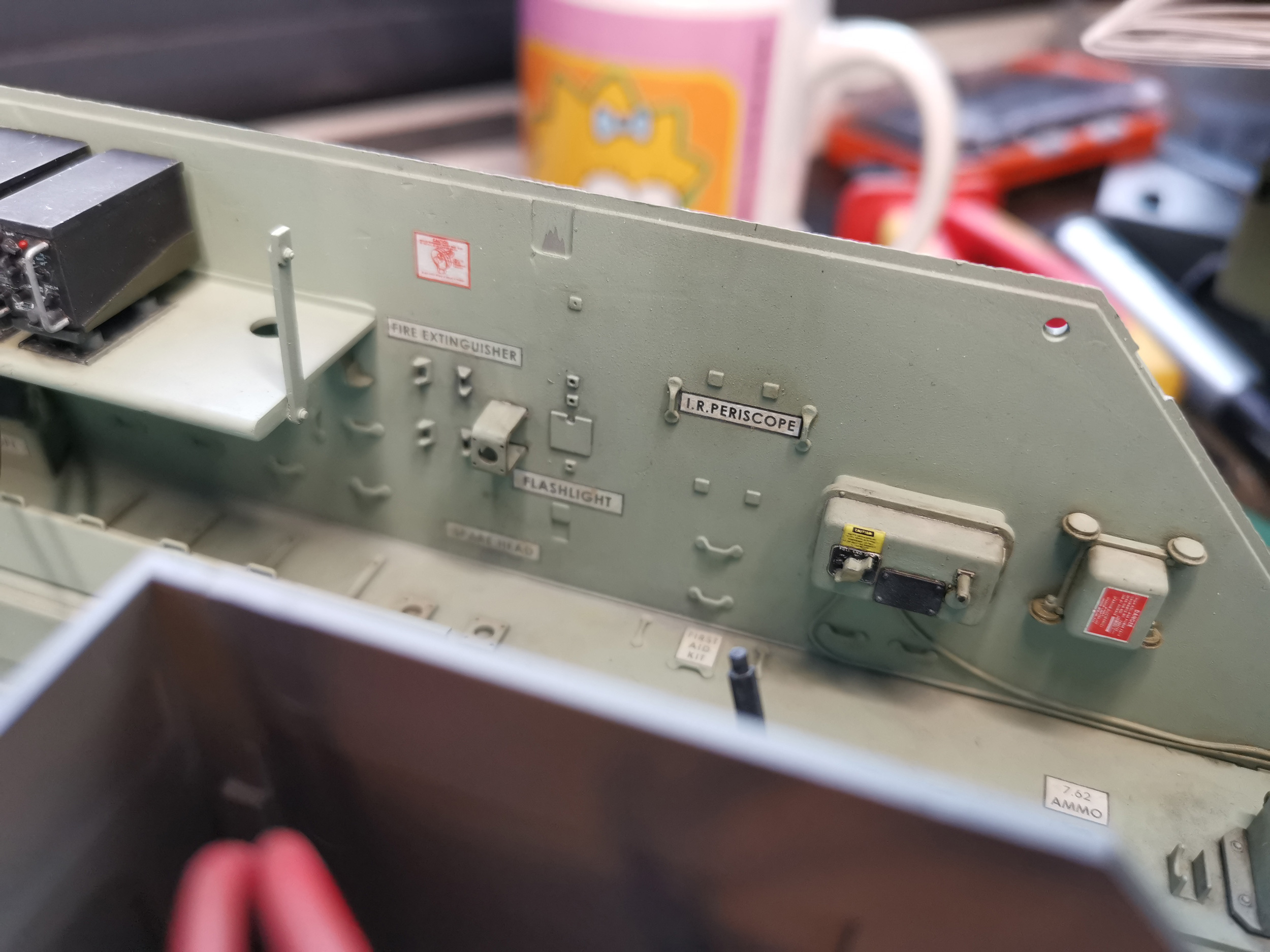

I have started to paint the interior.
I did a very light weathering, not sure if I should go further with that or not... I may just add some vietnam dust and that would be enough.
I still have some details to paint.
Putting the decals on the radio was quite a challenge, lots of them are not even 0.5mm :headbang:
Those drove me crazy !
My parts for 3D printing :

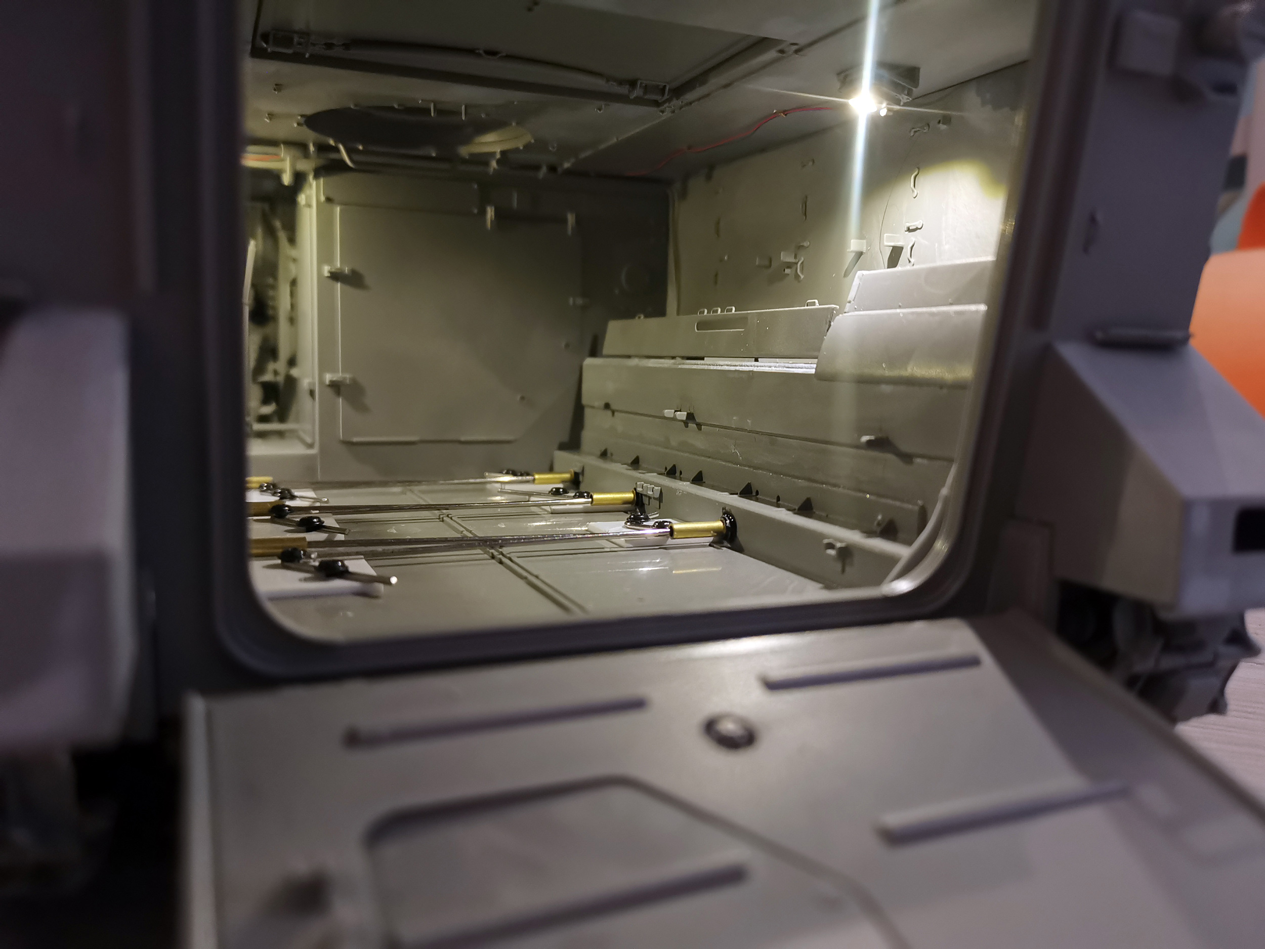

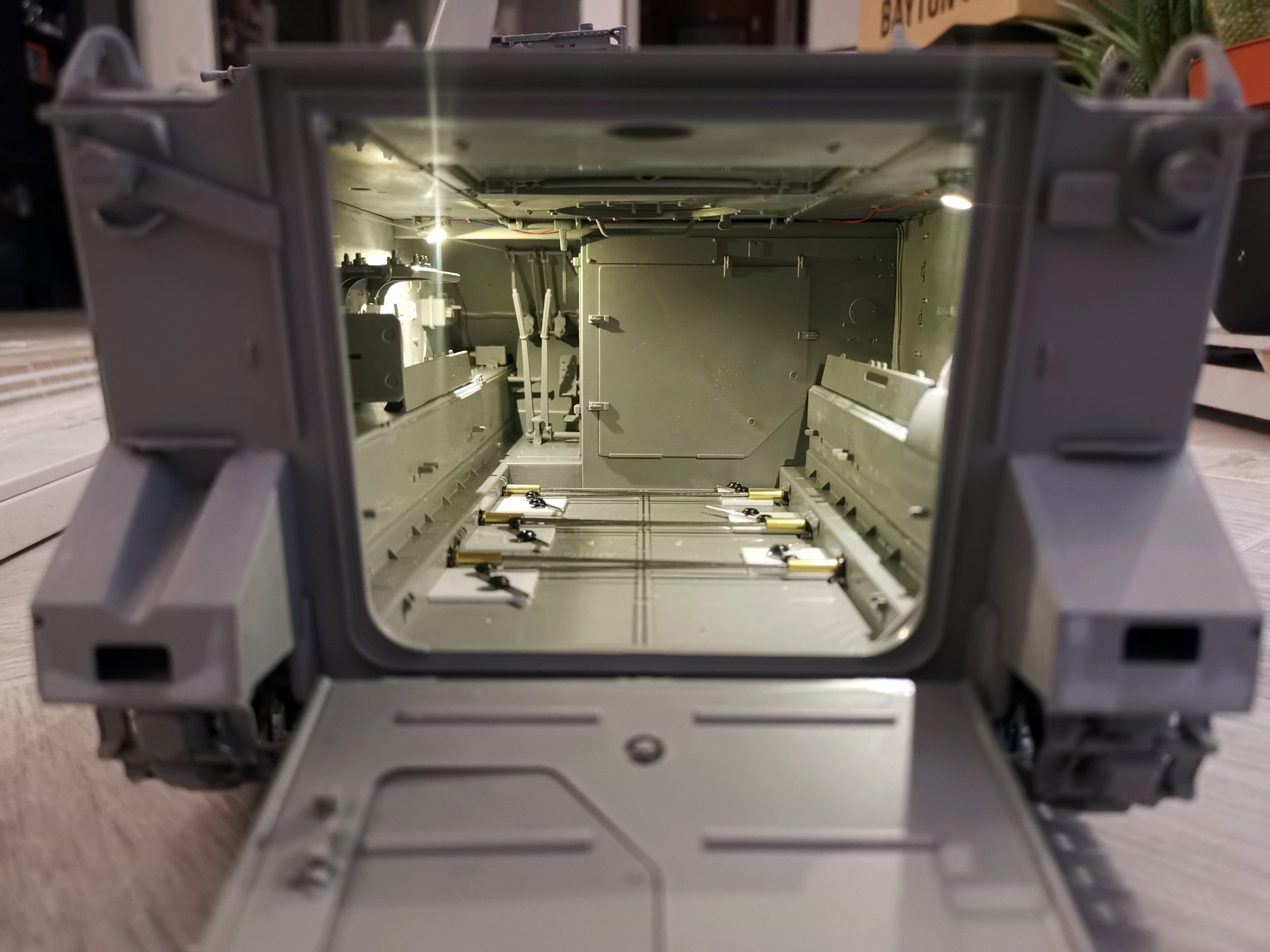

Some pictures with the lights on :
Not a lot can be seen through the driver hatch :

Some news pics, added more wires, some details on the right wall that were missing, the glacis is now fixed. I've put a small geared motor to operate the rear door. I managed to get the wire under the floor but the motor has some hard time to close the door. I had a better geared motor (with worm gear) but it has too slow RPM, it was taken forever to close or open... I ordered more with higher RPM but I was too in a rush to close the front.
Putting the floor was quite hard, fit was not good at all I had to do some serious trimming in order to get it where it should be.
