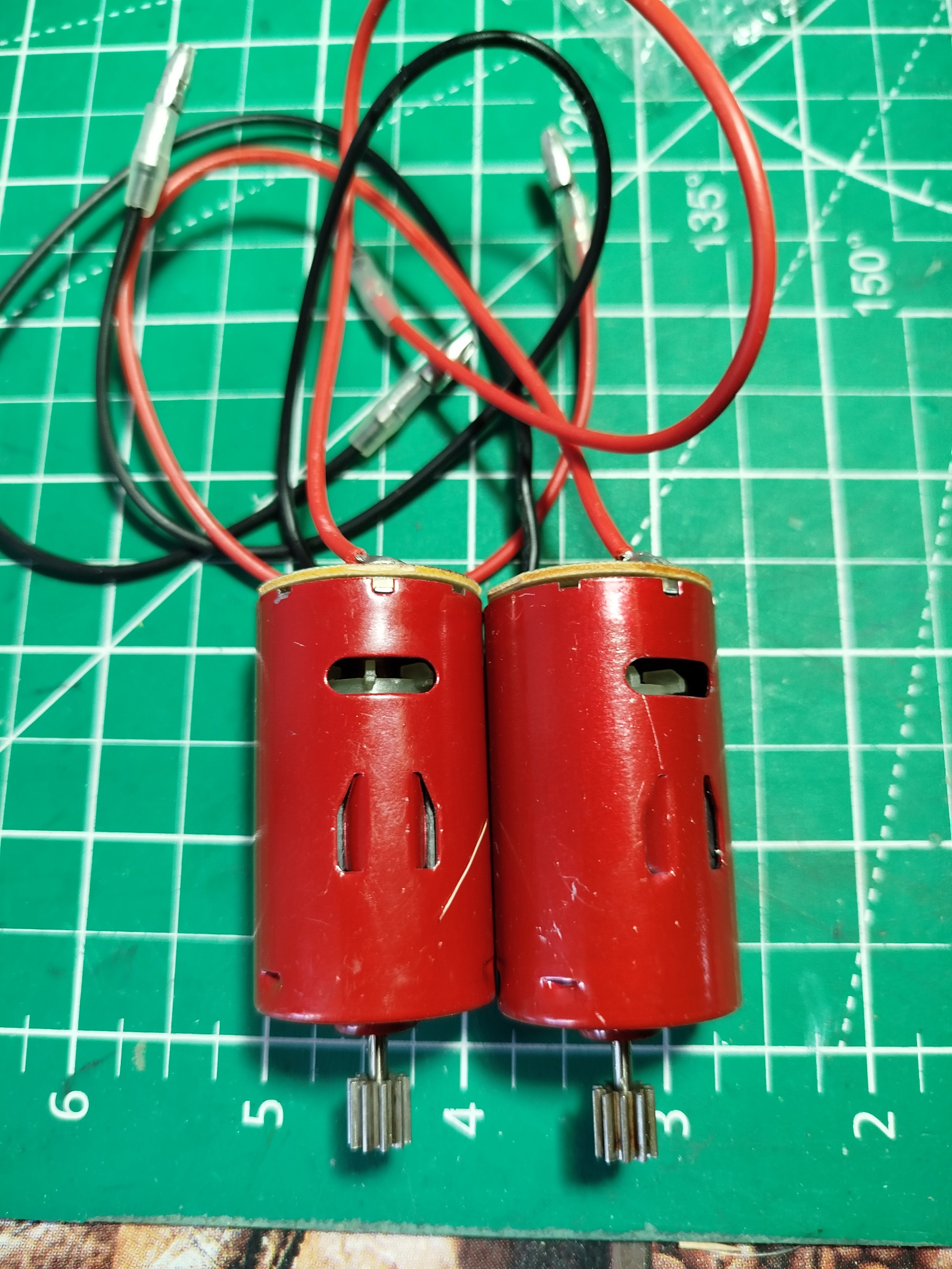

I reckon if them motors are red, it automatically makes it go faster!!

Red motors are the 390 series
Regular (silver) 370 series.
The Red ones have a fan inside to cool the rotor winding and in principle it has better characteristics.
There is a 400 series, but it simply won't fit between the gearboxes.....

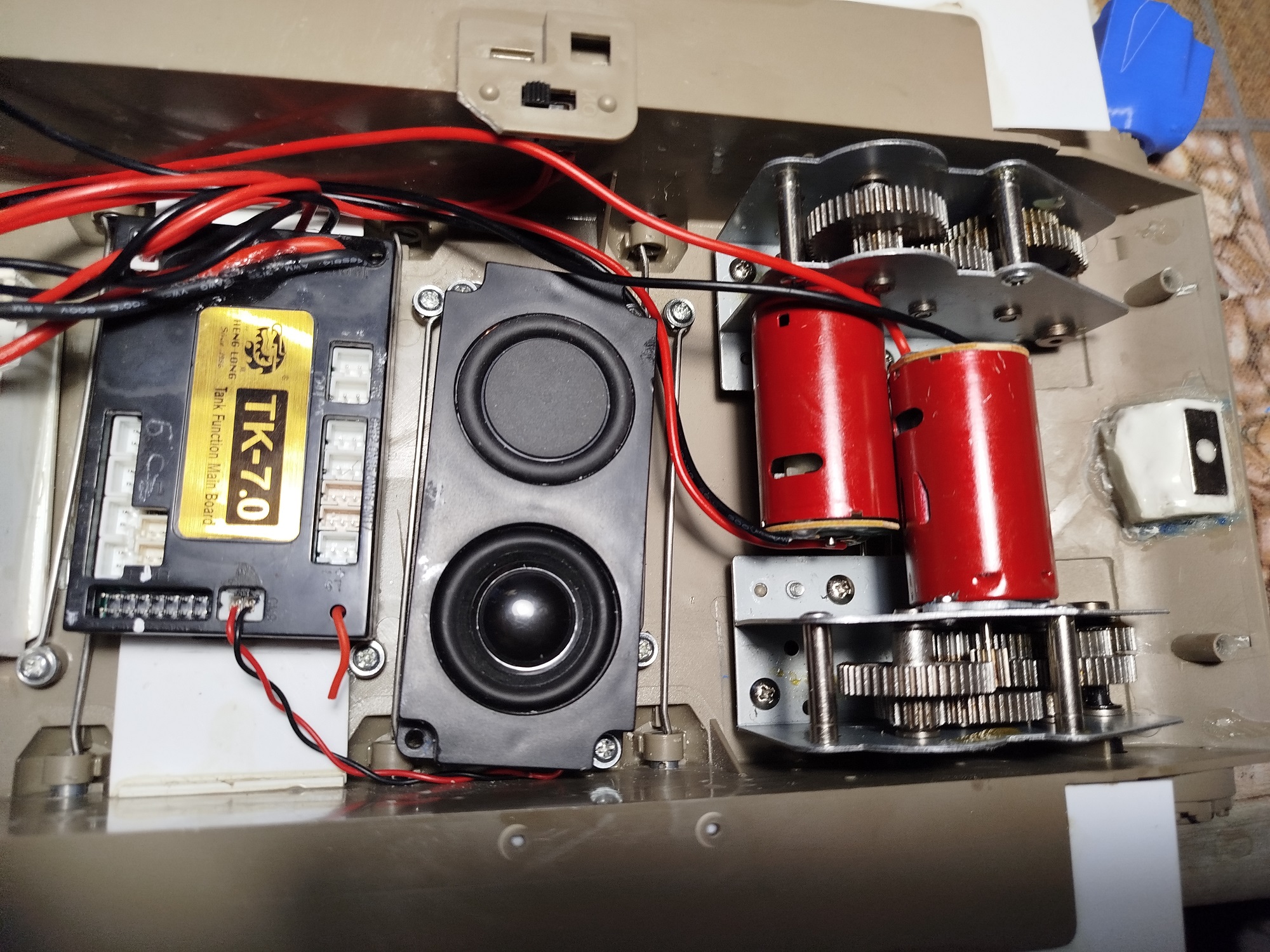

Re: MERKAVA MKIV מלחמת חרבות ברזל WAR OF IRON SWORDS,GAZA
Installed it... haven't tested it yet.....
