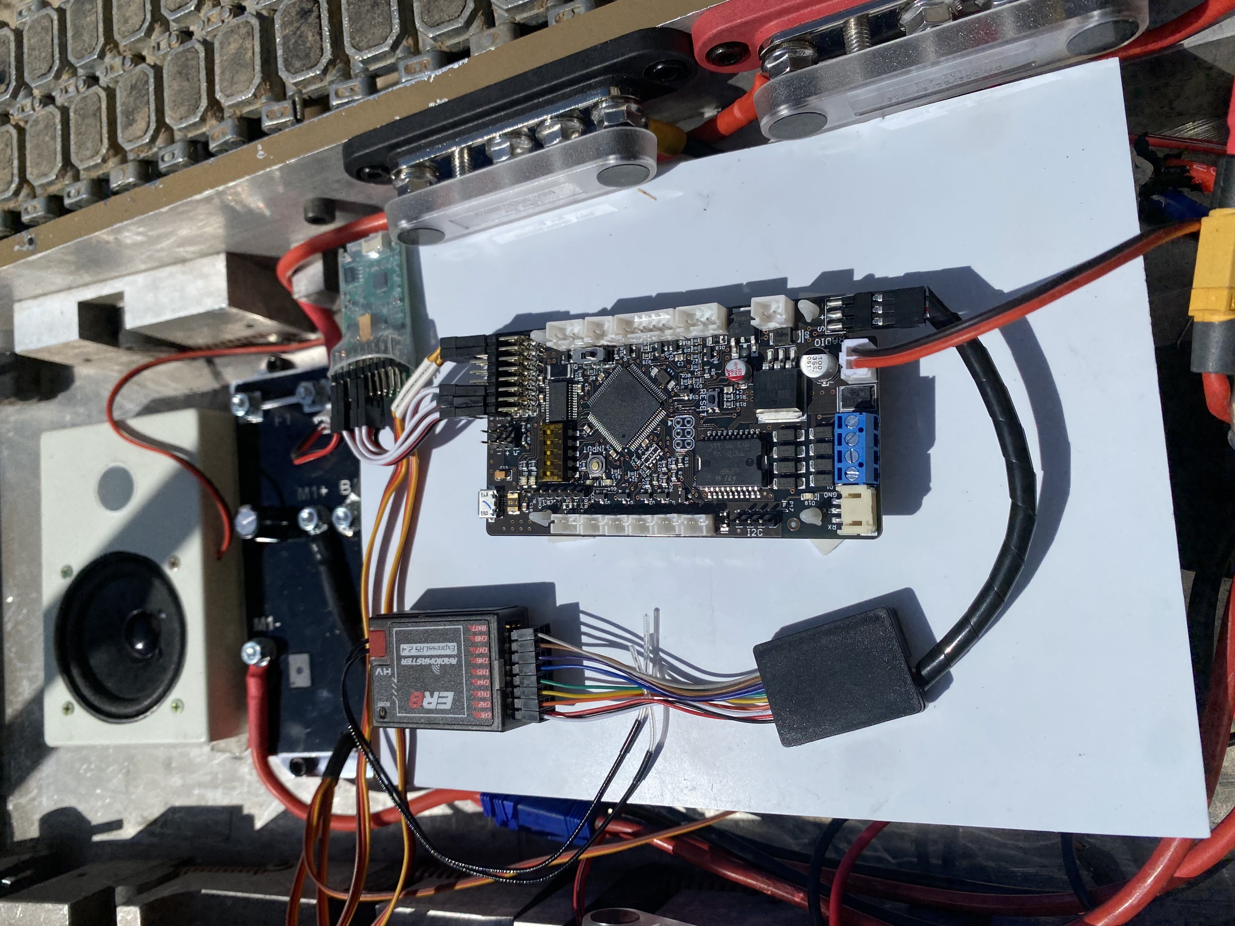

Update on the electronic rebuild, finally got the OpenPanzer TCB build working, mostly. Really nice to have my Abrams sounding like an Abrams now.
Most of this weekends work was on the chassis, but I did get a lot of work done on the turret, so hopefully I’ll be ready for an initial test of that soon as well.

Figured out how to get the amp going, kind of. My solution for this for right now is having a separate battery for it. Makes the speaker nice and loud though. Still need to play around with the DasMikro and figure out why the sounds other than the engine are getting ducked when the engine is on.
Got my SGS TVC-GSU-12 to work for turret rotation, but not elevation. Finally figured out why today (it’s expecting servo input, not ESC input). I don’t have a work around for this right now, so I’ll just have to live without barrel stabilization for a little while.
Next big hurdle is going to be getting the Airsoft mechanism running again. After that it should mostly be down hill.
