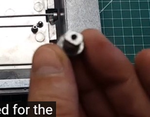

I am in the process of upgrading my HL Leopard2A6 with a Torro metal lower chassis. I found many features that I like, but the installation is nothing but smooth.
The Torro chassis came with the suspension arms pre-mounted. When I mount the roadwheels, I found the arms wobble a lot. I finish anyway and test drive it in the basement. The driving seems alright, but the straight dash run is not as smooth as I expected.
I had similar arm wobbling problem with the TongDe M60. I solved the problem by replacing the nylon rings with ball bearings on the torsion bar axles. It is now the smoothest running tank I have.
The Torro design is very different. The torsion bar suspension arm axle is a simple plug goes into an oversized hole on the chassis wall. Torro use a rubber O-ring to seal the gap for water proof. No ball bearing is allowed.
Any suggestion on how to improve or eliminate the suspension arm wobbling?

Can any Taigen/Torro RC tank owner tell me whether they ever see any wobbling of the torsion bar suspension assembly. Is that possible that I get an defective chassis with oversized holes on it?
I have paint the chassis, but it is only 2 weeks old. Getting warranty service may be difficult since I purchased the parts from Germany.

keilau wrote: Tue Mar 11, 2025 2:41 pm ...I had similar arm wobbling problem with the TongDe M60. I solved the problem by replacing the nylon rings with ball bearings on the torsion bar axles. It is now the smoothest running tank I have.
Do you have any images of how you installed the ball bearings on the torsion bars on the M60 please? I have one of these TD M-60's too, the metal edition. So unless the manufacturer fixed the problem by now, I'm anticipating issues if I try to actually drive it. I'm not sure how a heavy tank, supported by ill-fitting torsion bars, will drive especially hauling all that heavy metal?
