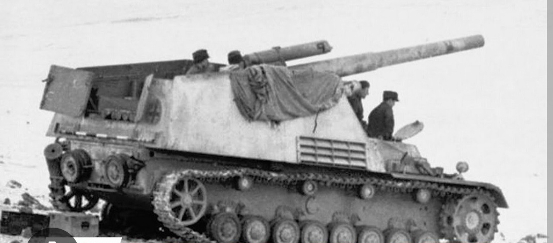

Tarps look really nice. Initially, I thought your big side tarp looked a bit too lightweight and droopy, figuring they would've used heavy oiled canvas coverings. But you hit it bang-on when you look at this pic. Glad I wasn't a crew member in the middle of winter near Smolensk!

Thanks Mike. And thanks for the great picture which I'm saving to my reference library. I'm still not entire convinced with my large tarp. The color is a bit neutral and perhaps a darker color would give it the 'heft' I was looking for. But, I'm trying to curb my OCD problem, so maybe I'll leave it alone. :lolno: Thanks again.
