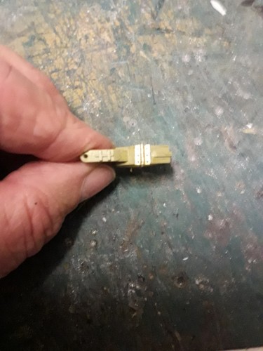

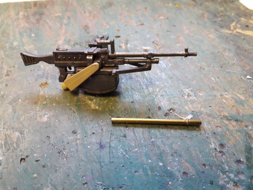

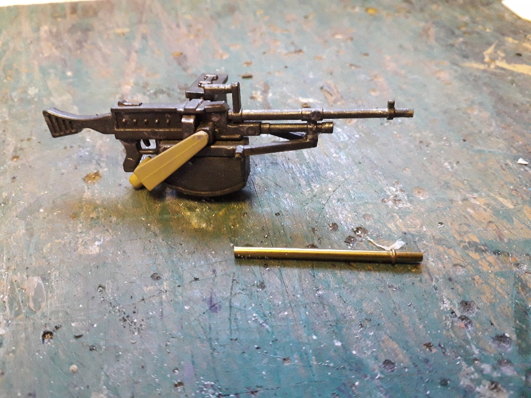

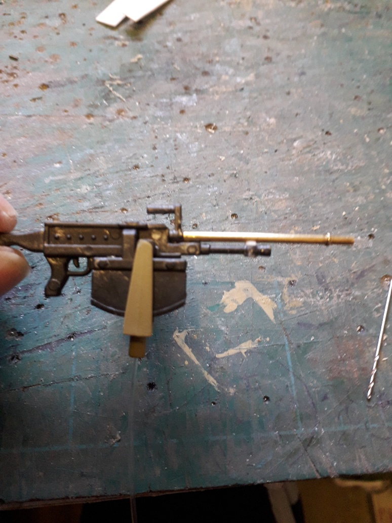

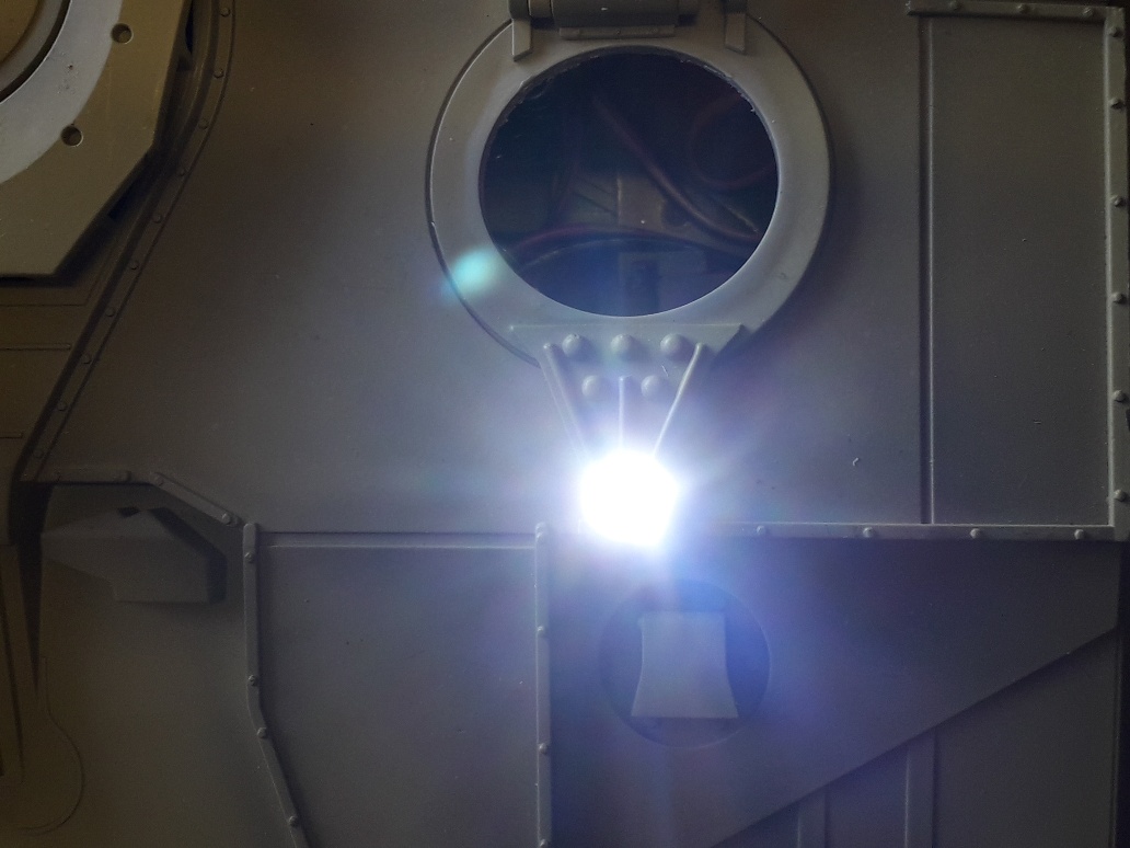

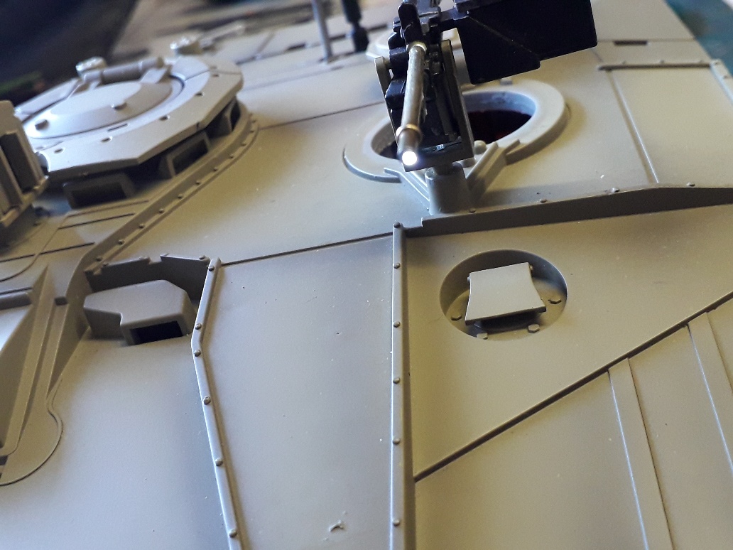

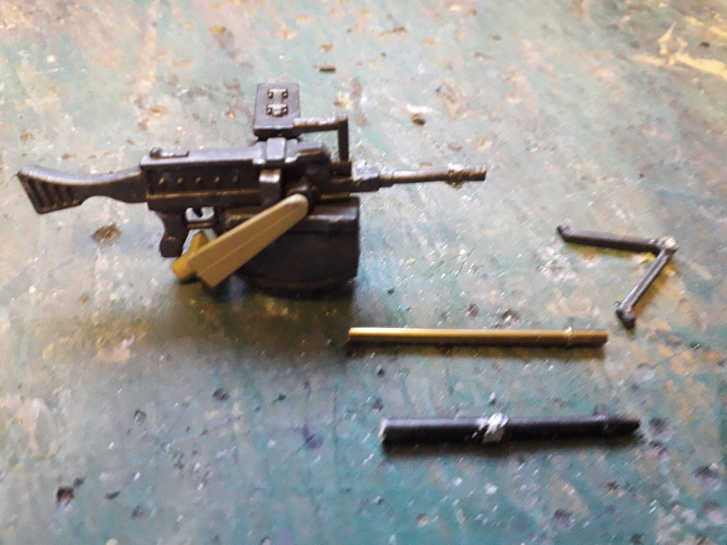

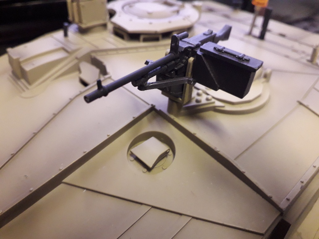

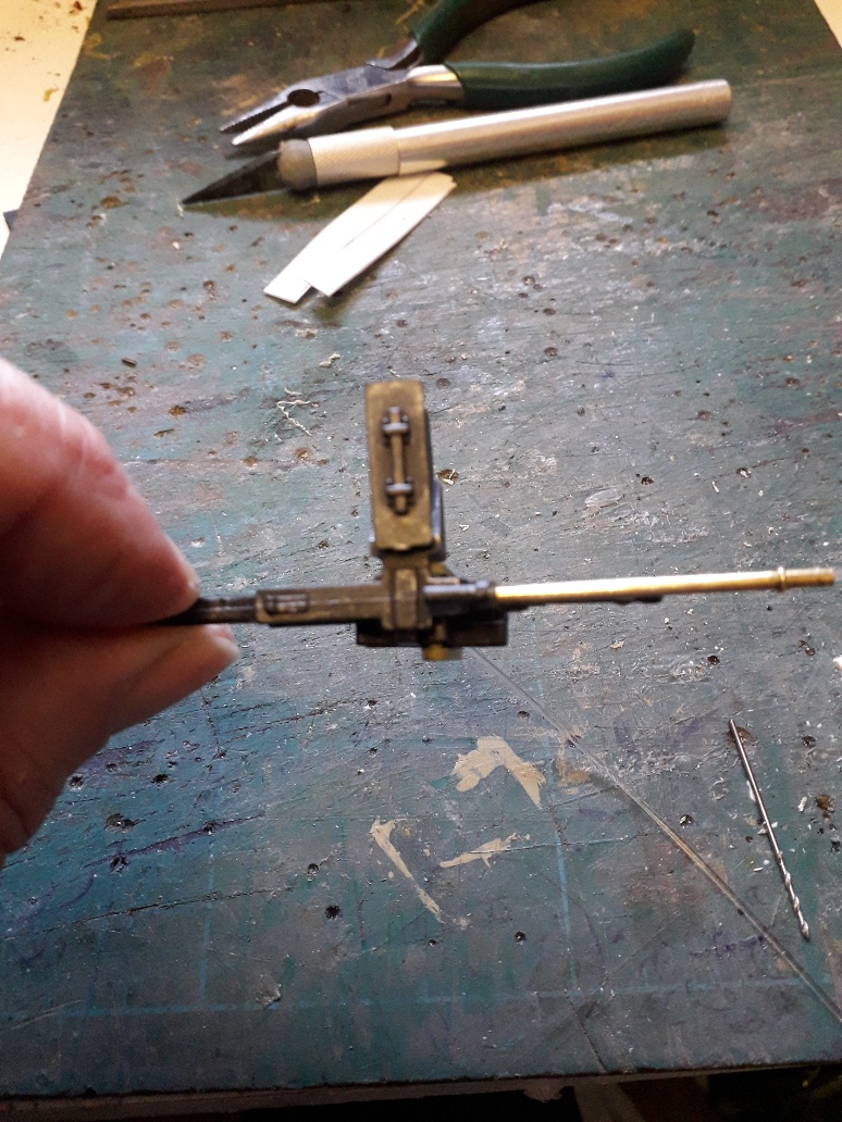

Little bit more done on my 2003 Op Telic Challenger 2, i have for the time being completed the Open Panzer refit and added the other electronics i wanted to make / fit, i will post a video of it shortly but first wanted to add / modify more of the tank body, i re made the wing mirrors from brass rod as the plastic ones kept getting caught and breaking.
I made the correct rear light clusters now painted and made some coloured lense covers, i have also made some rear IR recognition panels that fit on the rear bustlel of the turret.
I wànted the secondary gunners MG to functoon so i removed the solid plastic barrel and replaced it with brass and managed to fit a Fibre Optic cable and contained it all within the gun itself, so nothing is visible other that the gun itself, the gun and cable are one so i can remove the gun just by pulling it out the recess without any disconection as i have built the LED into the underside of the turret top and the gun just plugs in without having any re connection routine.
A few pics below hopefully show what i have been blathering about.
Regards Sub.

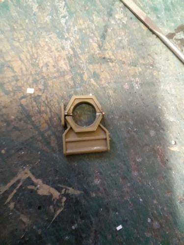

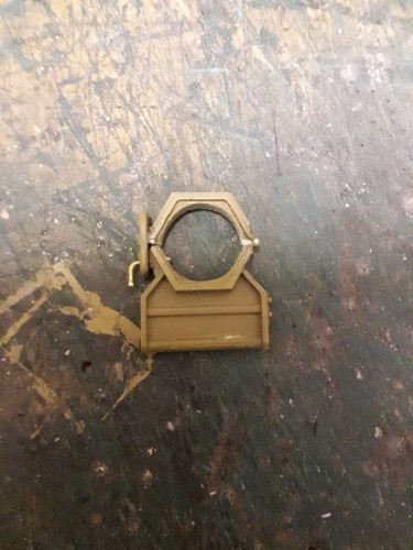

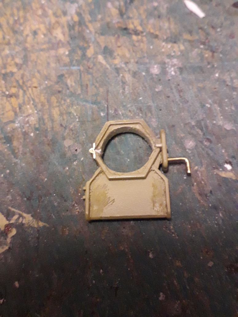

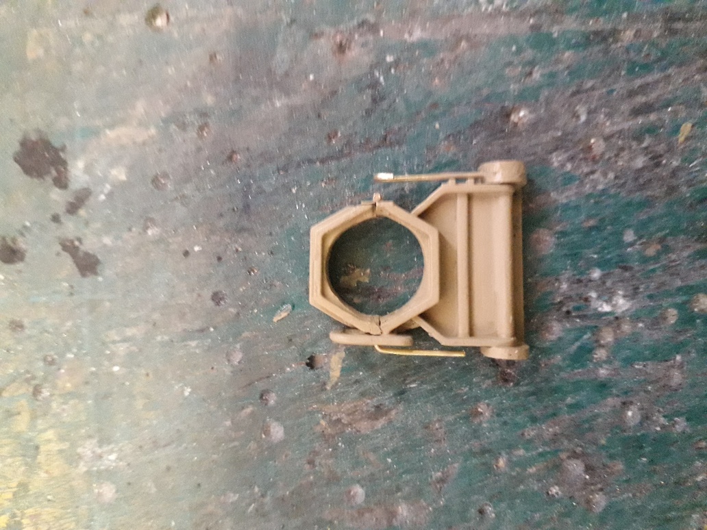

Hi.

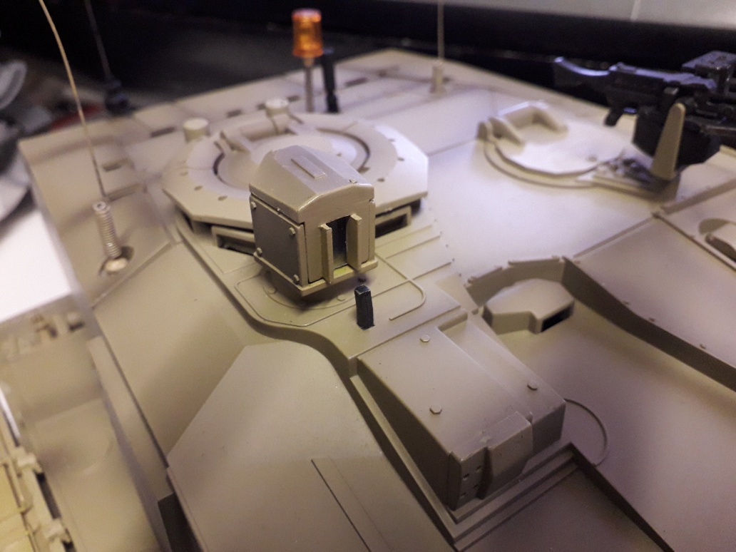

One more fitted back on the tank and with MG barrel foresight added..
I also added some doors and a lense to the commanders optical sight and have it rotating from the TX.
Sub.
Sub.

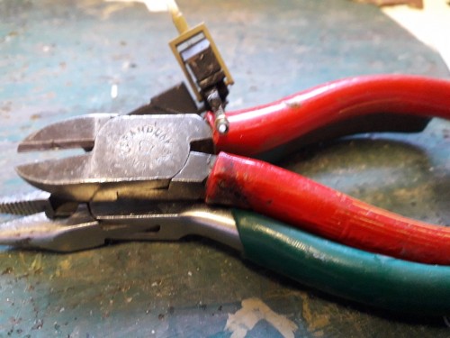

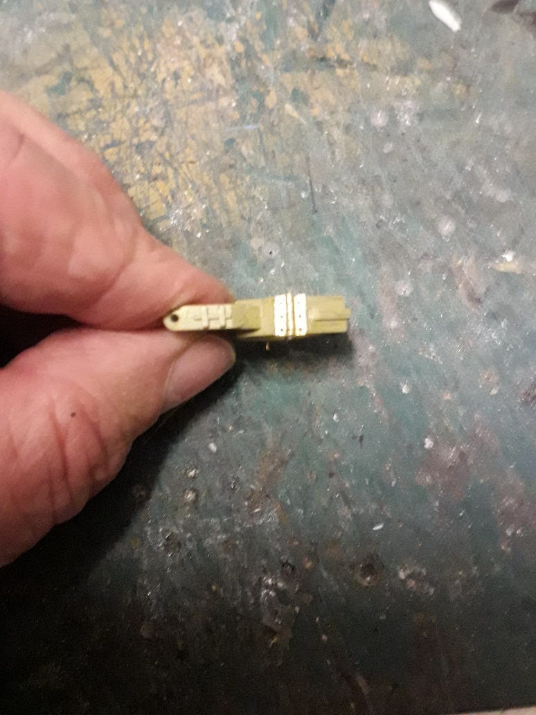

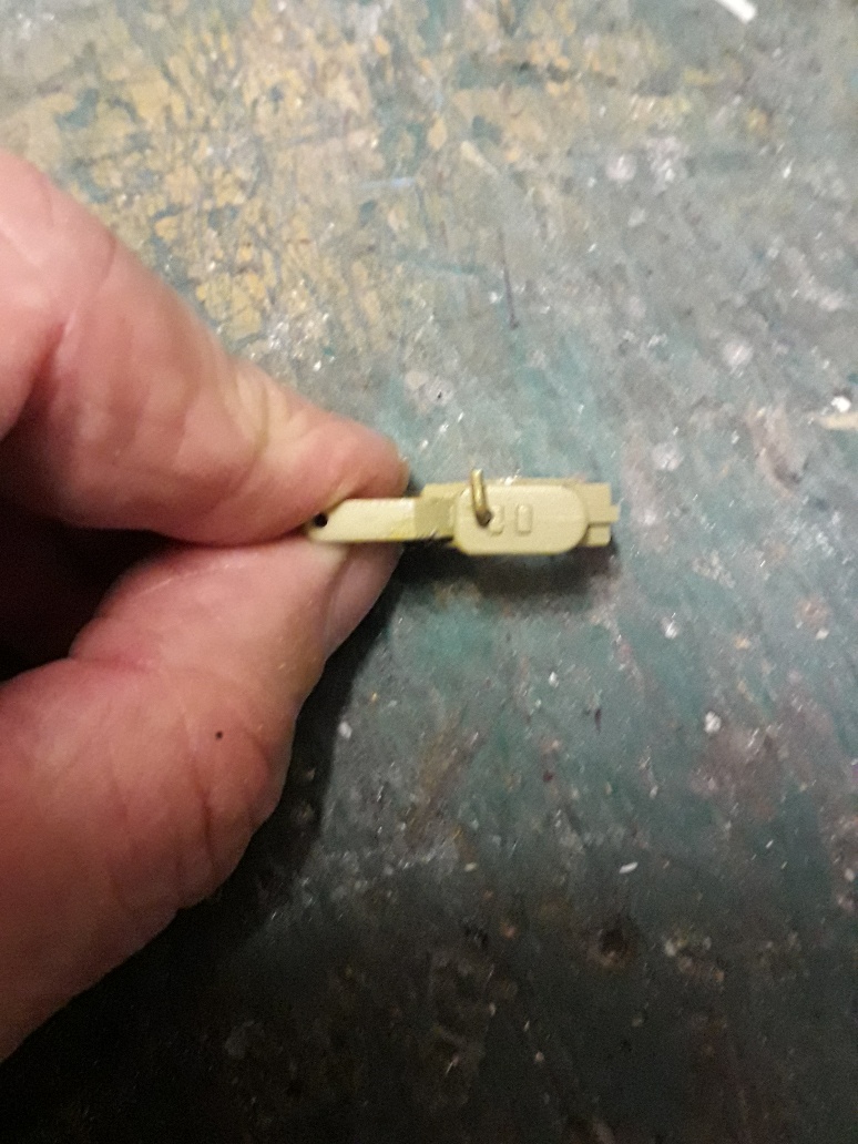

Hi.

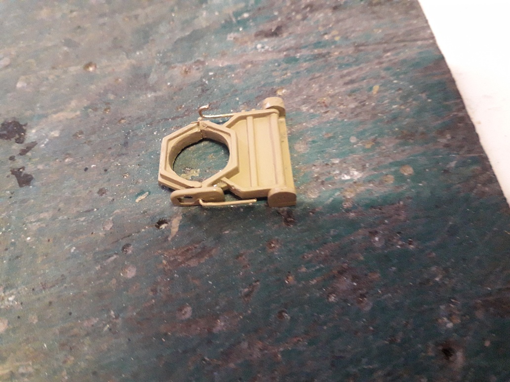

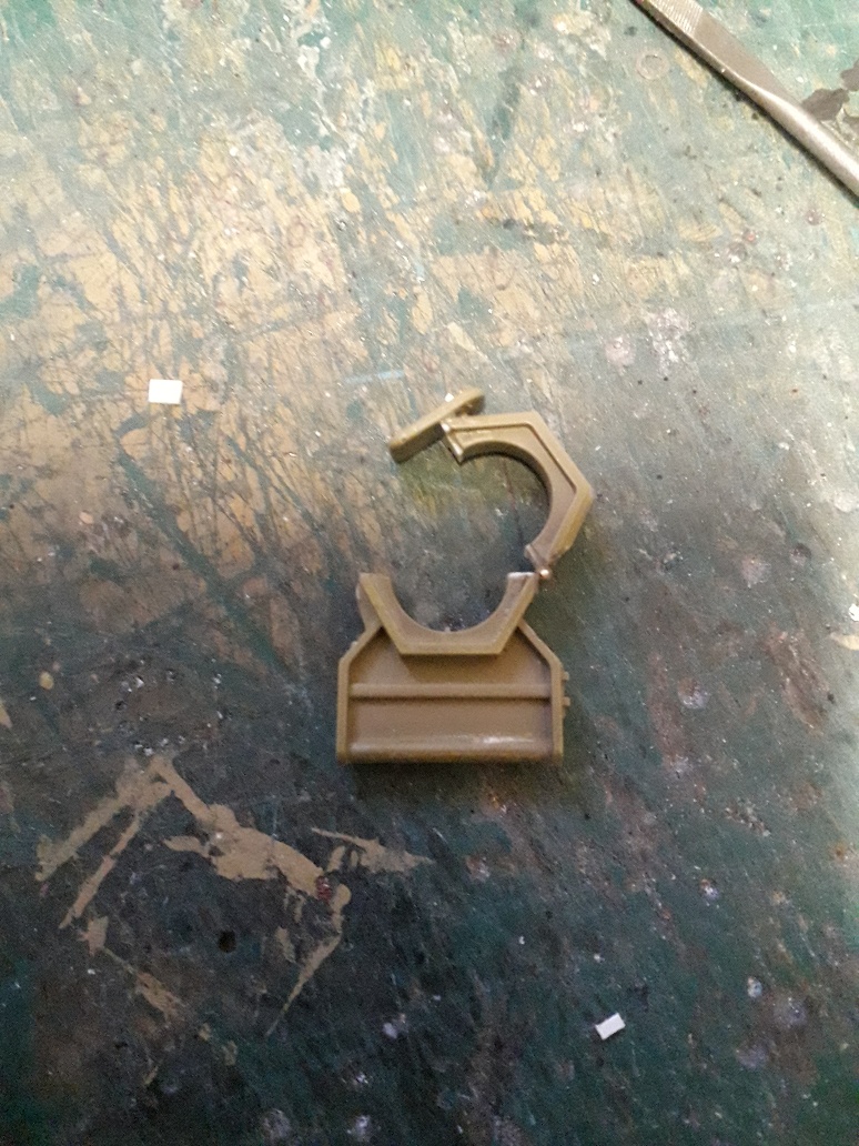

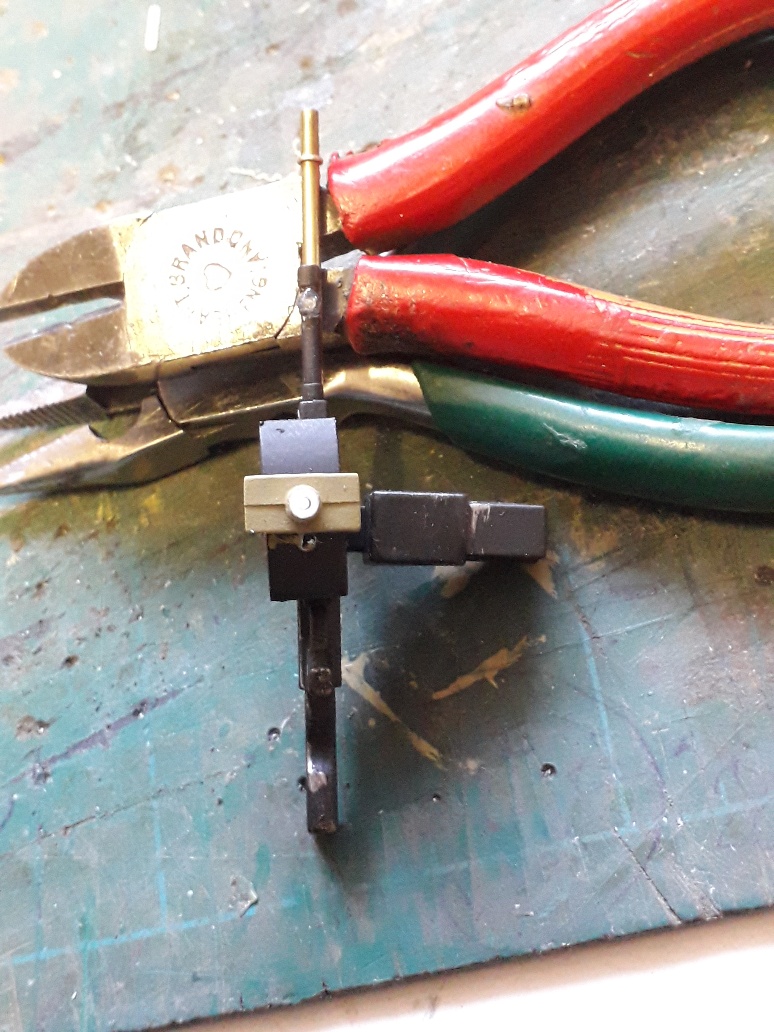

Bit more done i decided to make the gun travel lock down work.
Just now need to add the brackets and mount to the rear deck
A few pics.
Sub.
A few pics.
Sub.
Re: Scratch built Challenger Auto track adjusters

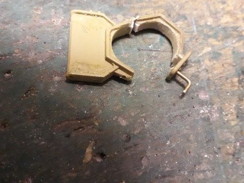

Hi.

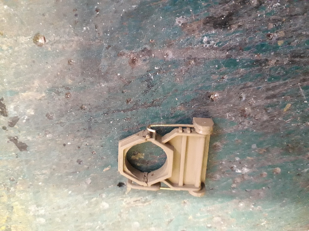

Little bit more done on the gun travel lock,
Deck mount added and a few more mods to make it more scale like.
Sub.
Sub.

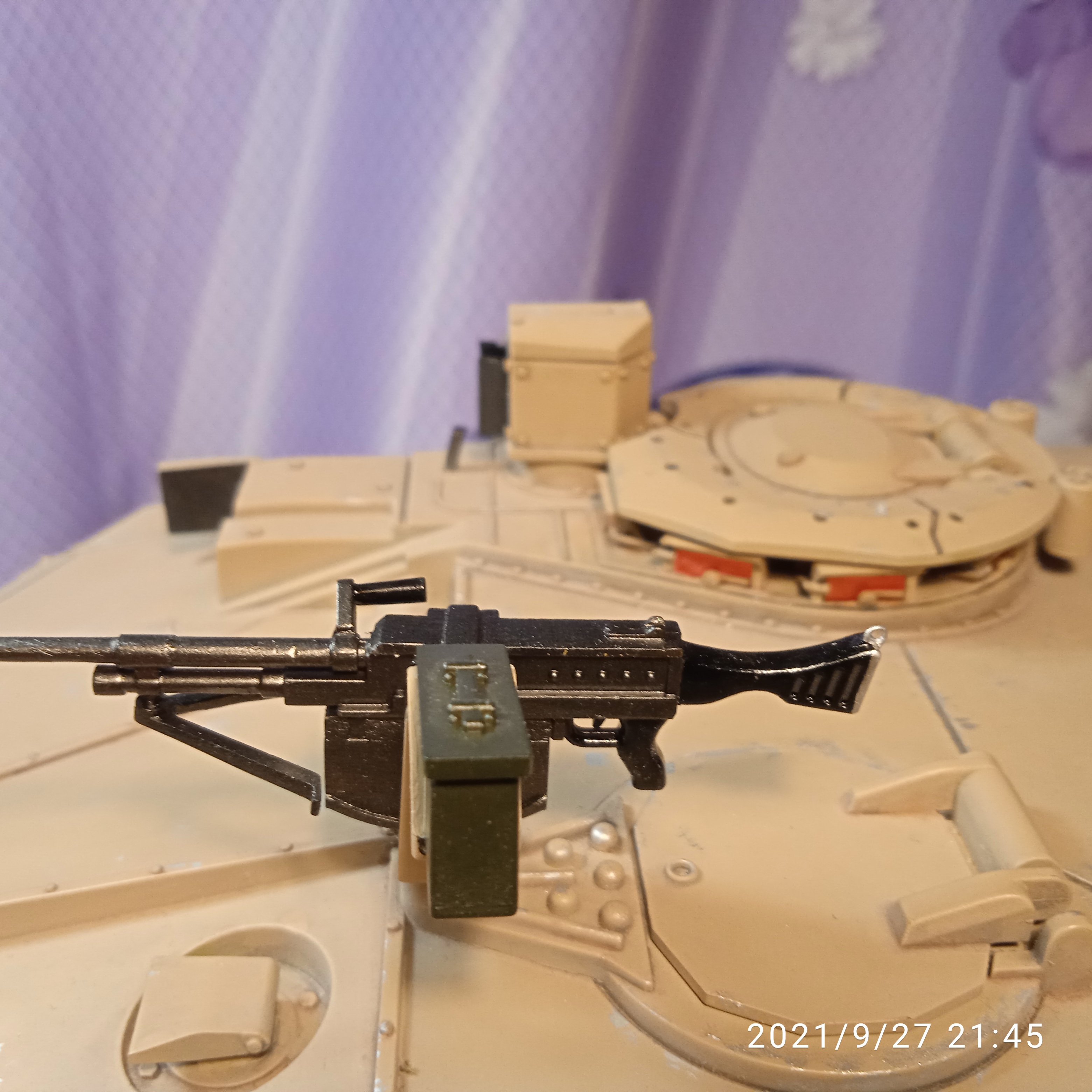

You should install a ring on such a beautiful machine gun...
- p7qlmzix31o01.jpg (141.8 KiB) Viewed 6910 times
- 1632824116471.jpg (1.97 MiB) Viewed 6910 times
