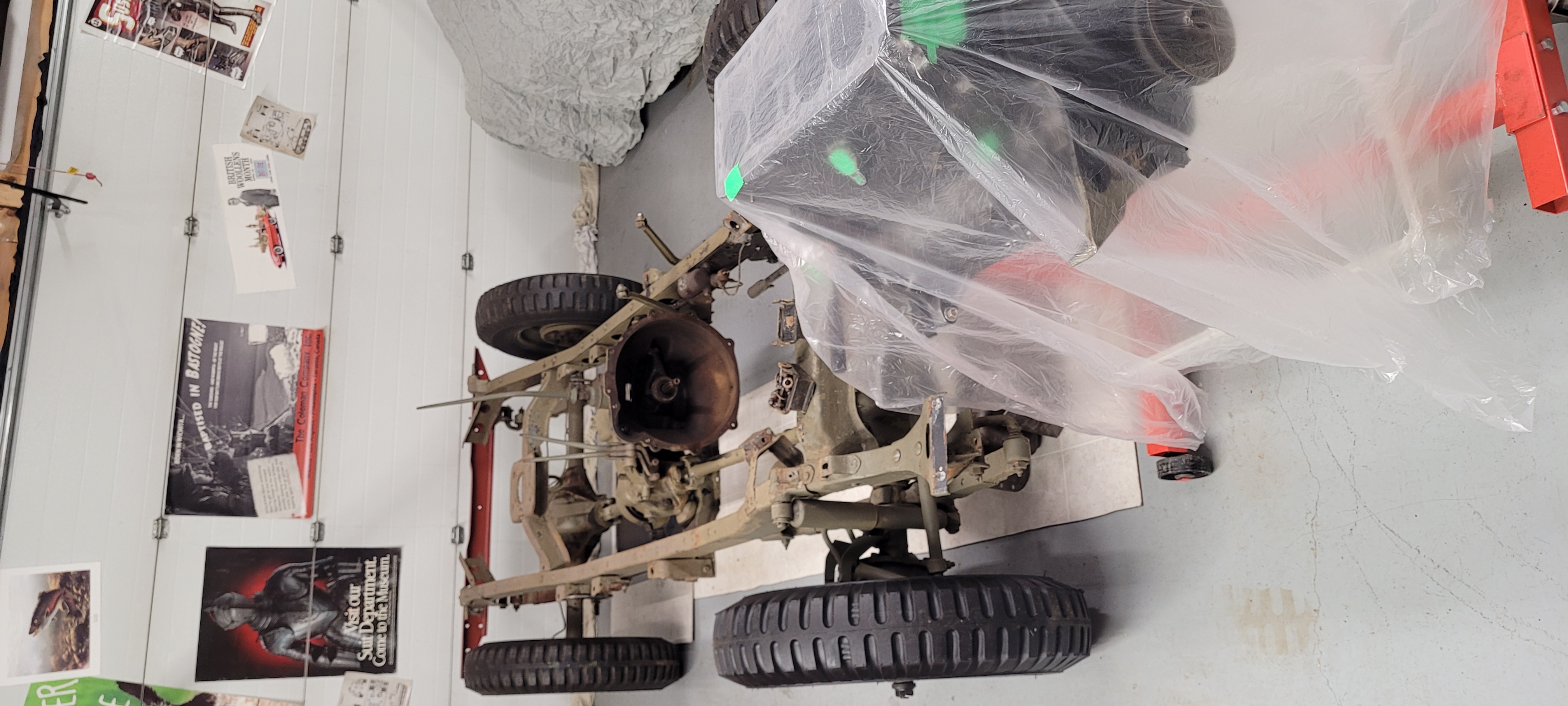

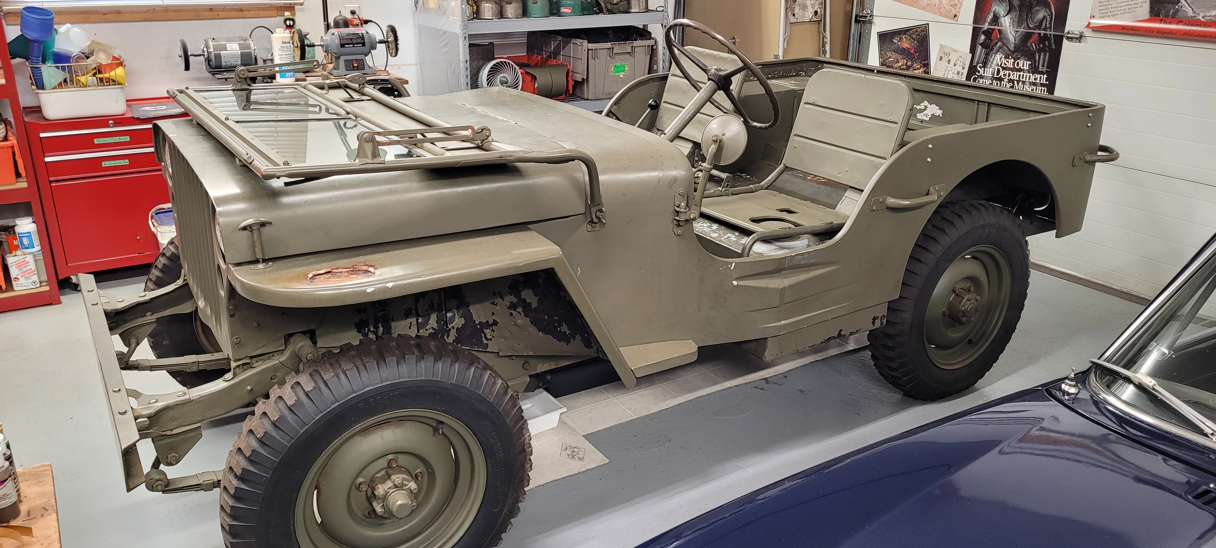

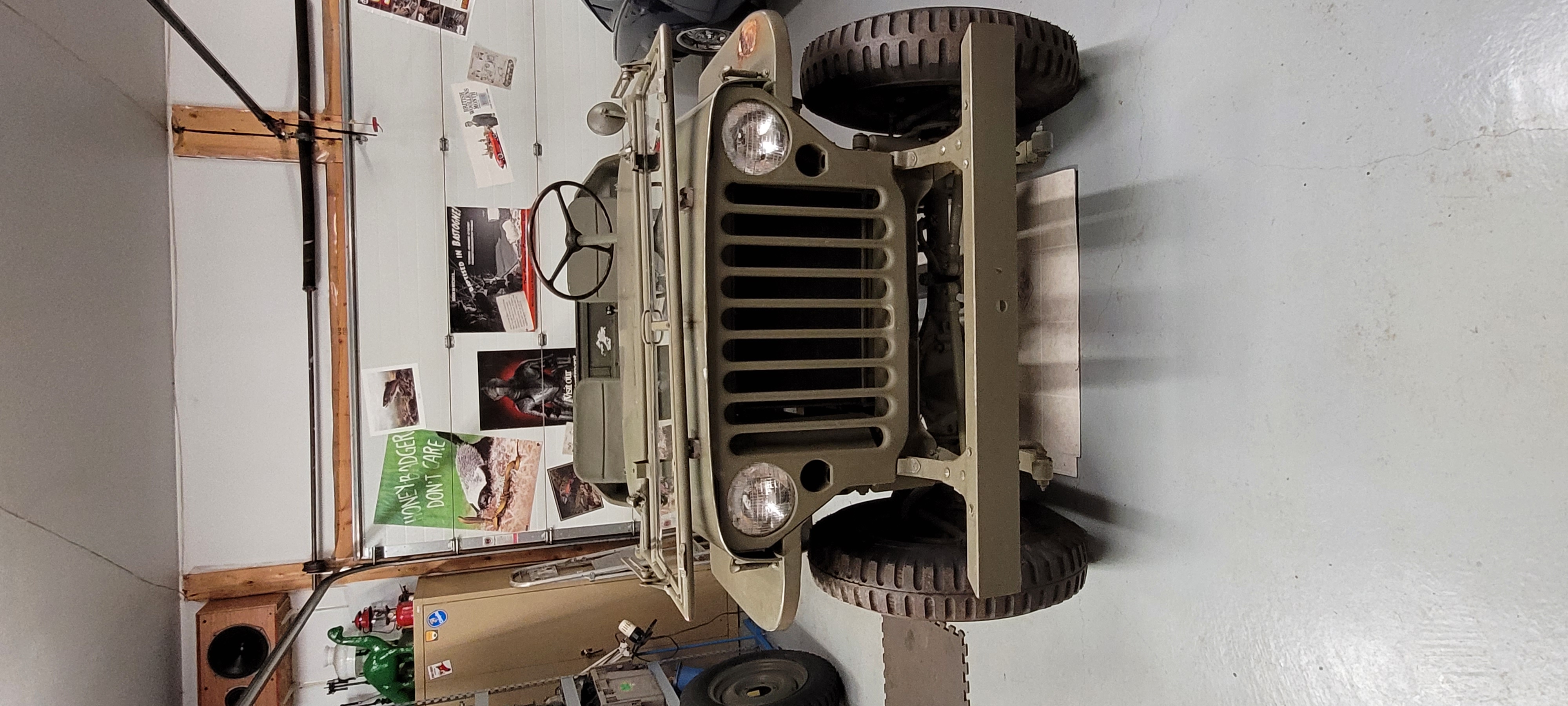

After the winter hibernating in our back shed, the GPW hit a big milestone when it rolled into a recently emptied bay in my workshop. The '78 Spitfire is off to a new home after 20 years in my hands. My first full engine rebuild so it was a bit bittersweet. The GPW is a bit more angular!

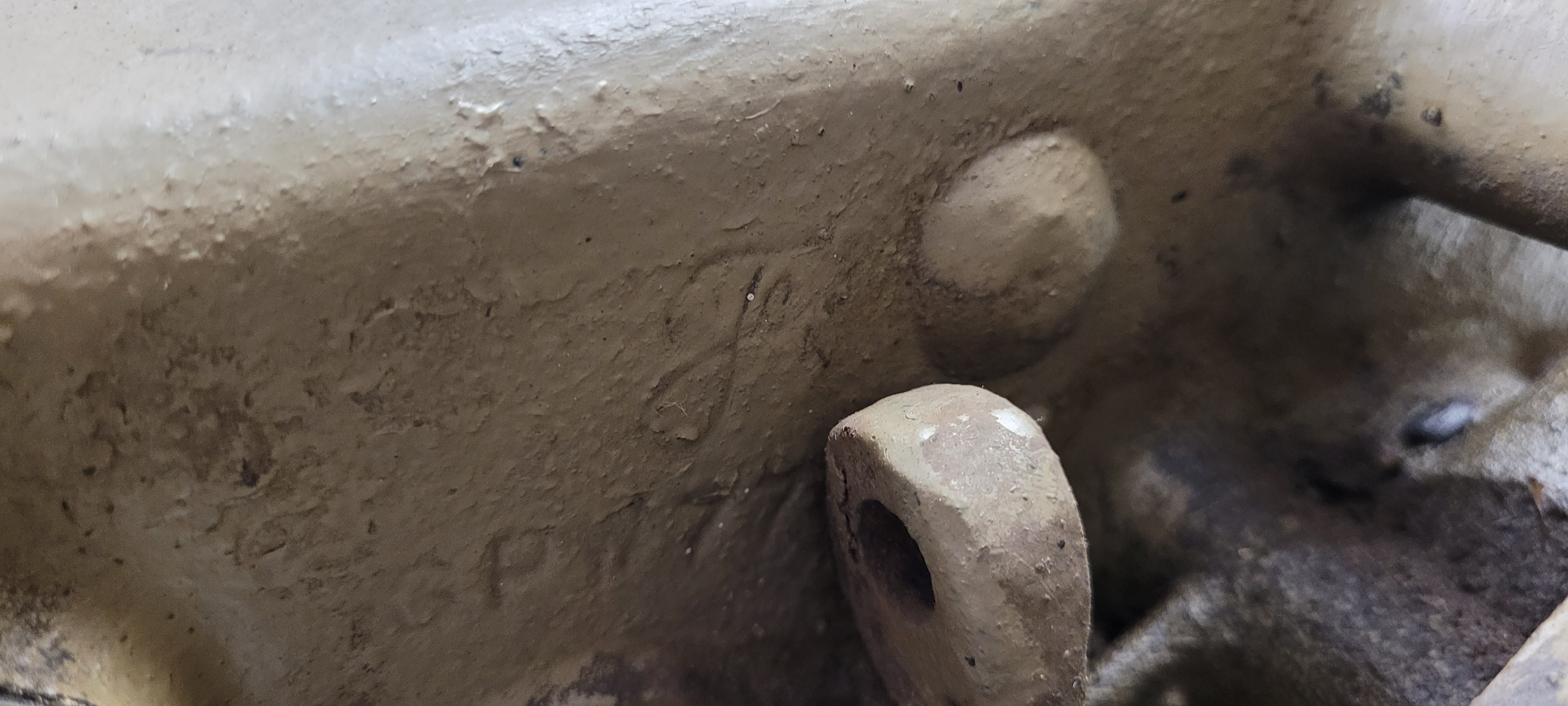

My son has been busy gathering together the parts list and piecing together information about the vehicle. Under some paint layers on the frame was the vehicle serial number, and it looks like it was built in May of 1942 so that helps with getting the right bits for that model. The body has lots of filler which we already knew, so the next decision is how far he'll take that aspect. Fenders, hood, windshield off next for engine access; the tub at some later date.

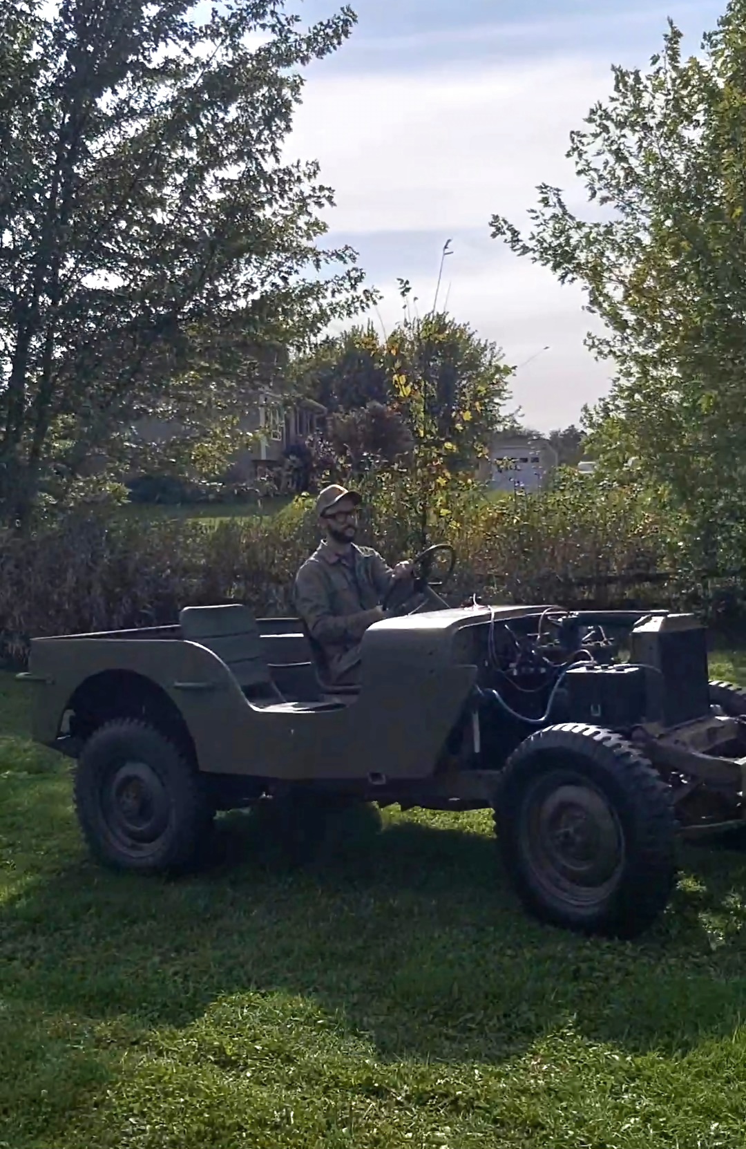

Since the last GPW update, lots of stuff discovered, lots of stuff done, and lots of stuff removed. Here goes:

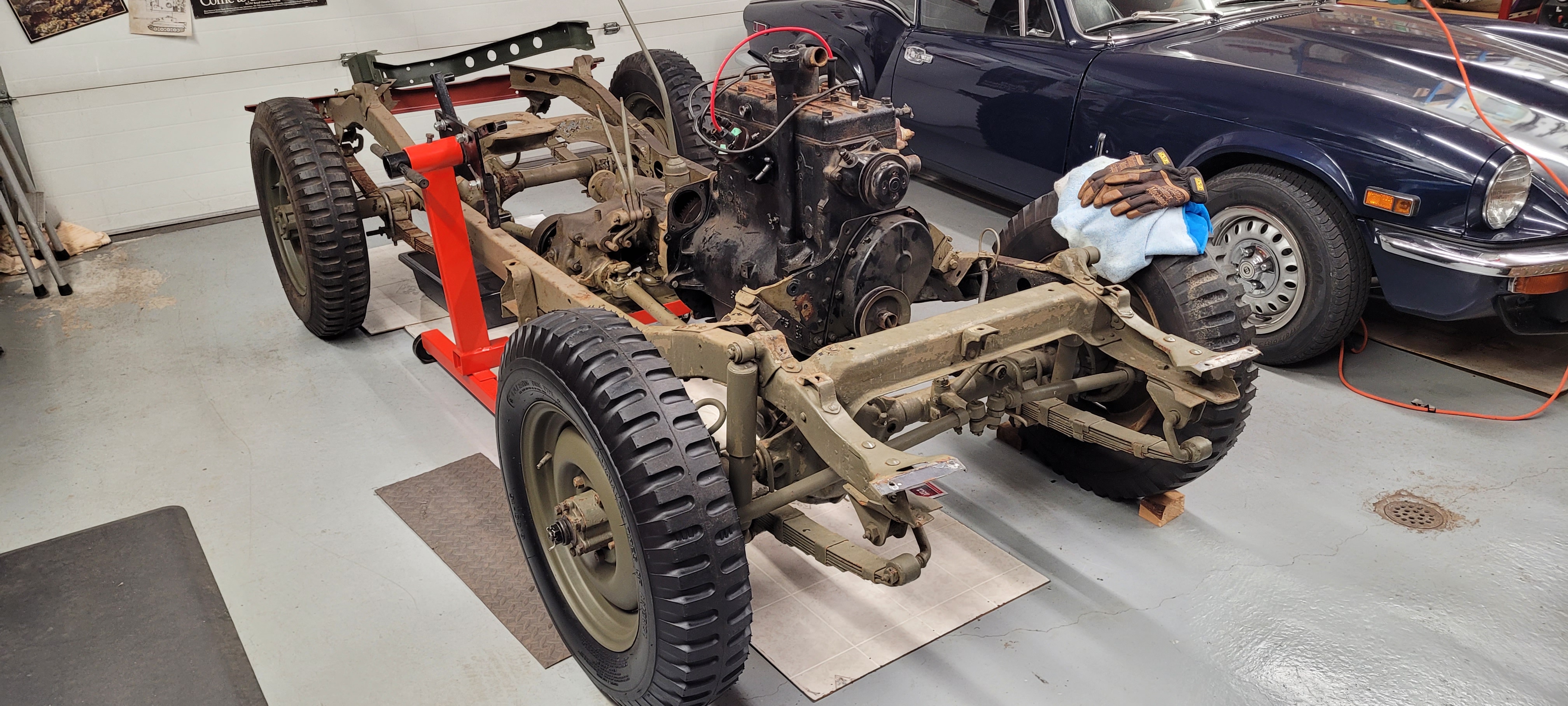

--The engine removed to clean out a bunch of mouse crap and nesting material in the bellhousing. My son's first engine removal. He said, "That was easy."
I said, "Most vehicles you don't have the hood, fenders and grill removed. They get in the way!" --Finally found the engine serial under a bunch of gunk and it's a Willys engine from an industrial application. Apparently a common transplant.
--Once the engine was back in, all fluids were drained and no glops or chunks of anything in the engine, transfer case, transmission, or diffs. Refilled.
--Vehicle had been converted-ish to 12 volts. My son wants the originality of 6v so a new generator, distributor, voltage regulator, and of course 6v battery fitted.
--Compression test gave nice even readings across the cylinders. Sweet!
--It's a runner! As a morale booster, we fitted a temporary gas tank and after fiddling a bit (actually, alot...) with the distributor and new carb it roared to life--no muffler but not objectionable. Settled down to a nice idle and my son putted around our property a couple of times. No brakes so he took it slow but managed to get into 2nd, and reverse, and both 2wd and 4wd. --There's a bottle of good Ontario rye whisky in the shop for momentous occasions like this. Even my wife who was on fire extinguisher duty for the startup partook! --A couple of weeks later, we removed the body tub for storage and the start of cleaning and refurbing the frame, suspension, and drivetrain. It looks like from the engine back is Ford GPW--check the Ford script "F" on the transfer case. Jackpot! --Winter projects are cleaning and painting the engine, evaluating and rebuilding as needed the entire drivetrain, evaluating and rebuilding the brakes, and the same thing for the suspension. In the Spring the frame goes off for a tiny bit of welding (that's a relief!), blasting, and then paint. --There's been ups and downs but it is 83 years old, and ex-military jeeps rarely if ever lead easy lives. I keep reminding my son of that whenever he gets annoyed at some of the bodges and weird repairs and parts we've uncovered.
