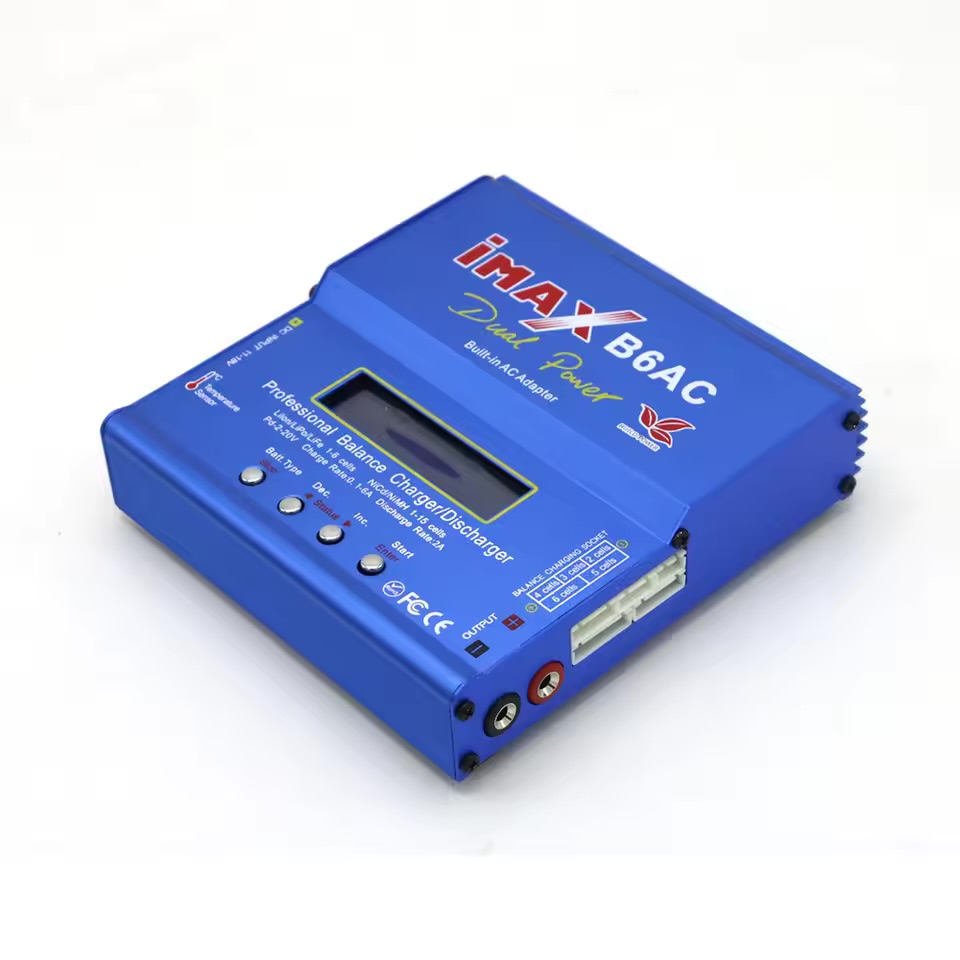

8O So you charge a Lipo battery? I think? by the balancing socket? You should know that on a Lipo, there is a certain tension? (volts) below which you must avoid going down per cell, and which is 3 volts. Otherwise the battery is dead? for this it is strongly recommended to install an alarm system. So if you do not have this, and used the battery to its maximum capacity?? very likely that it is better. In addition, your type of charger cannot tell you whether each cell is well balanced, as well as the value (volts) at the end of charging,
Alarme
Chargeur Automatique

Personally, if you used the battery without an alarm system, and the tank practically no longer works? there is a good chance that it is this. On the charger there should be a flashing (green?) light, which becomes solid at the end of charging? is this the case, the charging time depends on the intensity of the charger (amps) and the battery.
Some turntables have an integrated system which will cut off when the battery reaches 3 volts, I don't think this is the case here? I don't know if you are used to using Lipos? but there are precautions to take when loading, storing, and using. See our YouTube, many tutorials :thumbup:

:) For the charger, there is also one on the "Amazon" site or on "Aliexpress" if you look carefully, some sellers will deliver to you within 10 days, free of charge, as soon as the amount exceeds €10 :thumbup:
