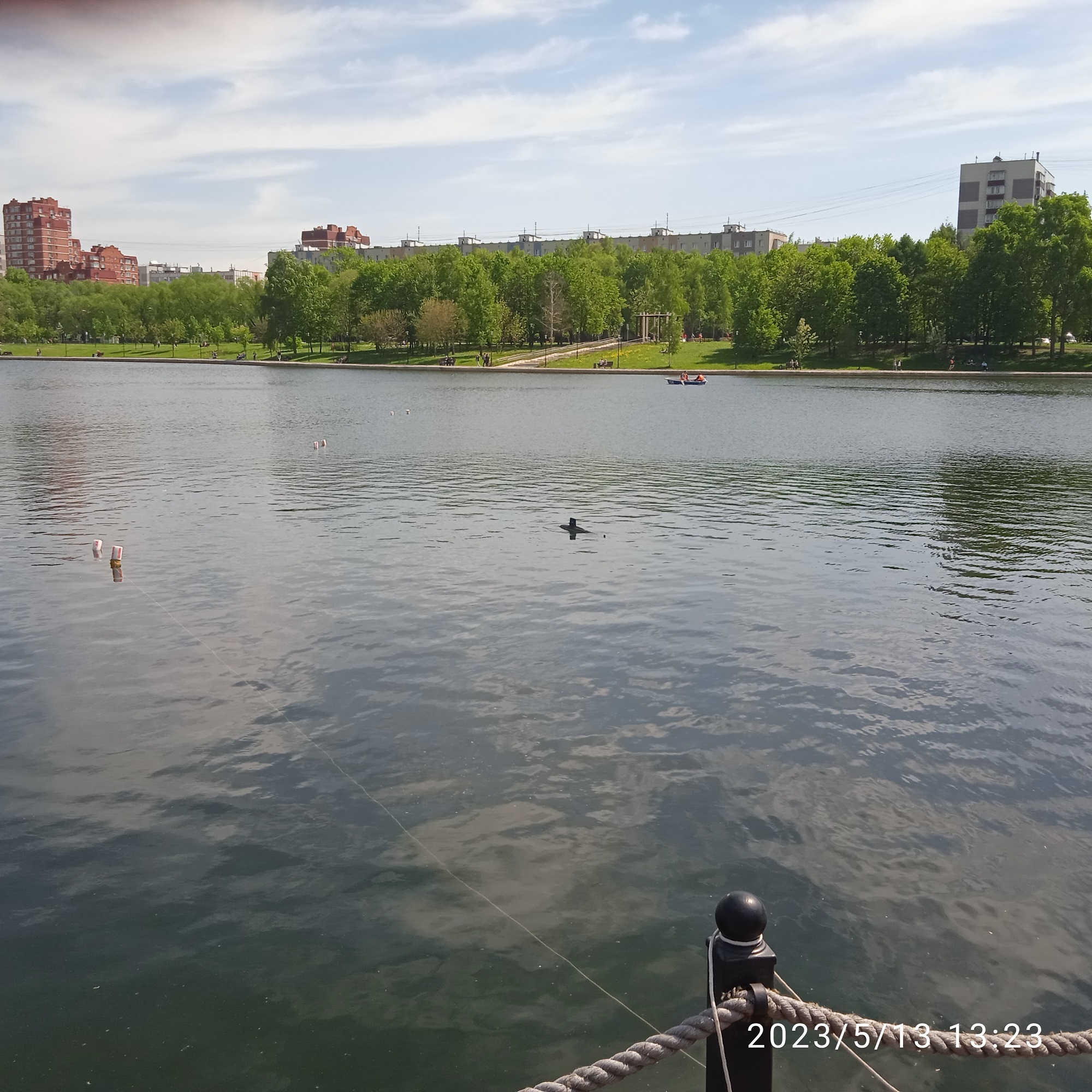

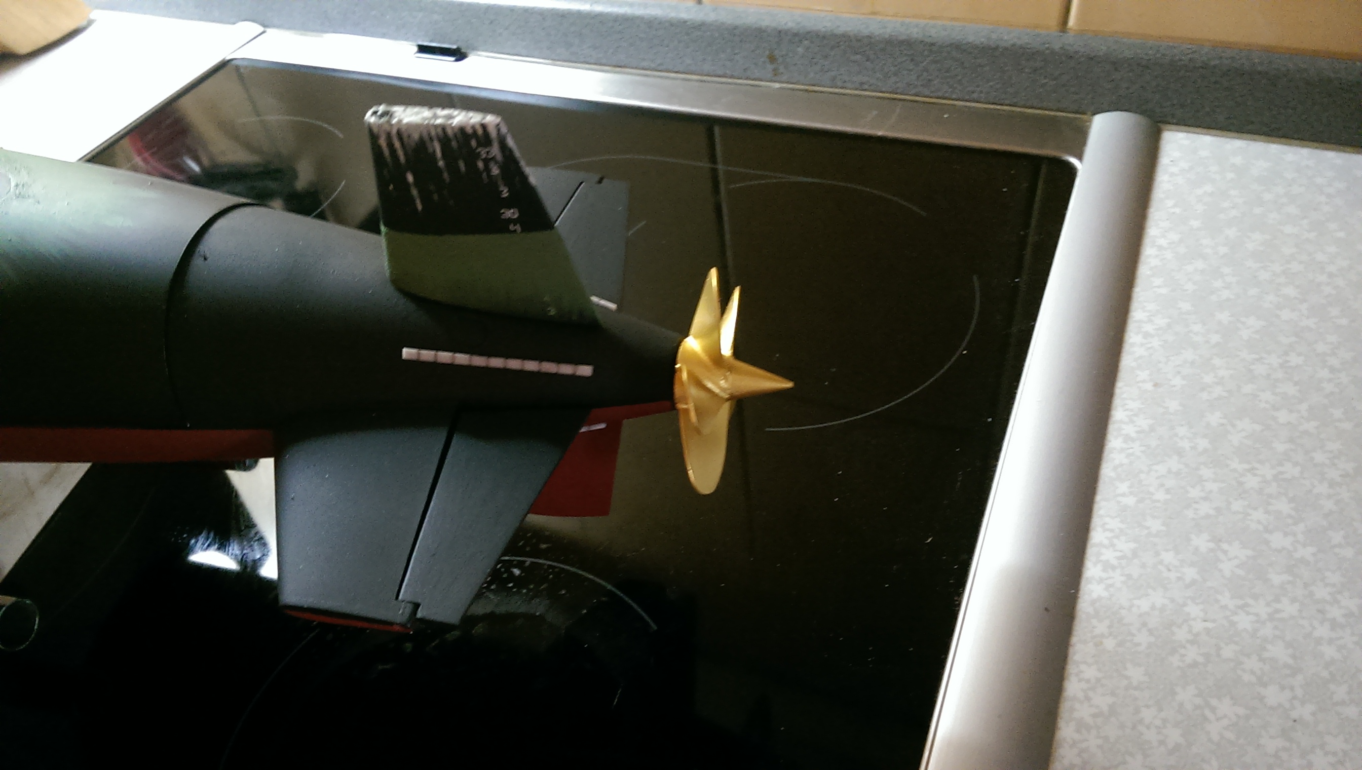

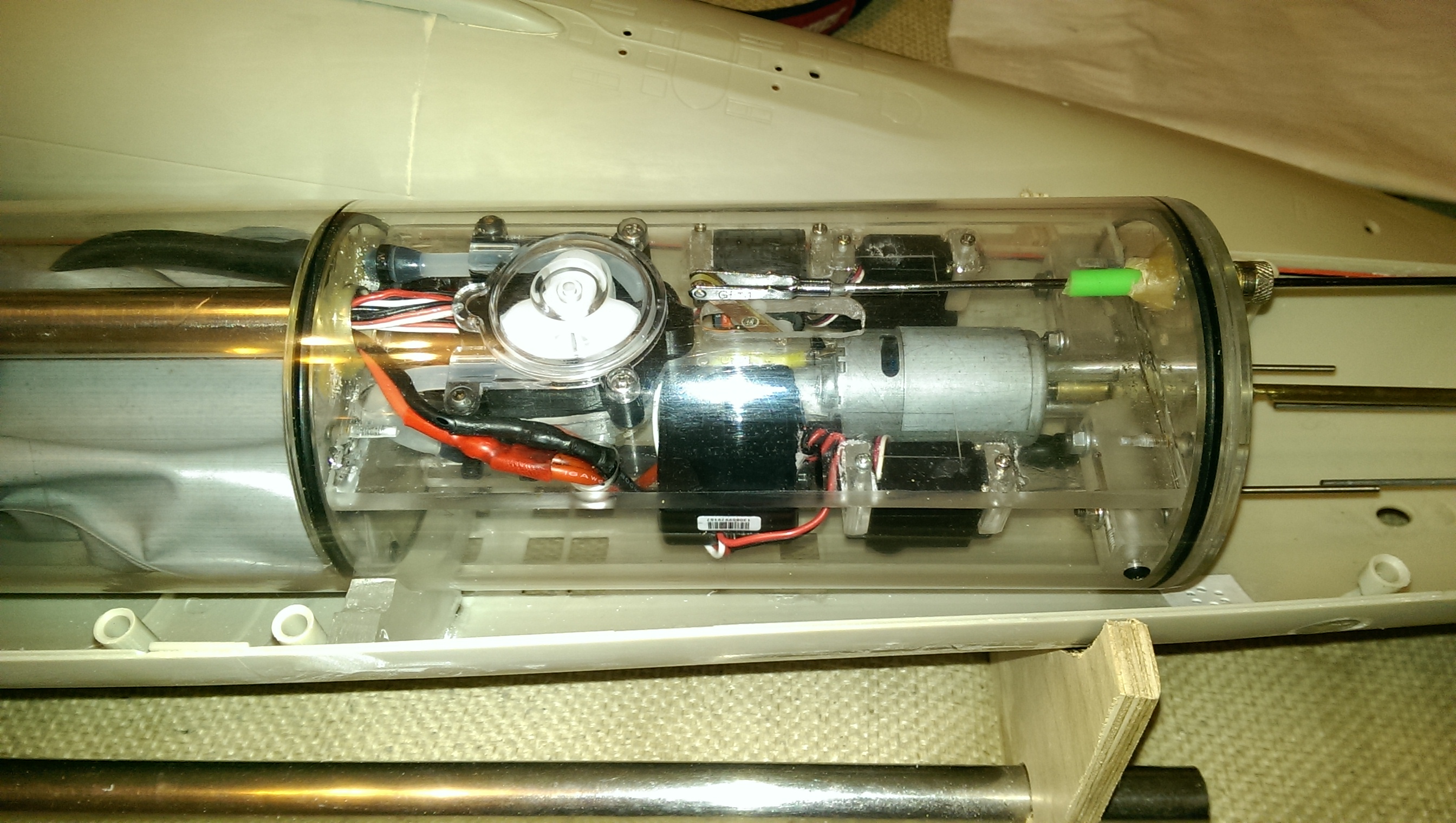

During the period of self-isolation, sitting at home, I assembled a Skipjack 1/72 from scrap materials, the body lay for a very long time, read how the masters make it and made my own version ....
For me, this was new, helicopters, airplanes, ships and tanks, road and off-road cars ...
And then I decided to make ...
