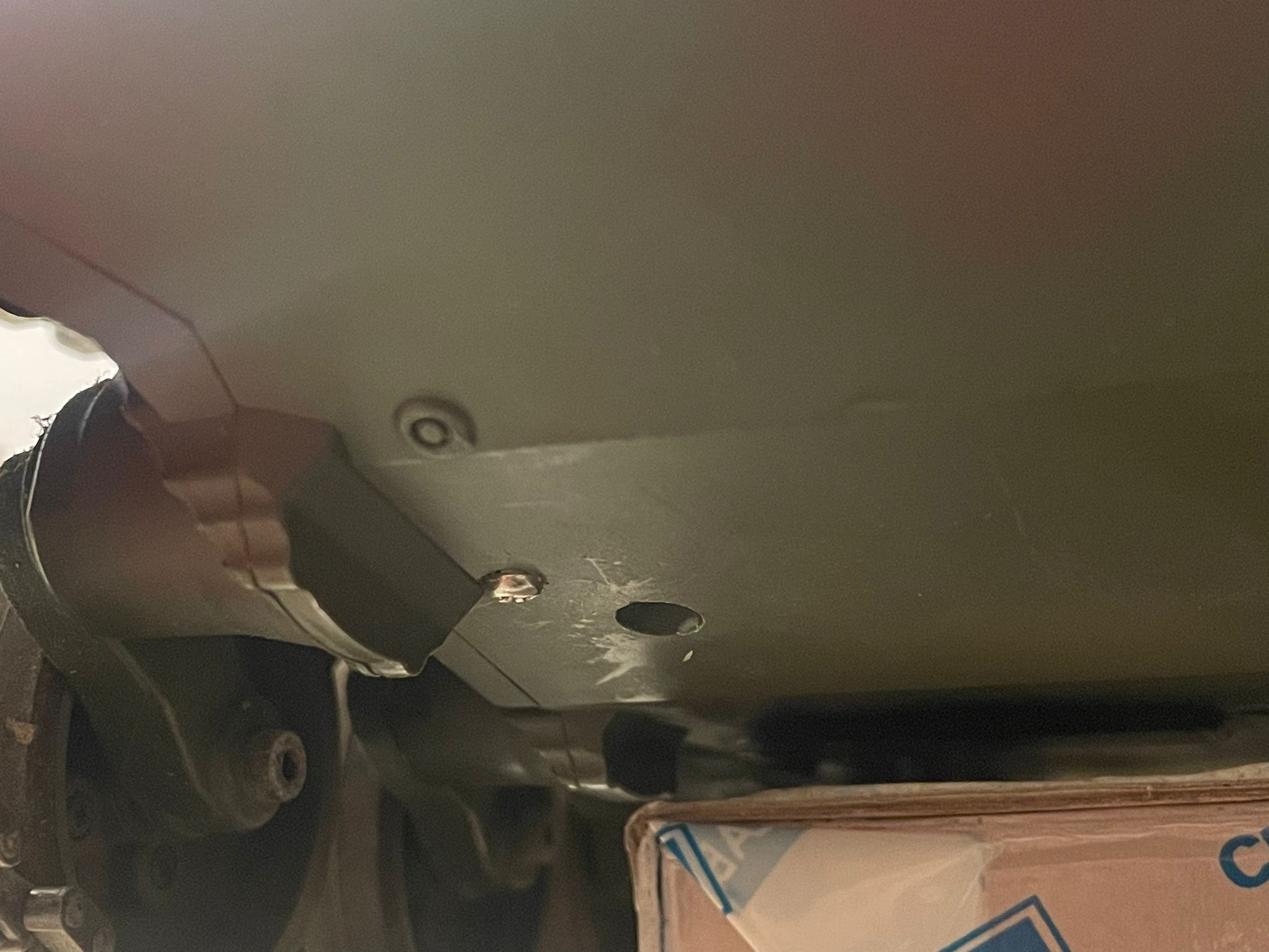

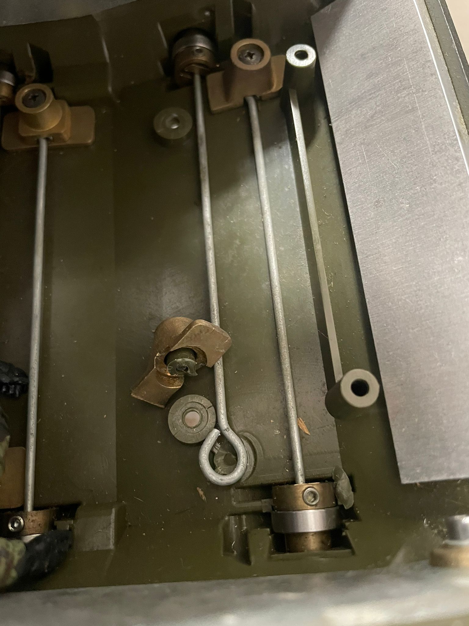

In spite of the hefty AFV-based reinforcements, the first road wheel's torsion bar mount has given way with the mounting post snapping clean off. But well, it is really, REALLY old plastic...
WhatsApp Image 2024-09-23 at 9.37.22 AM.jpeg (349.53 KiB) Viewed 1677 times
It was either a new hull, or I could drill out the hull and run a nut and bolt through it.
WhatsApp Image 2024-10-01 at 10.43.45 AM (1).jpeg (283.61 KiB) Viewed 1677 times
WhatsApp Image 2024-10-01 at 10.43.45 AM.jpeg (305.28 KiB) Viewed 1677 times

Good fix r32 - better than buying a new chassis tub!
