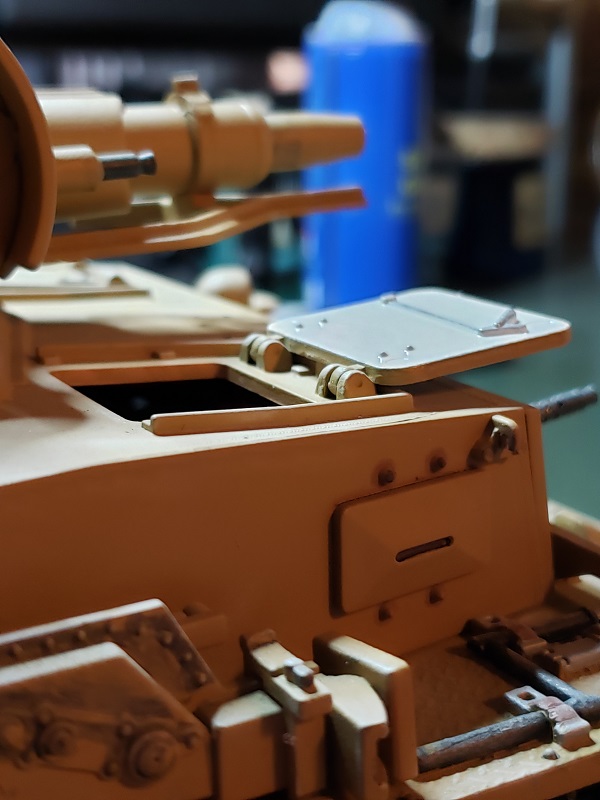

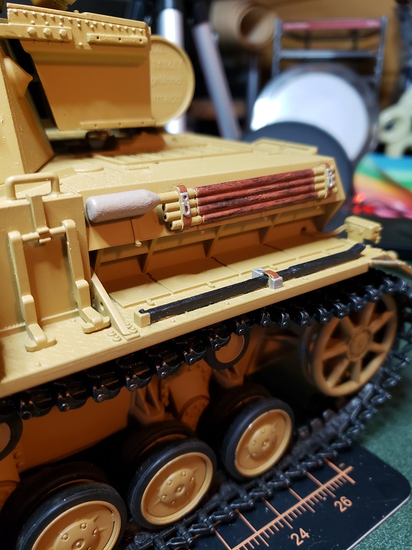

Good Morning,
Jarndice has the right of it, especially if your Armor is new and being assembled piecemeal like most of us hereabouts prefer. If you have an upper which is older and has tools attached or one of the mentioned types like Taigen, first look and see if the tools are molded on or glued. If glued, they may be careful removed by use of products that de-cure Super Glue ( or whatever the factories are using ). If molded on, they can either be removed by sanding or a razor saw and new after market tools painted and mounted or you can spend some time ( as I have done on several builds ) and give the tools a 3D appearance by undercutting with scribing blades and other tools used for working with resin and plastic. After this step is done, careful painting yields a very satisfactory result. Whatever route you take, post Pics of your progress for the Forum to follow along on.

I have a number of Taigen tanks on which, for no apparent reason, some of the tools are relief cast. I use Painless's method for those, with seven-power magnifying lenses of the sort that strap around my noggin. Five power may be enough for you. These are available from hobby stores, online hobby stores, and online shooping sites.
