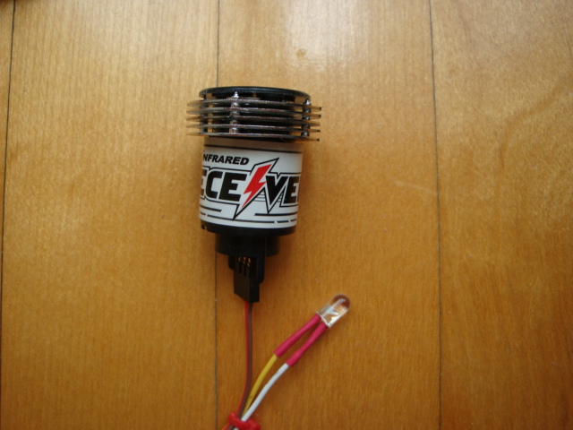

:) Hello, when you press the remote control directed towards the Infra Red sensor, does the LED react? I don't think it's a question of stupidity? since personally I got there, and yet quite devious with all this electronic stuff :haha:

On the TK 22/24 series it was recommended to replace the red LED of the mantle, (which is an infrared) and replace it with a standard one, then the shunt put in place (same as your photo) to activate the elevation, press without Hold down the "Power" button on the remote control until the LED flashes 4 times. I don't know if it will help you, because it's quite old? but it costs nothing to try? Afterwards, maybe this type of model is not suitable, compared to Sony?
Led infra rend, remplace for Led White,ou rouge
