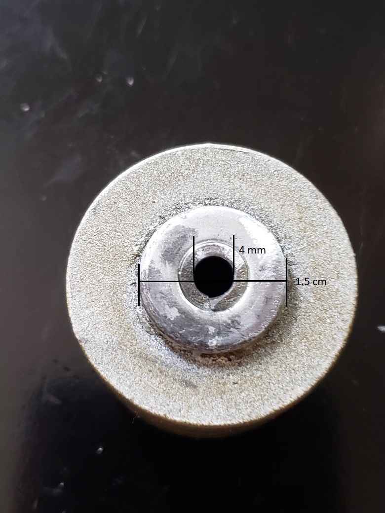

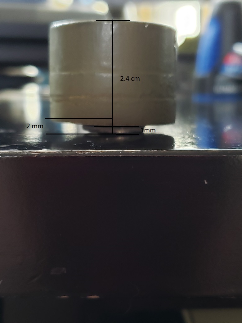

Good afternoon, Wayne,
Work is slow so here you go:
( click to enlarge )
P.S. Before I forget, the little raised nubs are _supposed_ to be bolt heads ;o) 21Century, eh?
