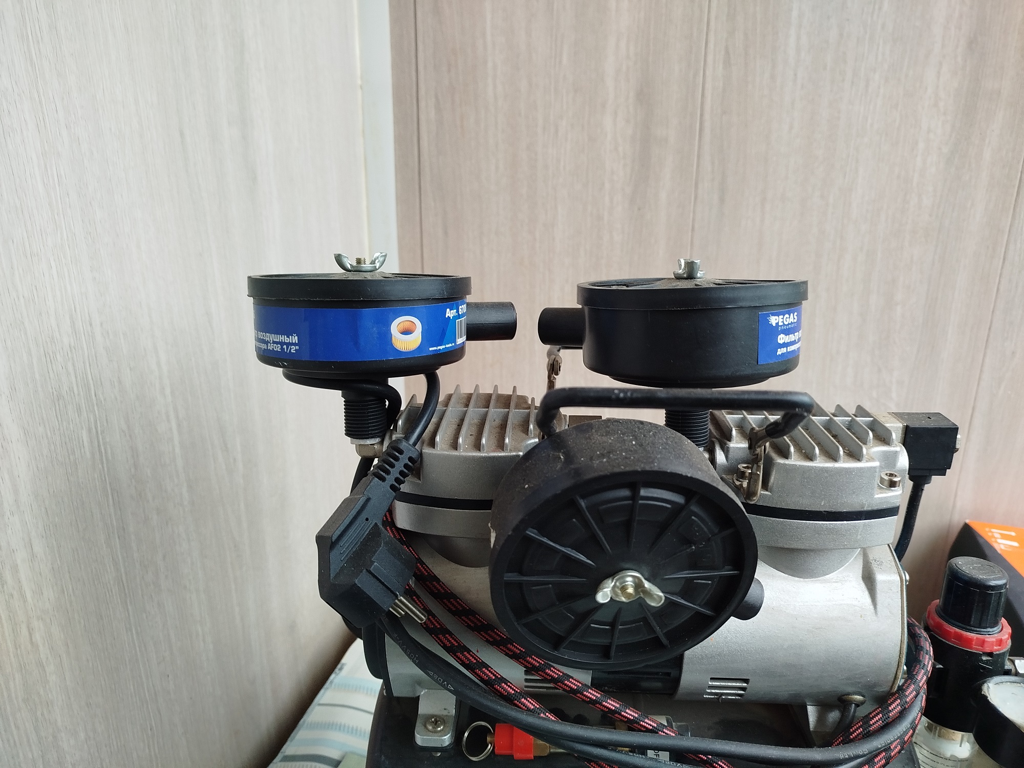

For the compressor to work efficiently, I recommend replacing the air filters that are there...
It seems that the manufacturer is concerned about the rapid failure of the working group.
It breaks down more often - they will buy a new one faster (C)
In addition, when the filters are clogged with paint, the load on the compressor increases sharply, since there is practically no air flow.
You will not have the nerves to constantly wash these small meshes with solvent!
I installed regular paper filters from a more powerful compressor and now I have forgotten what a dirty filter is.
I used adapters from garden watering hoses of suitable diameter.
I will take a photo now.....

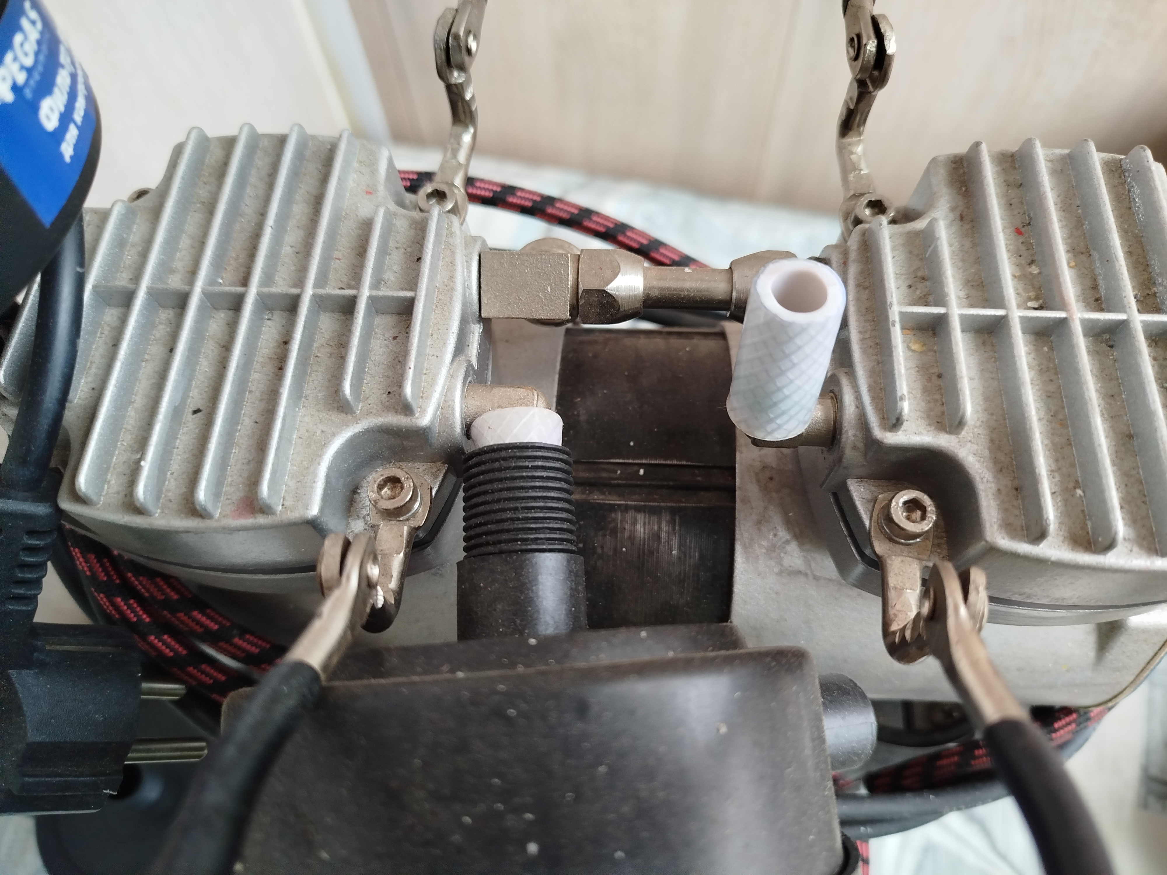

Re: Wellllllll I finally did it! Herman get in here...
You can find what is in the stores..
Don't forget to buy three adapters 1/8 90 degrees...
If something is not clear - ask....

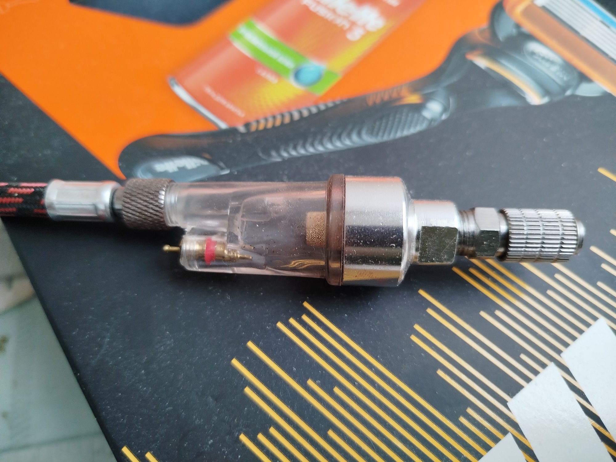

Buy a final filter to protect against condensation, for convenience I use quick-release connectors...
The tee is also convenient, I connect several airbrushes so that I don’t have to change them during work...
