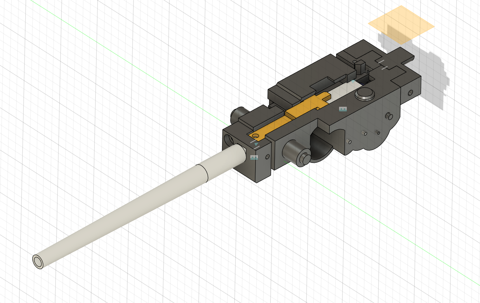

Taking the idea from AEG's precocking, we removed the henglong BB launch unit and put in the DIY gear box.
This unit shows the actual motion on the tk 7.0 board.
The operation control used a timer relay and a constant voltage circuit in units of 10 ms.

I would love to see a lower profile BB mechanism for tanks with accurate barrel recoil become available. The HL one is so bulky that it prevents most tanks from achieving the correct amount of elevation by bumping into the turret ring.
I don’t have a printer nor do I see one in my near future, so I’ll just twiddle my thumbs until then.

Yeah, the clearance issue with the stock HL unit really kills the realism for some tanks. A more compact mechanism would be a game changer. I’ve seen a few creative alternatives using microswitches and short-stroke setups, but they’re not widely available yet.
