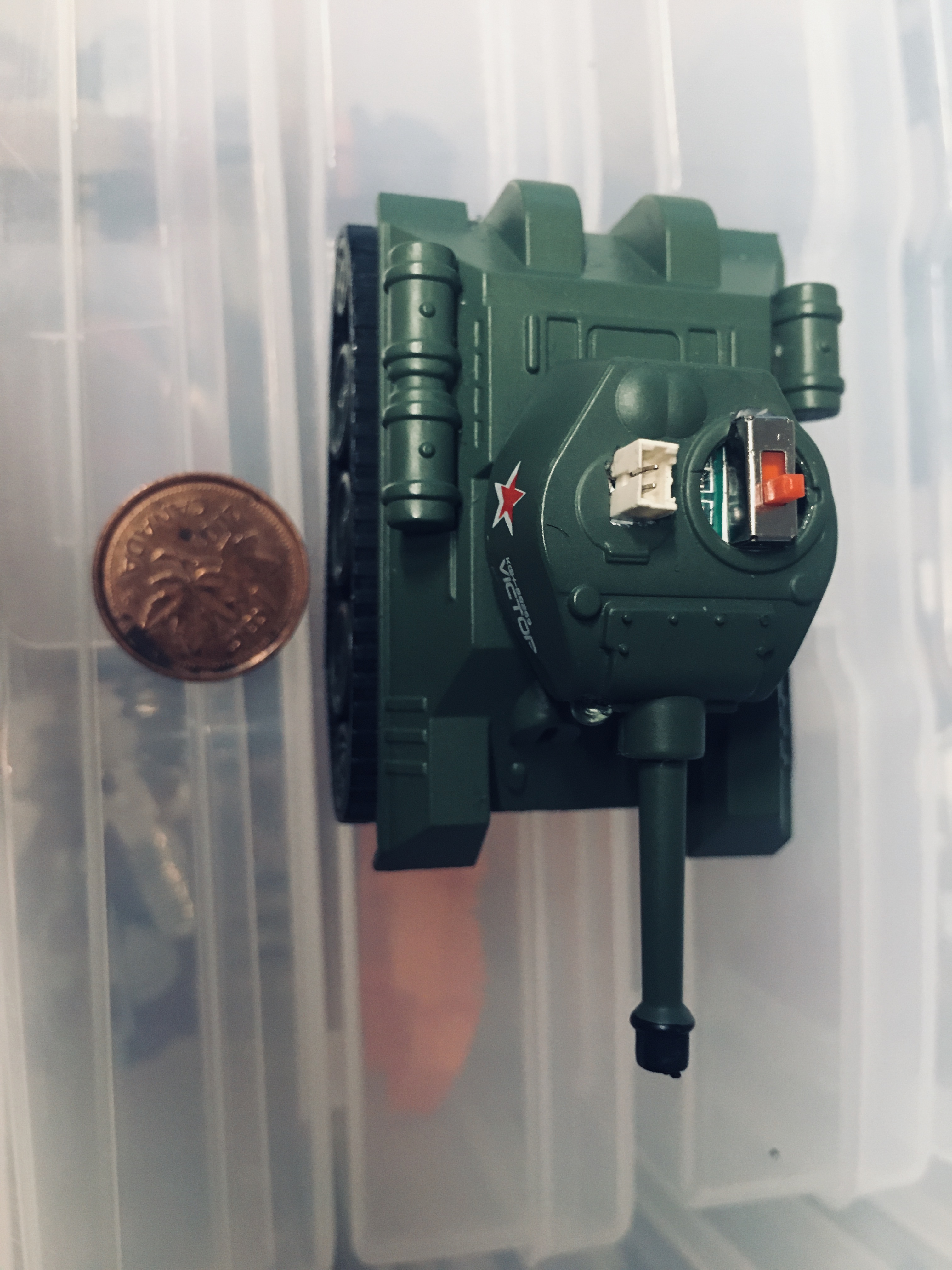

Yes I have :D Just yesterday I finished my smallest tank yet :O This one a T34, is smaller than the Leopard but probably the same scale 1:77.
Advanced micro circuit board receiver with Telemetry for Voltage and temperature. Ultra micro dual ESC with its own Track mixing.

1 Canadian cent
1 Canadian cent
Not so scale but all so small and excellent mobility and battery life. Can easily run 20 minutes continuously. Also has Telemetry with battery Temp and voltage alarms with variable setpoints,
I made a special circuit board to mount the power switch and charge port. Internal 100mAh 1s lipo.
The T-34 has a better gearbox with a lower gear ratio so it can go real slow (scale) as well as real fast!
Some of my recent 1:77 projects.
