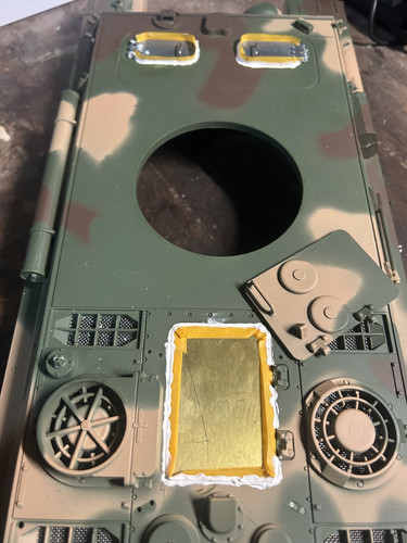

Heng Long Panther upper hull, i carefully cut out the driver's and enginecover hatch.
I used the Taigen front hatches and my own custom made engine cover, but i am not satisfied with the shape/gaps between the new hatches and the "holes" they cover.
So i surrounded the edges of the hatches with painters-tape and filled the gaps with (Vallejo) putty, but now im having trouble getting the hatches out without damaging the putty edge.
Any tips on how to solve this in a proper way (removing the putty and starting over is optional but not preferred)

before starting work, it was necessary to apply a separating layer to the part, and then seal the seam, usually 90% of the putty does not stick to silicone oil....
To remove a part with masking tape, wet it by immersing the part in water, tape is 99% made of paper, over time it will begin to dissolve, you will apply a little force and take out what is stuck...

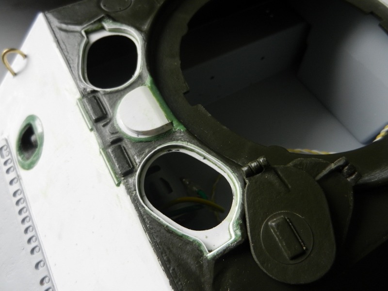

:S Hello, if I may? there was a simpler solution!! after cutting the hatches, simply glue inside the hull, a small plate of PVC, Evergreen, or ABS of low thickness and cut 1 mm (approximately) larger than the opening, and on which, the hatches will come to rest, now it's just for information :thumbup:

Jofaur86 wrote: Mon Oct 14, 2024 1:45 pm :S Hello, if I may?
Wow looks great, will surely do, but my concern was mainly with het outer edges of the hull, eg. The edges of the hatches from the Taigon Panther, are slightly differently curved than the HL upperhull.
I’ve got the hatches out now, but the puttied-edge is slightly damaged on some spots, so i will need to repair those with some additional putty.
After im satisfied with the hull on the outside, i will oil the hatches up and put them in place, and than set them in place with a piece of tape.
Than i can reapply the putty around the hatches, bit this time from inside the hull, as with the first time, the putty didnt reach the full thickness of the hull-plate, thus leaving a messy edge when the hatches are open.

If you look close at the photo you will find there is a thin plasticard layer around the inside of the hatch opening to fill the gap. If you can do this and maintain the shape you need, the damaged area can be filled and sanded to match
