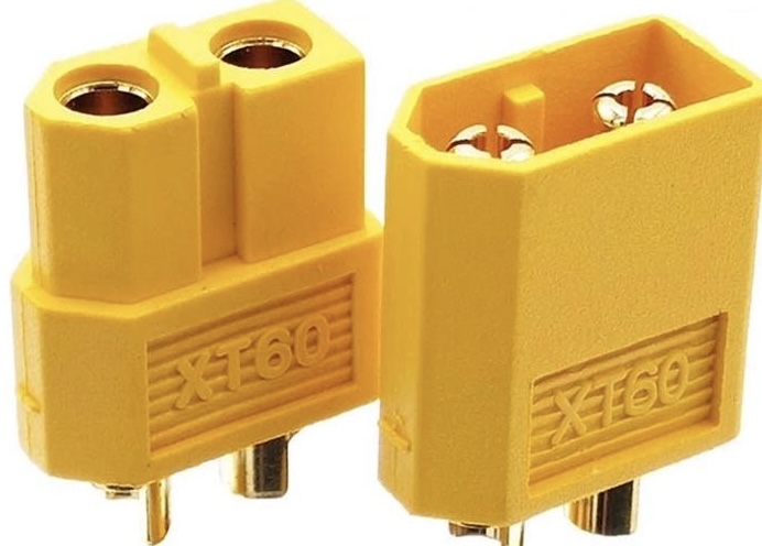

Jofaur86
Posts: 2172
Location: Centre France
Re: RC tank repairs
Post by Jofaur86 »
Good morning,
Completely agree with my comrades, the Heng long batteries (green for Nimh) rarely have the capacity indicated above (2000 Mah, example?) plus the charger delivered with it? only has the name of charger? in reality simple basic power supply. Tamiya plugs are not reliable, moreover with time, the wires oxidize and cause losses of intensity and current. Personally, I would invest in a quality batteries, with sockets other than Tamiya? it will also be necessary to replace on the tank, and a so-called intelligent charger
Jofaur86
Posts: 2172
Re: RC tank repairs
Post by Jofaur86 »
Prises , example taken type XT 60, but there are others Dean, etc.
Sorry for the size of the photo taken :'(
Chargeur
