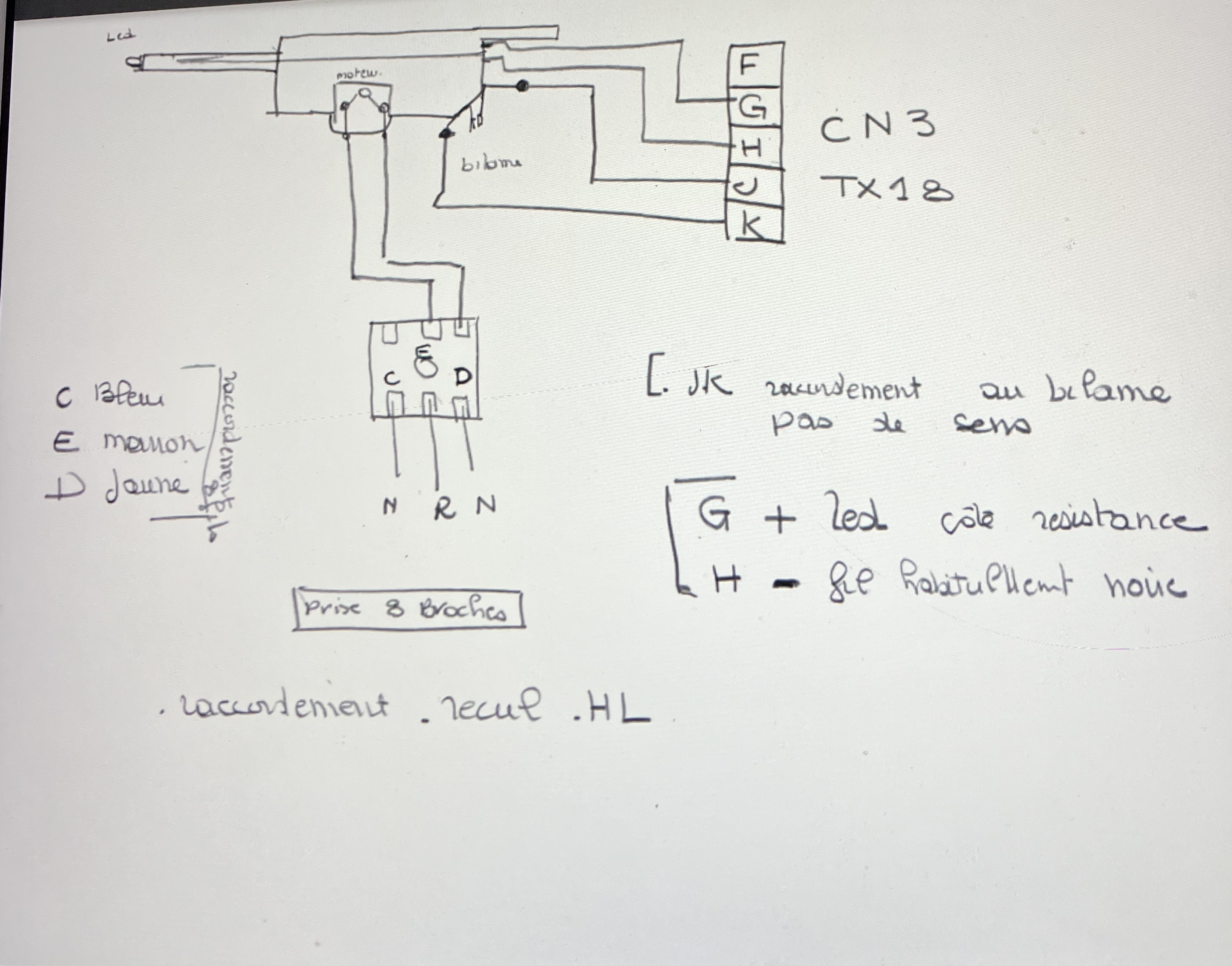

Hello, can you help me - how to connect a regular diode (not xenon flash) in a cannon using Heng Long 5.3 board? My friend's tank has a cannon mounted in a gutted BB mechanism. We only want there to be a flash when fired.

Small clarification!!! just in case?
Do not take into account the alphabetical letters, but the location of the wires on CN 3
2/3 led 4/5 switch ball firing contact, nothing on 1st pin
