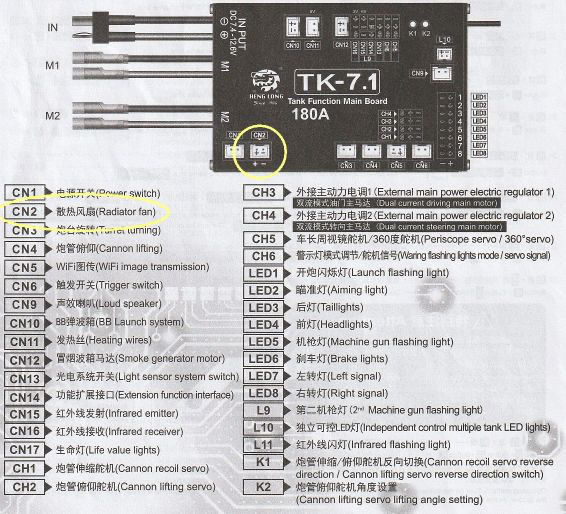

Oh 8O :haha: know it's i not always easy, attached is a photo of the 7-1 with the different connection marks. The battery socket is of the Dean type, which is more serious than Tam. For getting started, a simple switch M/ Enough, for the motors it is necessary to replace the current plugs (keep the warranty of the board) for the smoker, you can see that the fan has its own output, and the same for the resistance, etc., etc. Read the notations carefully and uses of the different outputs, and little knowledge and method, and time, should you get out of it? and then there is always the forum, in case of problems, there are a lot of competent and helpful members to help.
attached diagram HL 7-1
