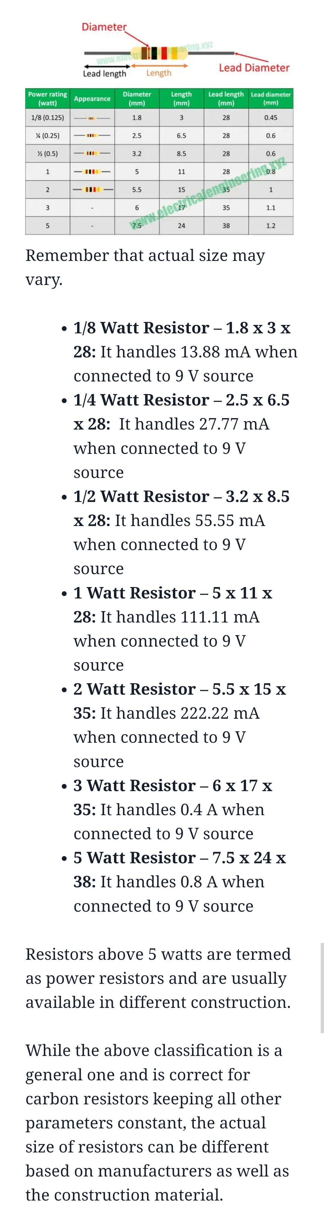

does anyone know what the wattage is for the 1.1 Ohms 5% resistor on the tk60? just wanting to make sure i order the correct one cheers

Re: Clark TK60 Help
I would say 1/2 watts diameter 2.5 mm Length 6.5 mm
1 watt diameter 3.2 mm Length 12 mm, approximate dimensions according to the manufacturer? but in doubt? 1 watt would be more favorable, it's only a question of dissipation, so who can do more? can the least
as "Rad" says, not sure if there is only resistance? Let's see....

Re: Clark TK60 Help
The wattage is important if the resistor doubles as a fuse. Dimensions do vary slightly between manufacturers.
- Screenshot_20240803_165439_Chrome.jpg (738.32 KiB) Viewed 3419 times
