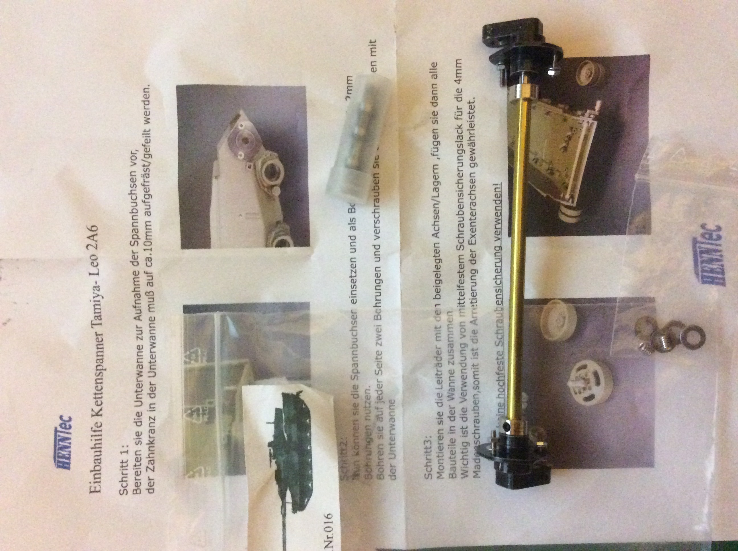

My HennTEC track tensioner to fit my Tamiya Leopard 2A6 should be delivered by the time I get home next week.
I didn’t realise that this system had been so disappointing for some users, but I do like the idea.
Once unpacked I will take a good look at it and take Tom’s advice and change the screws to cap heads straight away......and then give it “a good coat of looking at” (in light of the negative comments) to see if a anything obvious can be improved.

Modified HennTEC track adjuster:-

Mine looks like this.
