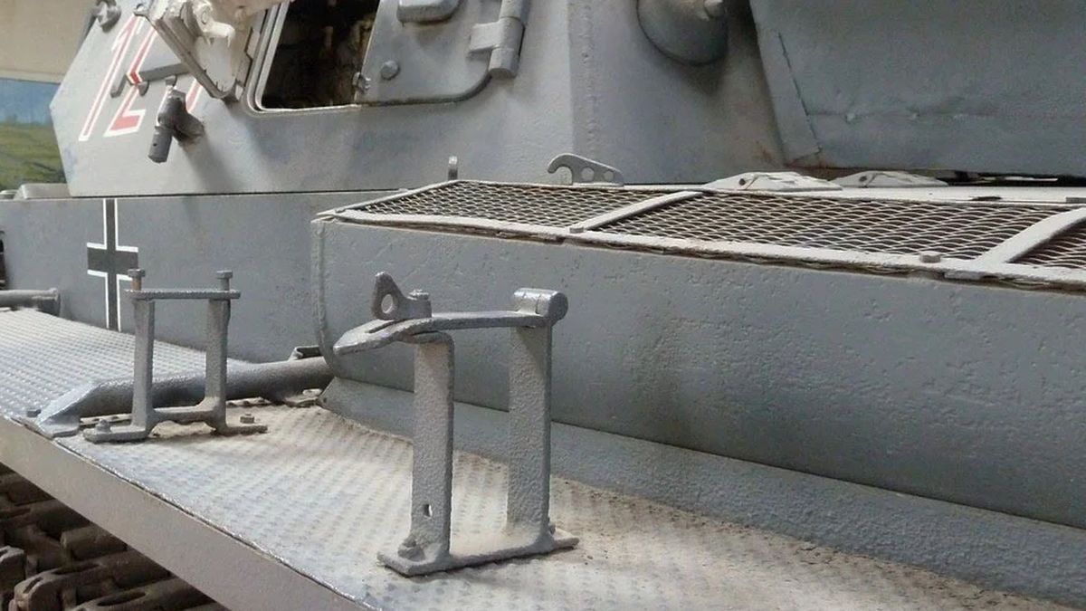

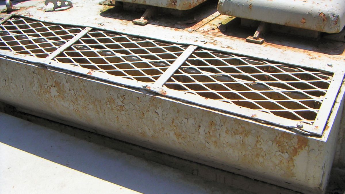

Always look for real reference (Google e.g. "Panzer III Walkaround"). Examples:
- pzIII3.jpg (144.98 KiB) Viewed 4561 times
- pzIII1.jpg (124.05 KiB) Viewed 4561 times
- pzIII.jpg (123.8 KiB) Viewed 4561 times
Re: Photo Etch Grills - which first?
Excellent photos thanks. Confirmed what I thought and that the frame should be on top and looks better anyway.
