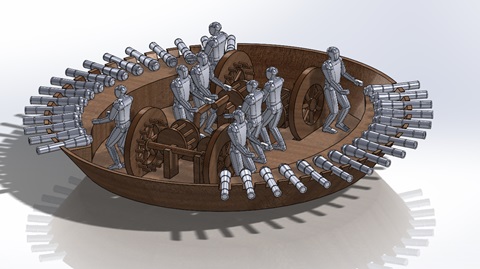

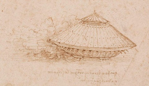

I didn't think about it at first, but my "bell" (or, as I prefer, "UFO") tank is actually not that far off from Leonardo da Vinci's early tank ideas:
His design has flat faces and four or five guys for propulsion, ... so, an "engine" of 0.5 horsepower
, but hey, the guy did live like 500 years ago.
