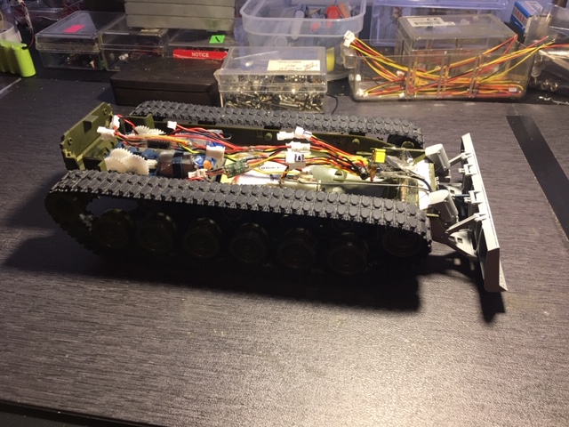

Anyway, here are some pictures of what I have so far...

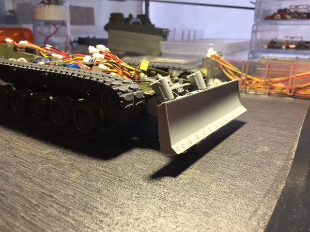

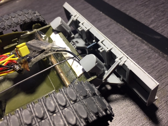

The Dozer blade assembly is connected to the lower hull with two screws.
servo control for the Dozer blade.
DSM2 low voltage (1cell) receiver with twin 1 cell ESC and long throw 1 cell screw drive servo added.

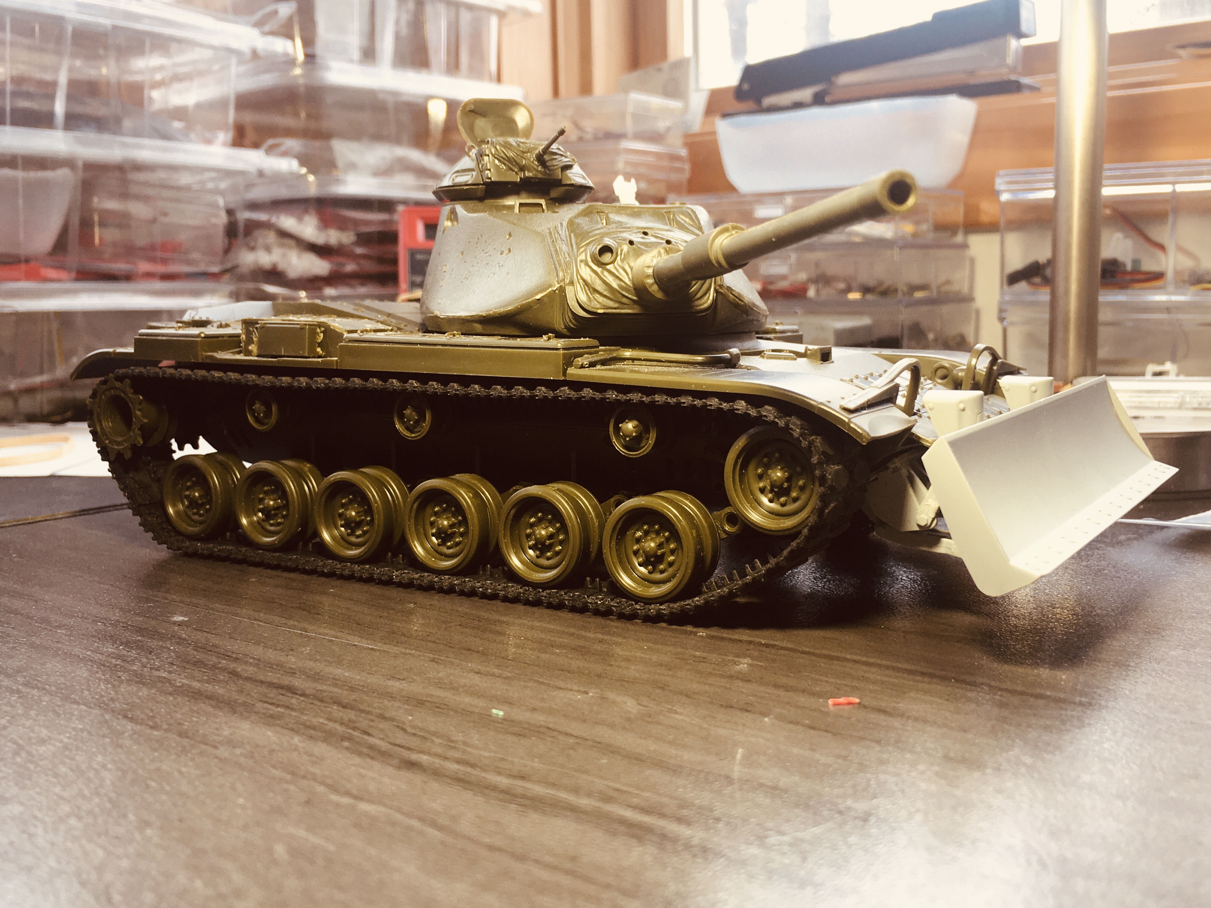

Dragon Dozer blade mounted on the Academy motorized model. Linkage added to make the Dozer blade remote control.

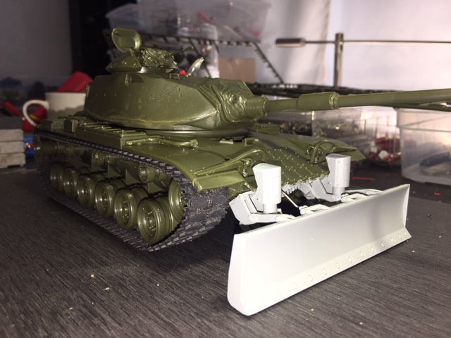

This shows some detail of the Dozer blade
Dragon IDF M60 Dozer Tank

You have done well to cram the electronics in there.
This looks fantastic.

It looks like a lot of electronics because of the connectors I added to the DSM receiver.I removed the tall 3 pin connectors then installed micro 3 pin connectors so what you are seeing in the pictures are the wires from the 3 pins connectors on the 6 channel RX. The Dozer blade servo sits on a mount that takes up some room as well. The Dozer servo is removable with 2 micro screws. Yes it is a small Dozer Tank and a bit tricky to get all that stuff in there for sure :D

Decided to update my m60 Dozer Tank. I updated the twin ESC's to one ultra micro ESC and changed the Blade control to Elevator control so Elevator stick up\down controls the Blade.

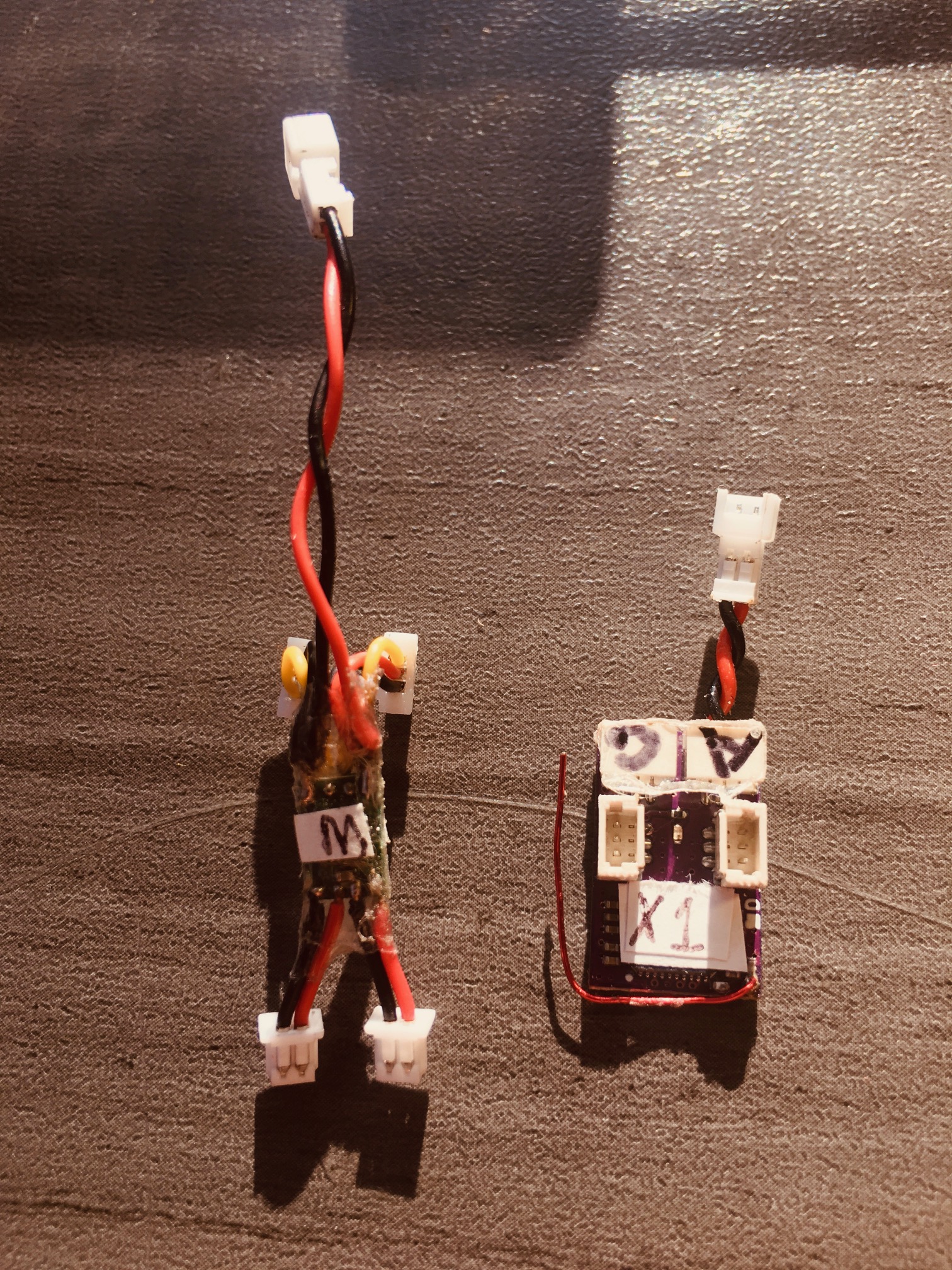

Latest ultra micro dual ESC\mixer with 6 channel AR6300 receiver. This one goes in the M60.
M means the ESC has a Track mixer. This is one of my smallest 5 channel receivers with ultra micro dual ESC with mixer. This is used in "worlds smallest Hobby grade RRC Tank.
3 channel setup. 3 more channels available.
Lots of room in the hull for more like Turret and main gun animation.

Yes indeed Herr Doctor :D The Blade arms need some reinforcement in the joints. I will be using small diameter pins to reinforce the joints so that it can do more than clear trable crumbs lol
