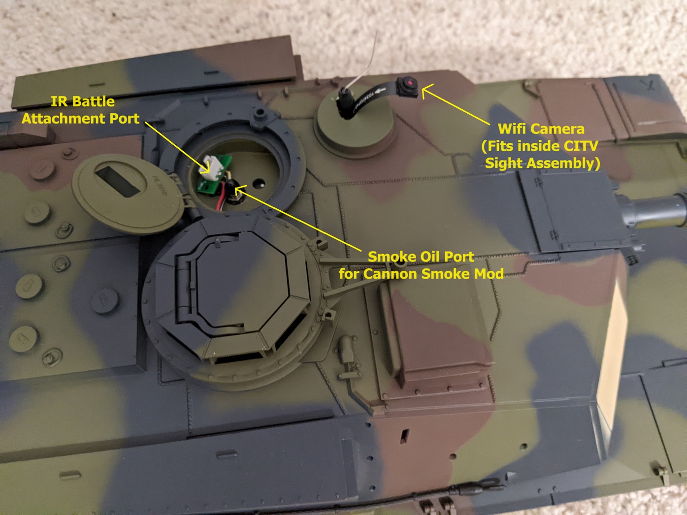

14 - I have already installed a 360 turret mod. After some trial and error, I now have this working with cannon smoke and BB firing.
15 - The Cannon Barrel smoke mod is now installed and working with BB firing. (Pain in the a##!) (Pics to follow)

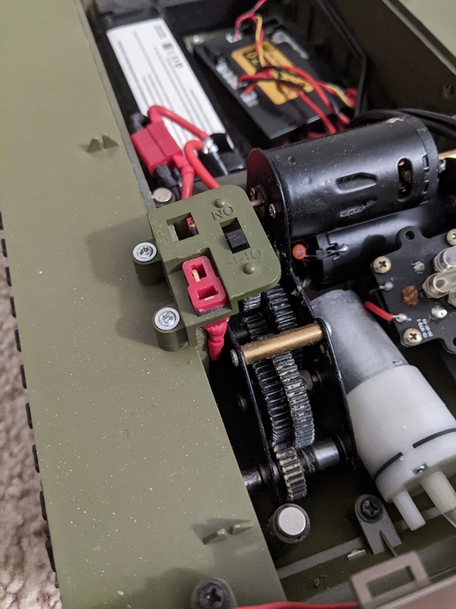

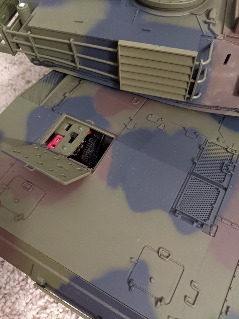

So, first up are a few pics of the battery charging mod. I dislike the battery box and plate on the underside of the Abrams, and I did not want to have to remove the top hull every time to charge the battery. Because of space limitations, I went with Deans connectors because they can fit in small spaces and handle the current we will be using just fine.
Below the red Deans female connector is a small metal plate supporting the connector so that I can push down the male connector firmly in without snapping off the resin holder.
With the top hull on, I now how this
Now, we just have to remember to have the turret turned a bit so that we can have access when we shut down for the day.

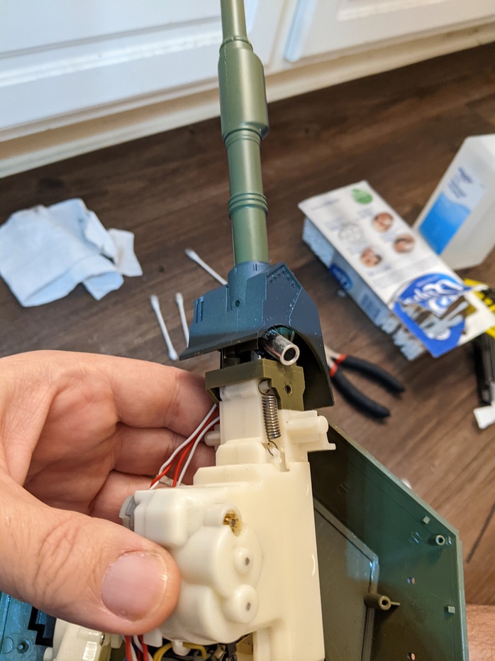

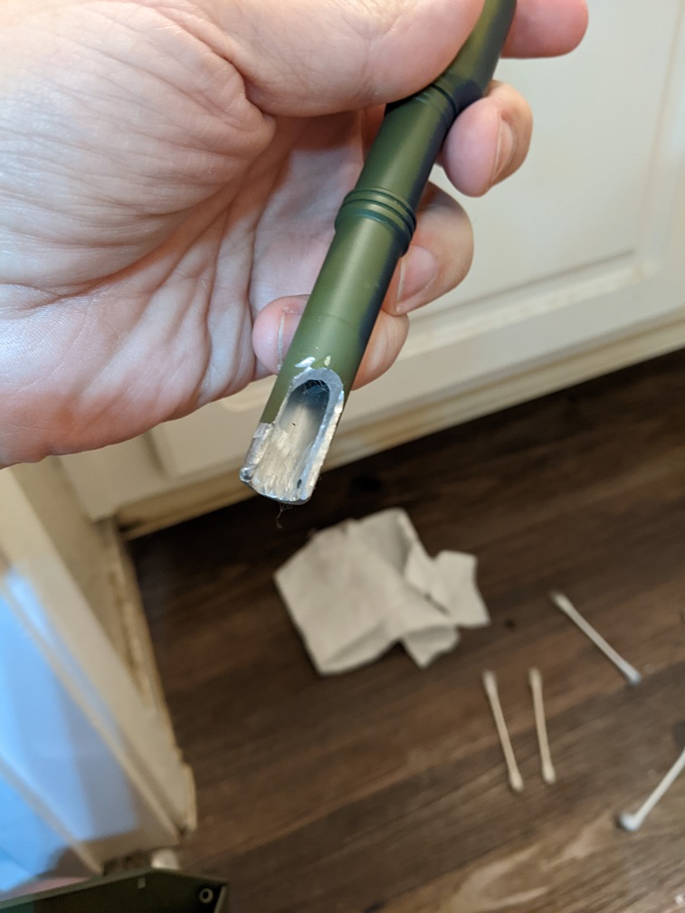

The second most difficult mod of this build is trying to get the BBs to fire while the cannon smokes, ... and then making this work with a recoiling barrel and a 360 rotation mod. I watched a few vids online from Stanlley Tai at RC Tank Legion in Malaysia and a few other guys but they all routed the cannon smoke tubing up through the BB firing unit. They ran a LED down the cannon, so that when the cannon "fires," the LED goes off at the end of the cannon and smoke comes out of the barrel, ... but the LED and the tubing block the ability of BBs to be fired. I wanted BBs to come out of the cannon with smoke right after. I could spend paragraphs describing what I did but better to post a few pics instead:
(You will need a drill and dremel tool to do the mods below plus some soldering skills and/or JB Weld.)
Step 1 - Adding an aluminum "receptor" tube to the inner barrel to accept the cannon smoke tubing. I had to drill a slanted hole in the inner cannon barrel and then cut a piece of aluminum tubing just wide enough to accept the tubing coming in from the smoker unit. I then reshaped the end of the aluminum receptor tube with a dremel tool to perfectly mate against the inner barrel. I put the receptor tube at a 45 degree angle on purpose so that most of the ejected smoke travels down the barrel to outside, rather than back inside the tank to the BB firing unit.
Step 2 - Cutting the aluminum outer barrel so that it has room to slide down over my mod and the inner barrel.
Step 3 - Reattach the unit together. (Although you can not see it in the pics, I also made a custom pull plate so that the barrel gets to move about 30% further, which makes the barrel recoil action more dramatic.)

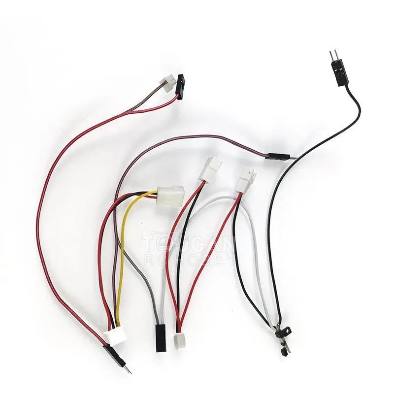

Step 4 - Hooking up all the wiring. My job was made a bit easier by utilizing this wiring kit made specifically for cannon smoke + 360 degree rotation by Toucan Hobby:
I then followed the directions in Part II of this video (from the 2:10 time mark):

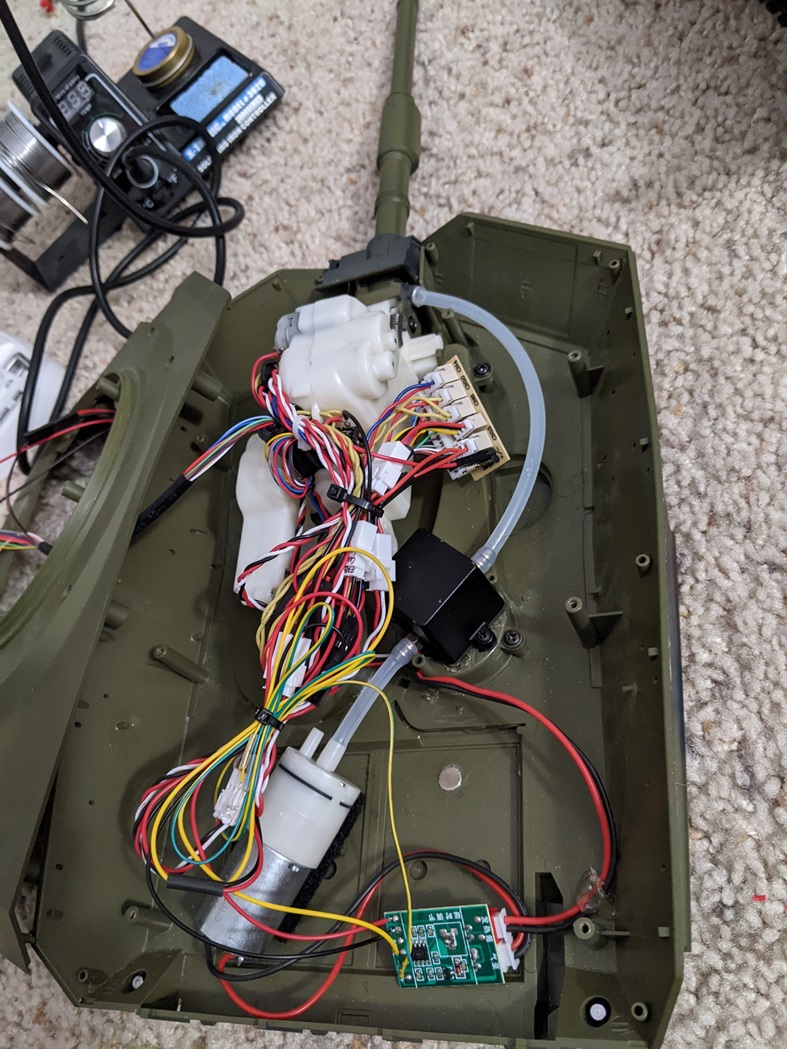

Step 5 - Affix the cannon smoke components to the inside of the Abrams turret. (The tubing only enters the cannon attachment tube for about 6 or 7 mm.) I attached the main smoker unit under the Loader's hatch access. I also moved the IR attachment port to the side.
How does it all work? .... in a word, ... excellent. We now have BB firing + cannon smoke + recoiling barrel + 360 rotation. Because of the extra switch affixed to the BB firing unit, .. the smoke comes like 1/5th of a second after the BB fires, which is exactly what we wanted. I will try to get a video posted shortly.

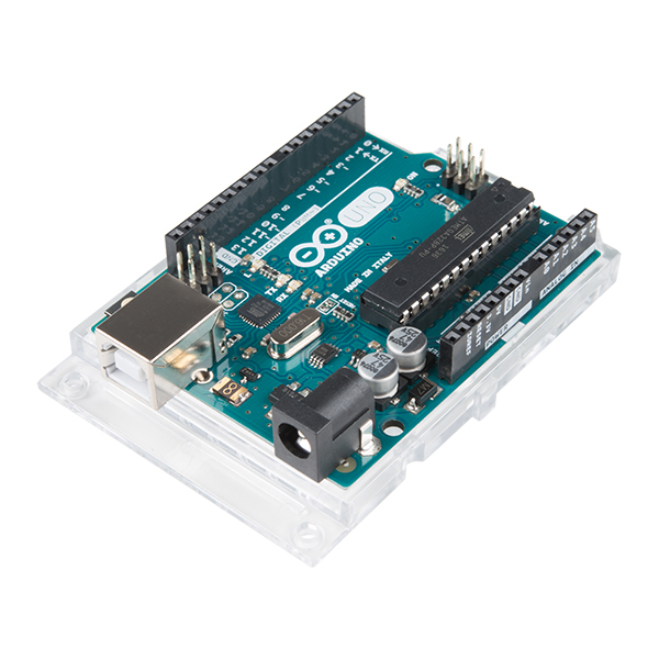

In order to get true artificial intelligence up and running on the Abrams, we need a processor and sensor suite that handle the code and timing that will be needed to defeat real humans. Unfortunately, a Heng Long 7.0/7.1 MFU or Clark or IBU does not have the processing power or is able to accept the sensor inputs that we will need to get the job done. I am considering several boards but will probably stick with one of the Arduino kits if I can. Why Arduino you might ask? So other ambitious modders can follow our thread and because Arduino kits are available worldwide and tend to be cheap. A huge amount of guides and How To's are also available to the beginner. If successful, other tankers will be able to follow our project for less than $150. Still checking, but it does not look like their classic Uno Revision 3 will be able to get the job done:
We will probably have to go with a Mega or Giga board.
Items we will have to account for as we consider boards:
1 - Will the processor run our code in the time needed to defeat real humans?
2 - Can the board accept the sensor suite we will need to detect other tanks?
3 - How hard will it be to make it electrically compatible with say, a 7.4 volt NIMH battery? (And of course, how wattage hungry is our processor? What size battery will we need to power it for say 30 min or more?)
4 - How easy or difficult will it be for our Arduino to mate to say, a Heng Long 7.0 MFU? If we can't mate them, how hard will it be to run the Heng Long MFU in emulation?
5 - Will we have room for the board and sensor suite in our Abrams?
Stay tuned, .... never tried to make an A.I. RC tank before, LOL
