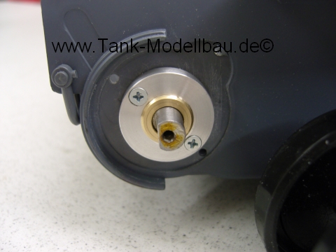

forgebear wrote: Fri Jan 26, 2024 12:22 pm 173_01.jpg
like this
Of note this helpful pic Dave posted is with the final drive housing "popped" or "cracked" off, note the sheared 2 upper pegs. The HL Tiger I doesn't affix this outer cover the same as say Panther G or KT or others which use screws and are a cinch to remove and re-install.
Panther G housing before I installed axle support bearings.

Thanks for the info and pictures. I've checked the bearings with the driveshafts and I'm pleased to say they fit perfectly, so no temperature shenanigans required. Just to double check as well - should I lubricate the axles/bearings or should they be run dry?
The good news is I do have a pin vise, but I do need to get at least one appropriate drill bit. The drill bits I have are rather cheap and perfectly OK for drilling small holes in plastic but will just blunt against anything metal.
Something else I need to double check, the screw that attaches the metal hull plate to the plastic hull that sits inside the transmission cover is not fully flush with the hull.
Am I right in thinking that this is what the washers are for that are supplied with the driveshaft covers and they should be placed between the bearing and the hull when being screwed in? Or should this screw be removed so the bearing can sit flush with the hull?
Thanks.
Posts: 7533
Re: Tracks not meshing properly
If you are fitting ball race bearings,they should already have grease inside, behind the covers.
But if you are fitting the brass/bronze bushings, a thick oil or thin grease in the hole/on the shaft would be a good option on assembly.
