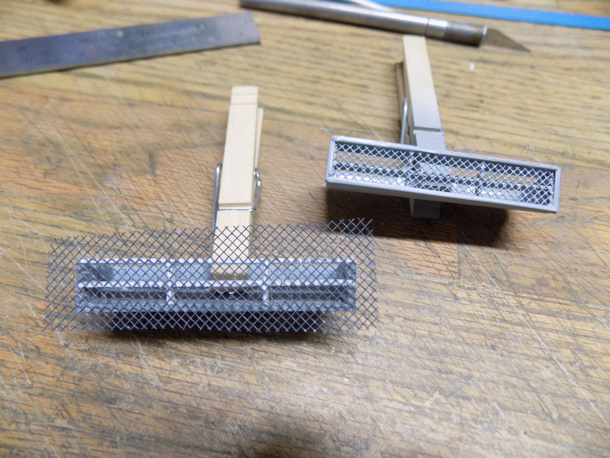

Used regular model cement to stick the screen to the box. After the glue dries a pair of scissors trimmed the screen. Then CA to mount the angle on top of the screen.

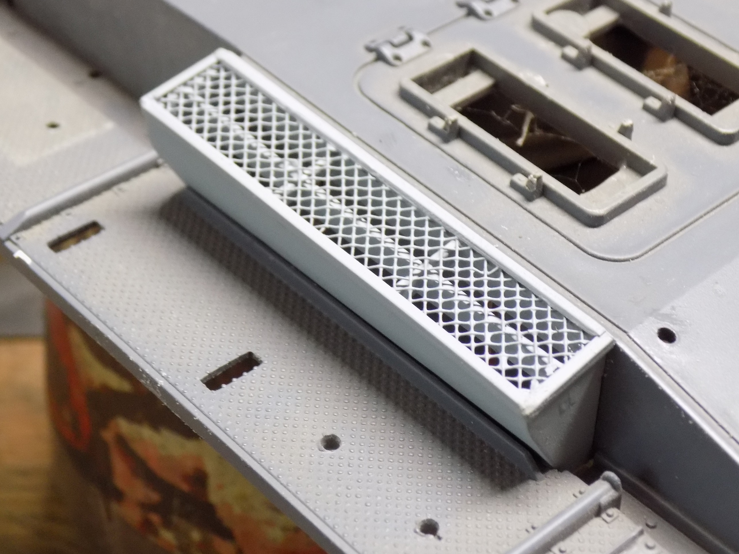

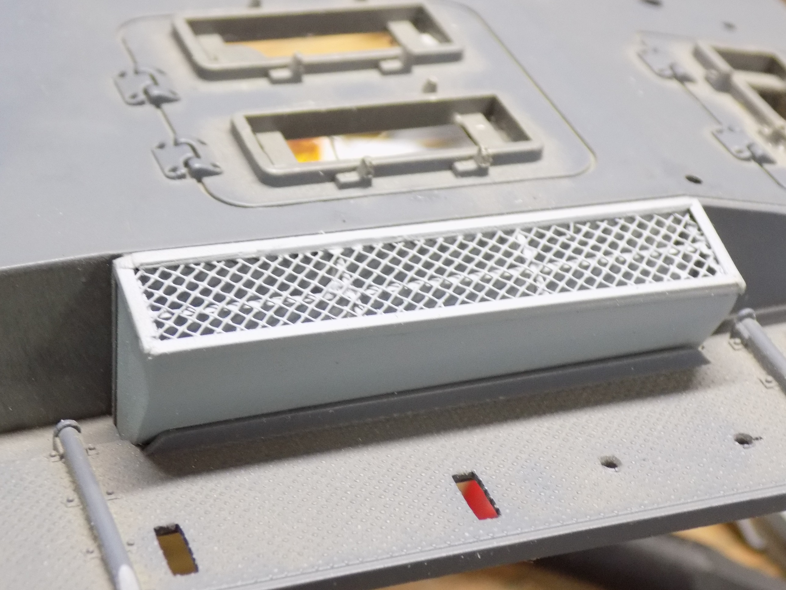

Best overhead view I could come up with

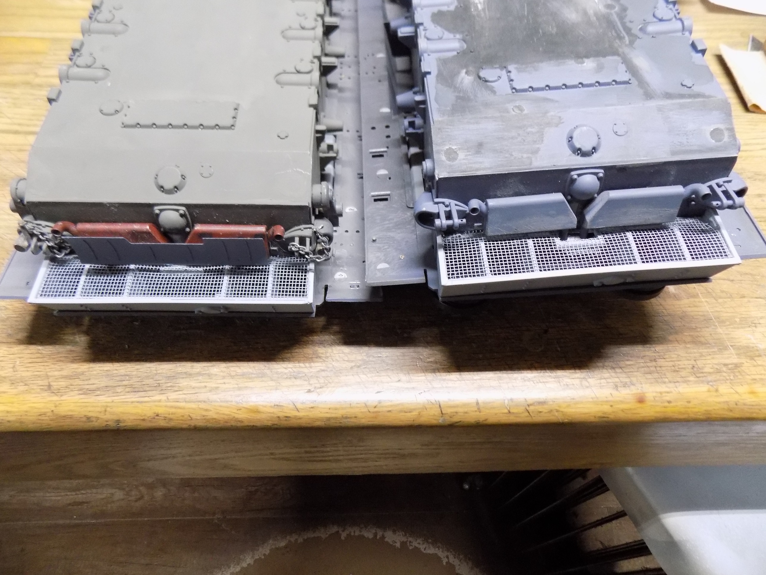

So while waiting for glue to dry on the other set of vents, I worked on the spare mounts for both threes.

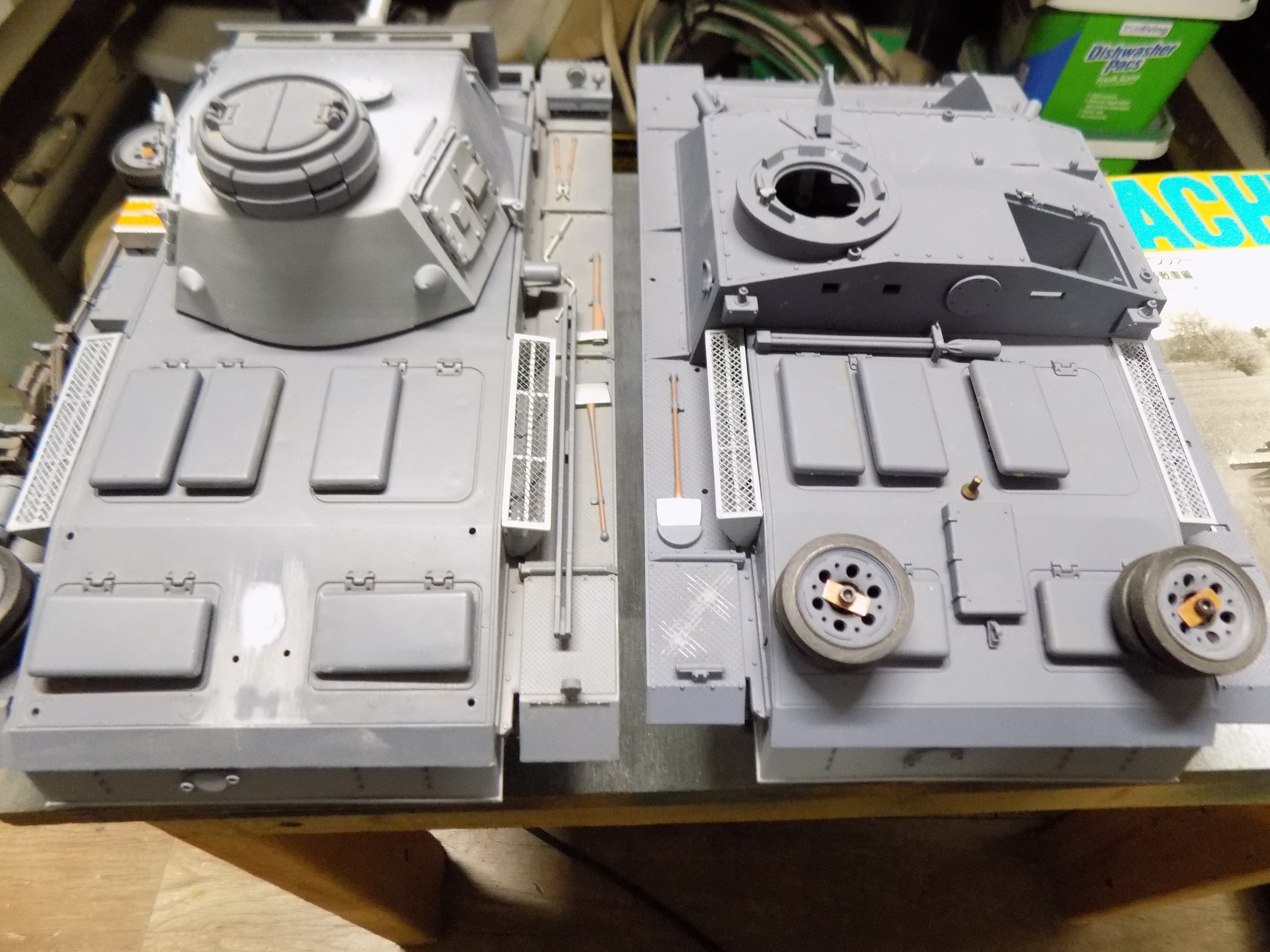

Intake screens for both complete. And while I was in the mood...
