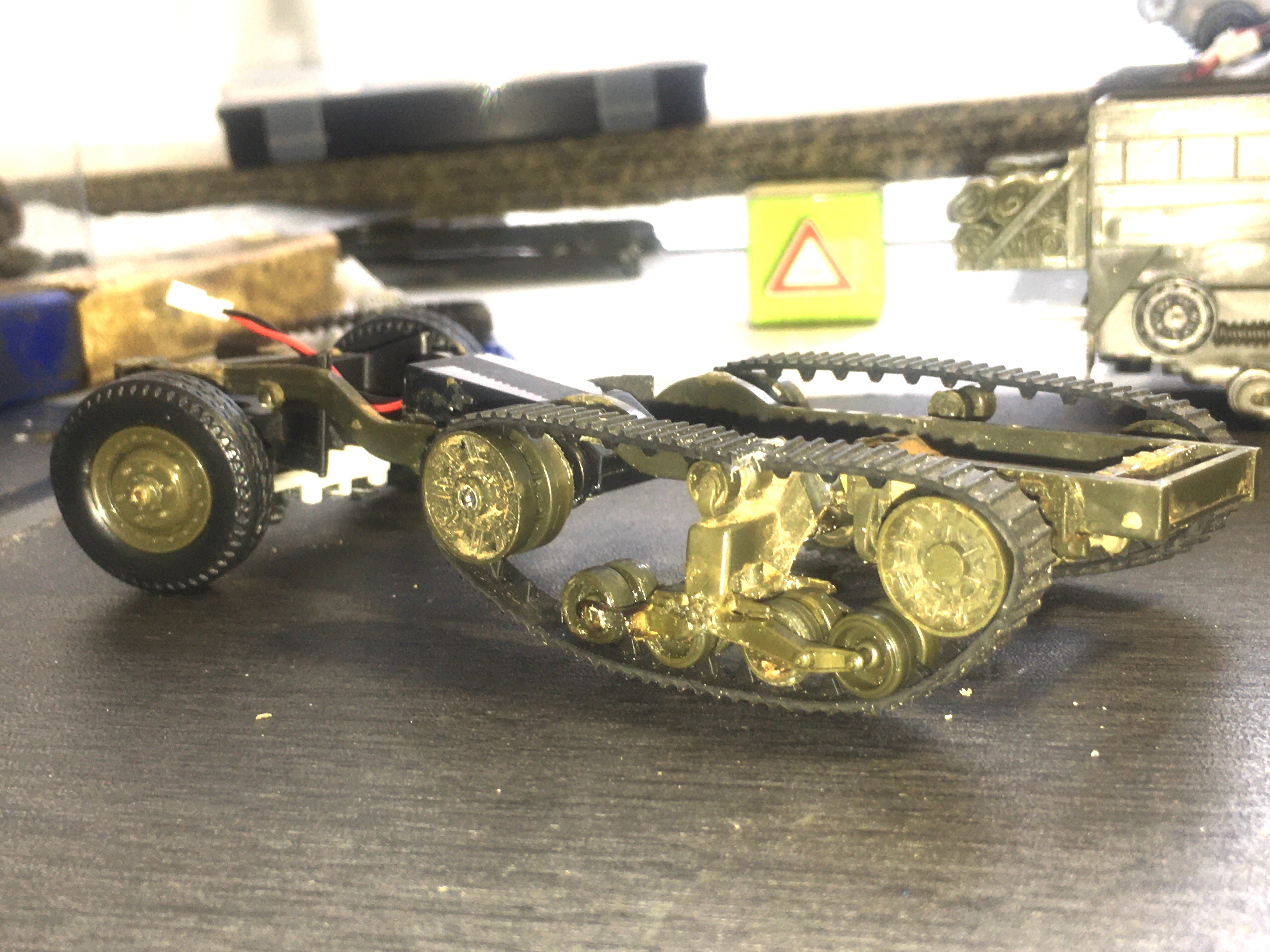

Yes and I am very attached to this model. A little paint job and some repair work to the body and it would be presentable ;) But that won't happen as I like it as is :wave:

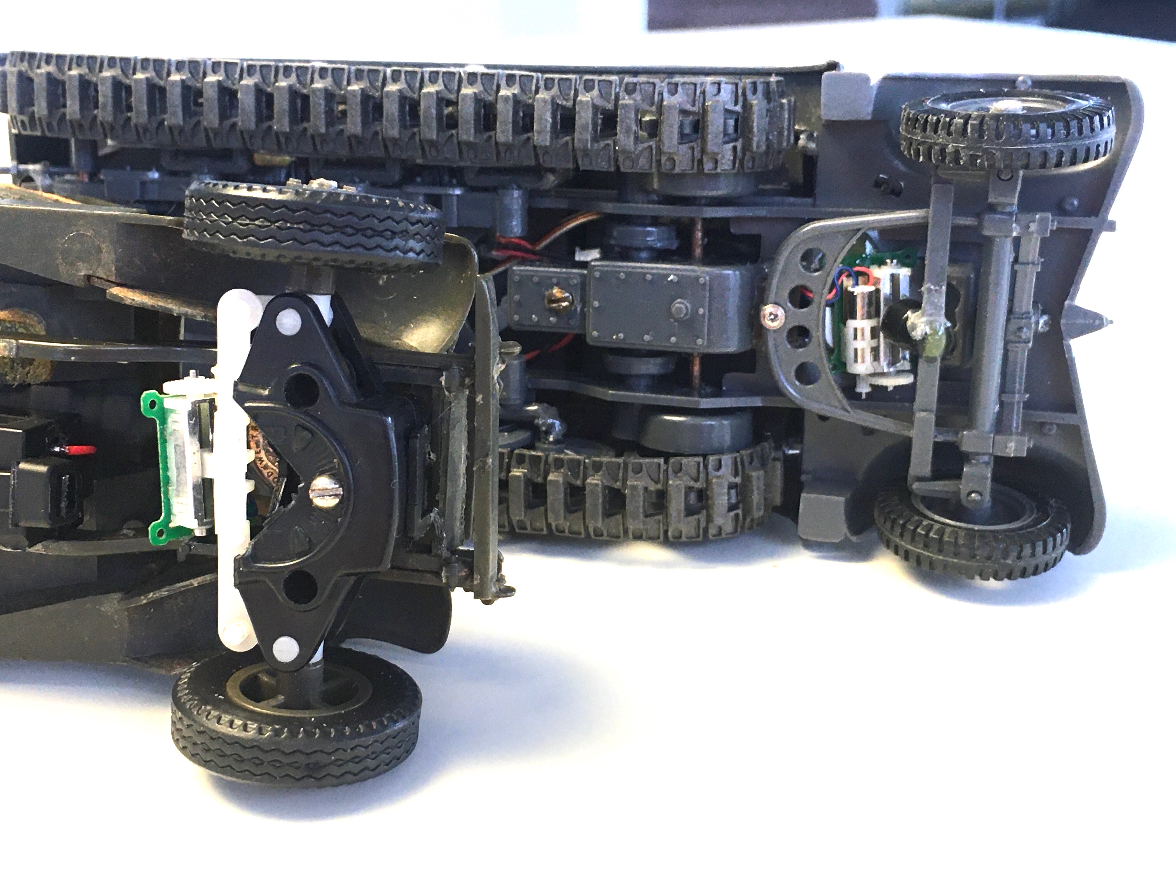

The photo shows a tie strap mod for holding the GB together instead of gluing it together. This mod makes the Gearbox "Hobby Grade"
Testing the M4 HT proves this mod and the GB screw mount works great.

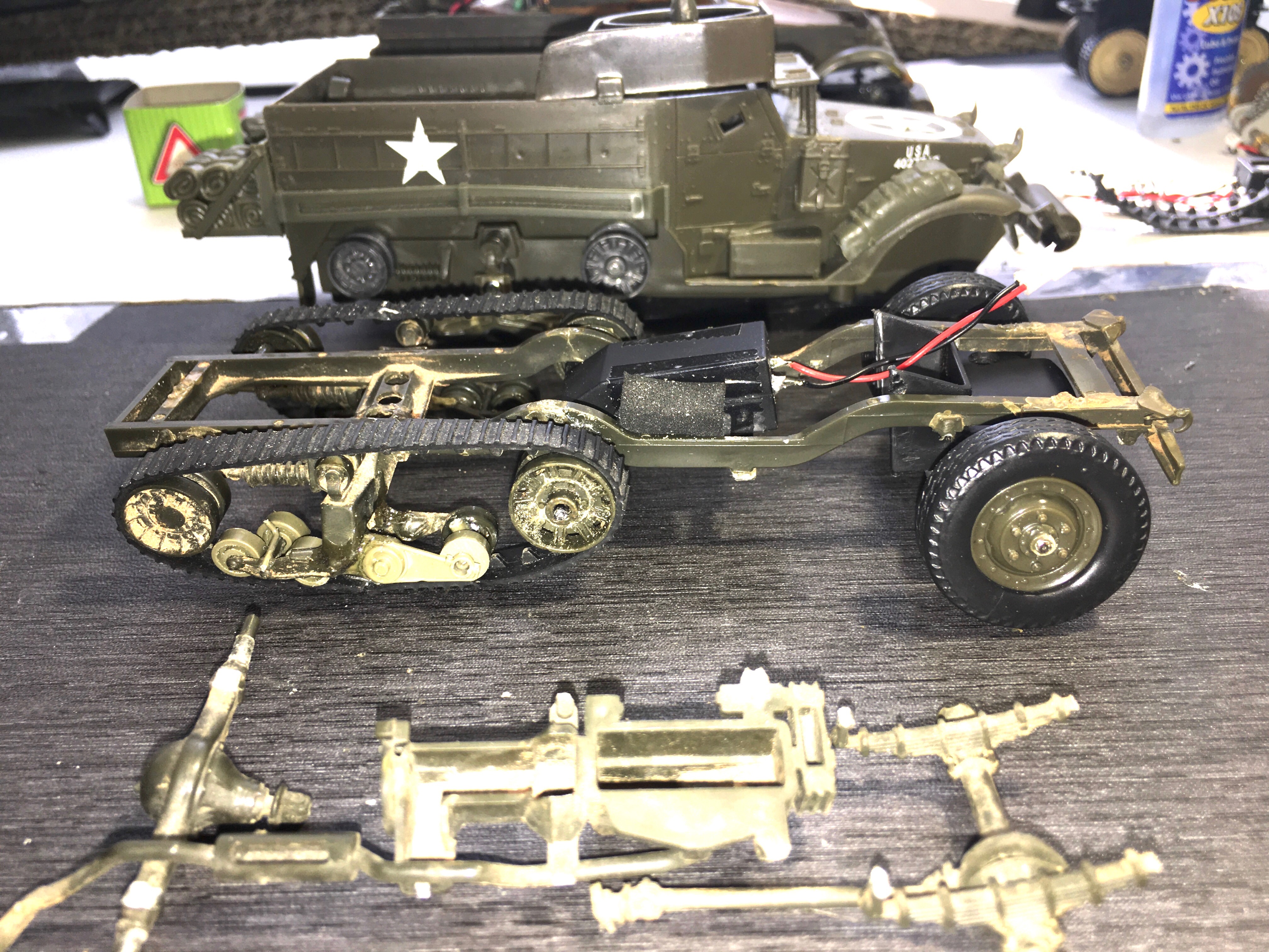

Ok got it figured out with posting the larger pictures.

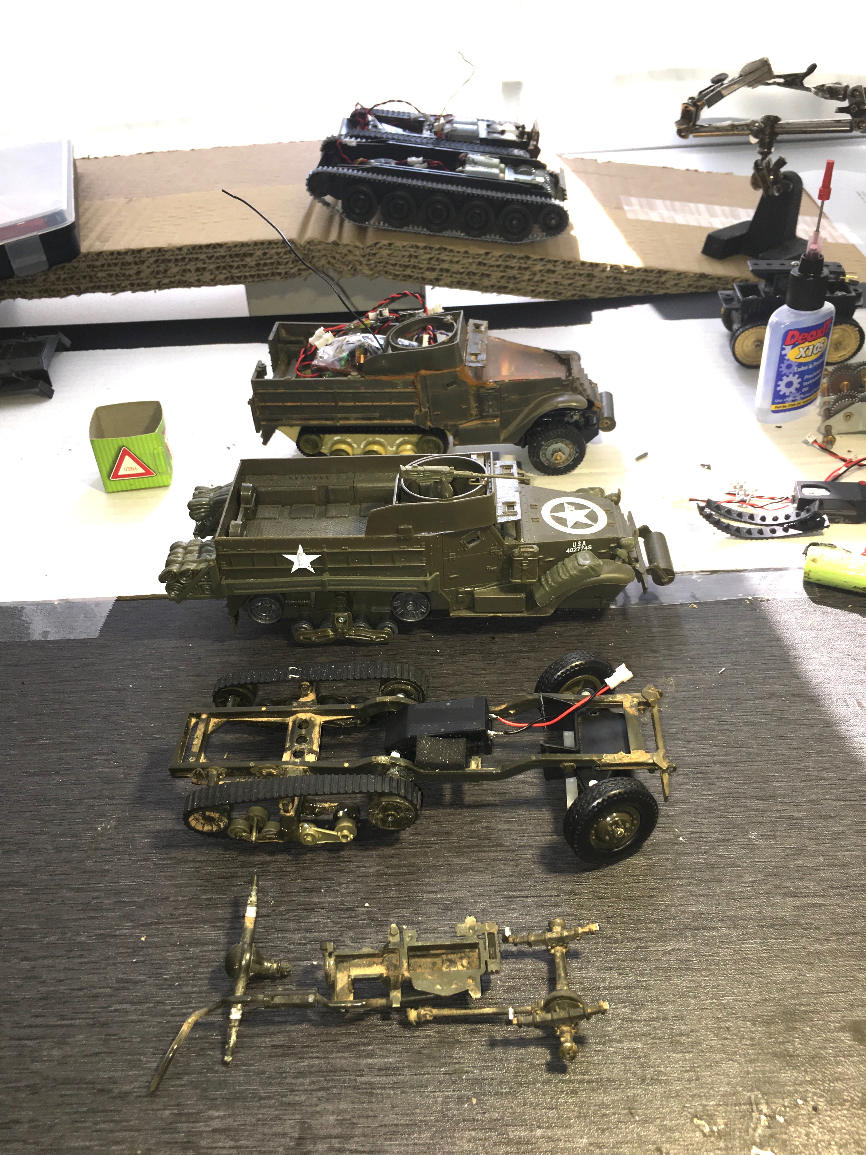

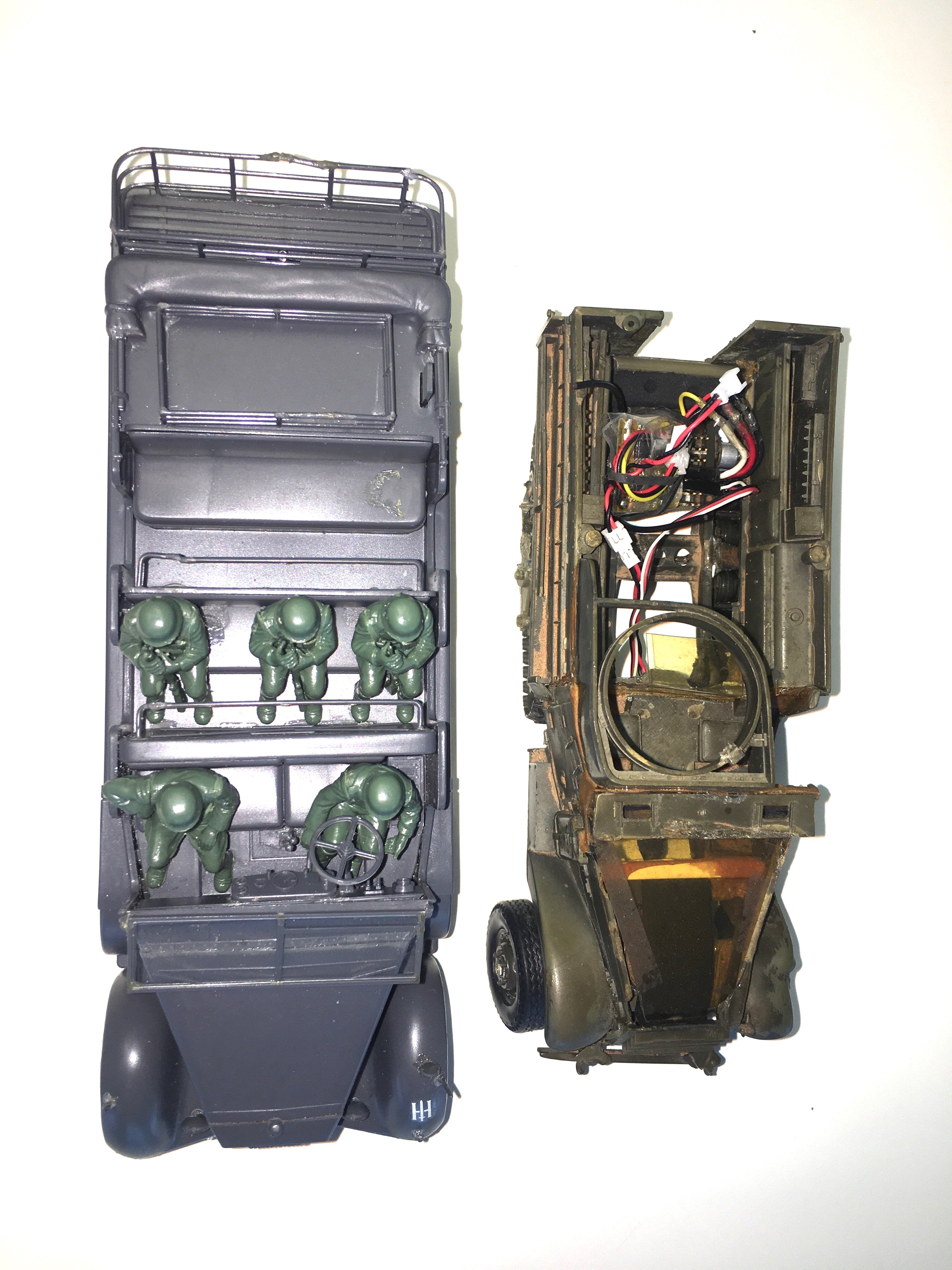

showing this  as a reference as to what I can build now
yes this looks much better

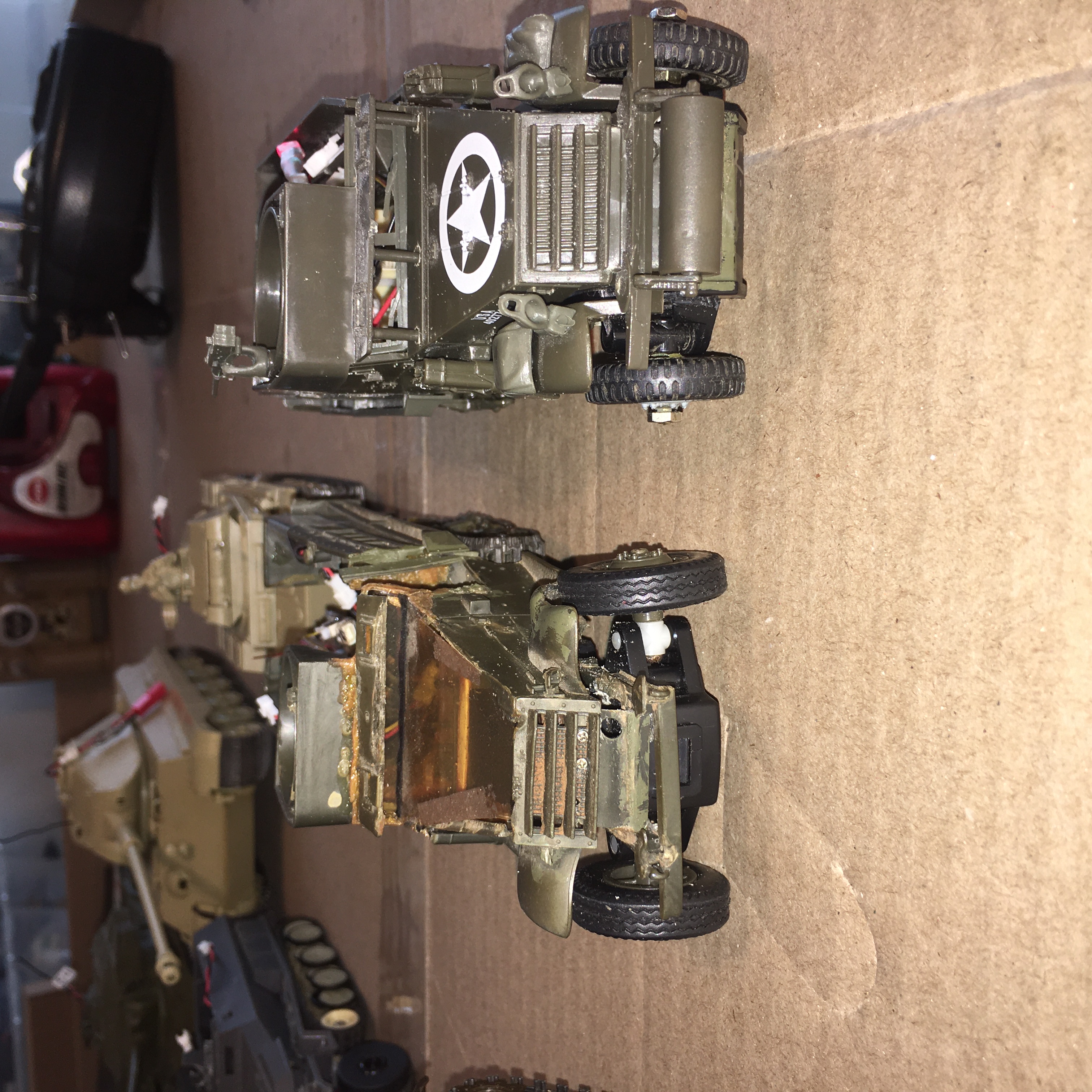

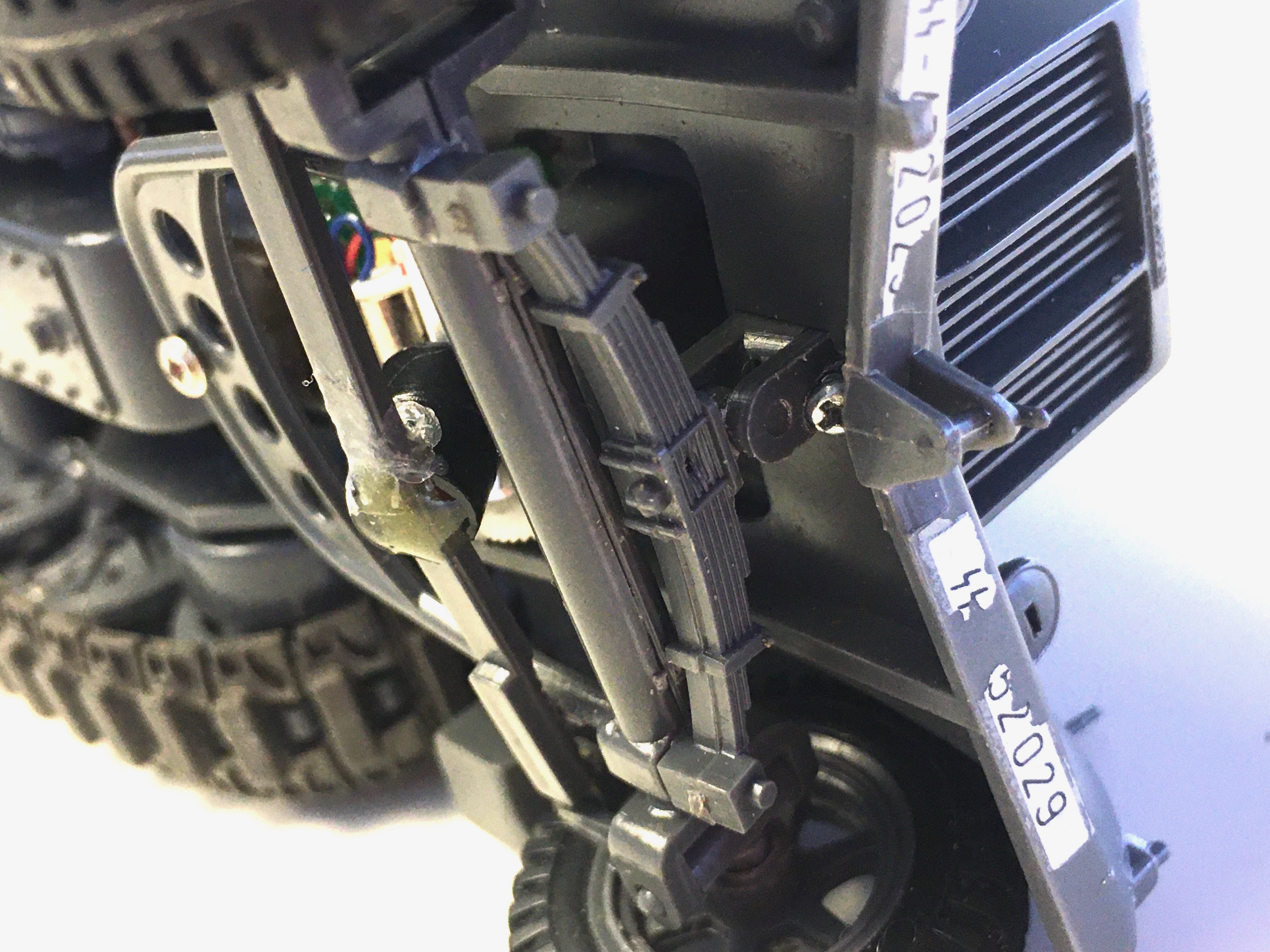

Stock front end suspension used on the German HT
Old work VS new
Old work VS new

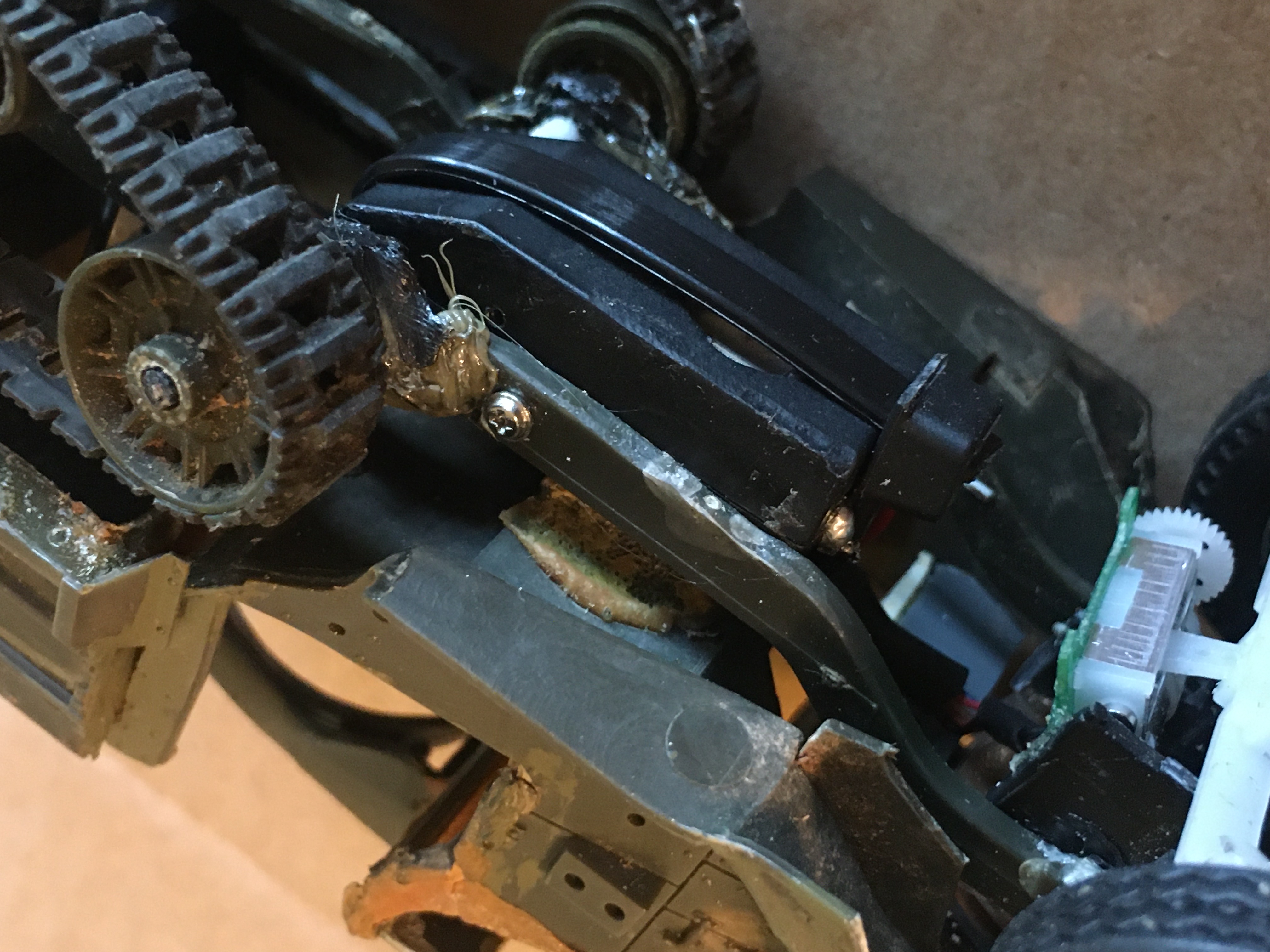

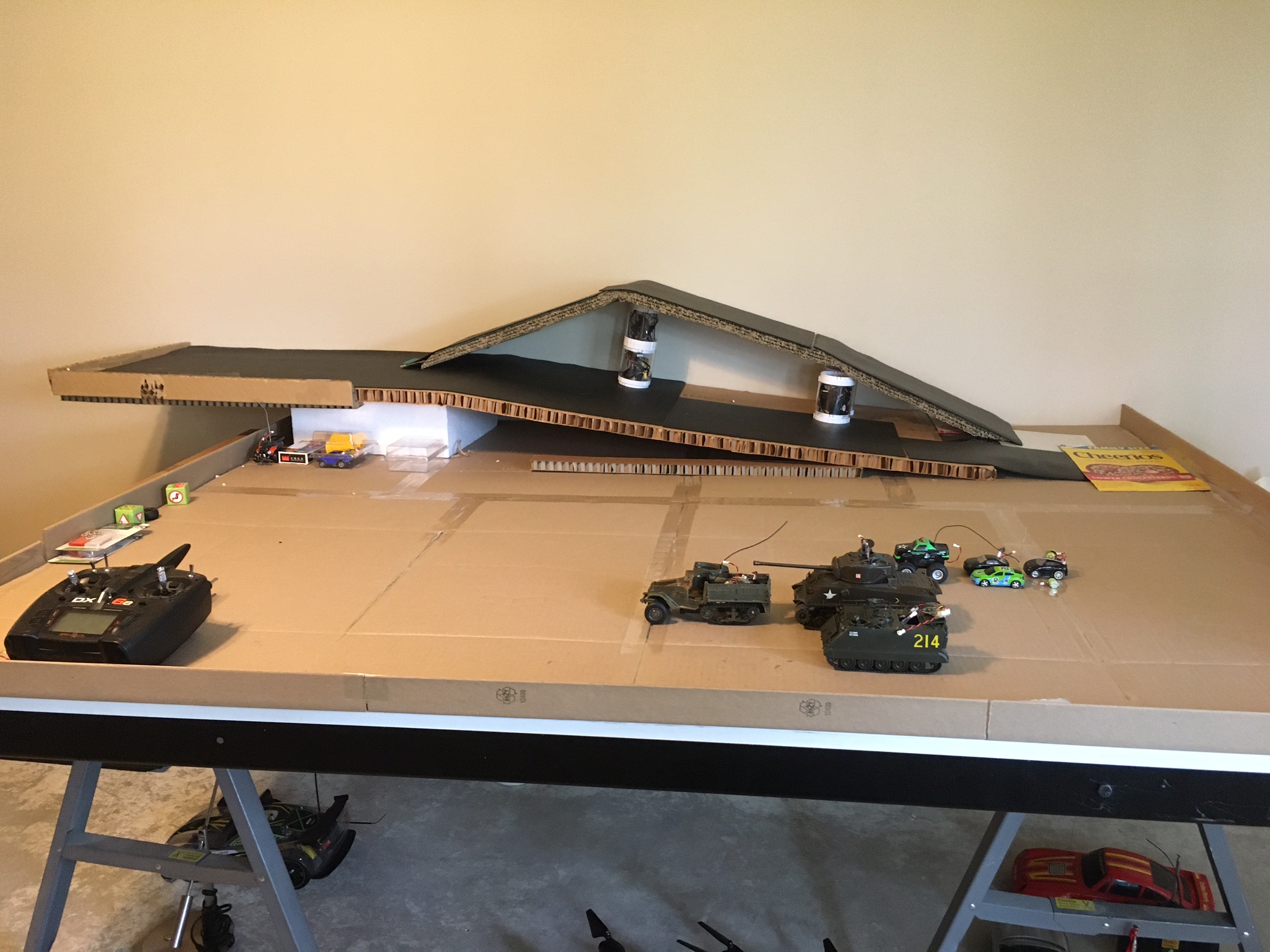

My M4 HT has worked good until recently on my new indoor R\C test track, the M4 started to have "Sprocket track slippage" due to the 40+º incline run on my proving ground track. I realized the track tension shifted as the flexible glue I used to hold the MTM gearbox in place was not sufficient to hold the Sprocket\track tension under this extreme loading.
So I added a 1 screw tension mount to the MTM Gearbox and problem solved 8)
I will add a video of the M4 climbing the track ASAP
new test track
new test track
MTRM GB 1 screw mount.

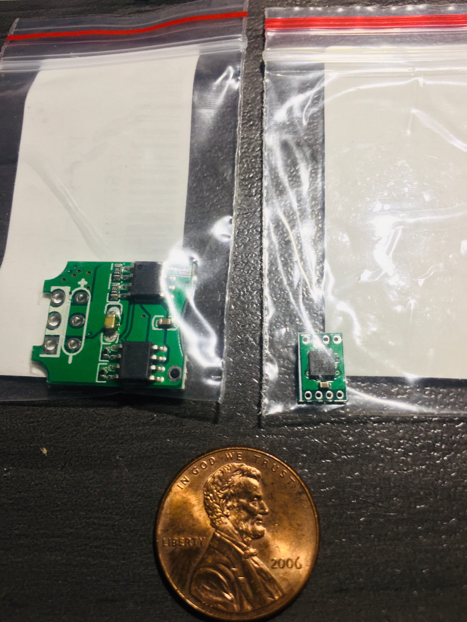

I ordered some of those 3 amp 1s Esc's and got them today. These look pretty small and will let all know how they work. I also ordered some micro dual ESC's and now after seeing them are impressed how small they are.
very small dual ESC
very small dual ESC
The one on the left is the one shown above, I will be testing these for use in my models but I am really excited about the one on the right! That is a DUAL ESC with mixer for tanks or tracked vehicles

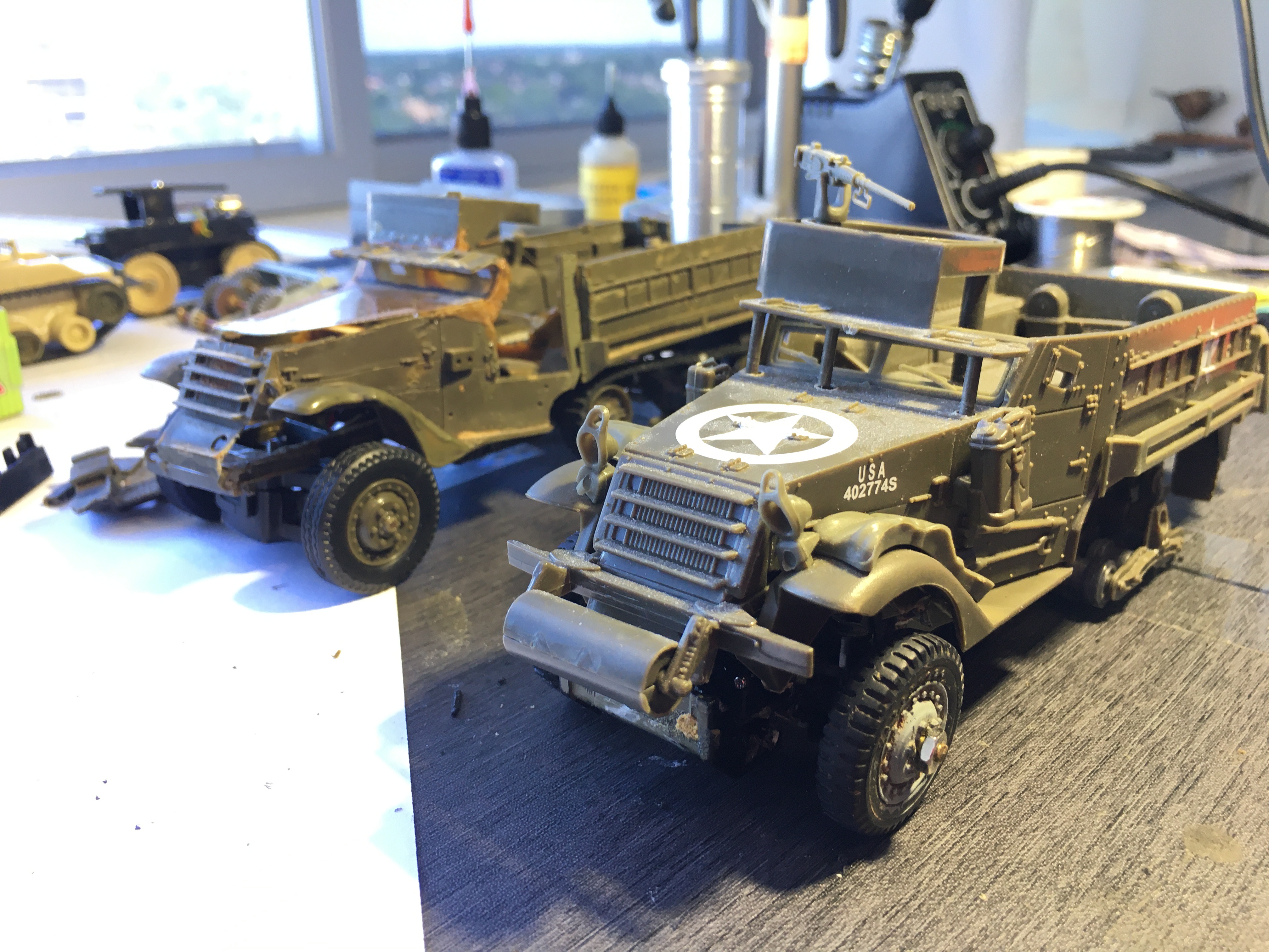

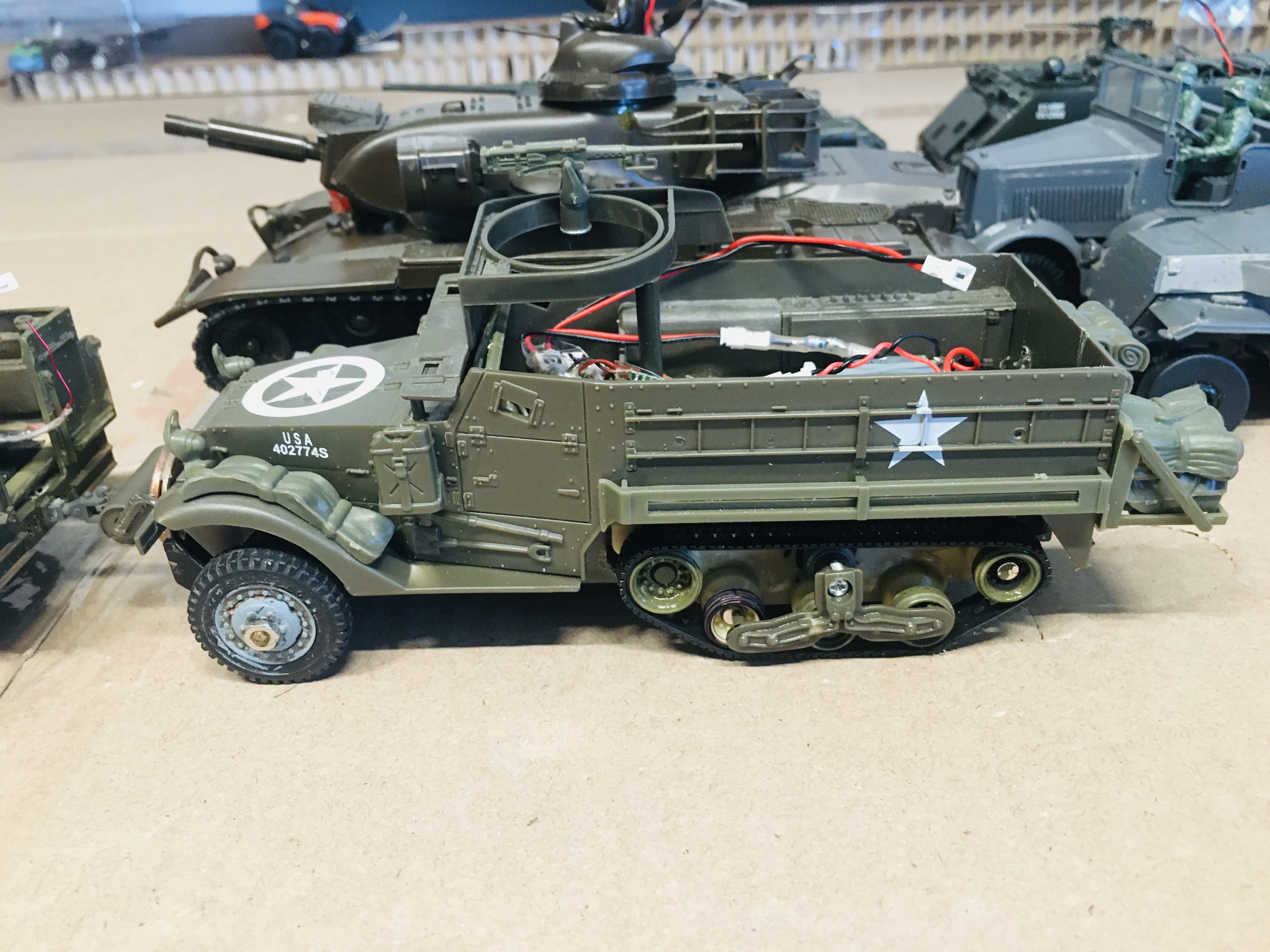

Meanwhile, here are some updates to this thread. A new Half track is added to the fleet. It is the same one that was shown in this thread in the background. It is a Testers model from the local drugstore.

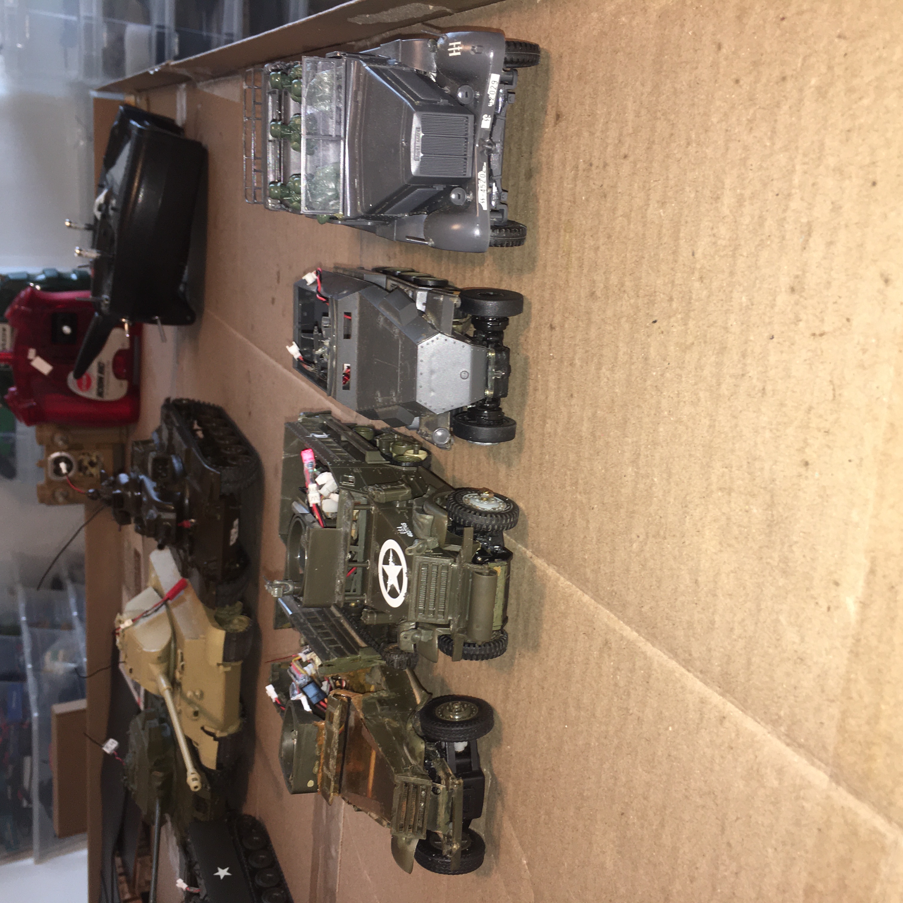

I am currently running these 8 models on the new track.
Here is the current 1/35 running Half Track fleet
Left is Arizona Tamiya M4 HT now has companion Testers M4 HT...JOY!

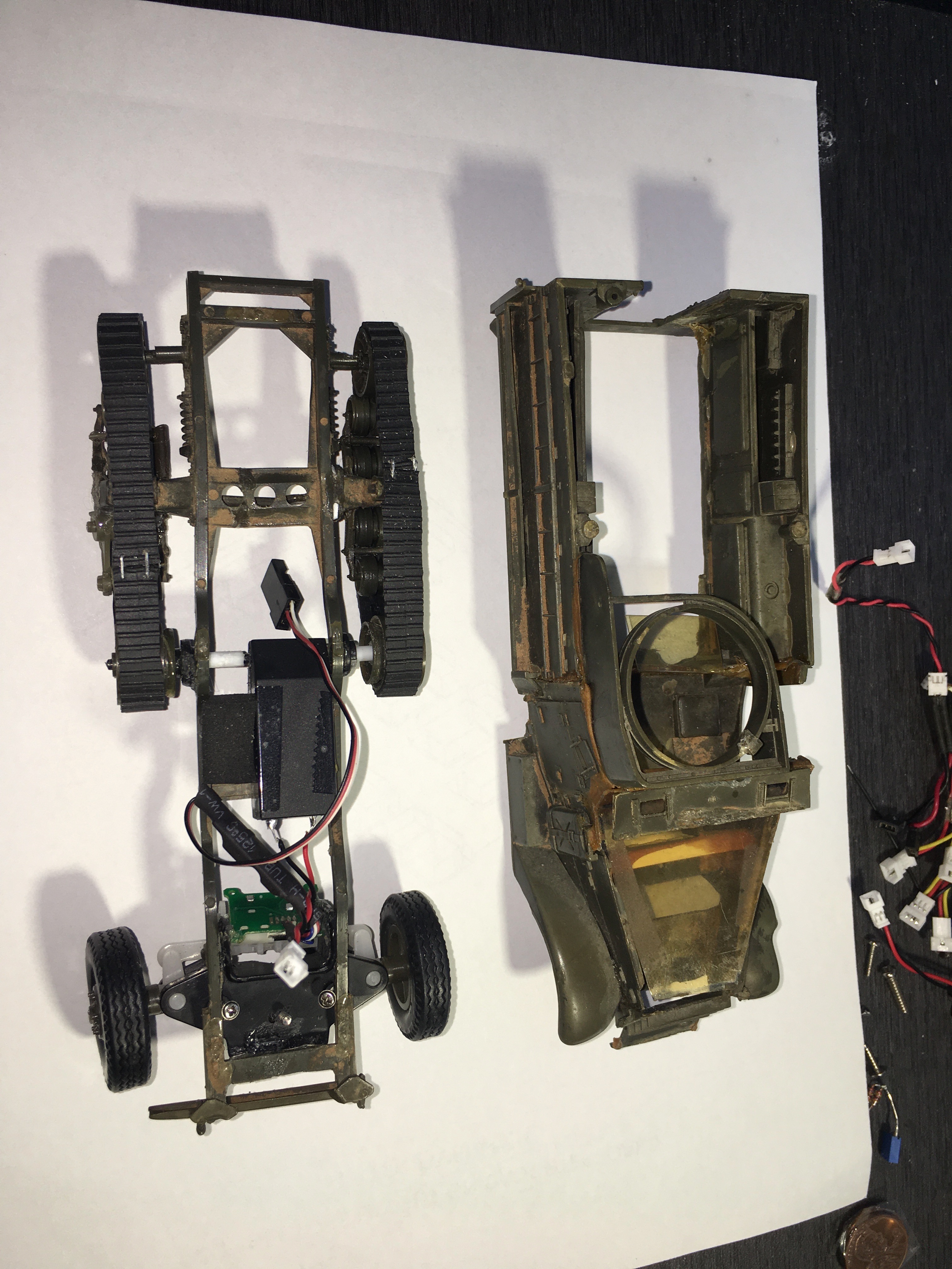

the Arizona models escapement steering box was upgraded to a HQ micro servo in place of the coil escapement using the same frame as it contains robust steering  components ready to use. So I am using the left over parts from the Upgraded M4 HT to build up the Testers model but with improvements and mods rto those leftover parts.Recycle i say!
I repurposed the old track drive unit from the Arizona model and trimmed it up to fit the Testers model.
