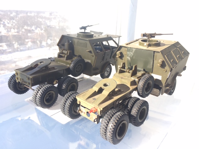

In this thread I talk about and show a Peerless Max M26 - M15-A1 used Tractor trailer from ebay that I recently acquired for a very reasonable price. After bringing that model back to life by converting to DSM2 RRC and fixing most of the things broken on it I realized that my original P-Max needs some cosmetic work. I had modified the back of the cab area to allow for a servo installation years ago when servos were still quite large. I never realised how bad that looked until I had both sitting next to each other. I somehow still had some of the parts for the original P-Max to reinstall.
Below are some pictures showing the progress of this P-Max#1 retrofit.
On the screen display of my Dx6i, the model memorie for this model is P-Max #2. So I have two DSM2 RRC P-Max models in running condition and I will feature both here as soon as I have the bugs and retrofit completed. Because they are Both DSM2, I can run them together sequentially using the same Transmitter and if the Tanks on the M-15-A1 trailers are also DSM2, they can all be run sequentially with the same Transmitter!
This DSM sequential model operation is something I have been thinking about for awhile now and I have already done it with other models with control of 2 models but then I realised I could have as many models available to run that is only limited by the number of memories available in the Transmitter.
So I plan on running both P-Max models and both Tanks that are on the trailers for a total of 4 models to be run sequentially with the same TX with the ability to switch to any of the four models at any time simply by selecting the models memorie number on the Transmitter and downloading its data on the TX to run it. I may do a seperate thread on this model running theory as I have not fully exploited its potential and options yet.

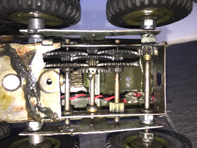

P-Max #1 has a custom all metal 4WD gearbox (rebuilt\modified from the original steel gearbox frame) with Mabuchi 130 motor that recently was reinstalled as it was finally perfected. It is a very smooth drive unit with super low speed throttle resolution that I have always wanted from this model When backing up with a Tank load, load speed resolution is a must for realistic operation. This model runs on a 1s lipo.
P-Max #2 has the original 2WD metal gearbox unit with original Mabuchi 140-RH motor. This model runs off a 2s lipo.
I will be able to operate all 4 of the models sequentially with one Transmitter simply by selecting the model number on the screen of the Dx6i which has "model match" based on model memorie number. The original intention was to make sure only the correct setting get used for a given model thus avoiding accidental crash due to wrong memories setting being used. It can also be used for the purpose outlined in this post.
Both M26 and M15-A1 models are back in service and ready to haul some Tanks!

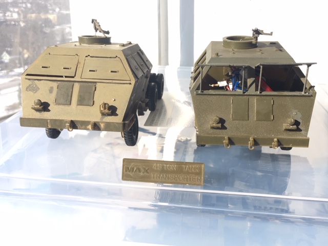

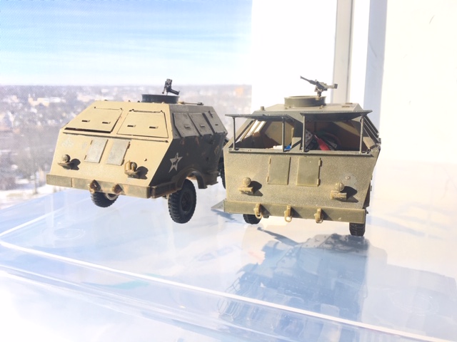

Original P-Max #1 free standing info display sign, Hard to believe I managed to keep this intact with the model for 42 years! I am a  pro hoarder lol.
P-Max #1 is the first military model RRC model I ever converted to RRC. 40 some years later, I retrofit P-Maz #2, a used ebay model to RRC.

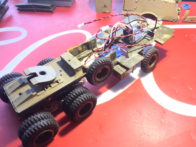

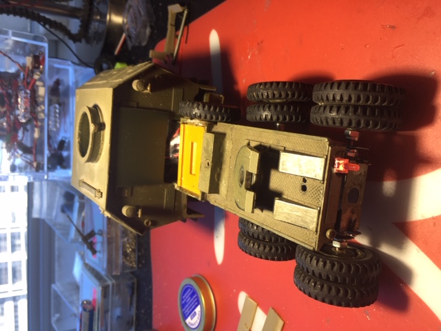

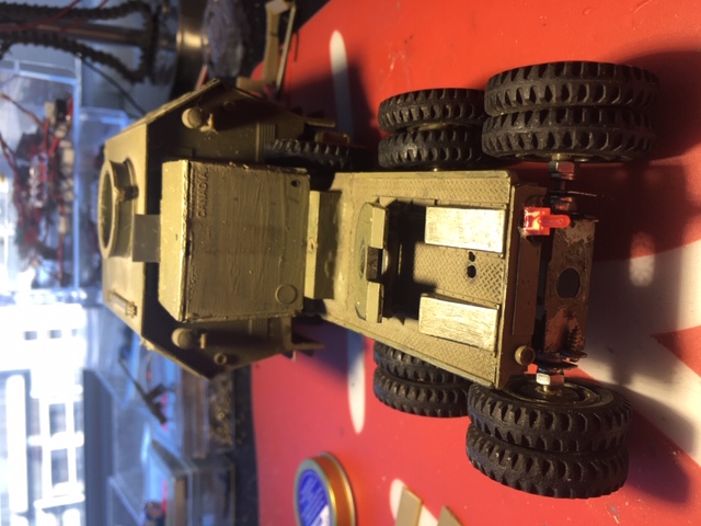

starting the structural repairs as this model was structurally compromised adding that box so I will restore the frame integrity as part of this retrofit.

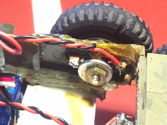

While this area is exposed, I will finally get the factory power switch working again after 40 years lol
This is what I had after removing that ugly structure. The new blue very small servo can be seen. I wish I had taken a picture of that huge servo that was here lol. The spare tire is the factory on\off switch on this model. It originally was a motorized model with switch on\off control.
I had to add this big servo box to the back of the cab in order to add steering to this model many years ago. last year,  I finally added a modern servo and now this ugly box needs to go away!

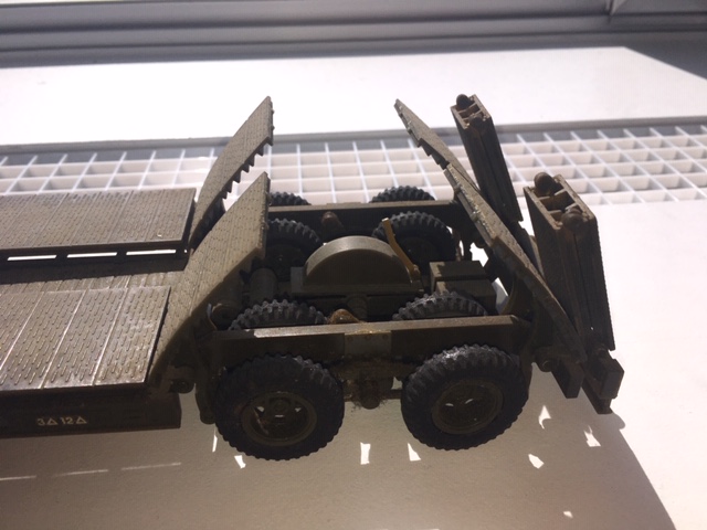

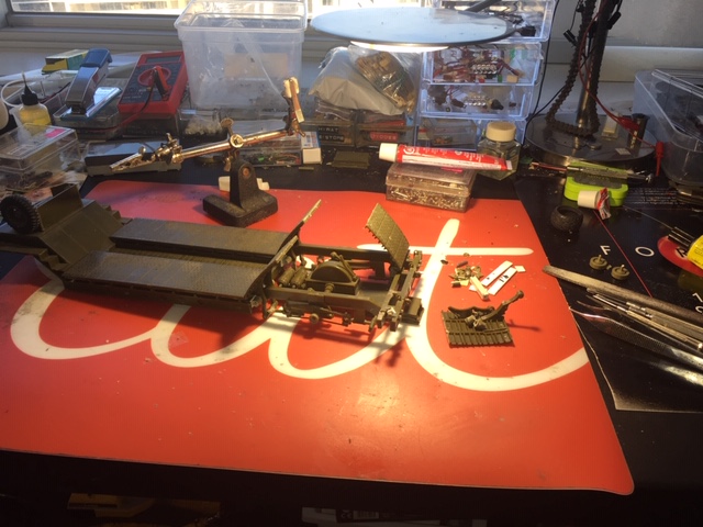

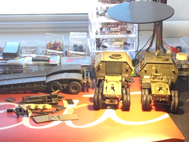

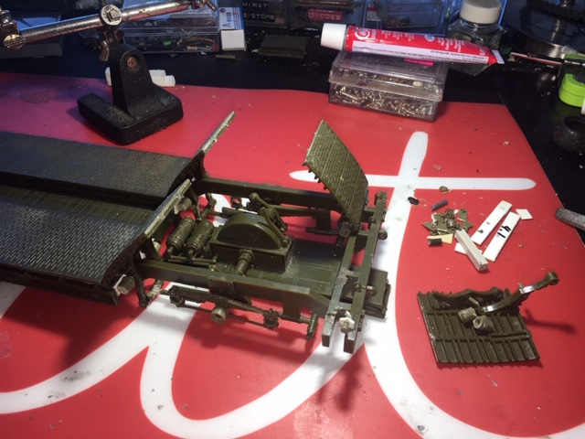

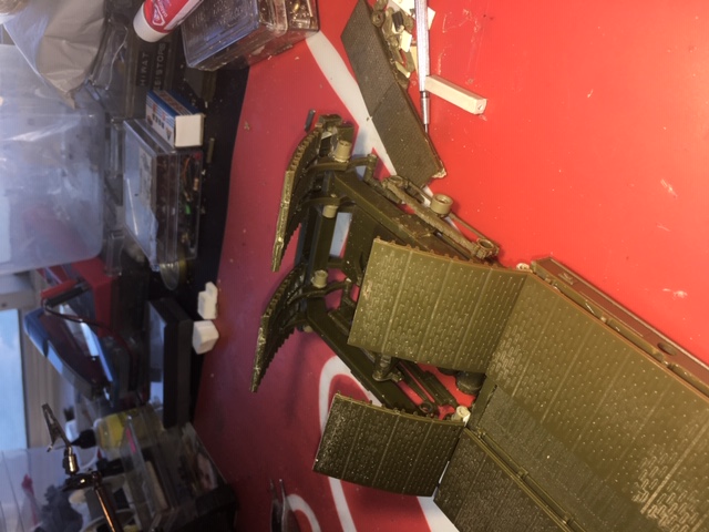

I was driving around my Peerless Max #2 Tractor A15 Trailer around and decided that the ramps needed to function properly so I put the trailer on the bench and it was in pretty bad shape. I bought this second P-MAD on ebay back in December of last year and have been working on it since then and finally got the M26 Tractor working very good with a DSM2 upgrade. This A15 trailer is quite complicated and to restore full function to the ramps will take some time. Below are pictures of the work in progress.
This was the most challenging repair I have done in a while.
making some progress on this difficult rebuild
This one is next. Been wanting to build one of these and convert it to RRC for a long time..Getting closer to doing it. When I do I will start a new thread for it.
This is the current state of the P-MAX # 2 M15 TRAILER. It is getting a total rebuild.
This is my P-MAX #1 M15 TRAILER with working ramps.

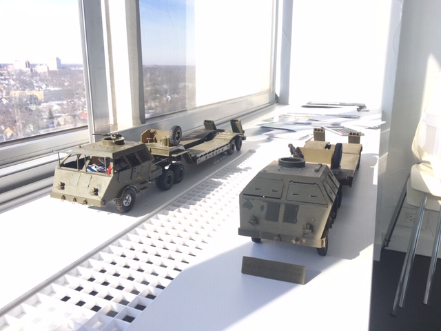

Soon I will have two fully functional Peerless Max M26 + M15 Tractor trailer scale RRC models

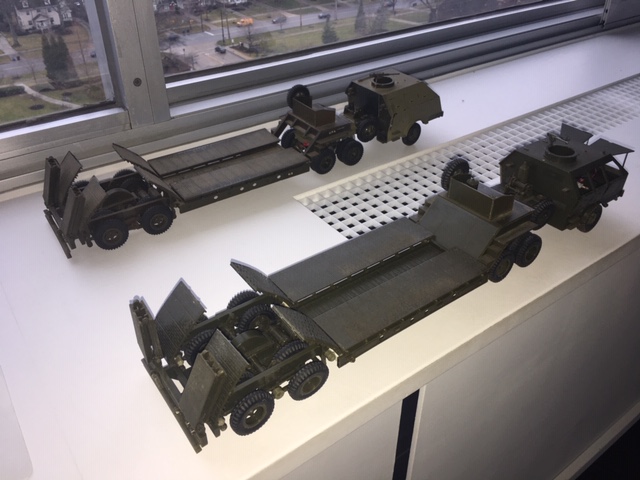

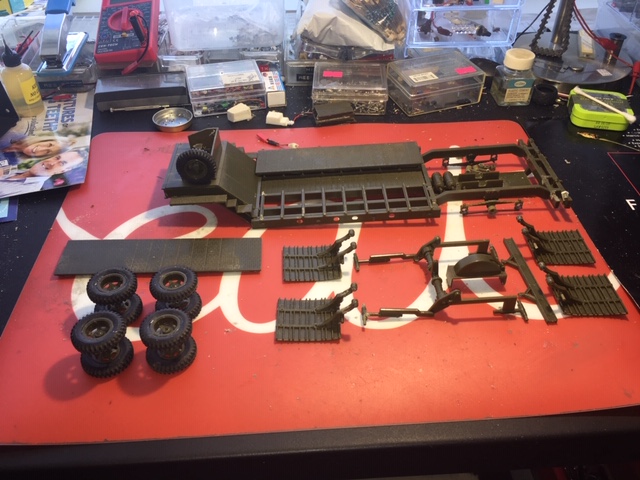

I finally got the M15 trailer rebuilt and it now has working ramps that open\close like they should.
Here is a short video of M26 Tractor#1 going up a ramp. This would be impossible if not for the 4WD rear axle.
https://youtu.be/zkKZrTxept4
This is what a all metal 4WD gearbox sounds like :)
https://youtu.be/7uwCZ-HVLAo

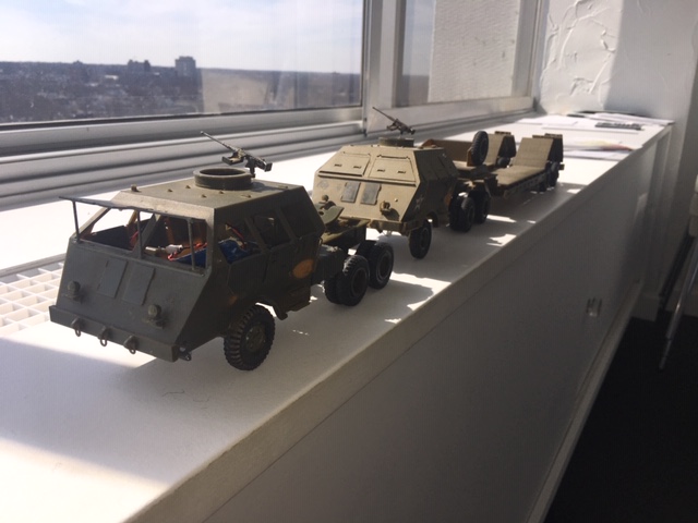

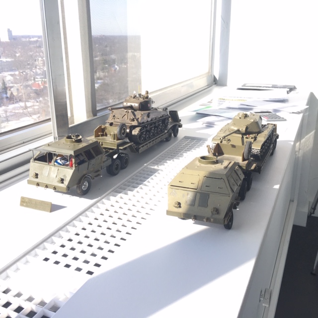

All of these are ready to run together.
Now I can haul this big Centurion around and operate it along with the M26 as they are both DSM2, actually all 4 of these models are DWM2 and all can be run at the same time sequentially
I do not have the assembly instructions for this M15 Trailer so I used the other one for reference else it would have been near impossible to redo the complex ramp system on this trailer.

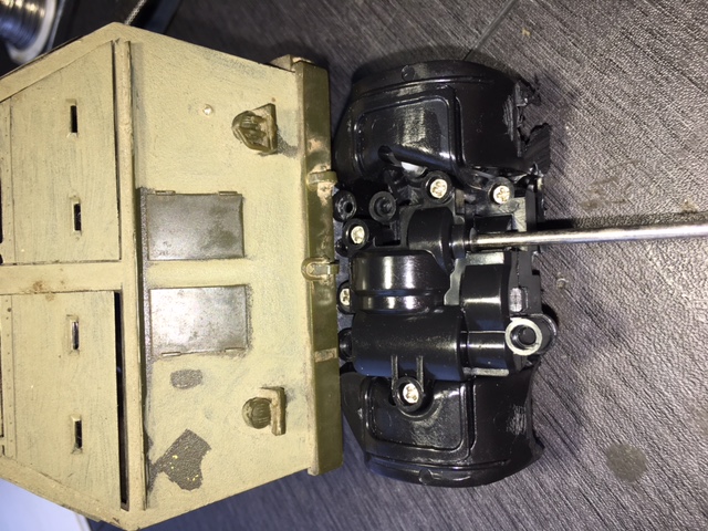

I have been thinking this model as a 6x6 using the MTM gearboxes .
download/file.php?id=83502&mode=view

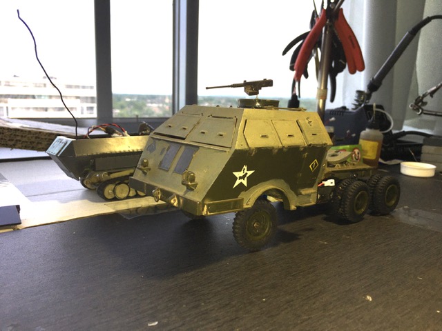

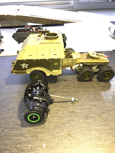

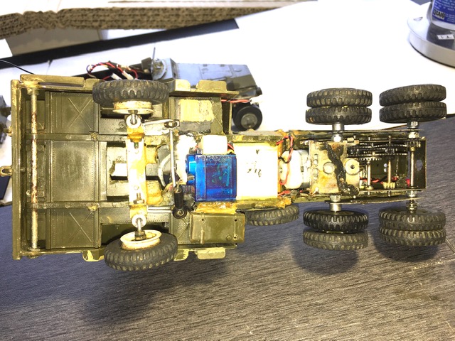

I just ran the truck that has the 4wd rear axle on my work bench test track and it failed to negotiate the track due to not being a 6x6. the front axle needs to be converted. I was looking through my spare parts and found a front wheel drive axle with steering that may go in this model for a true 6x6 1/35 scale model.
It is a difficult track at the first turn and even some tanks have difficulty getting up the hill in that turn so a wheeled non AWD vehicle has little chance of making it to the top.
Yes that is another half track. it is about 35 years old. It can run the track and climbs and steers very good. It has dual motor tracks and has track\+wheel steering.
the axle is the right width and looks like it will fit
if I add this front axle it will be 6x6
it has 4wd rear axles. The stock 2x4 gearbox was converted to 4X4 39 years ago.
Bottom view. I have owned this model for 44 years
Model M-26 failed to climb the hill so its off road capability is limited.

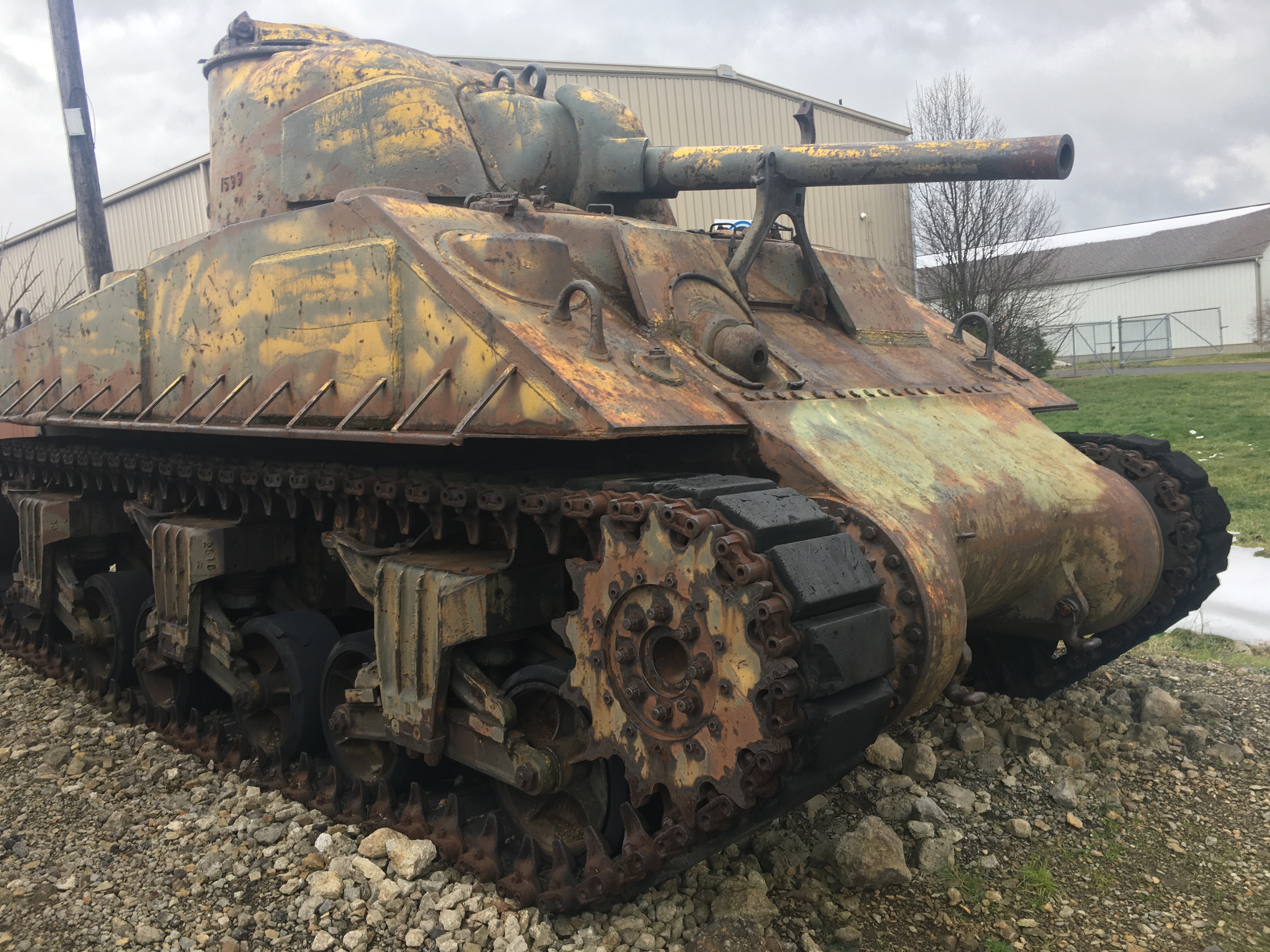

I do not know but I know where one of these machines are in a junkyard near Akron Ohio. They also have some Shermans and Stuarts.
Sherman M3A4? Sam Winers yard in Akron Ohio.
