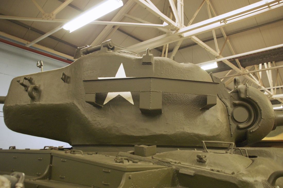

Although I am mostly retired, I seem only to have Tuesday mid-days (Modelers' Day) for tank work. At least I have gotten a bit done. I tried a bit of stippling on the front of the lower hull with Mr. Hobby Mr. Dissolved Putty thinned with Testor's Liquid Cement. Then I sprayed a base coat of Vallejo OD "Primer" over it. Since after the thick base coat, the texture seemed a bit heavy handed, I thinned the Mr. Dissolved Putty even more, again with Testor's Liquid Cement. With that mix, I started on the rear of the turret, but still thought the texture too heavy. So I again thinned the Mr. Dissolved Putty, this time with some enamel thinner. These photos show the textured and base coated lower hull and textured and unpainted turret. I think the consistency is just about where I want it, and there's is bit more to do on the glacis.
Photos are merciless, and this one actually makes the "cast iron" appear too rough. When I look at this M26 (actually so early in production as to be still designated T26) "up close and personal" the texturing is less obvious, and the "30-inch rule" (as in railroad modeling) makes it nearly disappear.

You are modeling right along there Herr Dr. When all is dried overnight you can adjust the texture with some judicious sanding. From a very light hand with 2k grit down to whatever you feel good with. Then you can always reapply texture. You're handling the inevitable trial and error adjustment period rather well sir. Kudos.
Posts: 11904
Re: [D-Day] M26 Pershing
Yip, a bit of sanding & it can be manipulated to the look you feel is right.

Your cast texture is pretty rough...or is it? Dundunduhdunnnnnn!
Especially that casting joint line! I think your Pershing looks just fine.
Mike.

Mike that turret looks like a Russian beat it into submission with the obligatory sledgehammer.
Posts: 6066
That’s rougher than I thought. The book photos make it seem a bit less so, but, yes, this one does have a touch of Russian.
