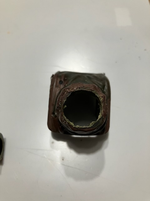

Work has started on the turret, by dismantling it.

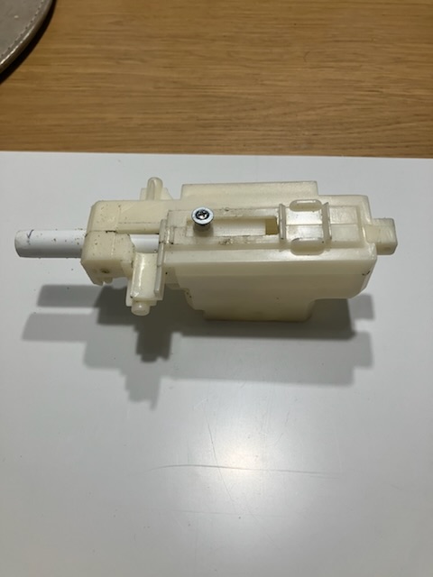

An un-used HL recoil was taken apart and modified to use a servo to operate it. As per Mr Imcq11. I have a regular sized servo for this. Because that is what Mr Imcq11 has used. A linkage will be made from the removed parts.
Next the barrel was cut off from the mantlet. I did think I may have been a two part assembly, but no matter who hard I tried it would not come apart..
The mantlet was filed out, and the whole shebang was dry assembled. This still needs to be adjusted as it is still tight. I now need to get a washer, as along with other inabilities I am incapable of making a circular opening.

Nice job. The recoil out of a bb unit has been my go to for ages.
7.1 board I assume ?

Meter rat wrote: Mon Dec 18, 2023 5:49 pm Wife has gone to the pictures, so I get a little bit of me time, before cooking a mushroom risotto for her.
:thumbup: :thumbup: :thumbup: :thumbup: :thumbup:
Excellent how to. Please continue being as detailed as possible with this mod Mr. Rat, Thnx.
HERMAN BIX wrote: Mon Dec 18, 2023 7:20 pm Nice job. The recoil out of a bb unit has been my go to for ages.
This is precisely what I needed to learn for adding servo recoil for another planned build. Thank you MeterRat for showing how to!
Yes 7.1Board. Hopefully, if the missus has got the correct one. Apparently it has arrived, as she was stuffing her face with Haribo’s the other day.

As I said. The recoil is based on what Imcq11 does. First time for me. Not to steal Mr Imcq thunder.

Santa delivered.
I now have to work out what to do with a surplus recoil unit.
