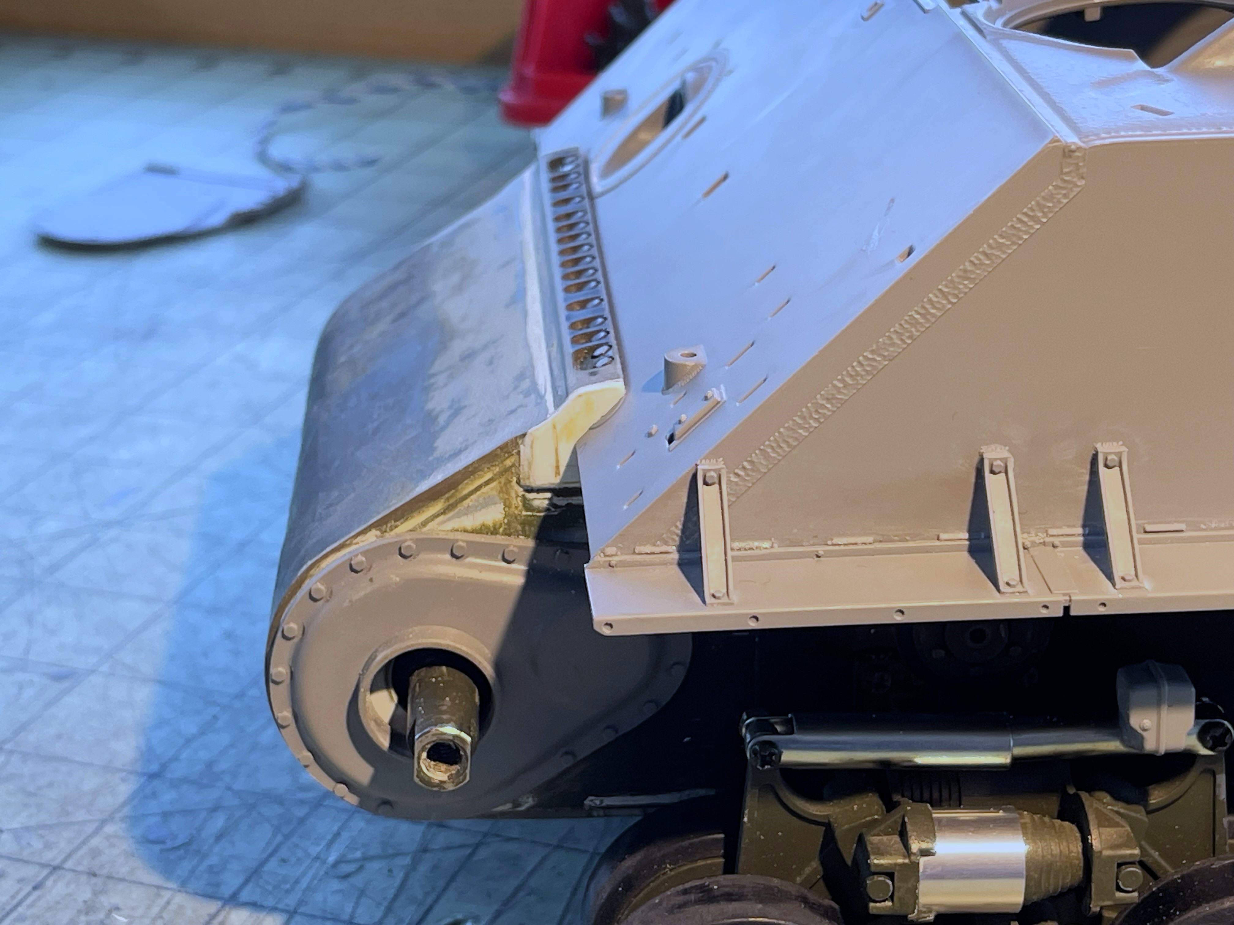

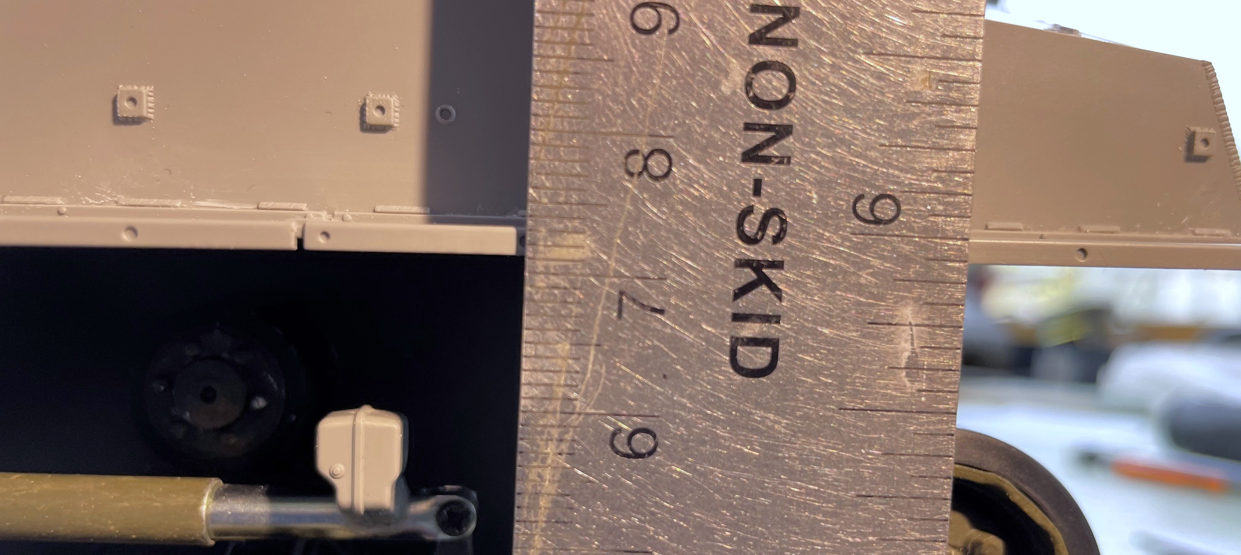

According to my calculations, the upper hull should be at 71mm from the ground to the bottom of the mud guards, all around.

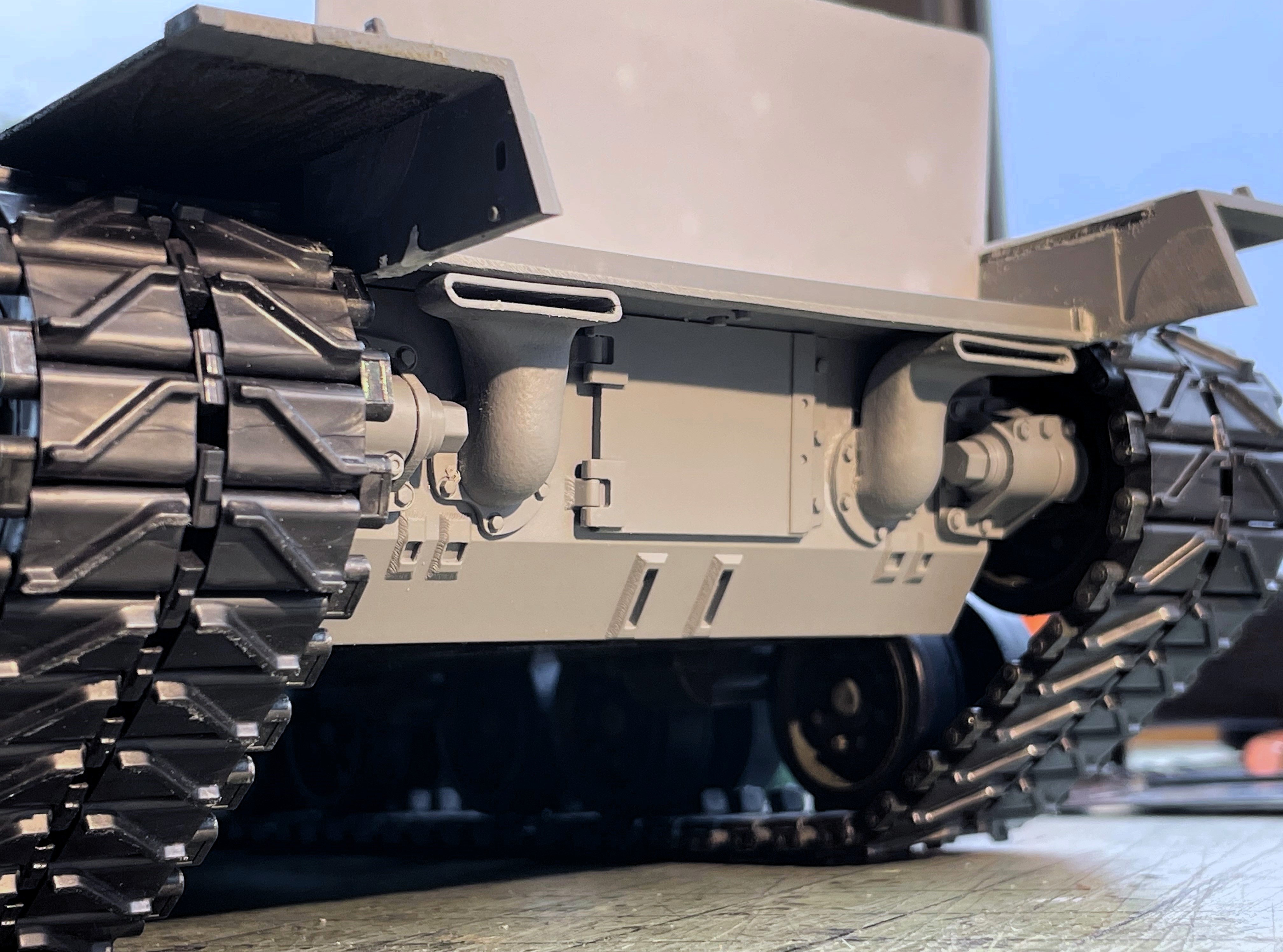

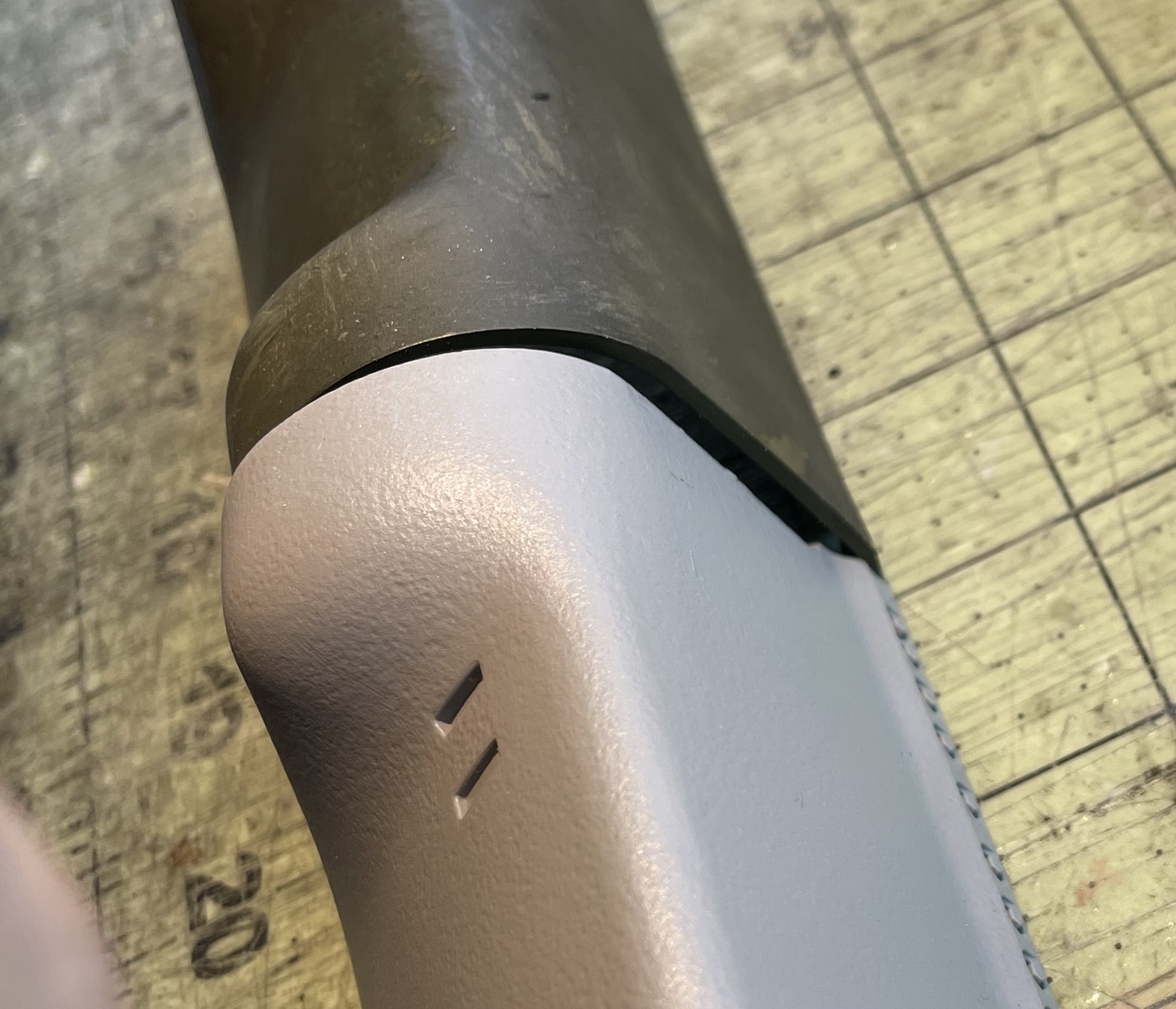

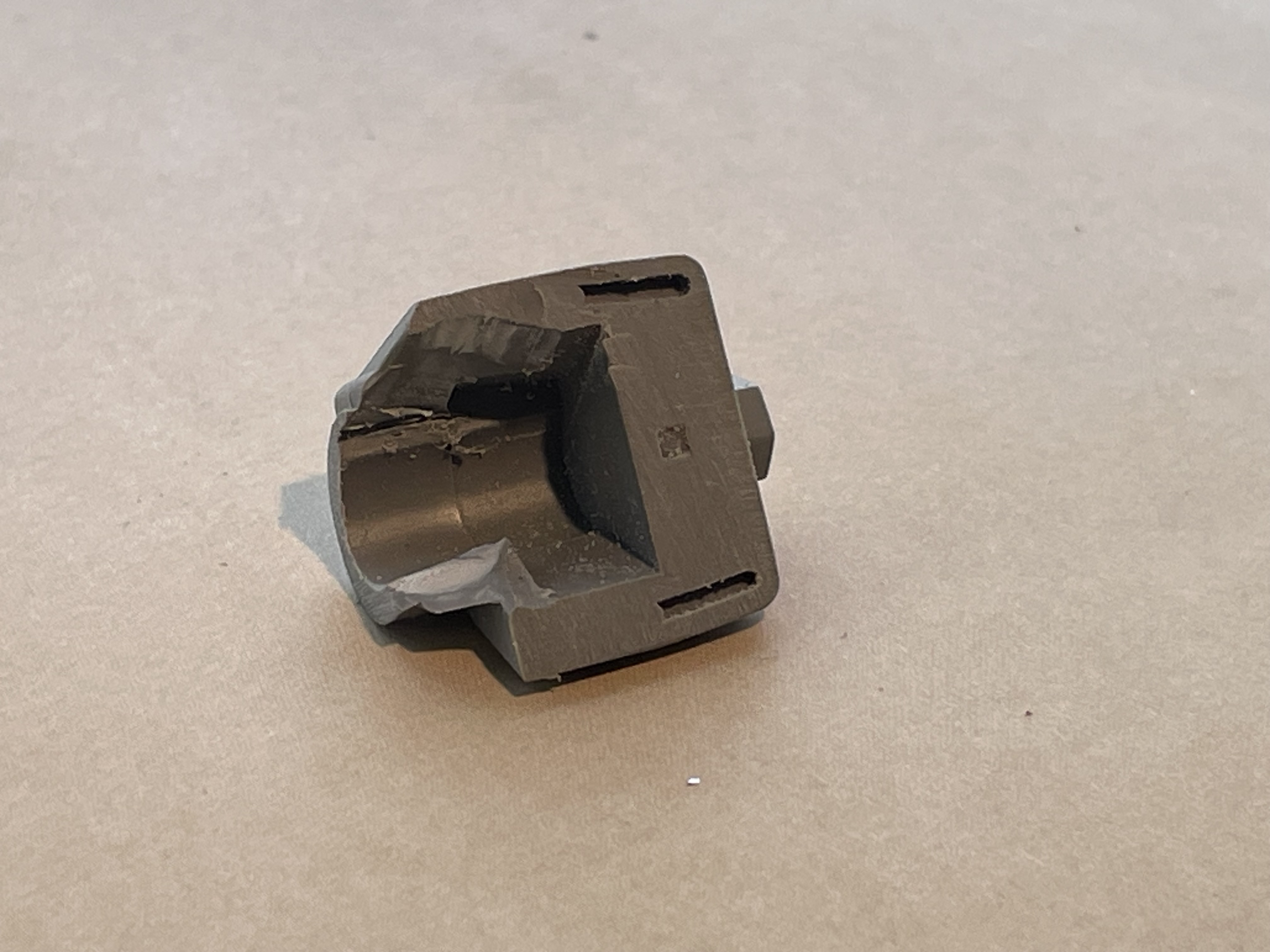

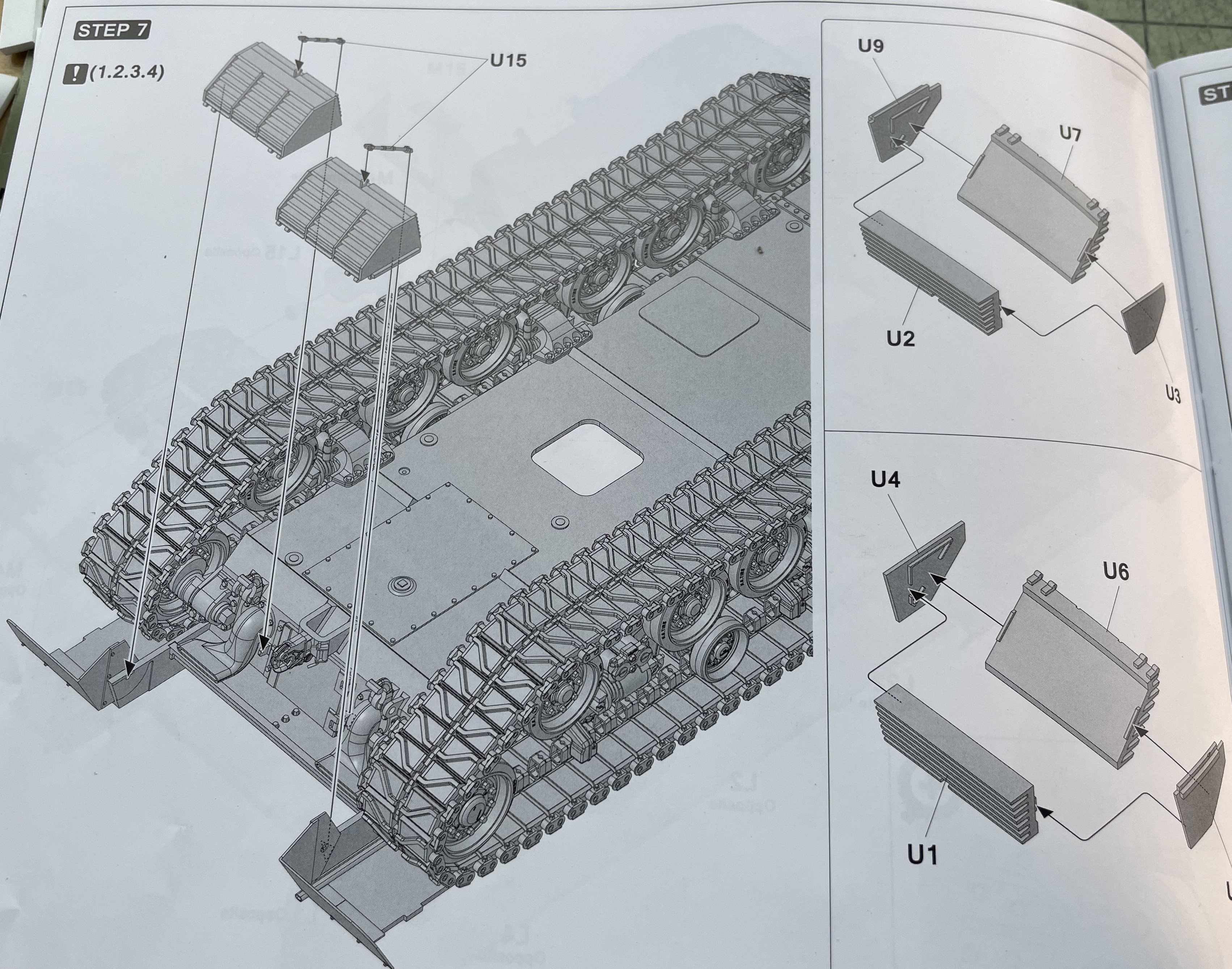

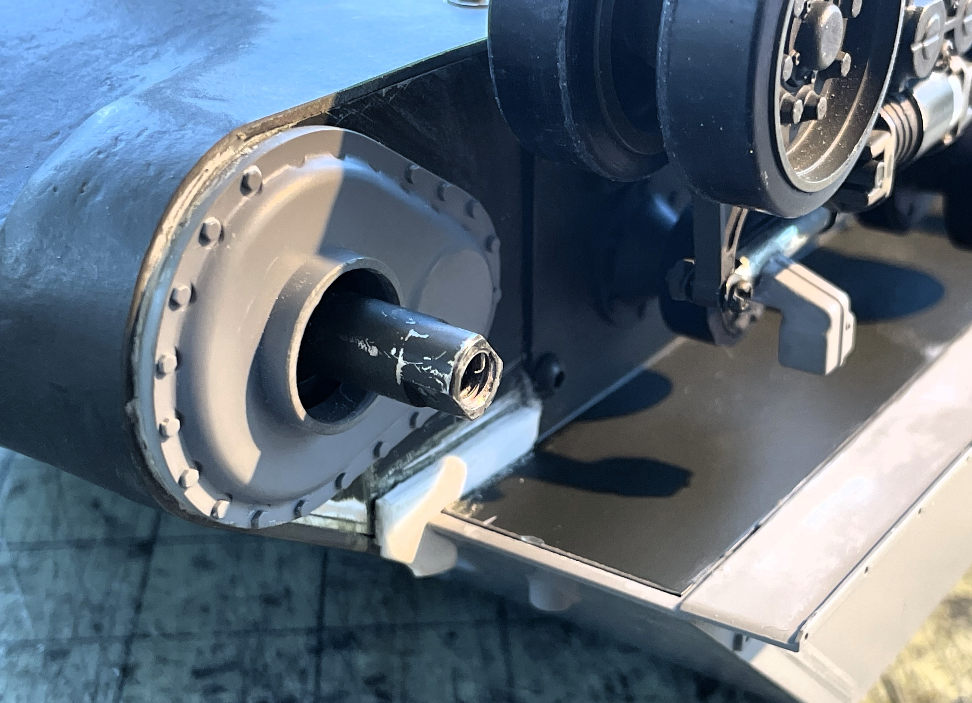

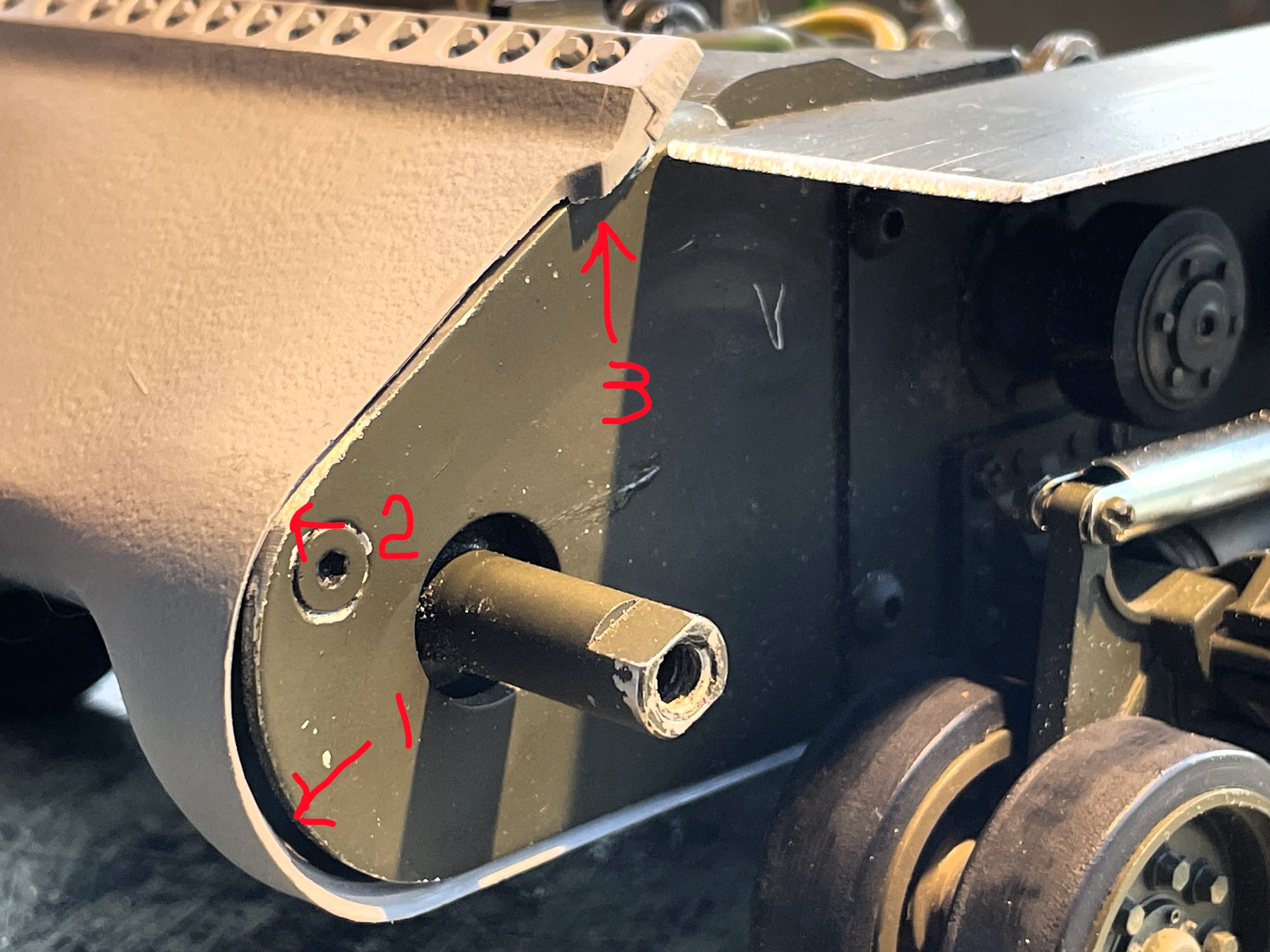

This is the Takom final drive assembly. I tried to use it but it does not fit the Tamiya chassis.
After cleaning up the interior of the Takom part, i tried everyting but it does not go all the way, the shape is too different (arrow 1 and 2) than the chassis, and the gearbox is in the way, creating upward pressure (arrow 3) and distorting the plastic part.
It is also too narrow, missing 0.5mm on both sides to match the Tamiya chassis.
Notice i had to trim the fenders support at the front to make the Takom upper hull fit.
There is no easy way to make the Takom final drive assembly fit the Tamiya chassis without major surgery on the metal and gearbox of the chassis, which is not worth it. Something has to give. I decided to reuse the Tamiya part for this build.

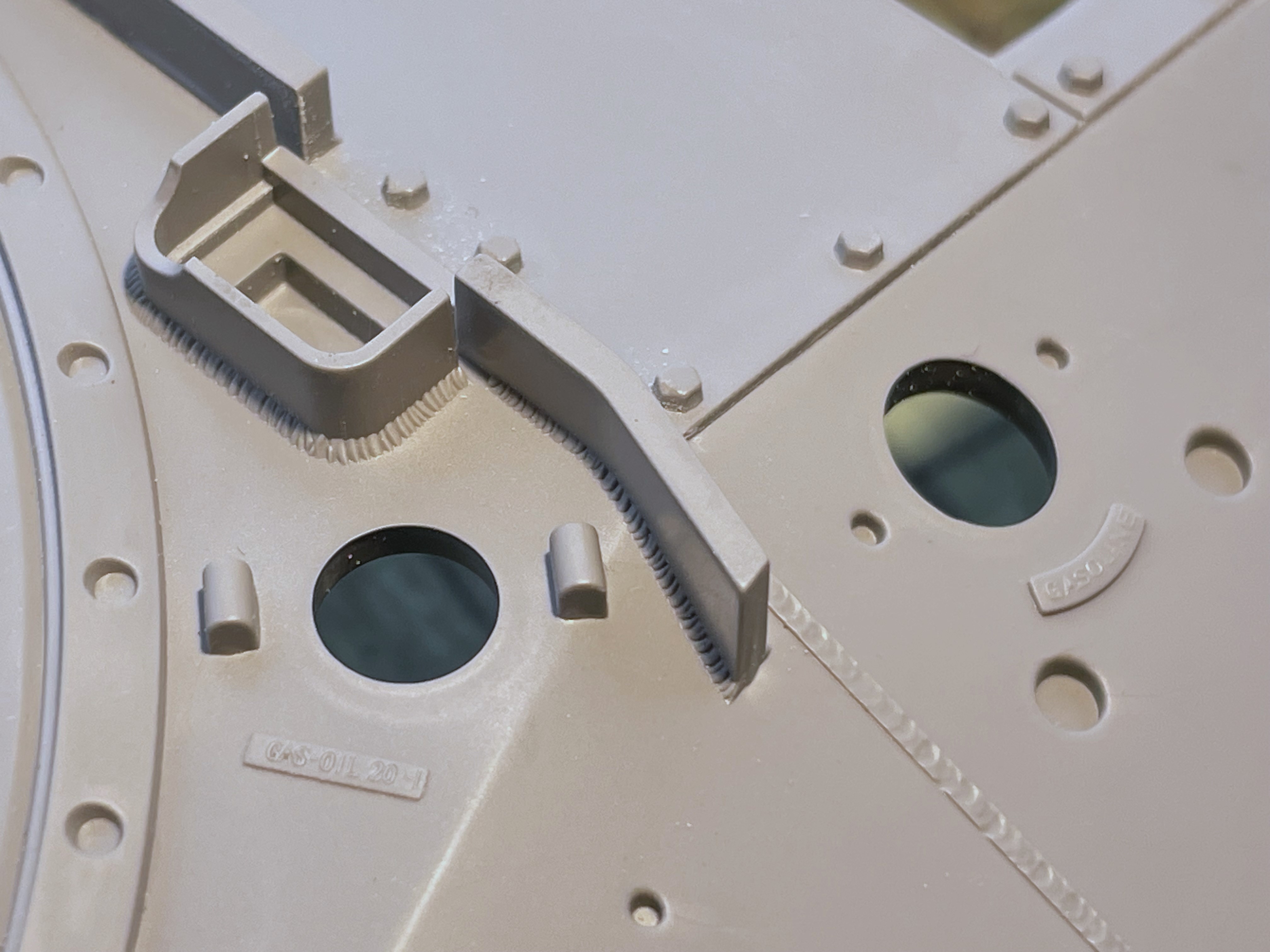

The main structural parts at the rear of the upper hull were assembled. The fit was good but not excellent, much dry fitting required and some adjustments were necessary.
Can't stop noticing how detailed the Takom Sherman is. Just look at the markings next to every maintenance cap.
The Son of Sherman book is essential for such build, if it is just to make sense of all the Sherman variants and what we are dealing with here. This book is highly recommended as it contains tons of essential info on all the areas of the Sherman variants. A new 2 book edition just came out but can't find it yet.

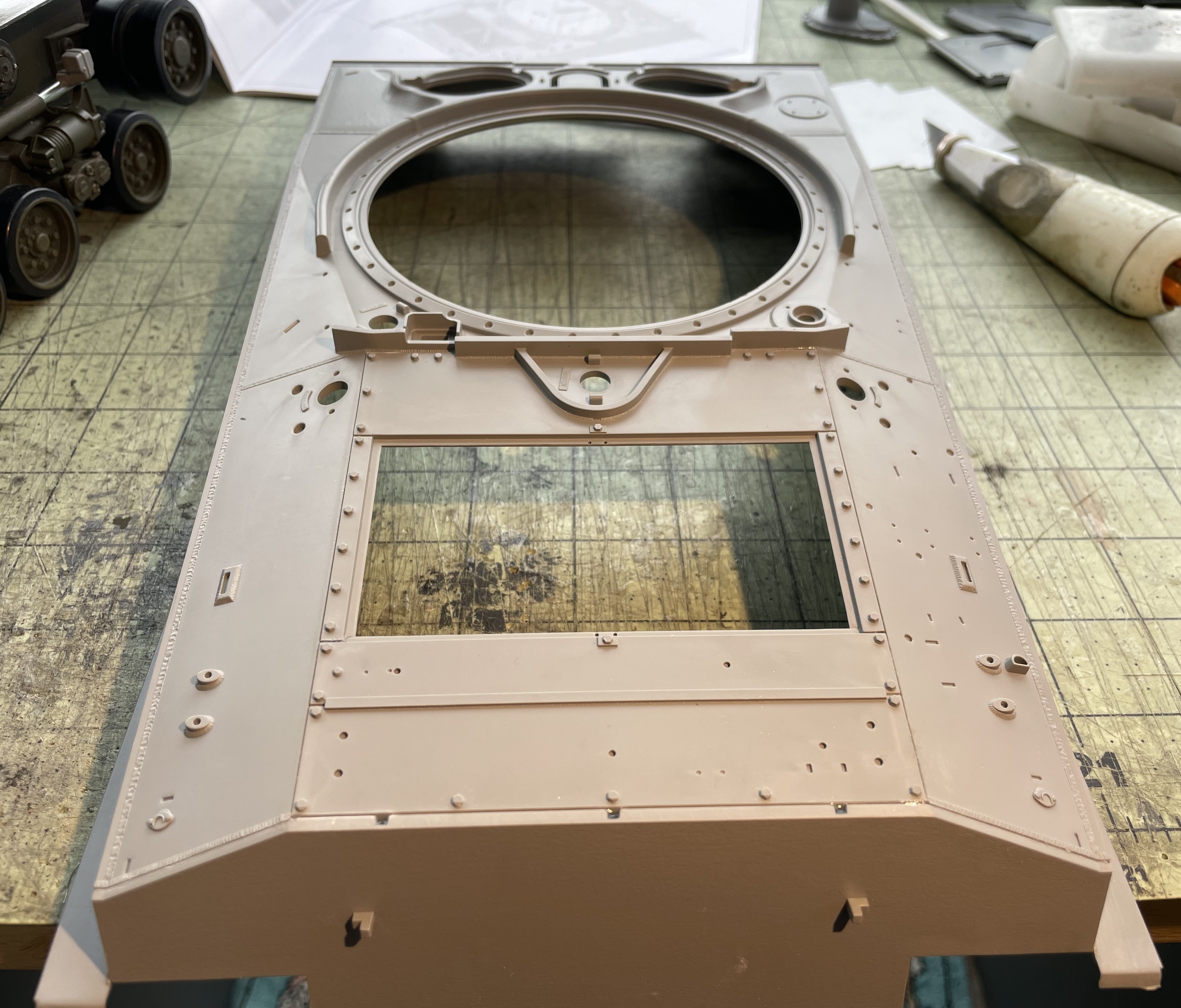

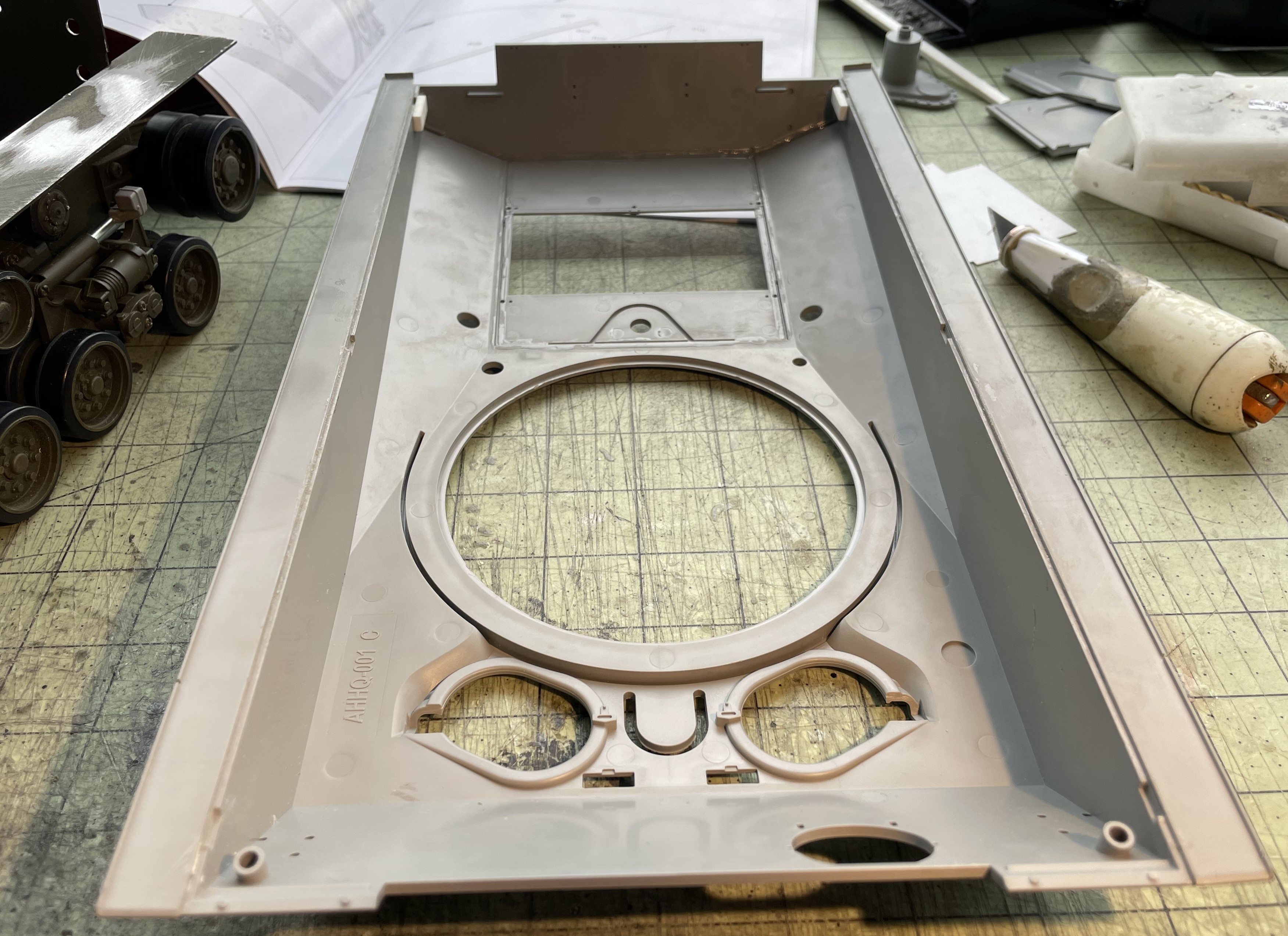

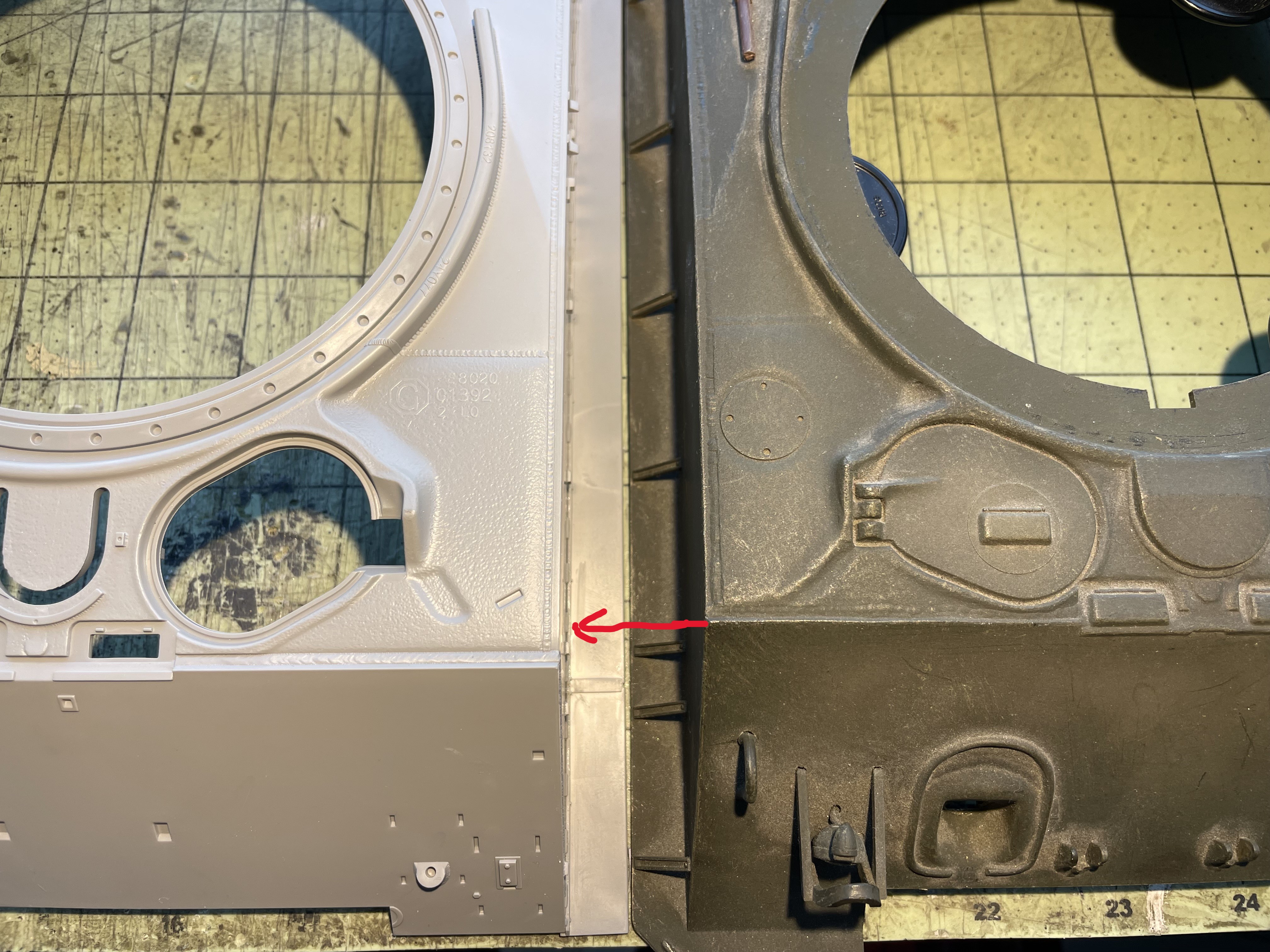

From what i can see, this is the Tamiya upper hull.
And this is the Takom upper hull for the Korean war version, everything so far on the kit seems to fit this image. Technically, both Tamiya and Takom upper hulls should be very similar except for the rear deck, or so it seems...

See how different the two chassis are in reality regarding the glacis inclinations, hull height and length, but they should be similar except the engine top.
After verifications, the Takom upper hull is the one that is accurate. We've been living with a really inaccurate Tamiya Sherman upper hull for 50 years.

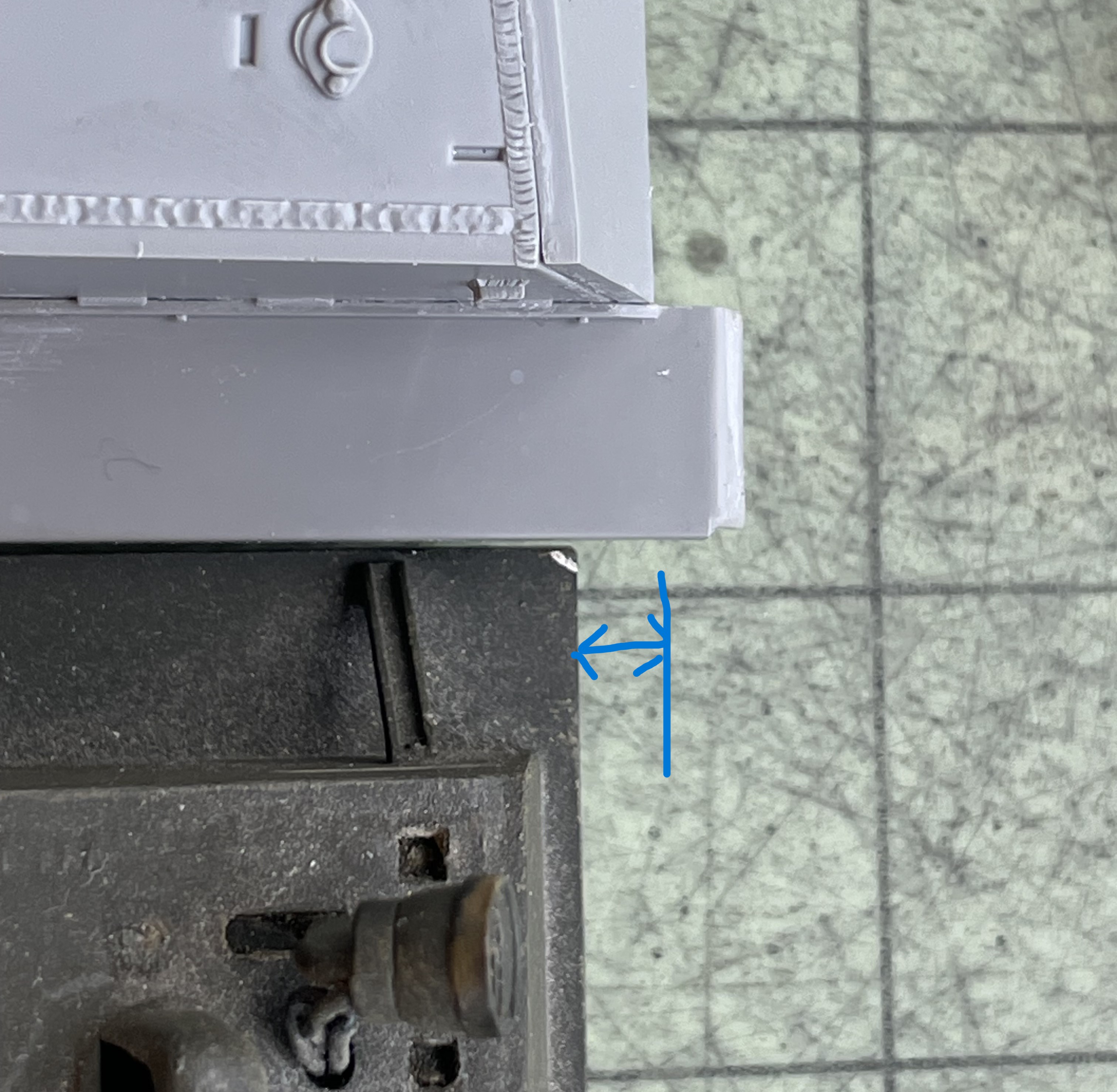

Upper hull side by side at the back, see differences in back plate angle and lenght of the hull. However, the chassis are pretty much the same lenght, i have not noticed any difference.
Upper hull height, the Tamiya is at least 2mm higher, its apparent.
Notice the inward curve on the Takom upper hull, a nasty issue on a critical part that Takom/AHHQ should look at correcting, or really bad reviews will come up. Or maybe it is a production issue not affecting all kits, who knows.

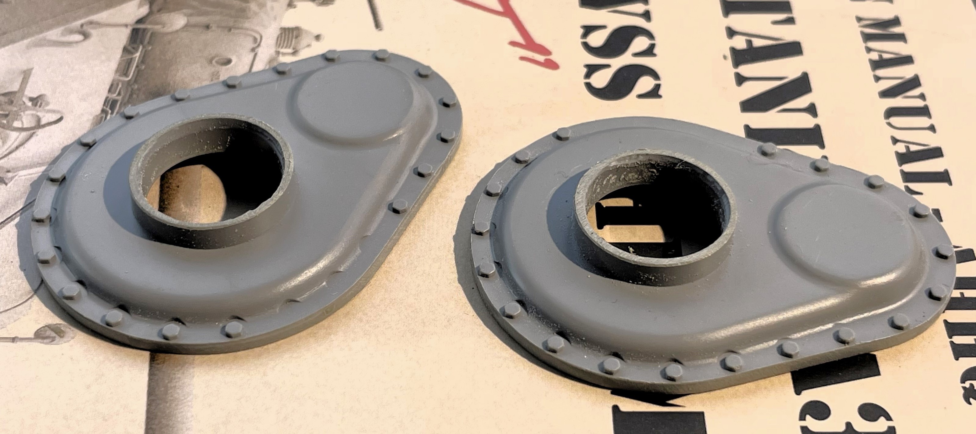

Trimmed, the Takom side transmission covers can easily be reused, and are looking good. I used to purchase these on the market, no more.

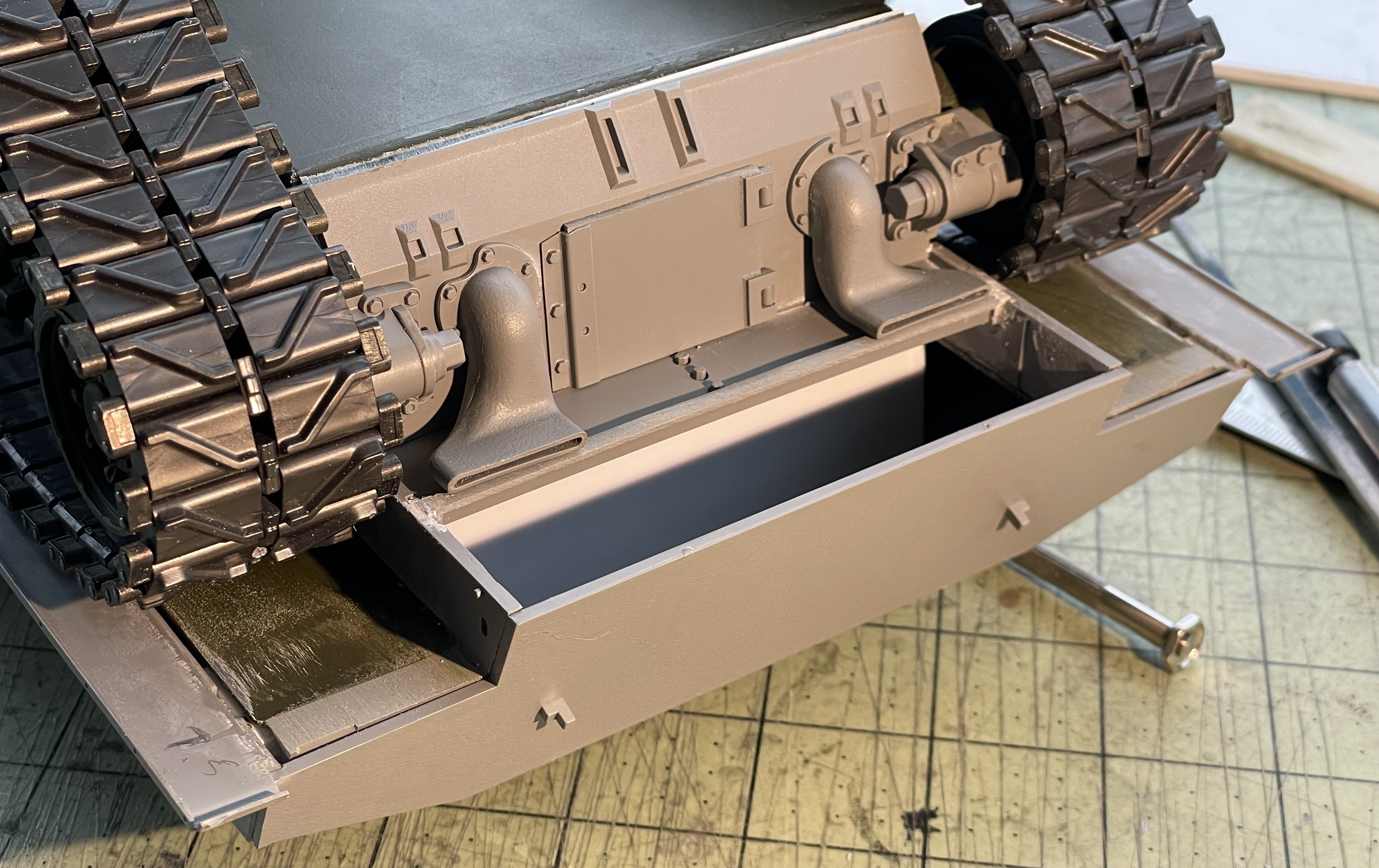

After installing the Tamiya final assembly, minus the top connecting part, the sides need to be trimmed to match the metal chassis, the transmission side covers are added, and the missing curve at the top of the unit needs to be scratch built as per reference, which will match the Takom part shape, otherwise there will be a gap with the upper hull on both sides of the middle slot.
Lots of dry fitting is required before adding the top part on the final drive assembly, i lowered it a bit, it was too high. I did not put the 2 screws at the top, they were in the way and were distorting the top, which must be flat. Instead of the screws, the final drive assembly is lightly glued in place along the metal edges. In case of heavy maintenance that would require a change of gearbox or else, it can still be removed, but i am not planning to for years to come.

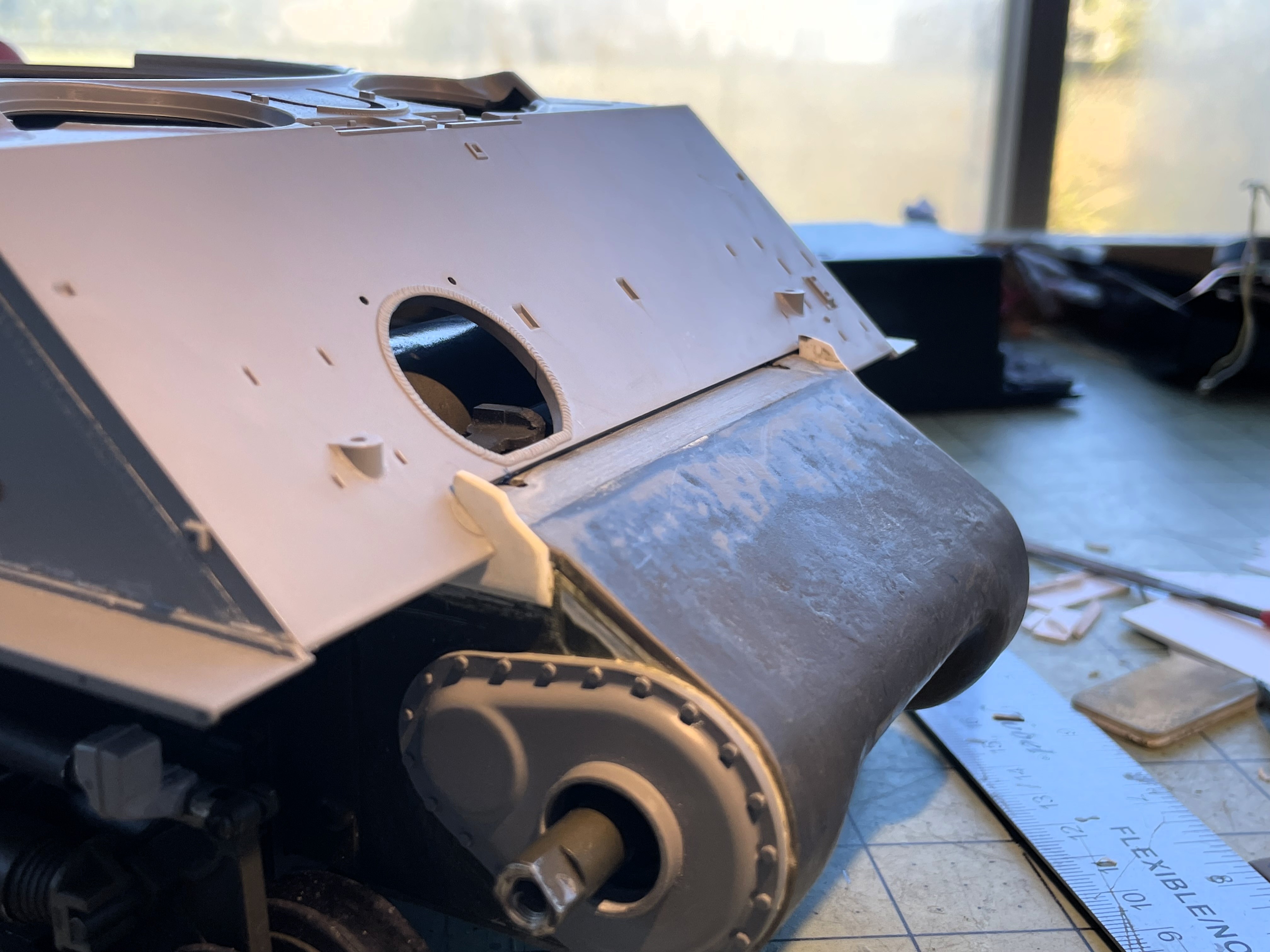

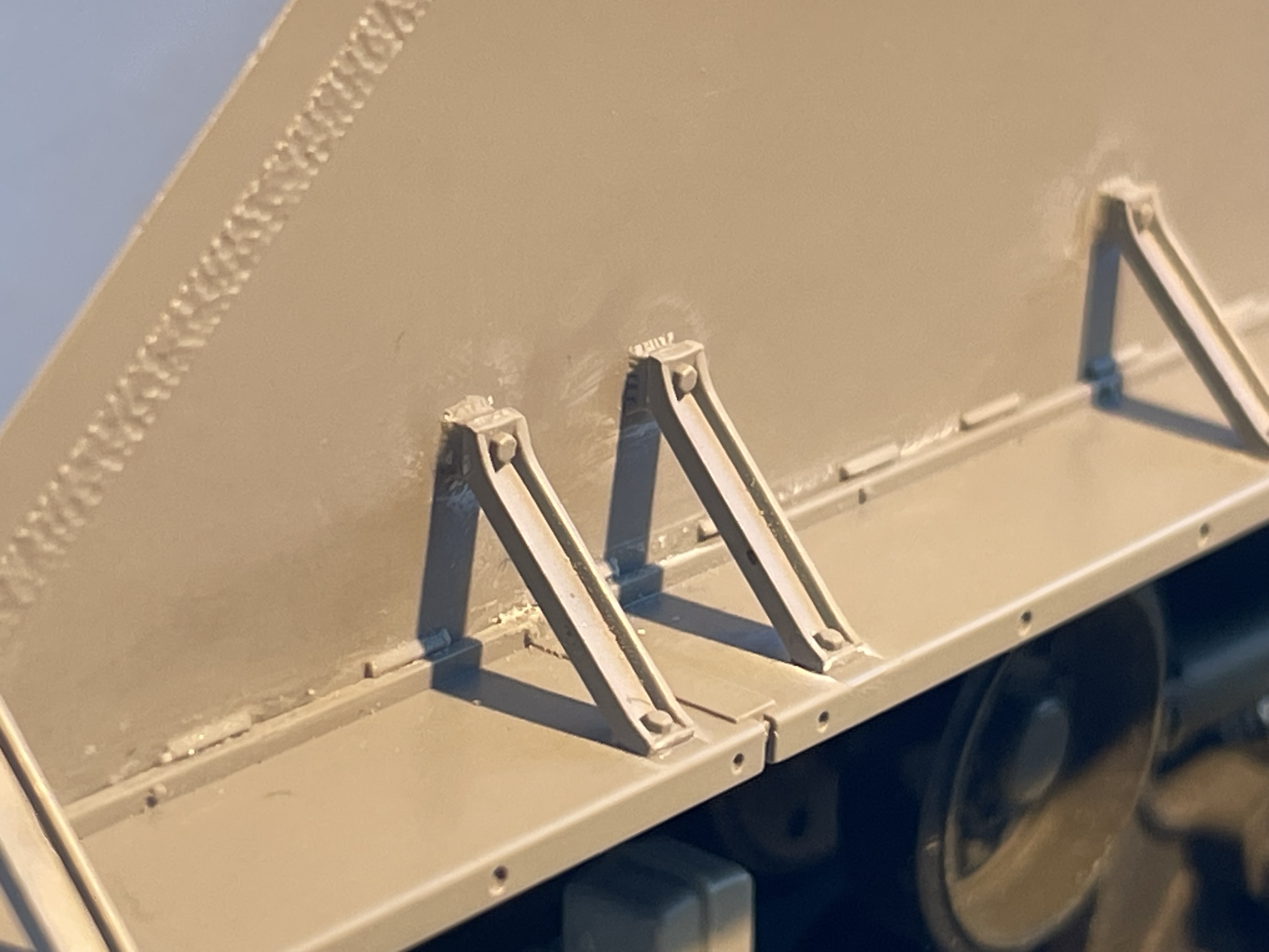

The Tamiya metal fender supports were trimmed to fit the Takom upper hull, sliding perfectly in place.

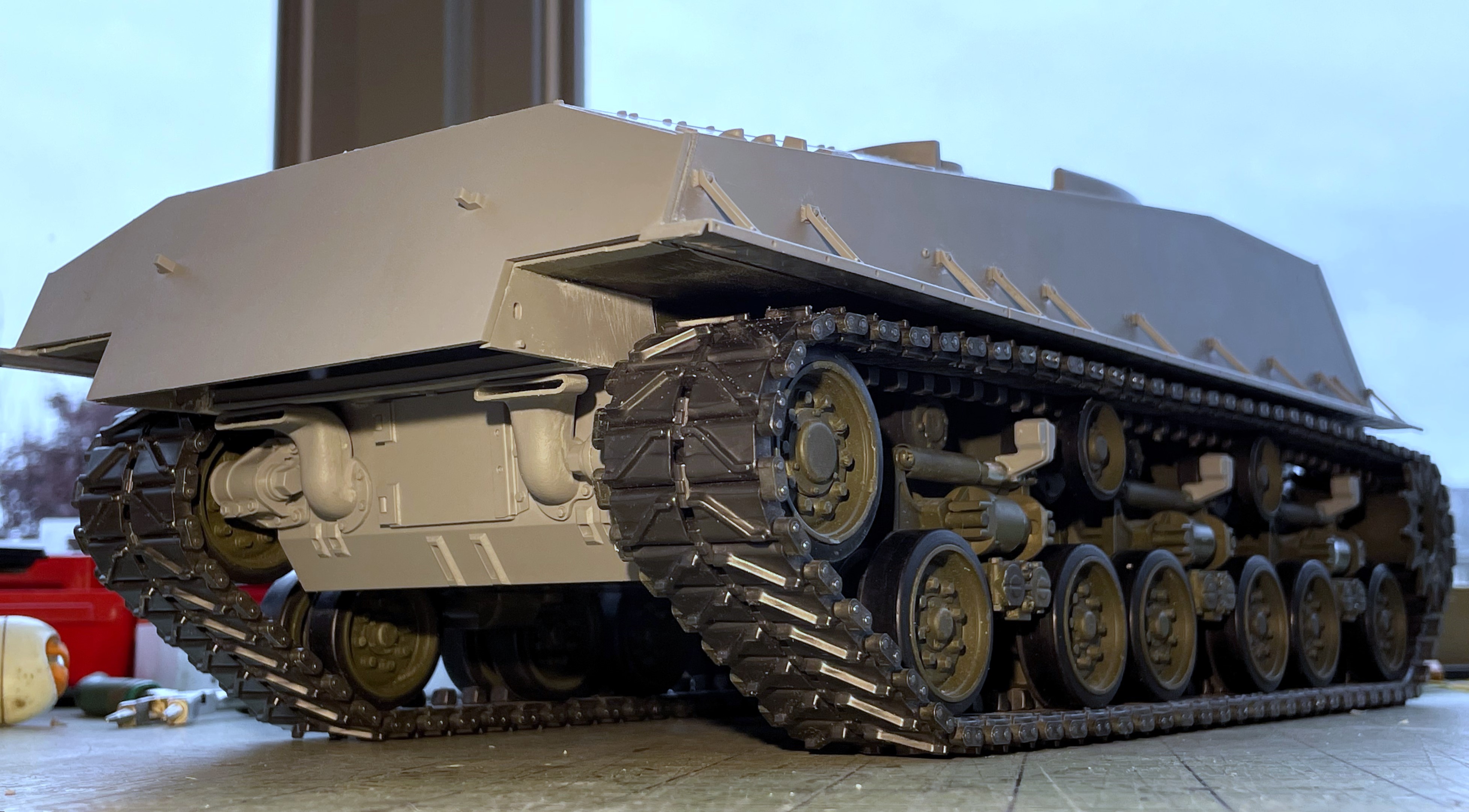

Looking at the back, it is clearer now how longer the Takom upper hull is compared to the Tamiya, there is a 7.5mm gap between the Tamiya chassis and the Takom upper hull. Not really an issue here but it shows how short the Tamiya upper hull is.
Upper hull positioned in place, looking good.
This is a critical step, the integration to the Tamiya chassis works so far and will create a much more accurate Sherman. The other big step will be the conversion of the Takom turret to RC and adding turret rotation with the upper hull, likely easier than on a Nick Aguilar resin turret, we'll see. The rest of the build will then be mostly cosmetics with some electronic gizmos here and there.

These brackets are not just for the look, they actually help keep the thin mud guards in place, and are superbly well detailed.

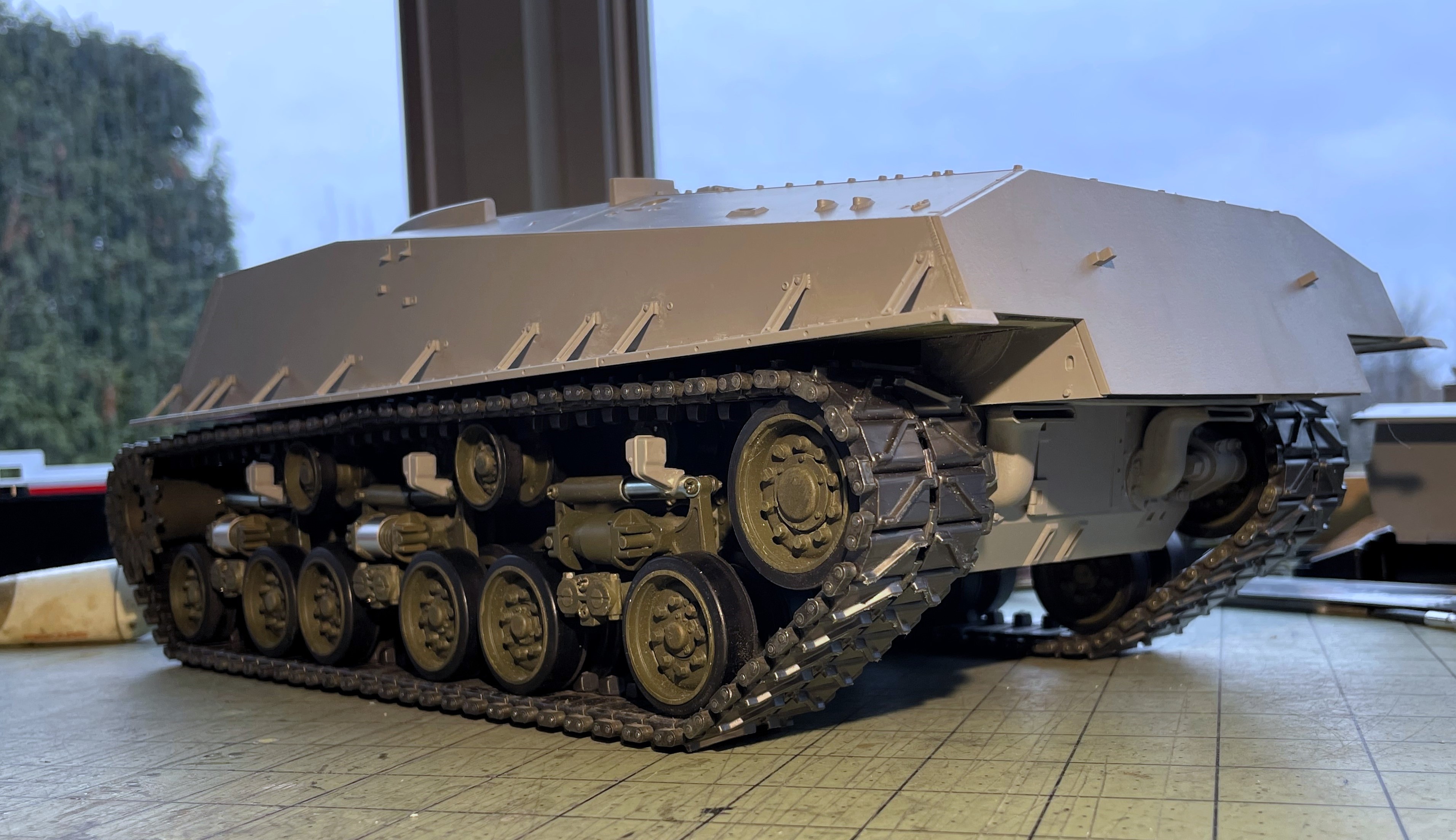

The model as it stands today.

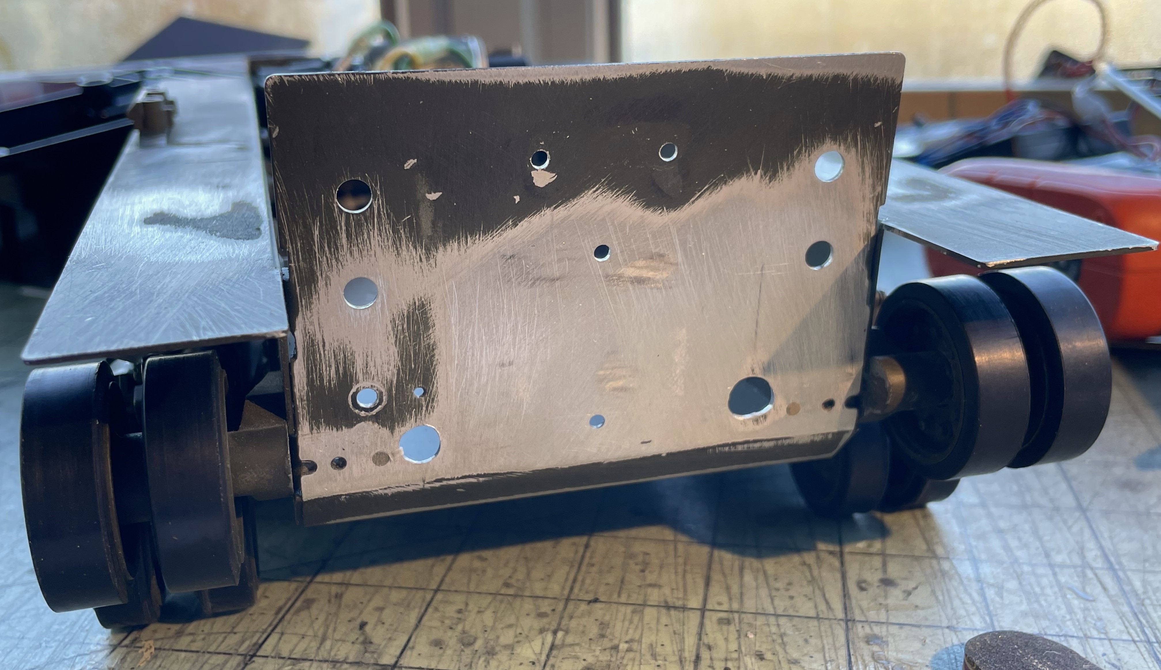

The Tamiya back plate was previously cleaned up of all features. To my surprise, when i removed the Tamiya engine hatch, the previous builder had engraved the words " F*** Y** " on the metal back plate under the hatch. I guess he must have foreseen that someone would be stripping apart his work a decade later. I never thought about leaving such message to a future generation so this was weird. I scratched it but realized afterwards that i should have left it there as part of history.
With so many holes and after i drilled two more for the exhaust pipes, i decided the back plate had had enough so i applied a 1mm plasticard layer over the whole thing to cover the mess. This affected the size of the back area but the whole build actually does the same, so no big deal.
Takom back plate is in position. Adjustments are required to fit it in place, the Tamiya lower back plate is a bit narrower and it takes some efforts with the 1mm plasticard plate mentioned above to position the Takom plate at the proper height, with the realization that the Tamiya idler adjuster arms are not at a realistic height themselves. I had to play with the side screws and holes of the idler adjusters to put them a bit higher to help me here. I would have liked to replace the Tamiya idler adjuster mechanism by a metal MATO adjusters, but as indicated above, the idler adjusters on late model Shermans are different that previous versions.
The inside of the Takom idler adjusters are hollowed, but needed some trimming so that they can be overlayed on top of the Tamiya idler arms.
The plastic section of the idler adjusters are in position, and looking good, hiding the Tamiya idler arms very well. Just make sure to install the tracks and adjust them before so that you are sure there is enough space in between the plastic and metal arms to adjust the tracks.

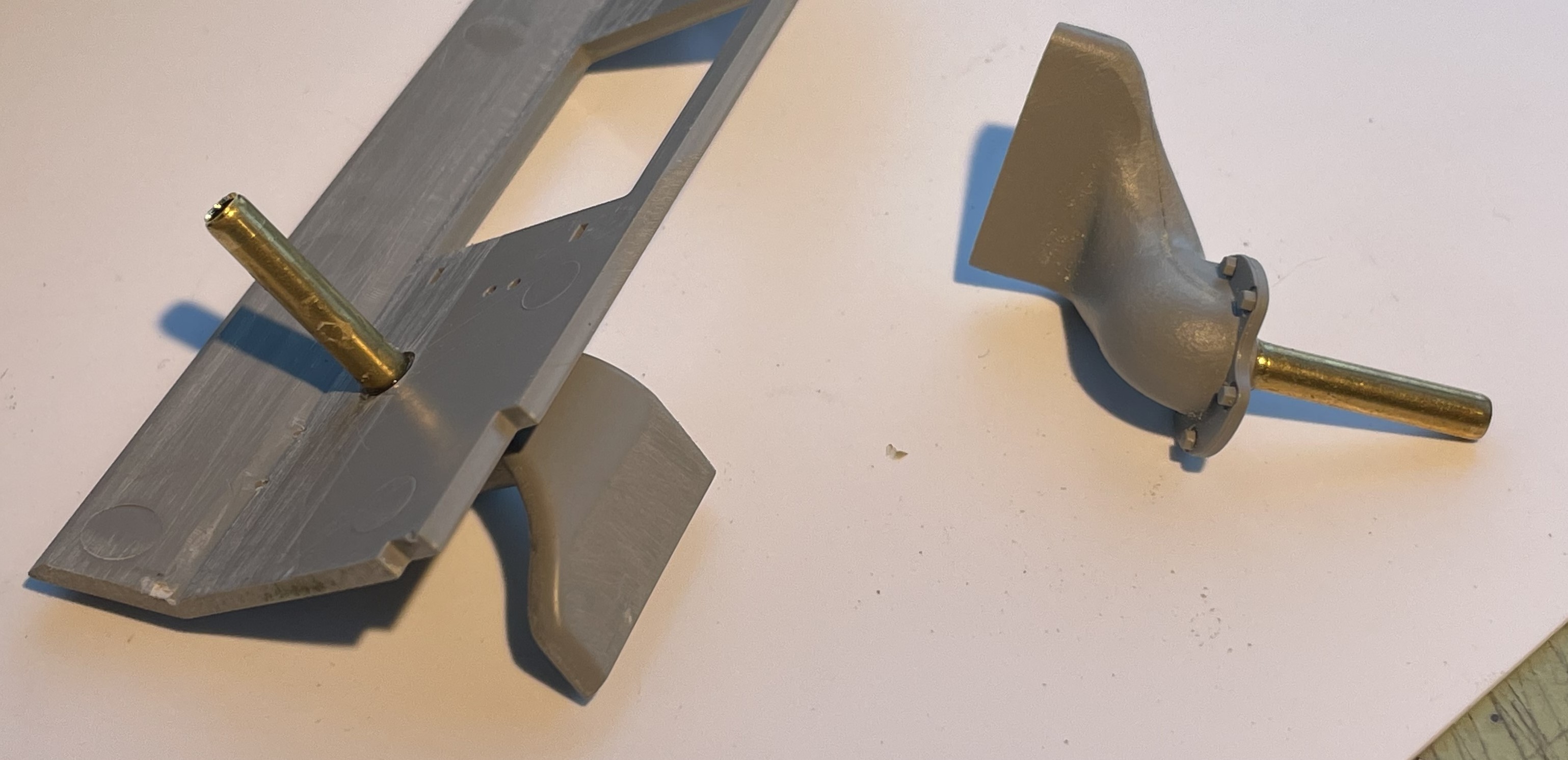

To complete the structure of the exhaust area and fill the gaps created by the use of the Tamiya chassis, i decided to transpose the required Takom rear section on both sides to the model, including the horizontal plate not shown here.
I found that there is a lot of fishy stuff going on with the Takom parts (ie how do you open the hatch with that large bolt head in front of it... and the horizontal plate barely clears the exhaust) but i managed to cut, trim and put them on the Tamiya chassis, including the extension to the fender supports to close the gap shown yesterday. It not an area that attracks a lot of attention anyway and most of it will be hidden by the exhaust diffuserd. No issue.
Again, small parts will be added later.
I added reinforcements for the fender suppport extensions using scrap plasticard. Its above and inside, it won't show.
Remaining is the hole where the exhaust diffusers are located.
The Takom/AHHQ instructions are again extremely unclear. There is actually an important choice to be made here by the builder between WW2 and post war exhaust diffuser type, with not a single word of explanation about anything. This is unacceptable.
I figured the top one must be the one used in the Korean war, because i saw the other one used during WW2...
And it is also very unclear how to attach the exhaust diffusers to the chassis. In any cases, it looks like a very weak attachment method. I will think of something better, while keeping the upper hull removable. I better save this for later as i need to detail the back plate first, and then not risk having the diffuser in the way or falling apart during the build.
In order for the smoke to be properly diffused... i will have to remove the solid back plate of the diffusers to allow the smoke to go through the blades, not a big problem. I will deal with the diffusers later.
