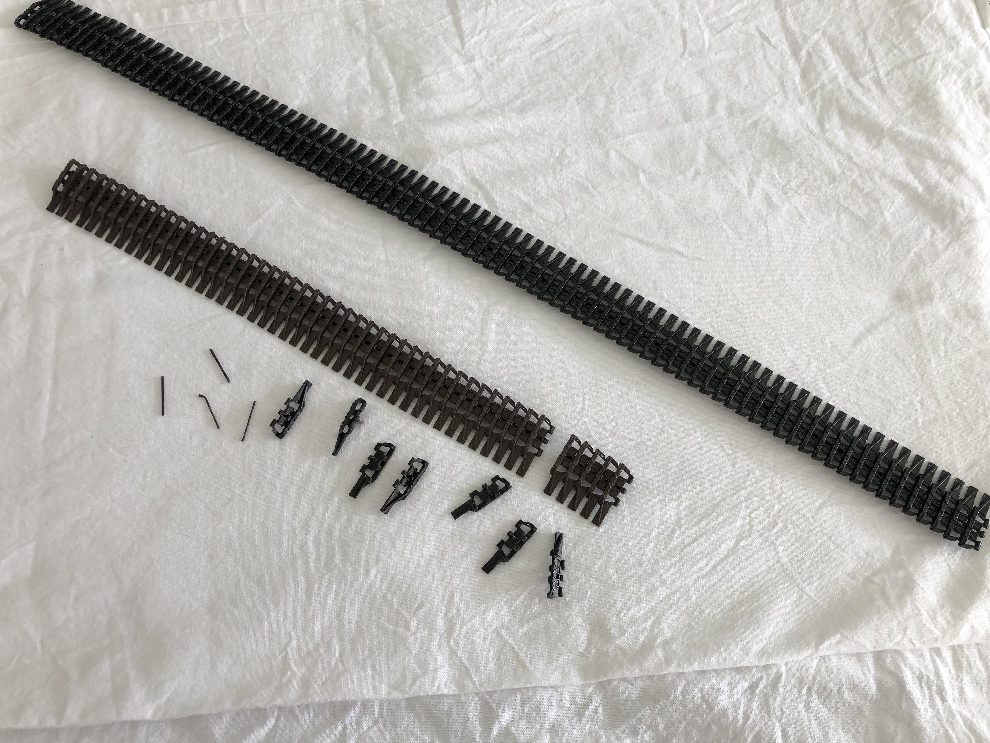

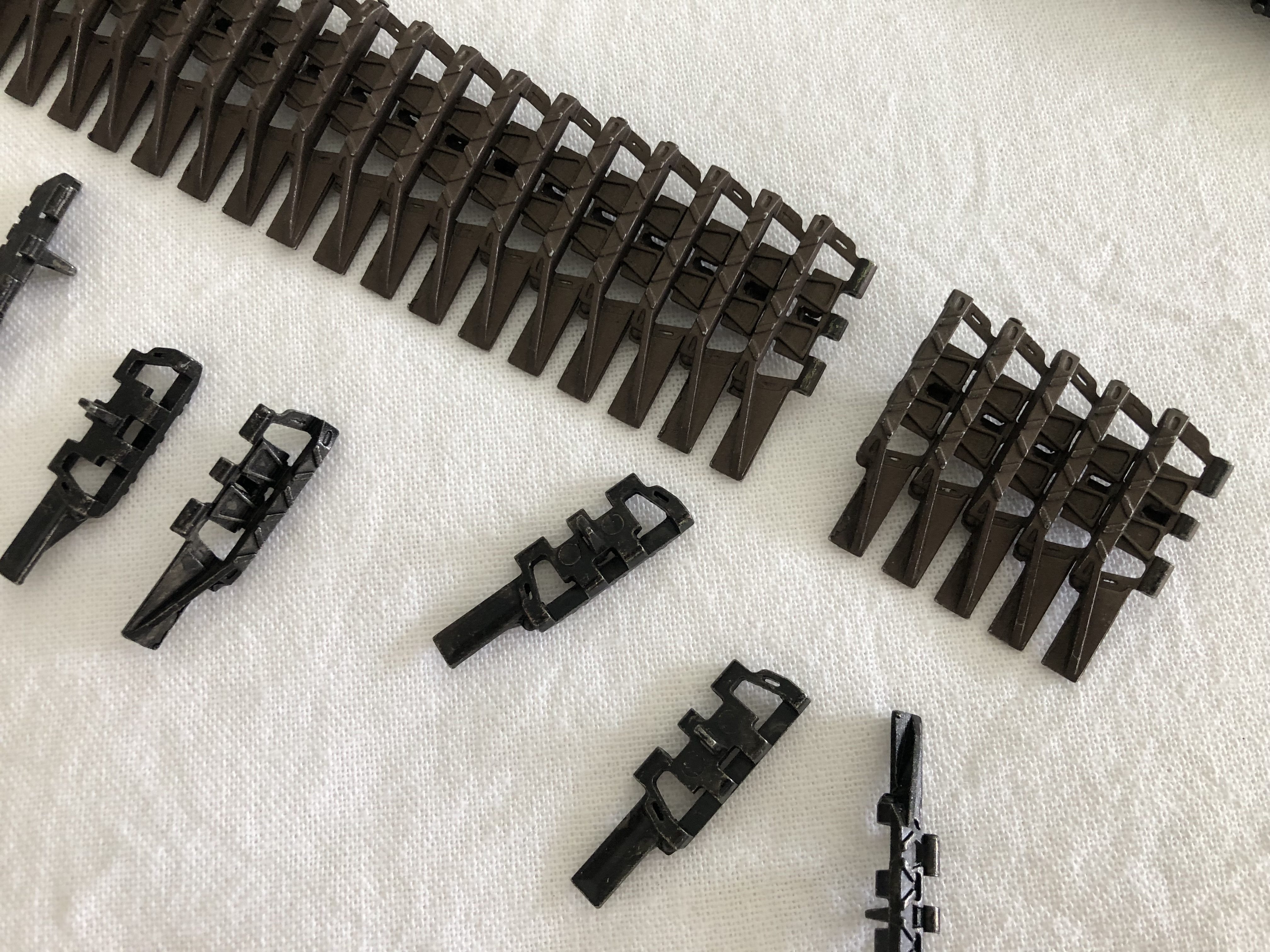

Estnische wrote: ↑Thu Nov 02, 2023 9:27 amYes please!HERMAN BIX wrote: ↑Thu Nov 02, 2023 9:25 am I have a boat load of spare Winterketten track if you need any for spares or stowage mate. Free as you like.
Let me know if you want any & how many of each hand.
