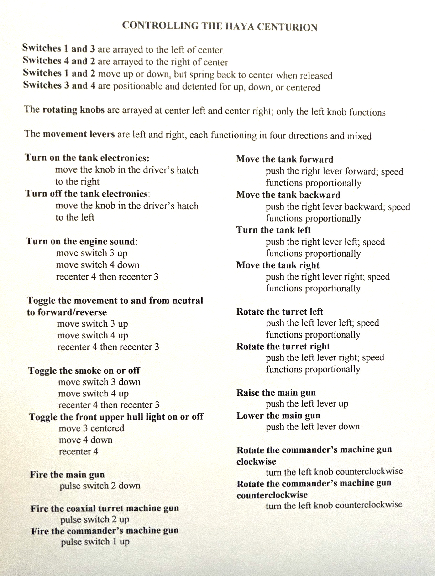

So I created some instructions arranged by function. If anyone who has a Haya Centurion would be willing, I would be grateful if you might check my instructions to verify that they are correct, and in the responses here identify anything I have messed up (
Calling all Haya Centurion Owners!
- Herr Dr. Professor
- Posts: 6101
I have been impressed by the Haya Centurion, and the instructions are better than any I have read so far for a mass-produced RC tank. However, the directions for running the tank with its Clark board are arranged by the switches, knobs, and levers (e.g. 'switch 3 forward and pull switch 4'). This is a bit tricky to follow.
Note, for example, that in https://youtu.be/jXuduHnVK7E , Mr. Tank a Lot gives up and says he will "come back with another video" about how to run the Centurion.
Maybe the instructions would be easier to follow if they were arranged by function (e.g. main gun or start engine soud). That way you can look up the function and then see how to do it.
) and offer suggestions for improvements. Here are the instructions for operating the Haya Centurion as I have revised them:
Re: Calling all Haya Centurion Owners!
Looks like Haya sells it with a different Flysky radio than what most of us use for a Clark board which is why that document confused the hell out of me. I personally would use it with a Flysky FS-i6S radio as it seems easier to use as far as activating functions.
