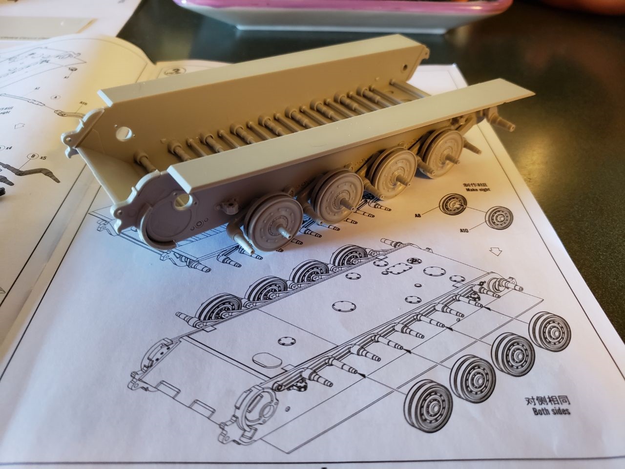

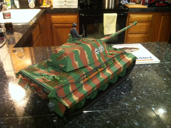

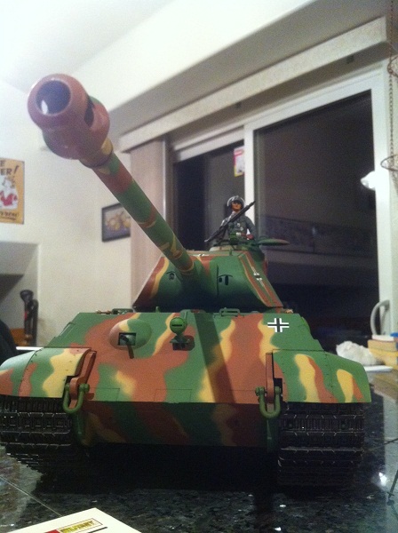

I have already made a start on this Build by sourcing a metal Taigen \Torro Lower Hull with running Gear and a 1/35 Scale Hobby Boss Porsche King Tiger to build and serve as a Paint\Details and Zimmerit mule. I know that we are supposed to keep the 'Going Crazy with Parts' to a minimum but since I am replacing the Lower, I anticipate having to swap electronics as well after over a Decade since this HL Tank came out. Here are some pics of the Hobby Boss Model being built and the Subject in all it's 'unique' HL original paint scheme.

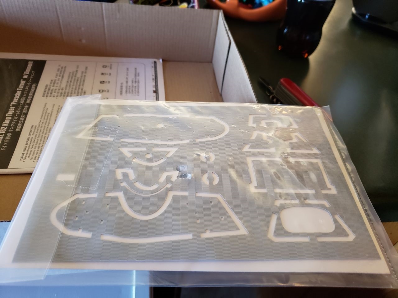

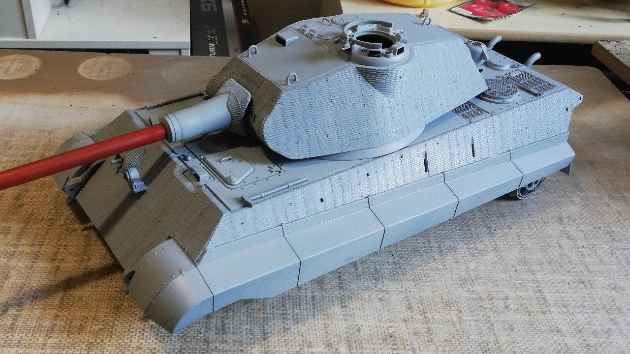

Nice. Atak Zimmerit is great, higly recommended. Fits nicely with minimum putty needed. My early Tiger II during build:
- IMG_20230424_190901_copy_1280x720.jpg (256.5 KiB) Viewed 31063 times
- IMG_20230424_190932_copy_1280x721.jpg (218.21 KiB) Viewed 31063 times

Thank you for the pics, Kaczor! That is exactly the type of effect I am hoping for. Another good reason for the 1/35 Paint Mule KT. I have _ never_ applied Zimmerit before on any of my Builds. Time to learn a skill and apply it.

Ahh Zimmerit , it’s all about the glue.
Sand the back of the patches to key it and get the glue all over the entire area you are placing the patch on.
Or you get edges peeling.
Also, do and damage to it before placing it on the glue, it’s a lot easier
