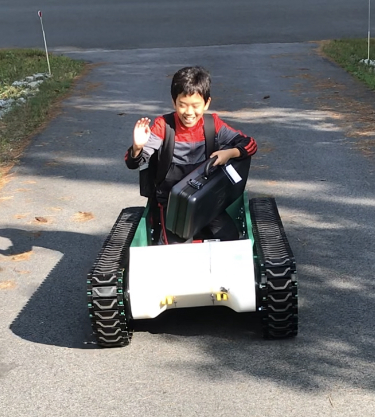

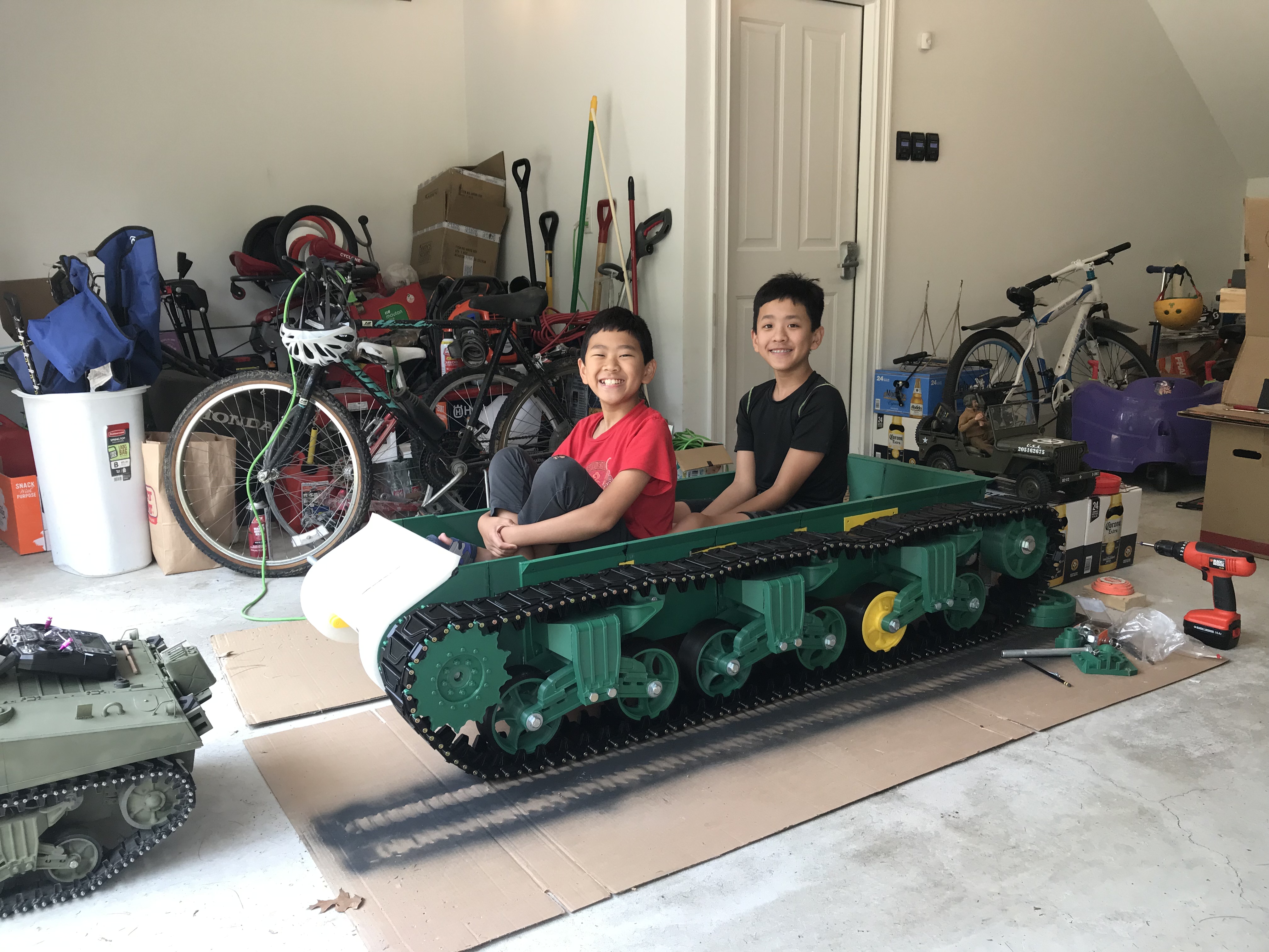

Here are few pictures of my son and I test drove the Sherman tank … hahaha
A video is much more fun than pictures. Anyone kind enough to show me how to upload a video?
- My son test drive his Sherman tank using the RC system
- B0543C66-0EFF-4707-88F4-70126C011EB4.jpeg (450.19 KiB) Viewed 5519 times
- Pick my boy up with his Sherman tank after school. He was so surprised and happy.
- 57E016EC-28F4-46BF-B7FA-33291FA093D7.jpeg (519.99 KiB) Viewed 5519 times
- Me test drive it on a single track
- DF7CCE6A-8F6D-41A1-9388-98F20933B233.jpeg (193.08 KiB) Viewed 5519 times
