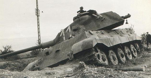

Nice! I made the same modifications of all periscopes. Probably you know other photos of "Eleven".
af90c310_jpg - Click to see more photos on ServImg.png (221.2 KiB) Viewed 5142 times

Post by John Glover »
That last photo is fantastic. Shows the early type armored exhaust covers which have a rib down the center ,these were replaced with a beefed up version on the left hand side which became standard production[Axles sell both types]Tiger 1 type exhaust shields, exhaust pipes made out of different angles of pipe and even the little bars welded inside the end of the pipes are horizontal and not vertical like in the curved production exhaust units that became standard .I will fix this on my tank I am building. This is so helpful. Thanks mate. regards John.
