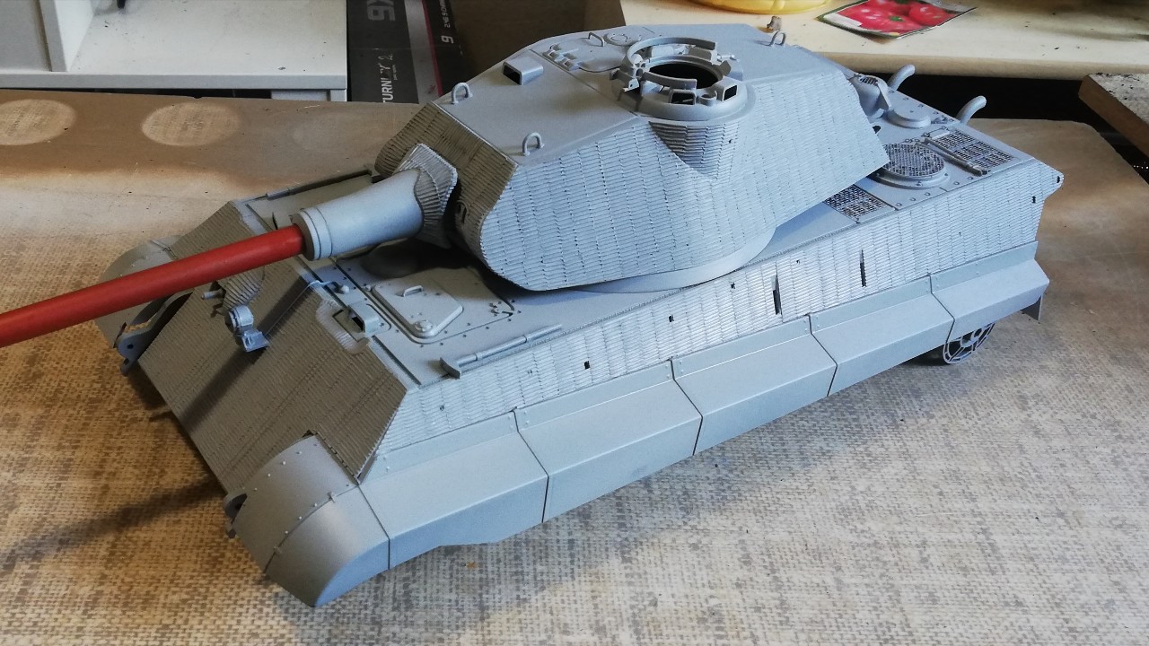

First I try to remove the tooth: the ATAK Kit for the zimmerit includes some pieces of the armor to be completely replaced, as well as the sheets to glue on the plastic of the tank.
The two most important pieces are the turret front armor, and the turret tailgate. Both have a nice texture, with the zimmerit already printed.
To fit the new turret frontal armor, turret disassembly is required. The front armor is held in place with screws. Just unscrew those, slide the barrel off, insert it into the new shell and screw it all back on.
The new tower front, placed:
The new tailgate, and the standard one, side by side:
I pry with a cutter, to detach the old hatch from the turret:
The piece is in fact held in place with 3 pins, and just a little glue applied at the factory.
If during the process these pieces should unfortunately break off, it doesn't matter.
The important thing is that those of the new piece are intact!
However that didn't happen, so I have an extra spare part, just in case!
After sanding the 3 pins of the new tailgate a bit, the piece fits perfectly:
A general view of what the tank looks like so far, from the front:
From the back:
You will surely have noticed that I had already done some work some time ago, such as some small details and the removal of the side fenders, as well as the reconstruction of the side armor which is inevitably missing.
I will tell you about these steps in the next posts!
See you soon!

ATAK set is nice and fits quite well.

A great improvement already Mr Domenic, and I had no idea that the Atak Zimmerit set would fit that well onto an old H/L model.
I used some on a Panther and it was close, but did need some fitting to get right.
I really like the way you have removed the mudguards, a King Tiger looks soooo much better without them :thumbup:

ATAK produces a Zimmerit kit exactly for the Kingtiger Porsche Heng Long!
I assume the hard plastic parts are meant to replace the original parts.
When I glue the shaped sheets, then we can give a more complete judgment!
It certainly helps the model makers of this large scale a lot, making zimmerit with milliput for these large surfaces is something that requires time and patience!
For the fenders, I totally agree. Especially the Tiger II with this turret, without the side fenders gives the turret more prominence, and slims the tank hull down. On the Tiger II "Henshel" the fenders fit much better.
In addition to being historically plausible as well. A great many of these Tiger II Earlys ended up losing their fenders. In many photographs, in fact, these are missing.
I'll tell you about the fender removal process soon!
