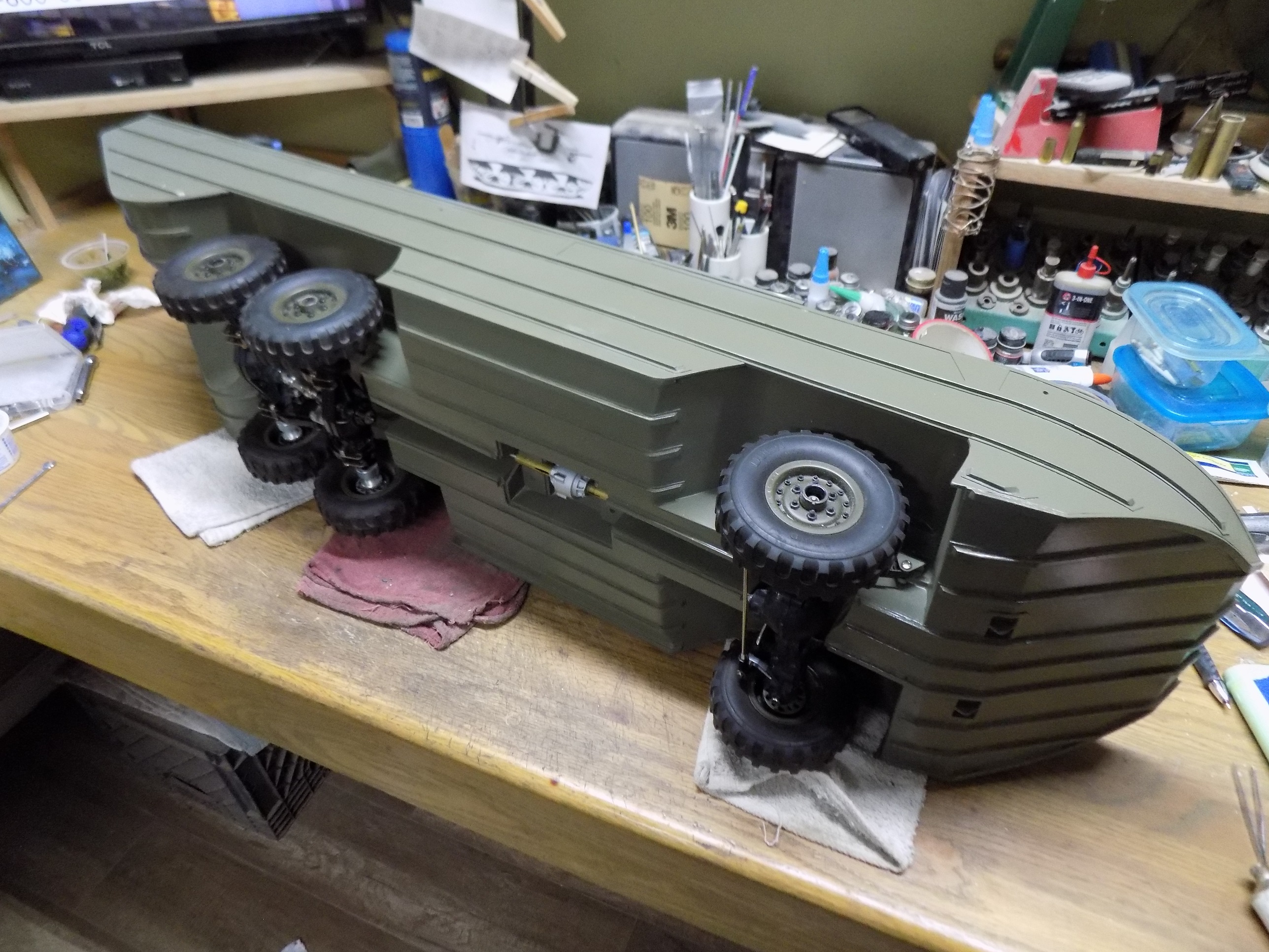

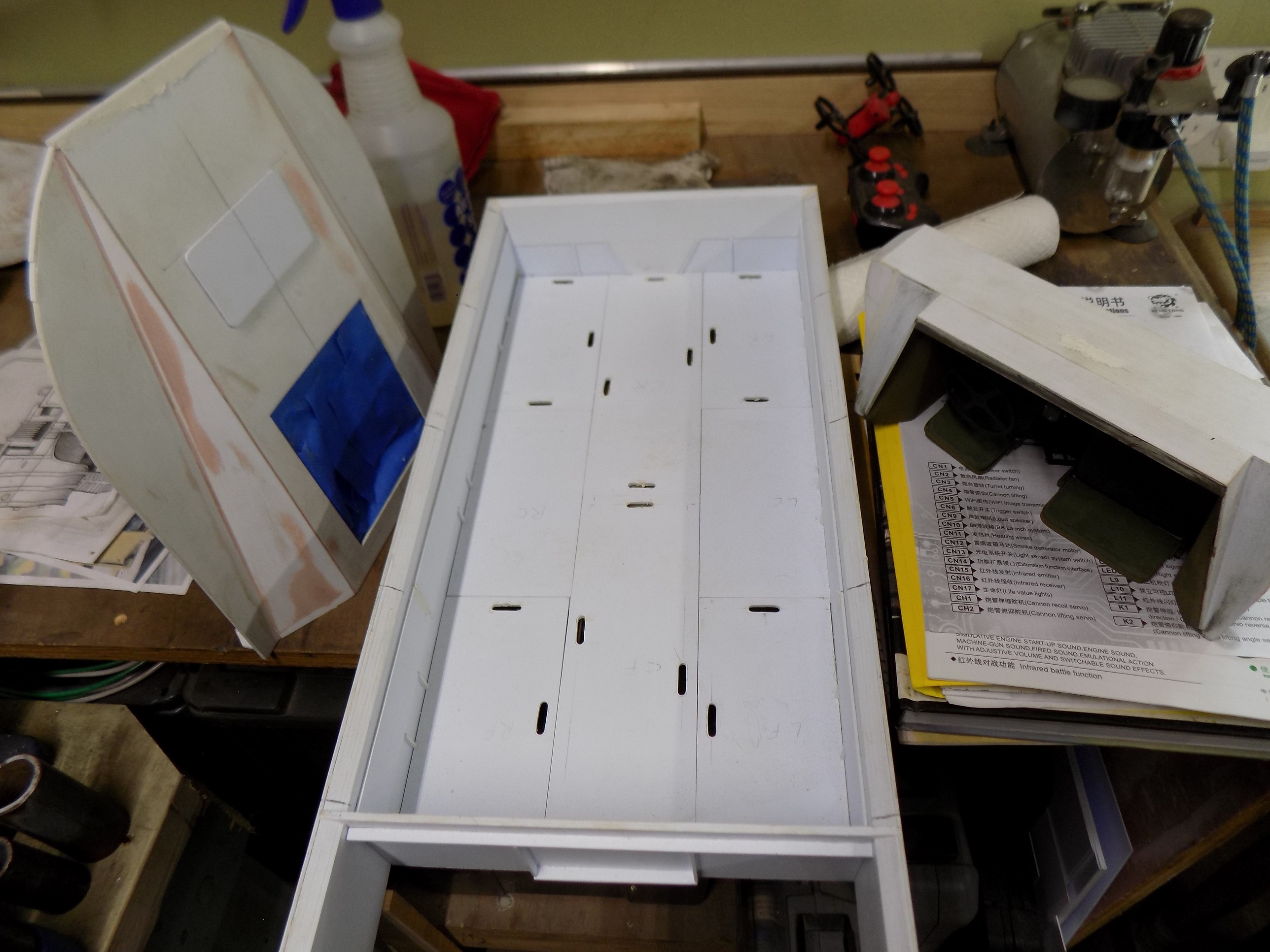

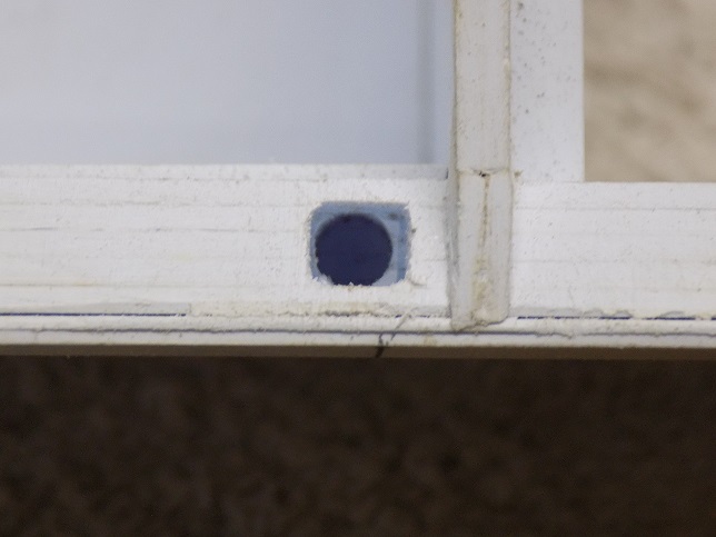

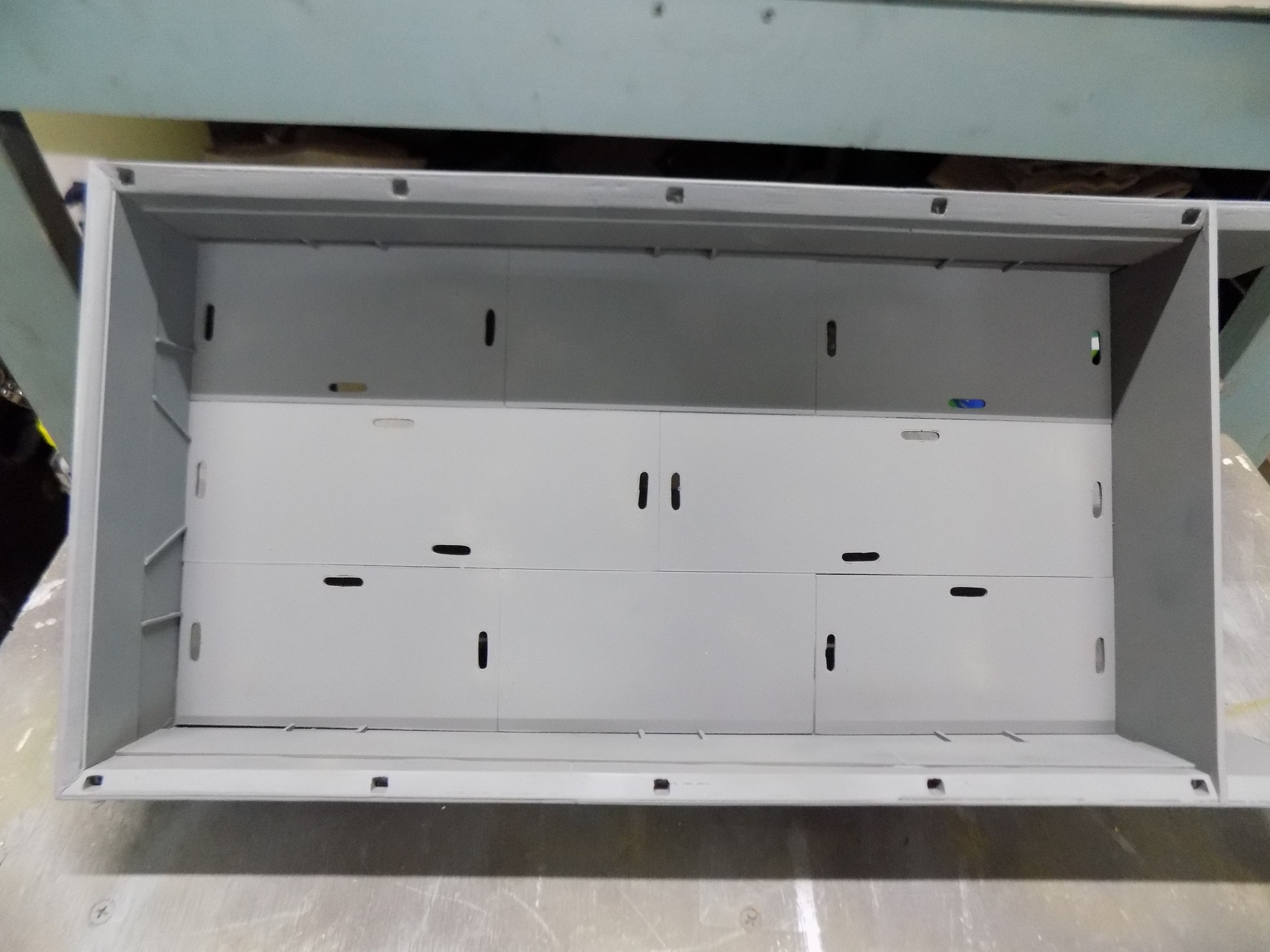

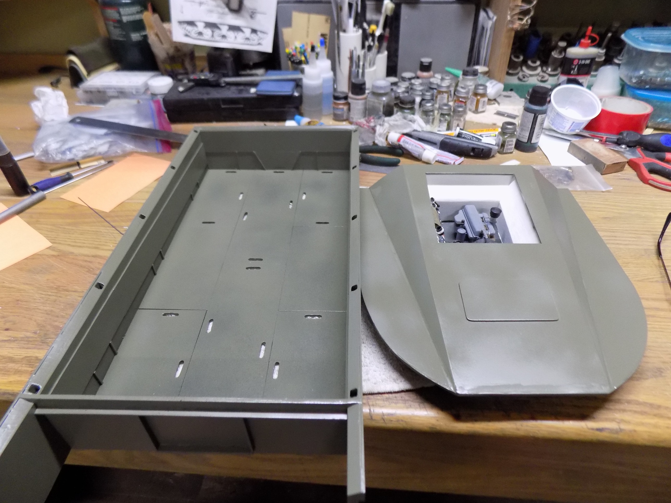

Working on the top parts of the hull to get them ready for paint.

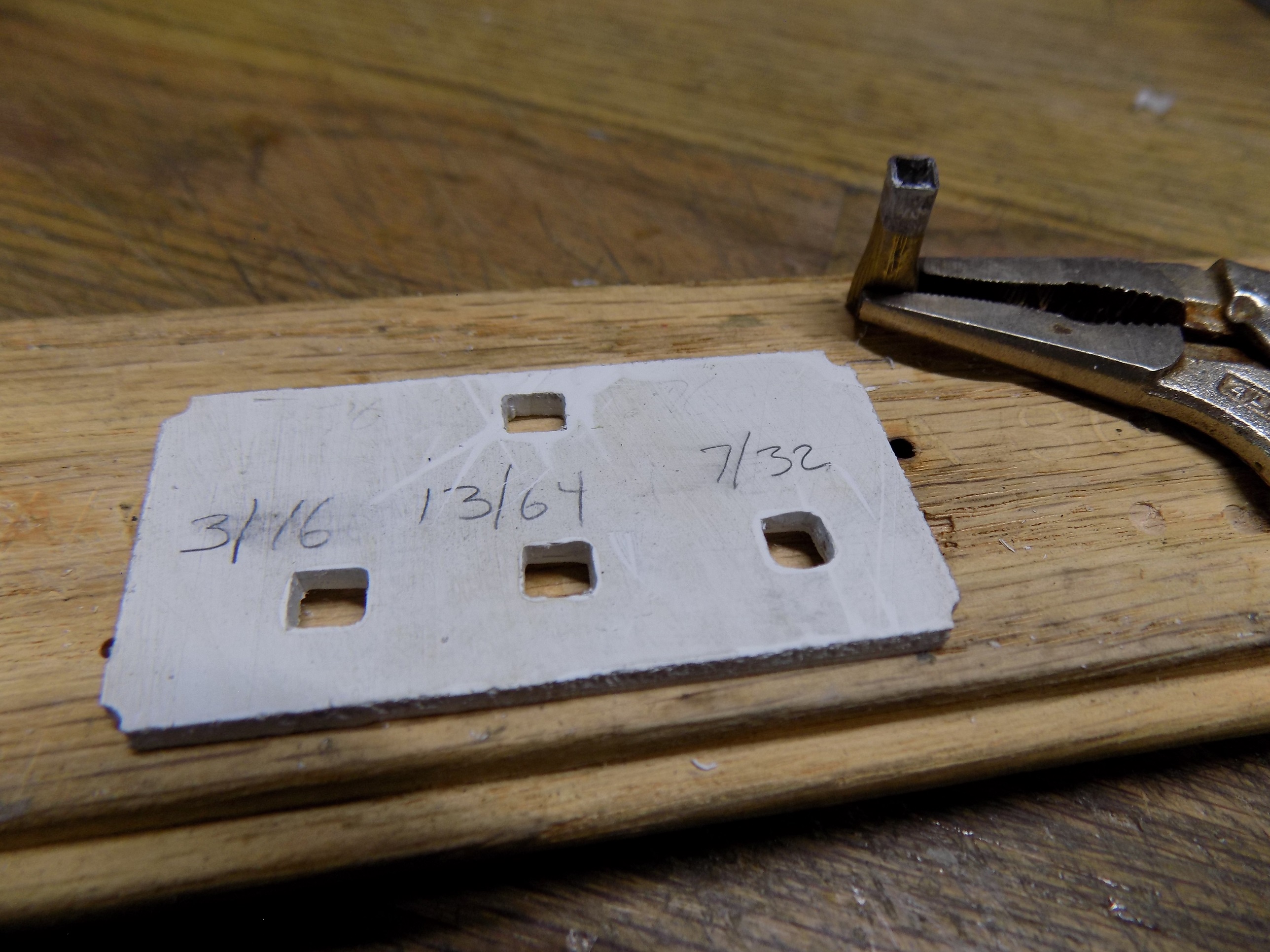

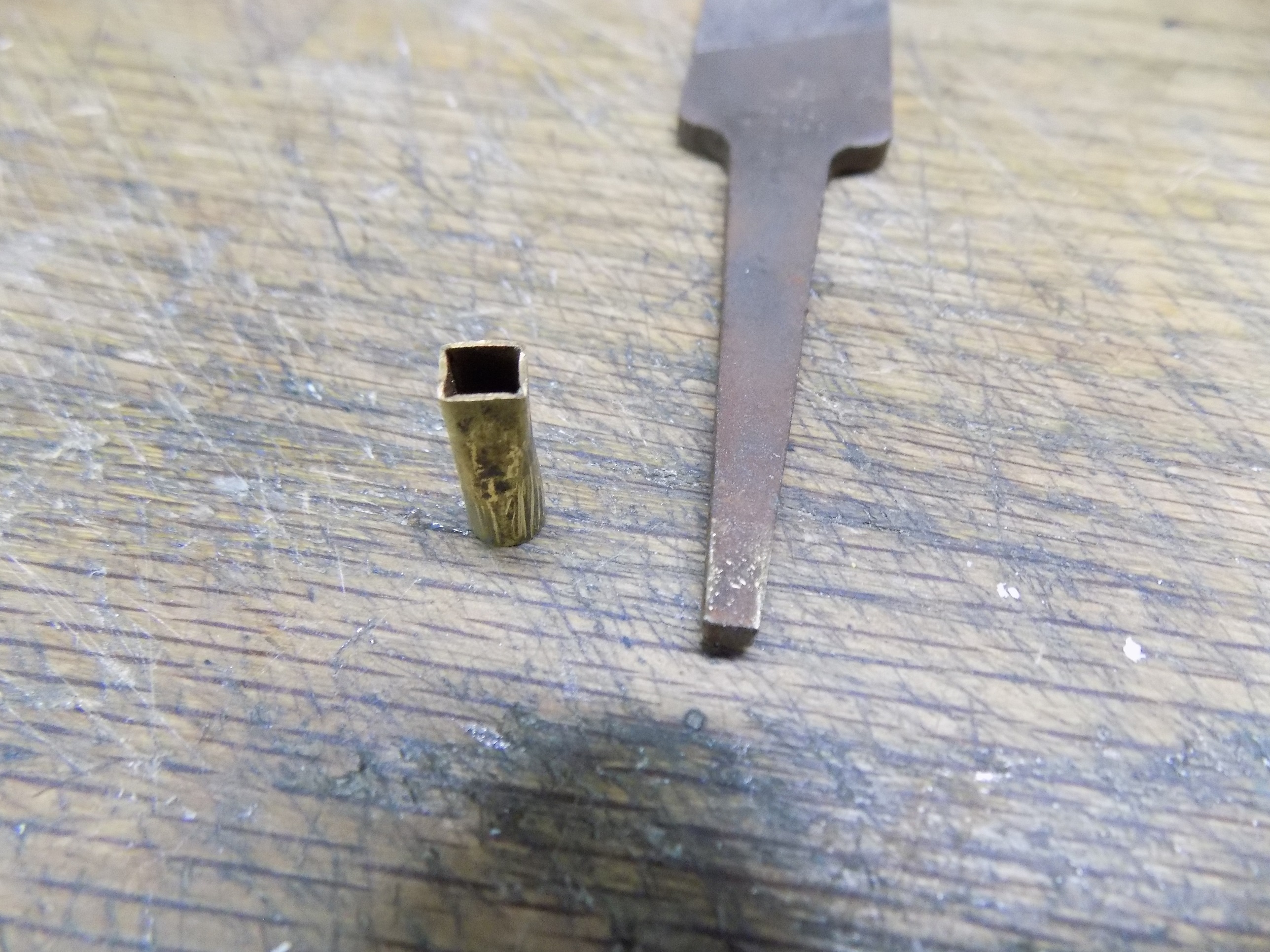

Had a nice conversation with my brother Mike yesterday on how to drill square holes for the canvas cover hoops. He gave me a great idea. Some times you just got to make some tools. I have some putty curing on the cargo deck. Once dry I will drill some holes and then heat the square brass tube and hope to shape the pockets. With luck I'll have some pictures of the results later today.

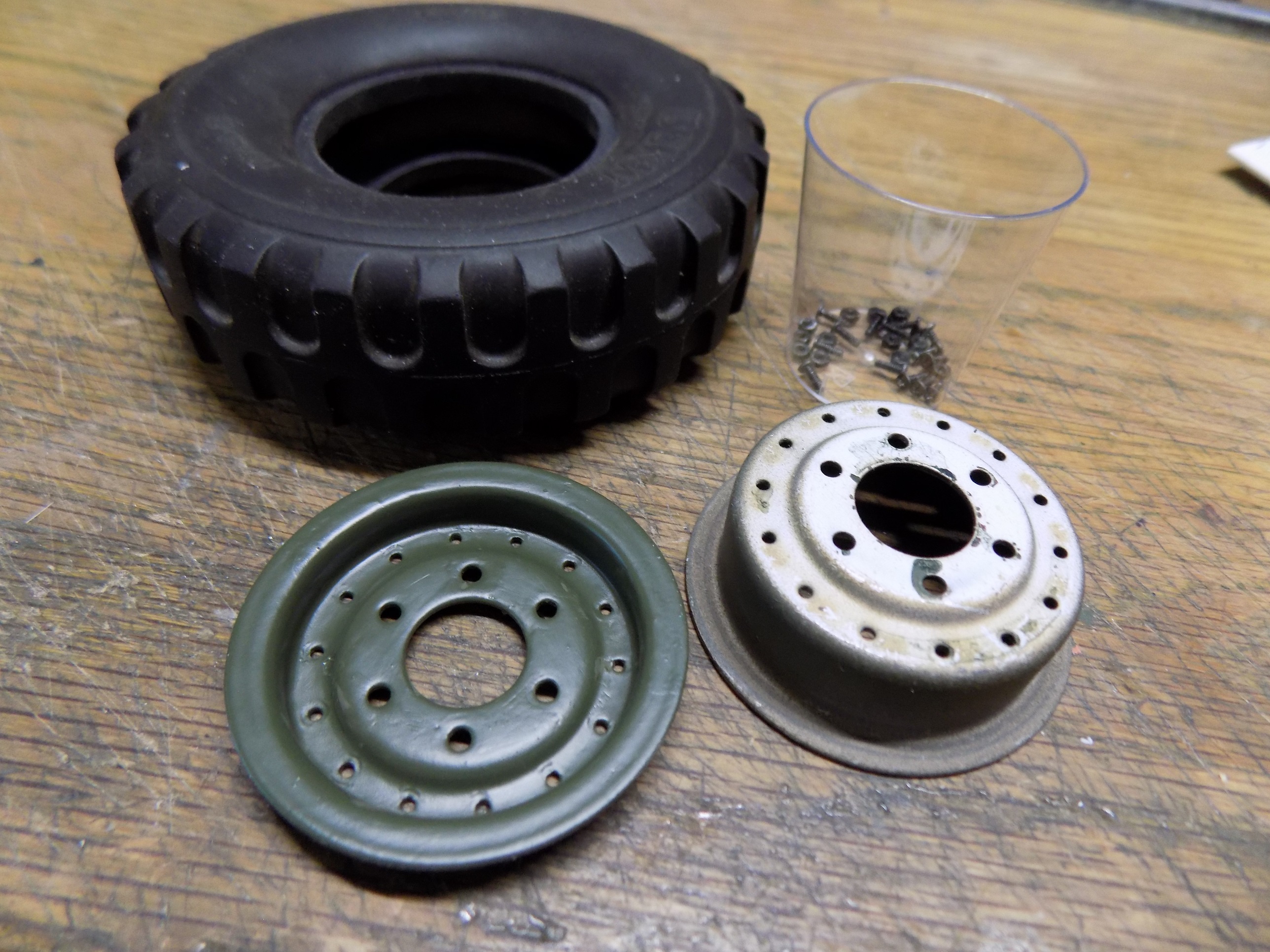

I chipped the paint on Mike's spare DUKW wheel when a drill bit broke through and the chuck jaws hit the rim. I tried touching it up, but just couldn't match it well enough. Had to pull it apart to clean it up and re-coat. These are really cool wheels but those really small fasteners are a chore with aging eyes and fumbling fingers. Earlier I had to rework the front tires/tyres to add more "stuffing" inside the tire. They were starting to look like they were @ 5 PSI as the duck grew in weight.

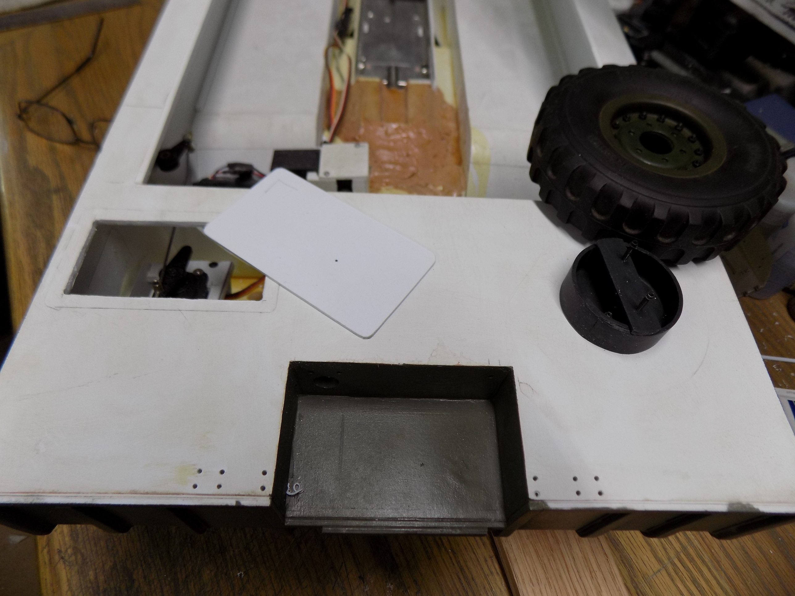

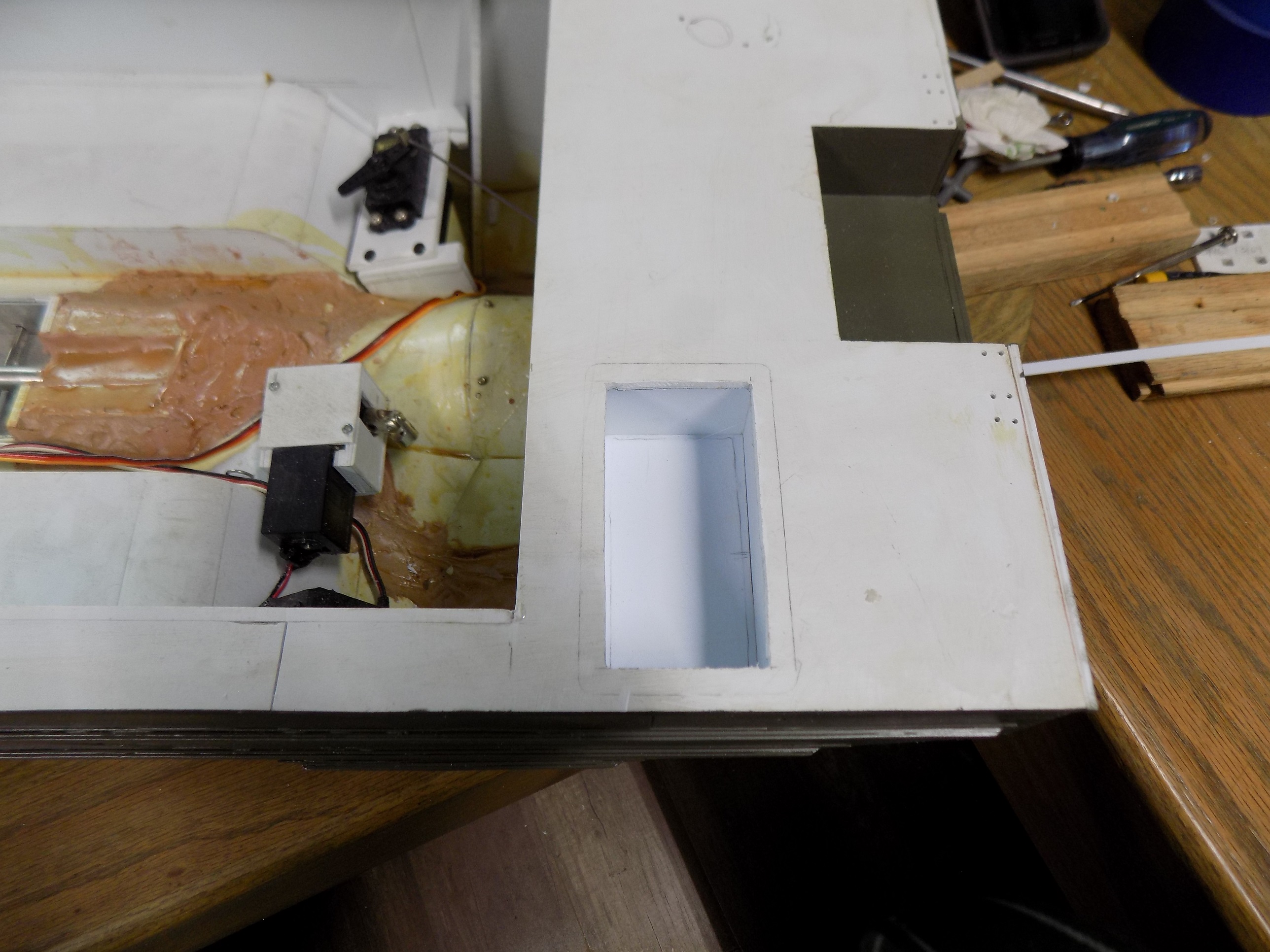

Cut a hole in the deck for the rear storage box and made a spare tire mount. The wheel has not been repainted in this photo. The storage box on the front deck will not be functional. In this case the twin motors are just below that deck hatch.

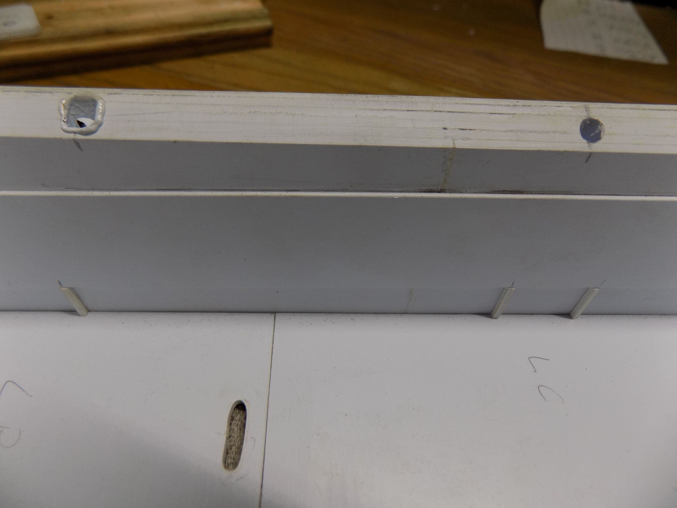

Experimented on different diameter pre-drills. Chose the 3/16. It's only in primer now because I am debating (with myself) as to if and where paint shades should change between outside/inside and floor. All in all, I am happy with the way the pockets came out. Thanks Mike for the great idea! You are still my favorite older brother.

Drilling square holes = achieved !! :thumbup:
I did wonder in what context these were required, now I can rest easy.

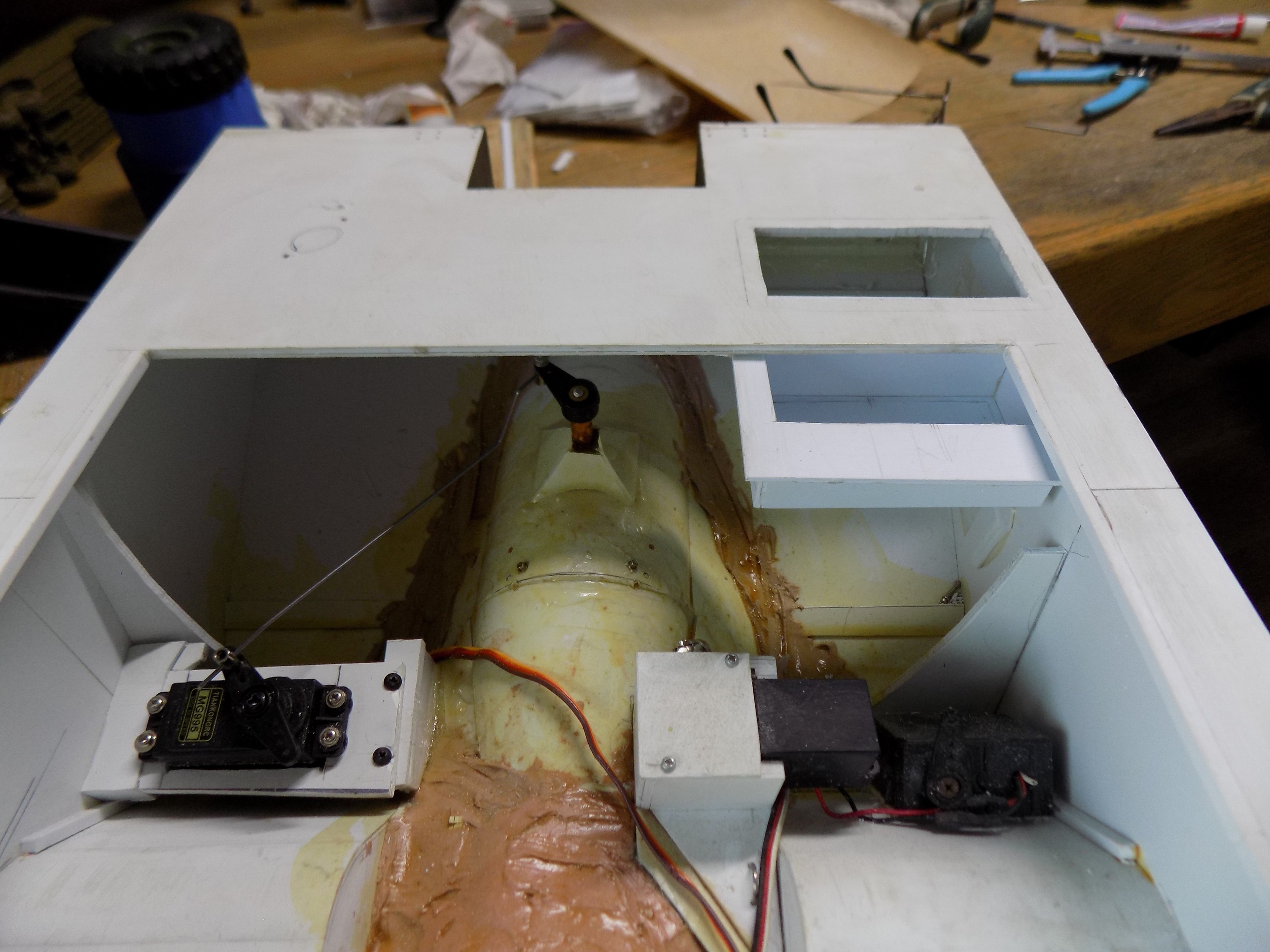

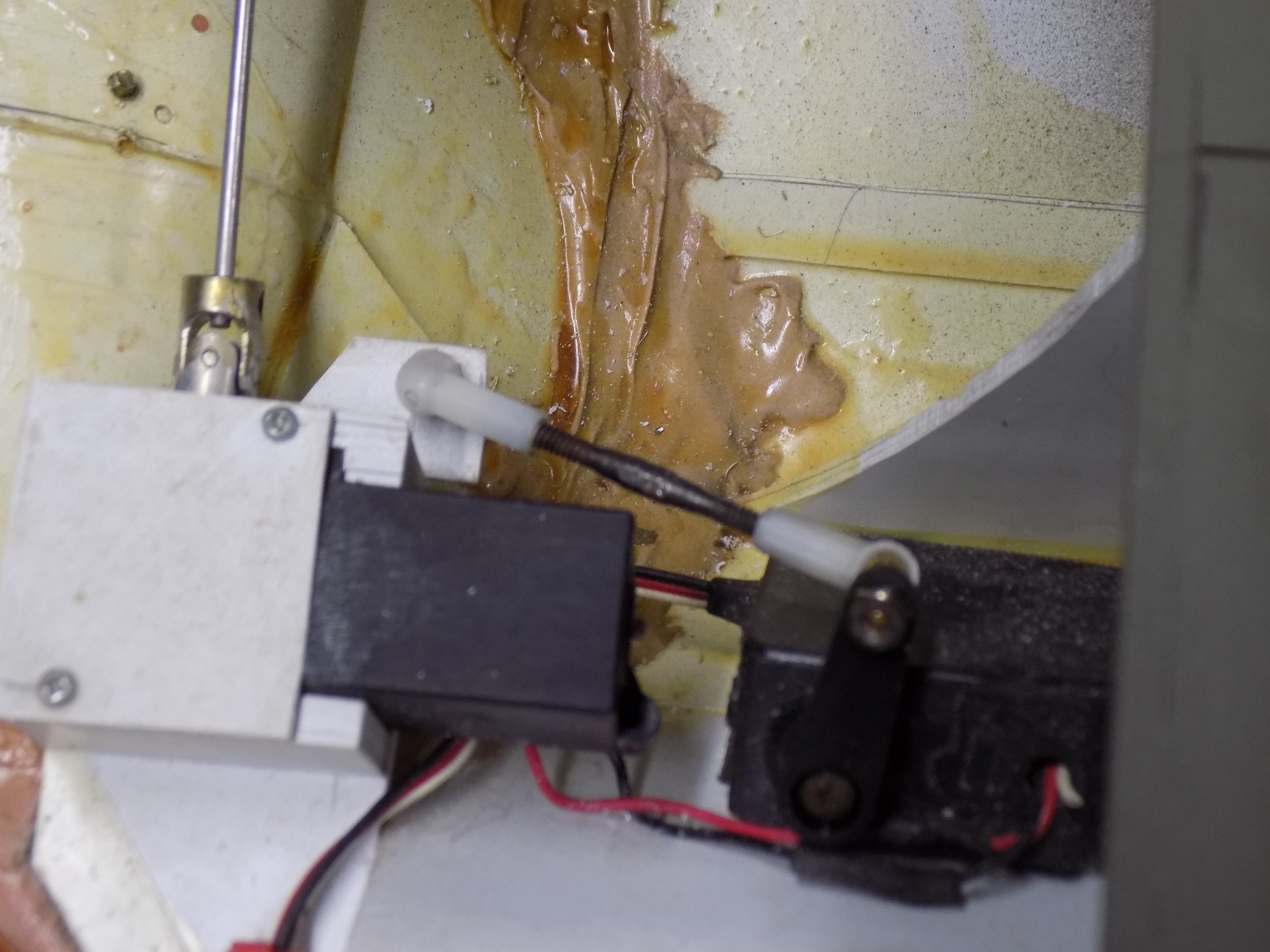

Moved the rudder servo to opposite side for three reasons. It was getting crowded on the port side, it will be easier to sync/trim the rudder with the front wheels as they are both channel one. And lastly, I wanted the aft storage box (just because). It slides in a couple slots with a stop for rear movement and the cargo deck will prevent forward movement.

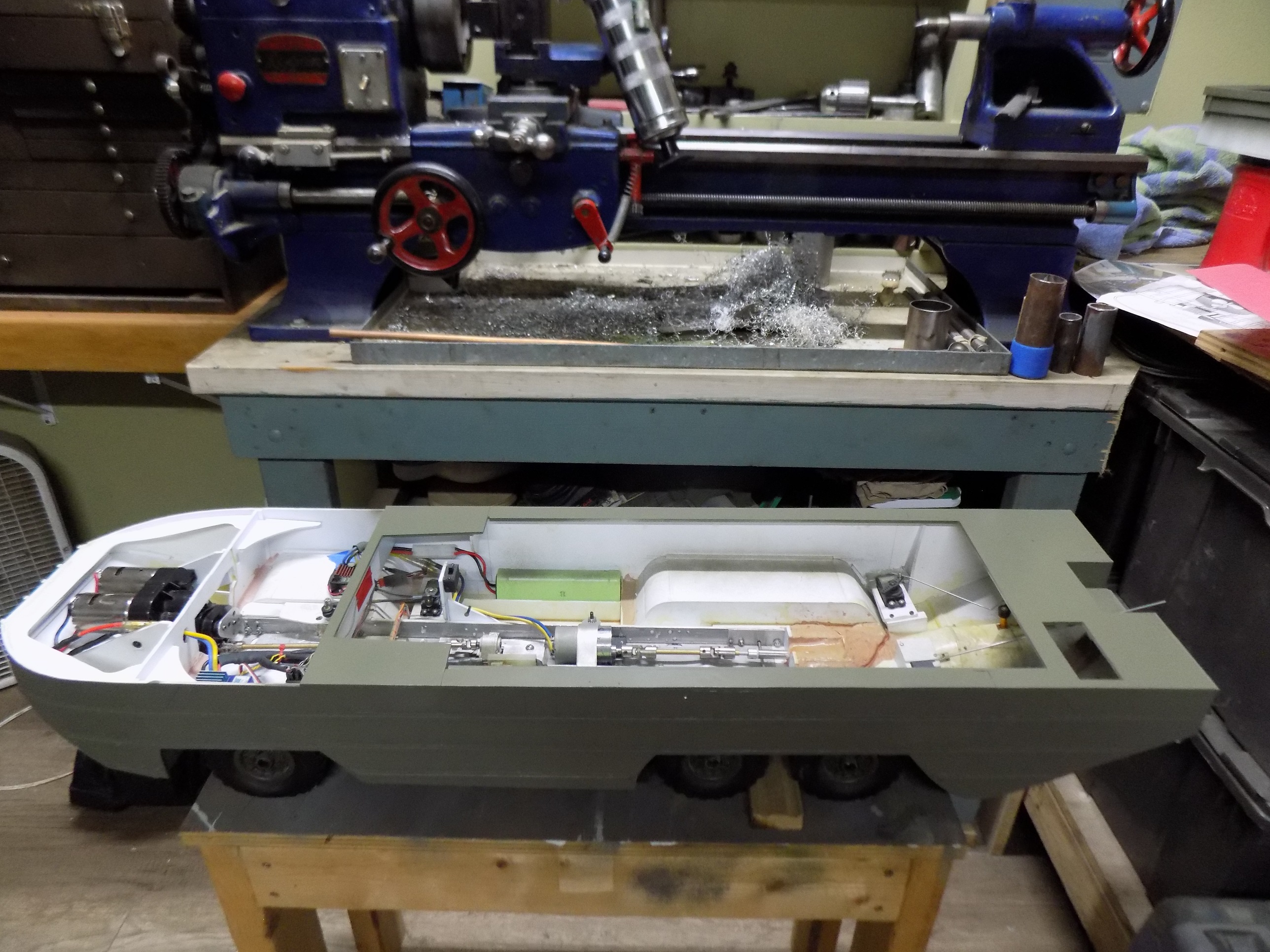

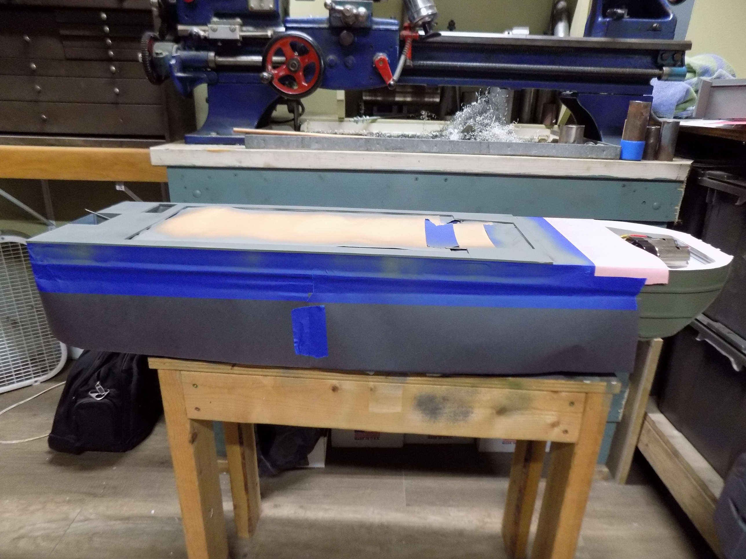

Mostly maintenance work today. Pulled the twin motor and transmission apart today. It has been getting noisy during testing. Found a couple bearings that seem iffy. Took some measurements and will get some replacements ordered. Built a link for the winch motor's servo. It seems the zero keeps changing as the model gets moved and I find the winch running when I turn it on. This link should keep the zero where it should be. Did finish most of the paint work. I know it looks like I am painting indoors. But the rain has been coming and going all day. When it stops, I run out and spray, then bring the parts back inside. It's a bit humid because of the rain (and Missouri) so the paint takes a while to dry. Also built a servo "y" to connect both steering servos. Lucked out and they both turn the correct direction on the first try. I thought I was going to have to change the rudder link around...
