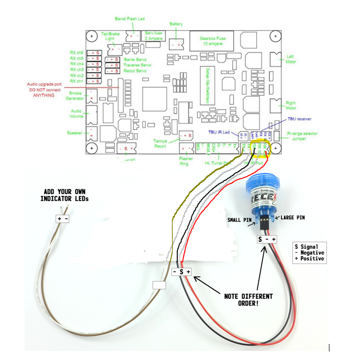

OK...we are getting into some territory where I'm not all that familiar. I have some of those Taigen apples laying around, but I've never used one. I do have an IBU2 here also, but never hooked it up to a tank. I found on the TCB Wiki how they hooked it up so maybe this will work for you. I took their pic an modified it for the IBU so the pic is crude, but you should get the idea. I would verify that it is hooked up to that port in the wiring order shown. If it doesn't work after verifying that...I'm at the end of my ideas. The Taigen apple also doesn't have any hit indicators (IE: LEDs) so all you will hear is the sound of being hit without any visual indication unless you add LEDs to the port as shown in the pic.
IBU to Recce apple.PNG (404.18 KiB) Viewed 2619 times

tankme wrote: Tue Aug 08, 2023 5:46 pm OK...we are getting into some territory where I'm not all that familiar. I have some of those Taigen apples laying around, but I've never used one. I do have an IBU2 here also, but never hooked it up to a tank. I found on the TCB Wiki how they hooked it up so maybe this will work for you. I took their pic an modified it for the IBU so the pic is crude, but you should get the idea. I would verify that it is hooked up to that port in the wiring order shown. If it doesn't work after verifying that...I'm at the end of my ideas. The Taigen apple also doesn't have any hit indicators (IE: LEDs) so all you will hear is the sound of being hit without any visual indication unless you add LEDs to the port as shown in the pic.
First of all, thank you for researching and coming across a possible solution.
It's definitely not the easiest, also because I think we're talking about attempts, and if it doesn't work I'd have to rearrange everything as it was before.
Accessing the base of the mushroom connector does not seem like an easy task, I would have to disassemble several turret parts.

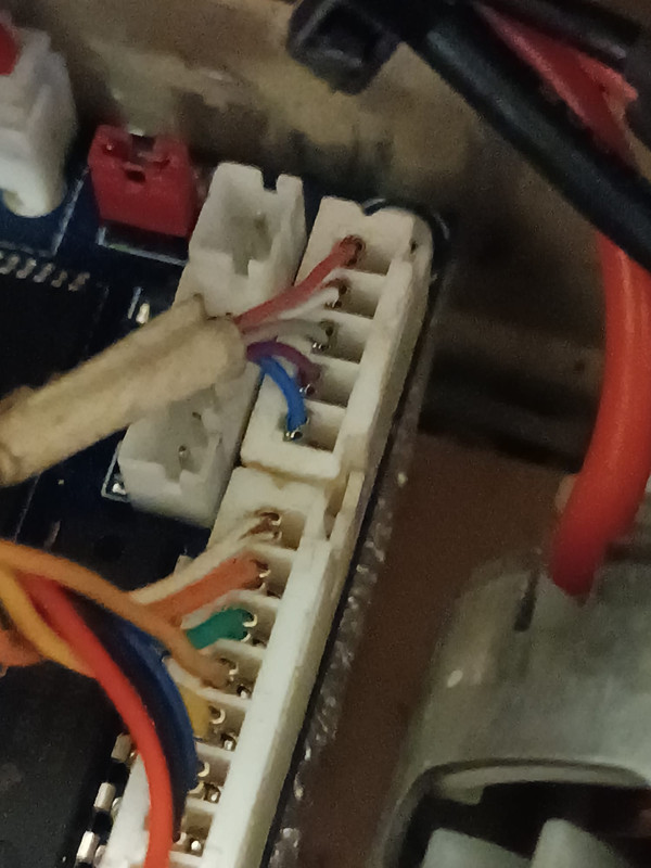

Meanwhile, I show a photo of the connector on my IBU:
The 3 cables referred to I assume are the Orange, White and Gray one. The other two are in theory for leds which I'm currently not interested in, right?
As soon as possible I will try to check in which order they attach to the base of the receiver.
