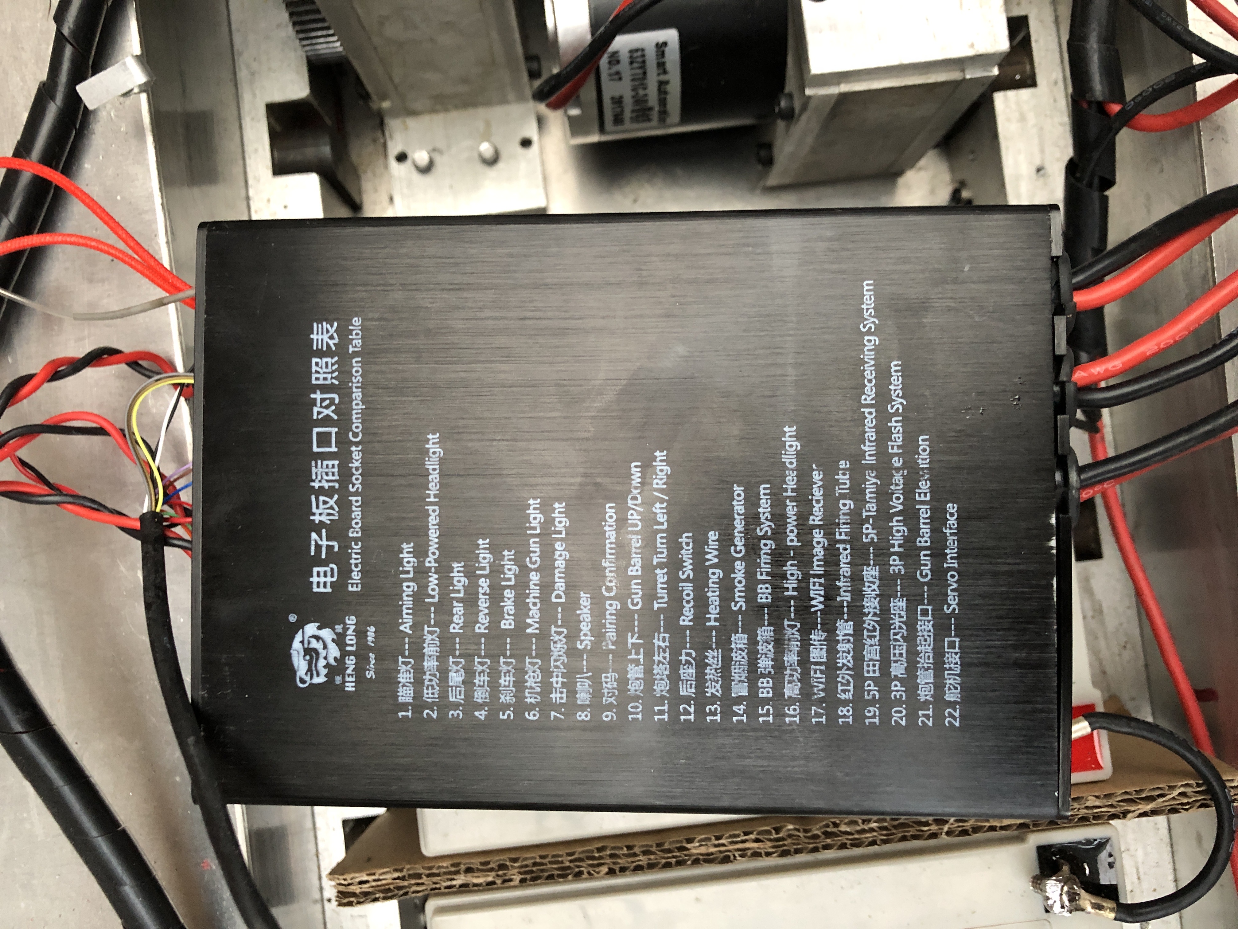

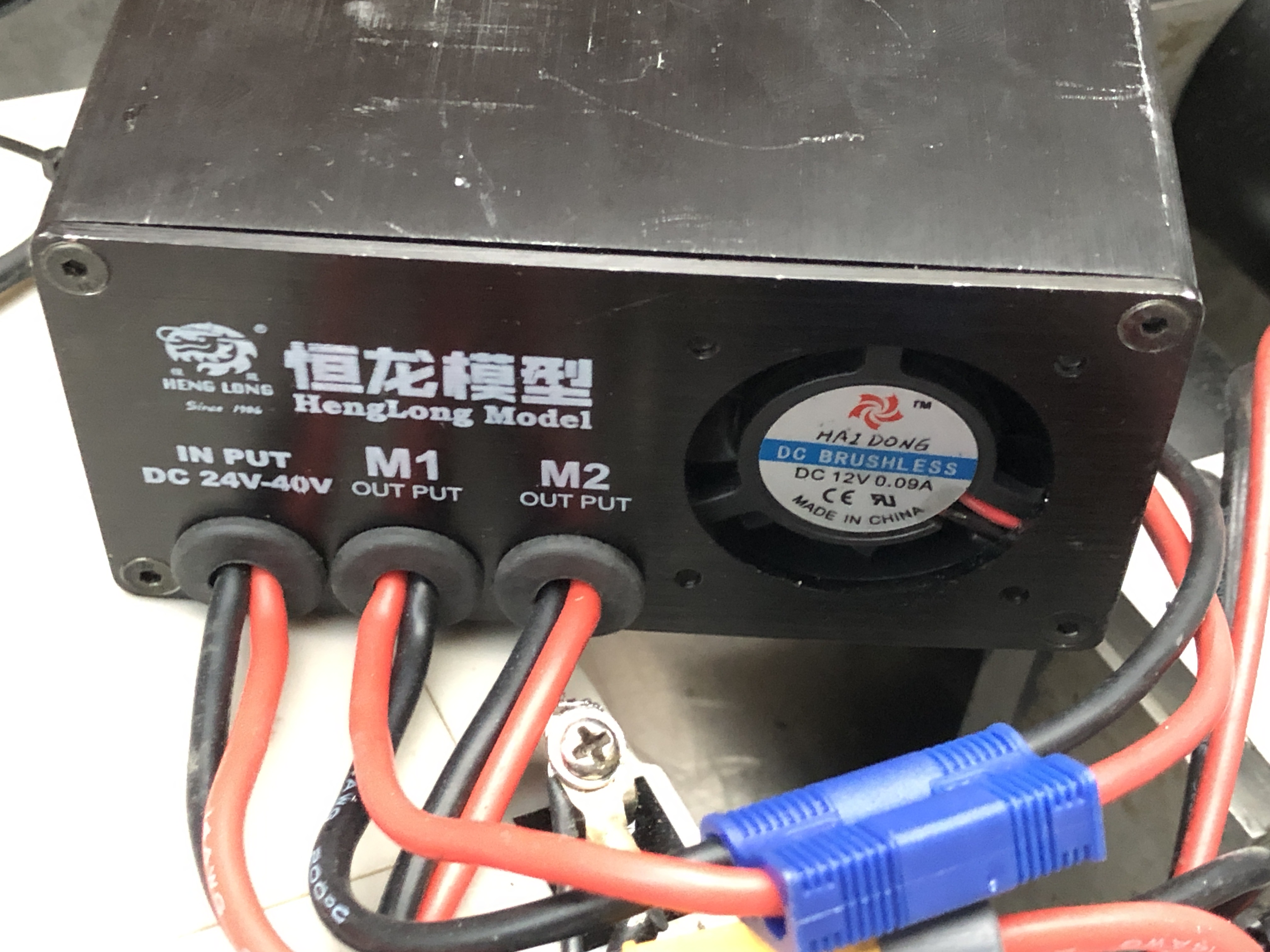

8O Question ? it is not possible, to keep the original electronics, to have all the additional functions, and to install 2 Esc in relation to the intensity of the motors, directly on the RX? maybe stupid, what am I saying? ?but should work?
tankme
Posts: 3098
Location: Elgin, TX
Re: Alternative MFU board for 1/8 All Metal Tiger I?
Post by tankme »
Jofaur86 wrote: Sat Jul 08, 2023 11:34 pm 8O Question ? it is not possible, to keep the original electronics, to have all the additional functions, and to install 2 Esc in relation to the intensity of the motors, directly on the RX? maybe stupid, what am I saying? ?but should work?
I would say something similar is already in that "black box" where the power goes in. My educated guess would be that they have the ESCs wired into a standard HL electronics and a step down for it while bypassing the ESC functions of the controller. They are using their standard controller with this tank which tells me they are using some form of their embedded RX and not a standalone RX.
